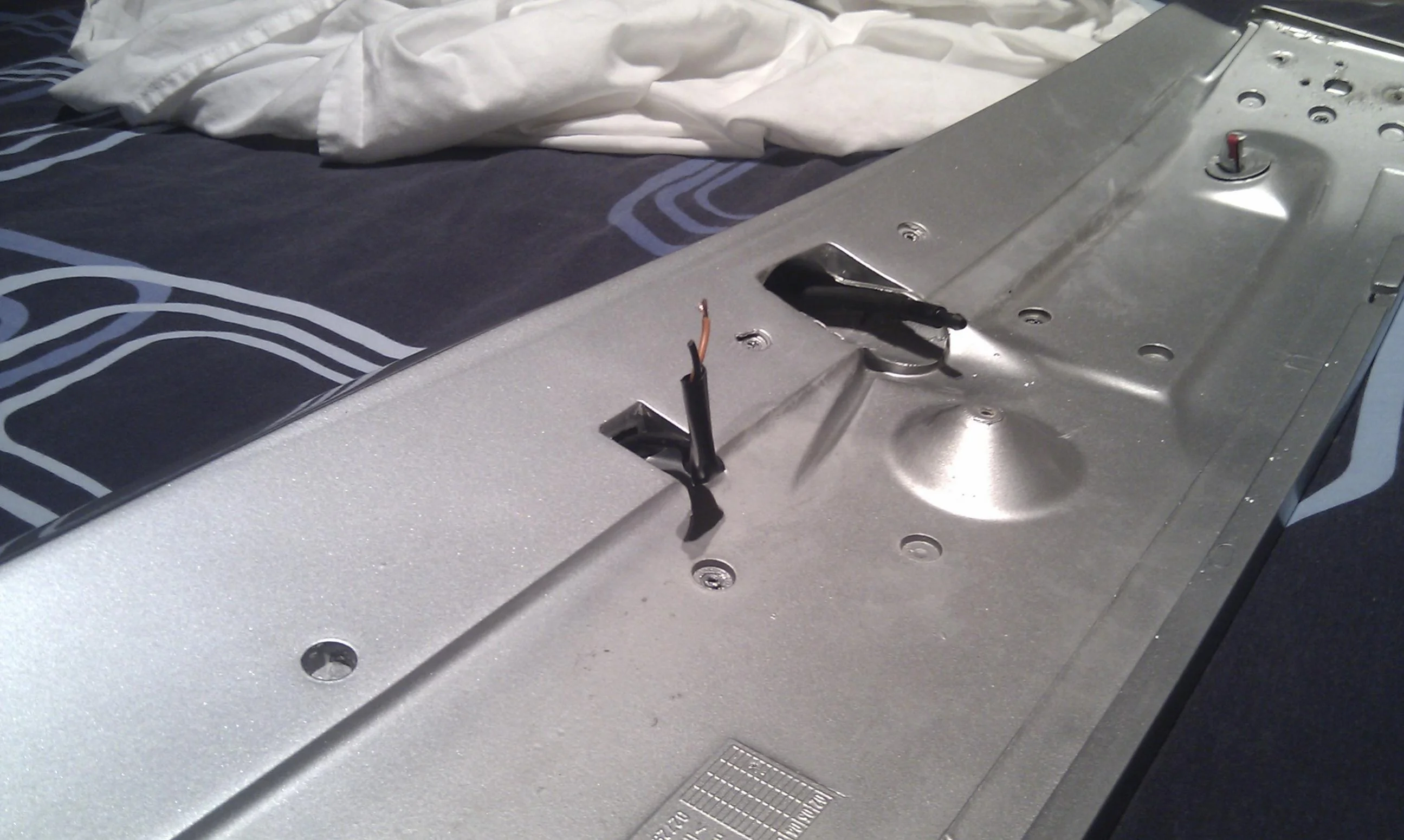

OK so I got a cup spoiler today to find the connection from the brake light to the car missing. Il post a pic, anyone know what connection i need and even better got a pic of the connection? :D

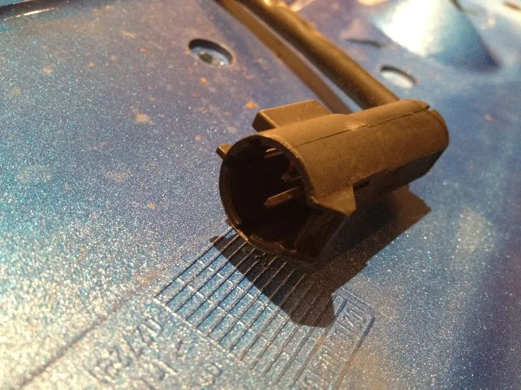

you need to chop your old plug off and connect the wires to those on the picture
the one your getting sent looks like its got some wire on as does your spoiler so just solder the wires and heat shrink it
Dont know if they split or not but wouldn't of thought so and even if they do can see them breaking doing it
