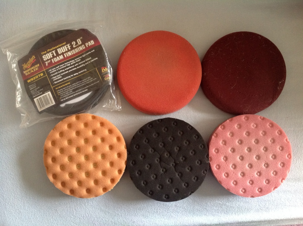

Ok I have a Meguires g220 DA polisher with various pads that i bought off someone on DW having been used once. works fine the only problem is I don't really know what pads are what. I would like a little help with these later but first I need to understand what I have done wrong when I was using it the other day.

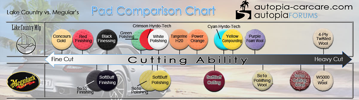

Ok part 2
What pads do I have and what's the best order in which to use them?
Thanks
Jaff.
Ah thanks lol. All I knew was I had a black soft buff 2.0 :eek:
No idea how to differentiate between the red and pink ones on top mind but I have an idea now lol
