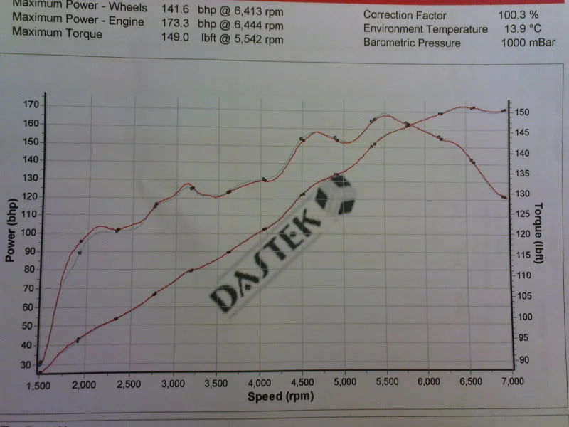

When lightly tuned (Filter+cat back exhaust) mine had a max of 149 lb ft at 5500 rpm, now due to the itb's and good mapping its making 150lb ft at just over 4000, and holds close to 160 till close to 7k.
Here is a graph when standard, the torque is on the right, and it peaks just on 150 lb ft at 5500 rpm, with a very 'up and down' torque curve.

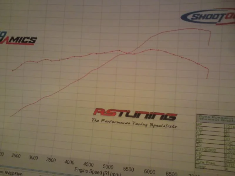

Here is the curve after the itbs, the power is like a line, and the torque curve is completely different

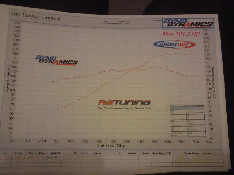

I then made a few more changes, such as moving the air temp sensor into a trumpet, plus a few other things, and had the map tweaked again and the curve got even better:
although its not gained a huge amont peak power/torque, its now making between 15-20 bhp and lb ft of torque more at any given point in the rev range, completely changing how the car dives, and explains why its so much faster.
Timed performance has gone from 0-60 in 6.7 secs average, to 5.7 average, and 1/4 mile from 15.0 ish to 14.2

Its difficult to compare the two sets of results directly because if you look at the torque resolution on the two separate rolling roads it is very different. The res of the original rollers is fair greater hence the peaks & troughs on the first, and the seeming flat line on Paul's setup.
You also need to be careful with the cost estimation too as I'm fairly sure you have saved massively on the calibration work.
It's a brilliant project though. Something that should have been done years ago, instead people were pushed towards non OEM ECUs.

Its difficult to compare the two sets of results directly because if you look at the torque resolution on the two separate rolling roads it is very different. The res of the original rollers is fair greater hence the peaks & troughs on the first, and the seeming flat line on Paul's setup..
Im back on these rollers this coming weeked so il post the results up :)

Yes mate, though they are on 2 different rolling roads, this coming weekend im back on the first set of rollers so I will be able to accurately say how much its gained :)
