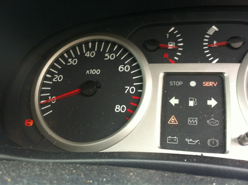

Sounds like its either going to be the ABS pole wheel or the ABS sensor itself, not much more it could be mate. Take the sensor out, and put it back in making sure its sat in the right place then test drive and see if the fault is gone?
Do you understand the principles of how the ABS system works mate? If you don't have a read up on it and it should make it easier to figure out what could be wrong.
