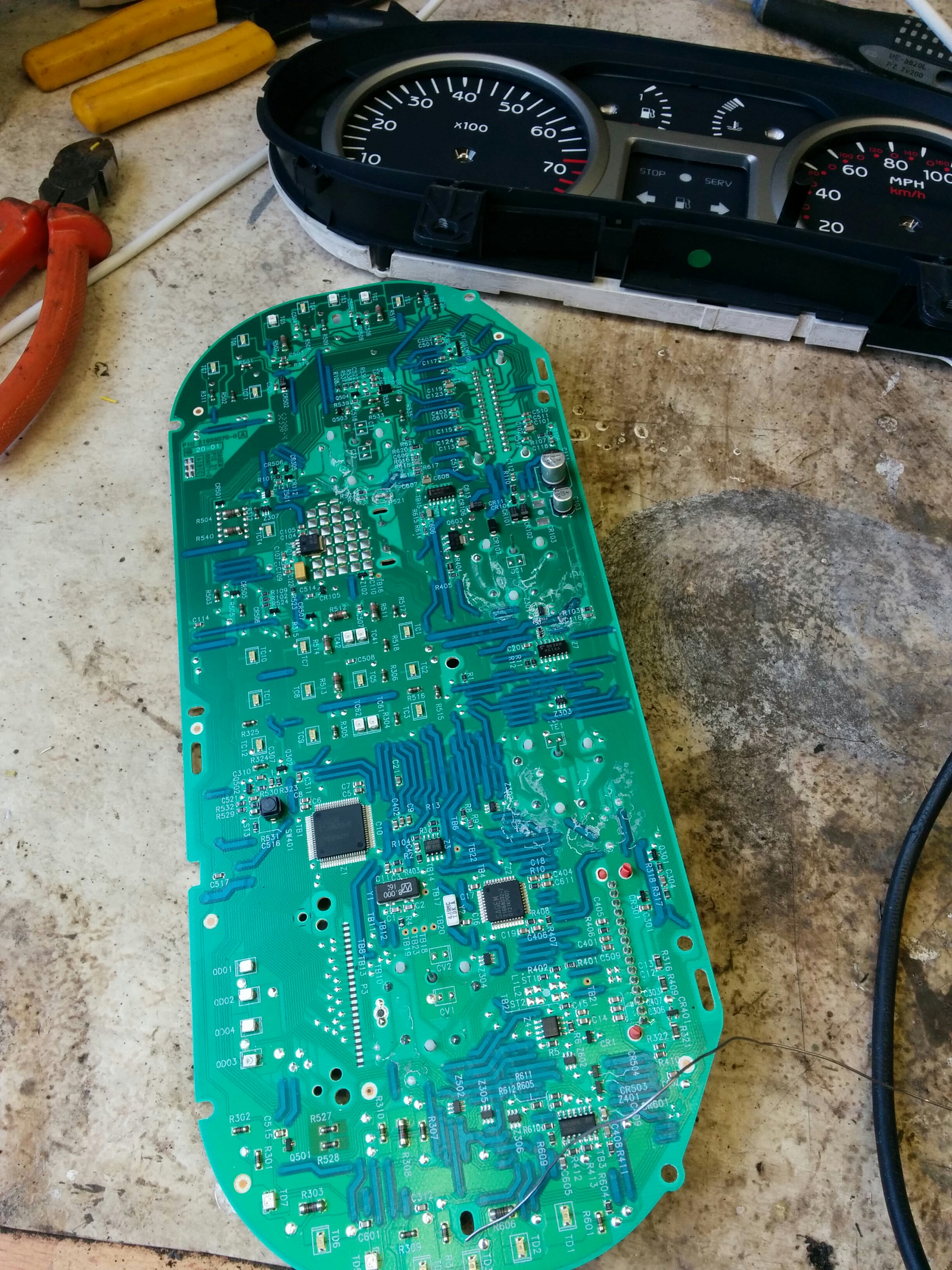

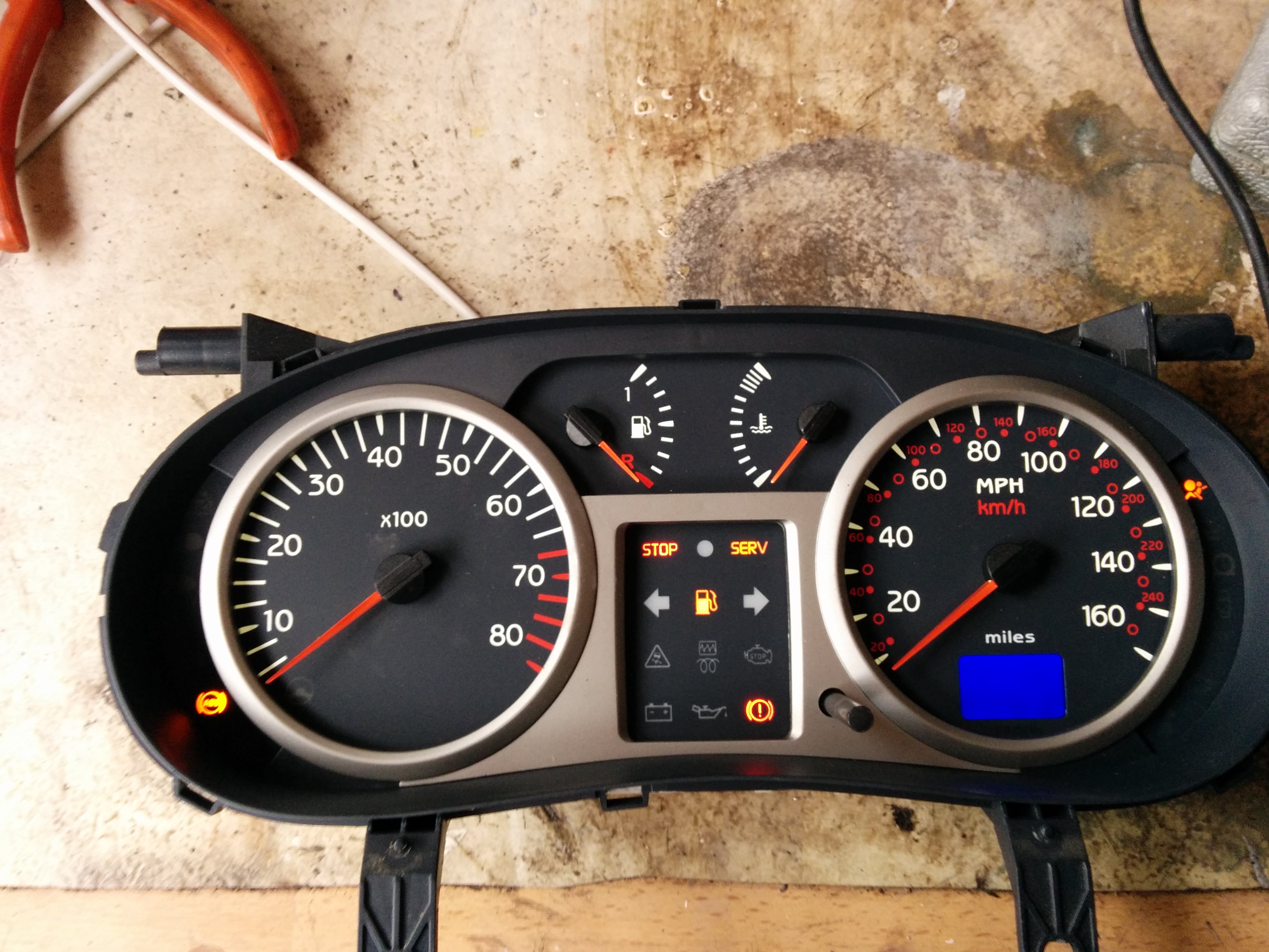

Did you take all the LEDs off in one go? I did them one by one testing them as I went!

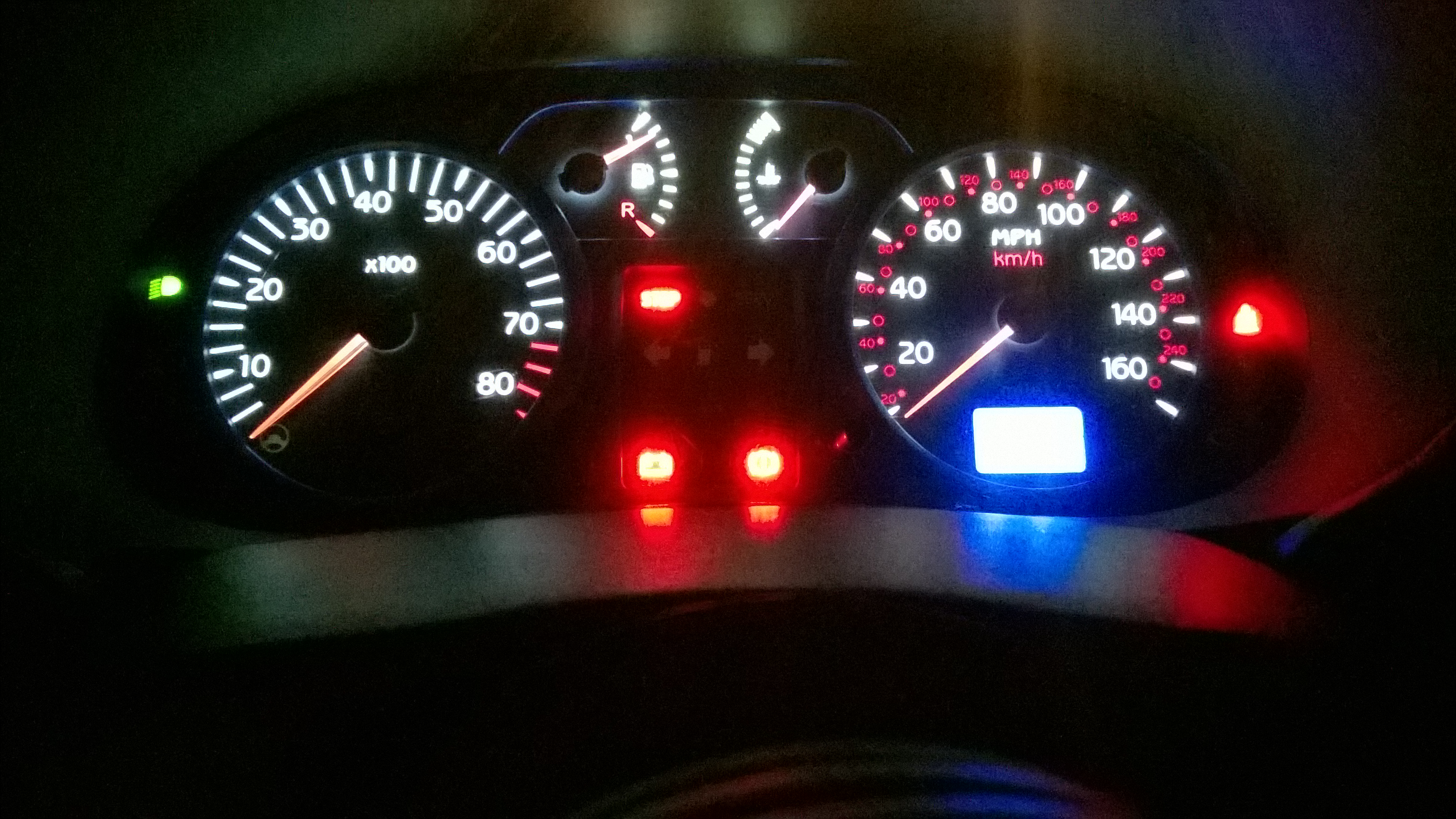

Did the four mileage display ones, then tested. Then did the rest, tested, fuel and temp gauge didn't work. Polarity correct bit swapped them for different LEDs and they worked fine. Only thing I'm worried about is the needle placement. Is it a case of running the car with the dash off and placing the needles back on with it running knowing where they should be?

The stepper motors have end stops on them. Turn the motor spindles all the way anticlockwise until they come up against the end stop. Then put the needles on half way up the gauges (e.g. 80mph, 4000rpm etc) and push them down to your 0 marks (Which of course you marked off beforehand... didn't you?).

When you say push them down to my 0 marks, is that pushing pushing them round on the spindle so that the end stop lines up with my 0 mark?

When I do it, I mark where the needles sit at their lowest positions on a piece of masking tape stuck on the dial face. Afterwards, I push the needles down so that they sit on those marks. The 0 marks are lower than the first marks printed on the dial faces which is why it's important to mark them beforehand, but for the record in the picture above all the needles appear to be in the right place. If that's the farthest down each one will go without hitting the end stops then you're lucky.

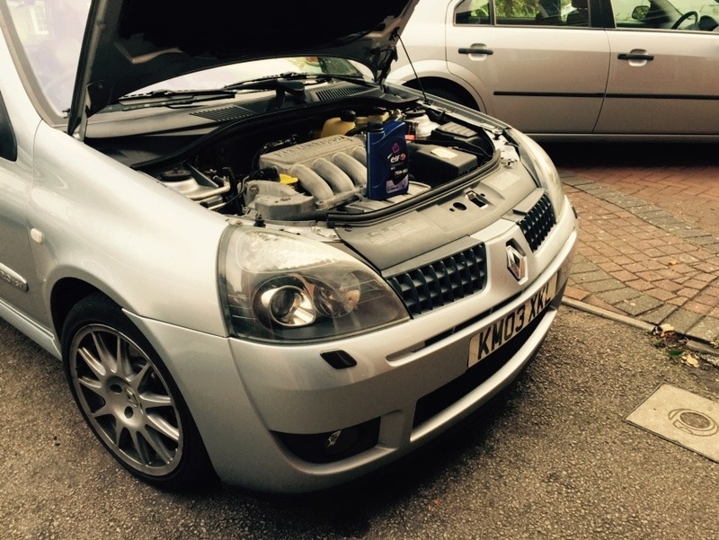

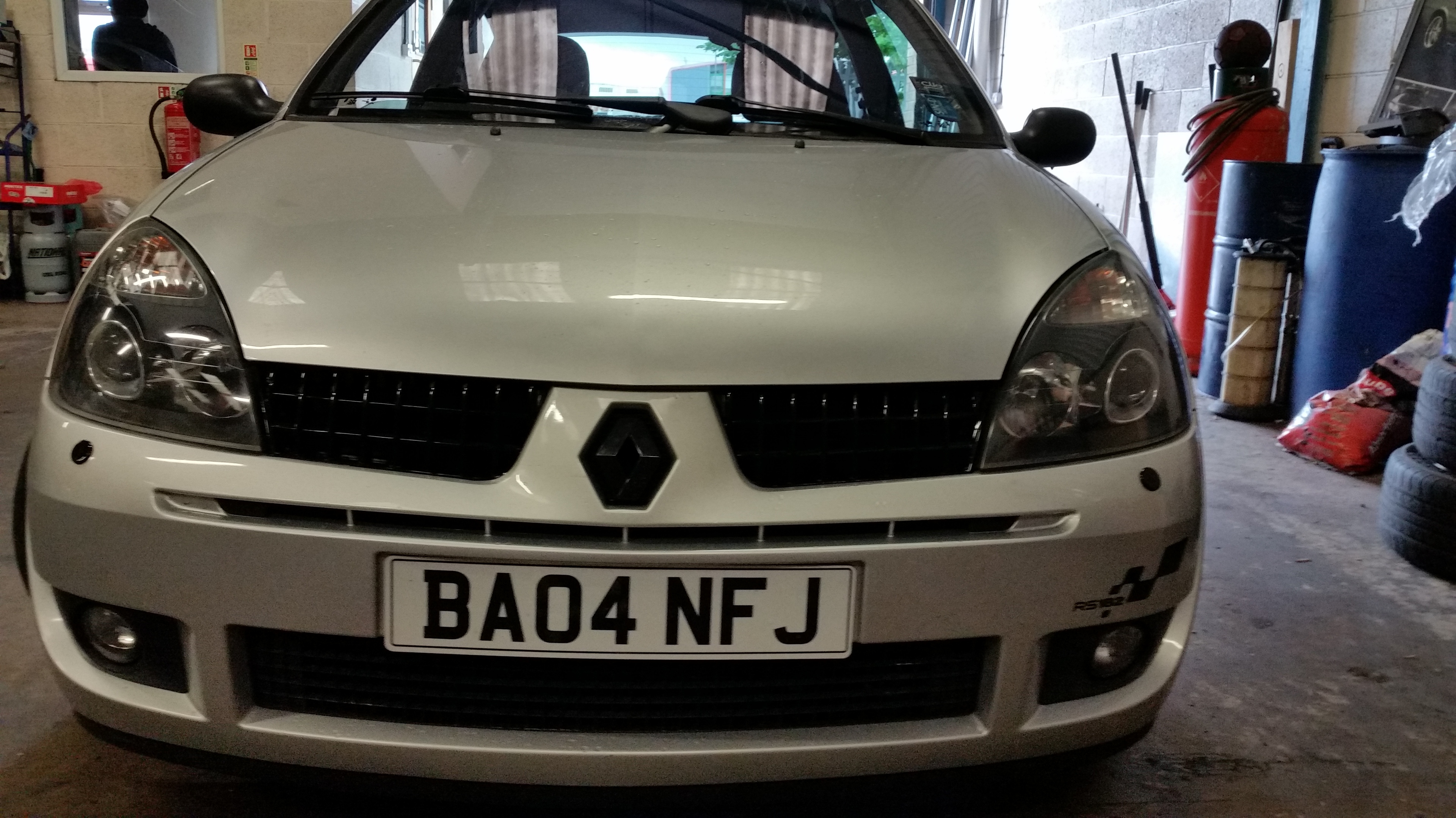

The 'to do' list with my car is shrinking slowly but surely.
For quite some time, well, since I bought the car the reversing lights have never worked. Car parks have been interesting to say the least. I heard that the gearbox sensor was an issue here but I thought I would check the car out first, given that the gearbox has to be partially drained for the sensor to be fitted due to its location.
After obtaining a new reversing sensor, establishing that it went to a dead short upon closing I shorted the wires out on the car with the ignition on. Sure enough the reversing lights worked for the very first time ever in my ownership. With that in mind I ordered 4 litres of Elf's finest; Elf Tranself NFJ 75W80 GL4+ gearbox oil. With some food grade plastic tubing and a funnel I was ready to get stuck in.
Whilst I was draining the gearbox oil I cleaned the misting oil around the selector shaft and noticed a slight amount of play in one of the linkages ; I shall have to put up a seperate thread to look into changing the parts.
What was strange was how clean the gearbox oil was that came out of the gearbox! Maybe it had been done before. However, with the new Elf stuff in the gearbox is now pretty much silent :smiley:. Furthermore the gear changes have improved from cold. It also helps that people can see where I am reversing now! It is nice when a job works out like this :smile:.
Now to look into changing the bush/rod at the bottom of the gearbox in an effort to improve the gearchanges. Any ideas if the parts are available seperately?

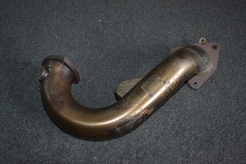

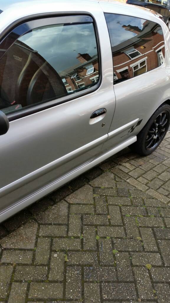

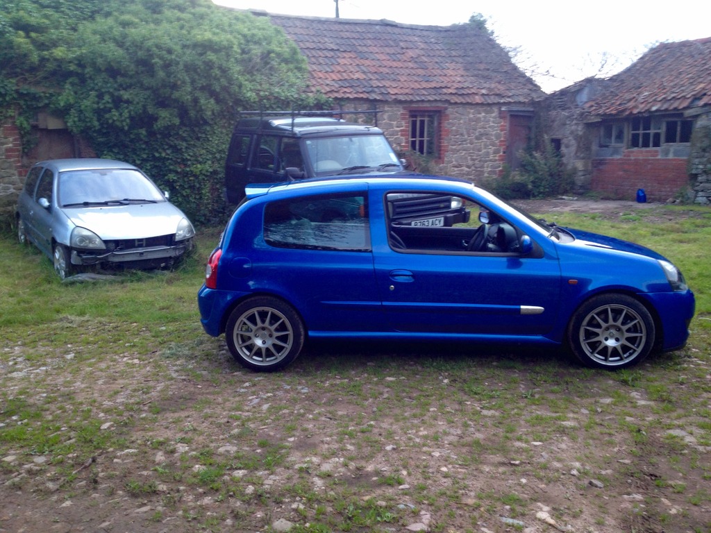

Went down the yard to grab a few bits from the bust up berg.

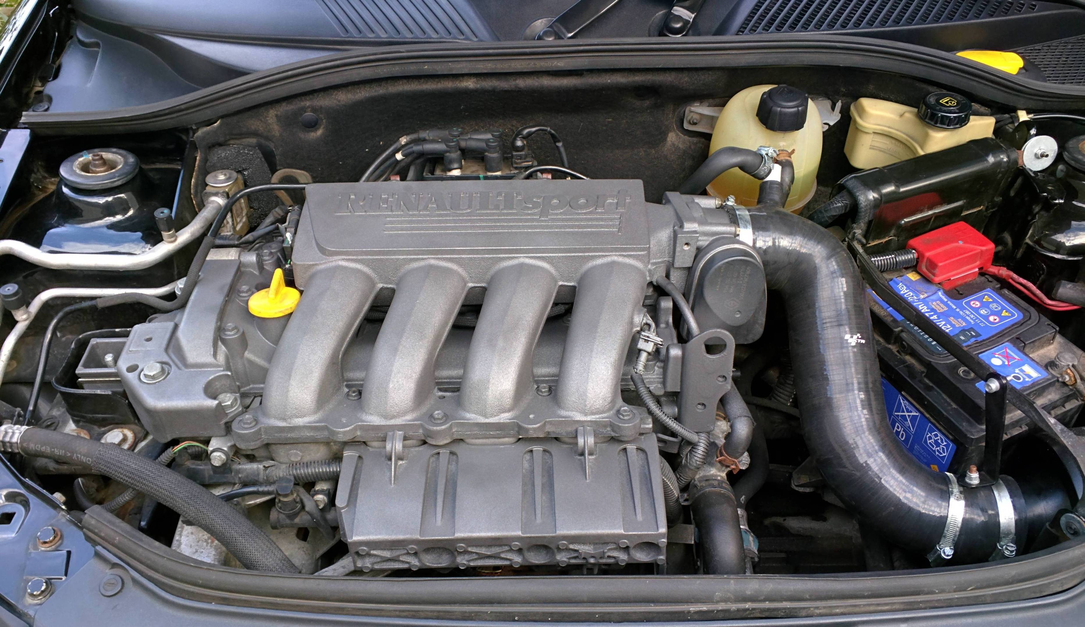

Took the door bullets off her to spray up and put on the cup, nabbed a fresh intake elbow as the old one had been cut down

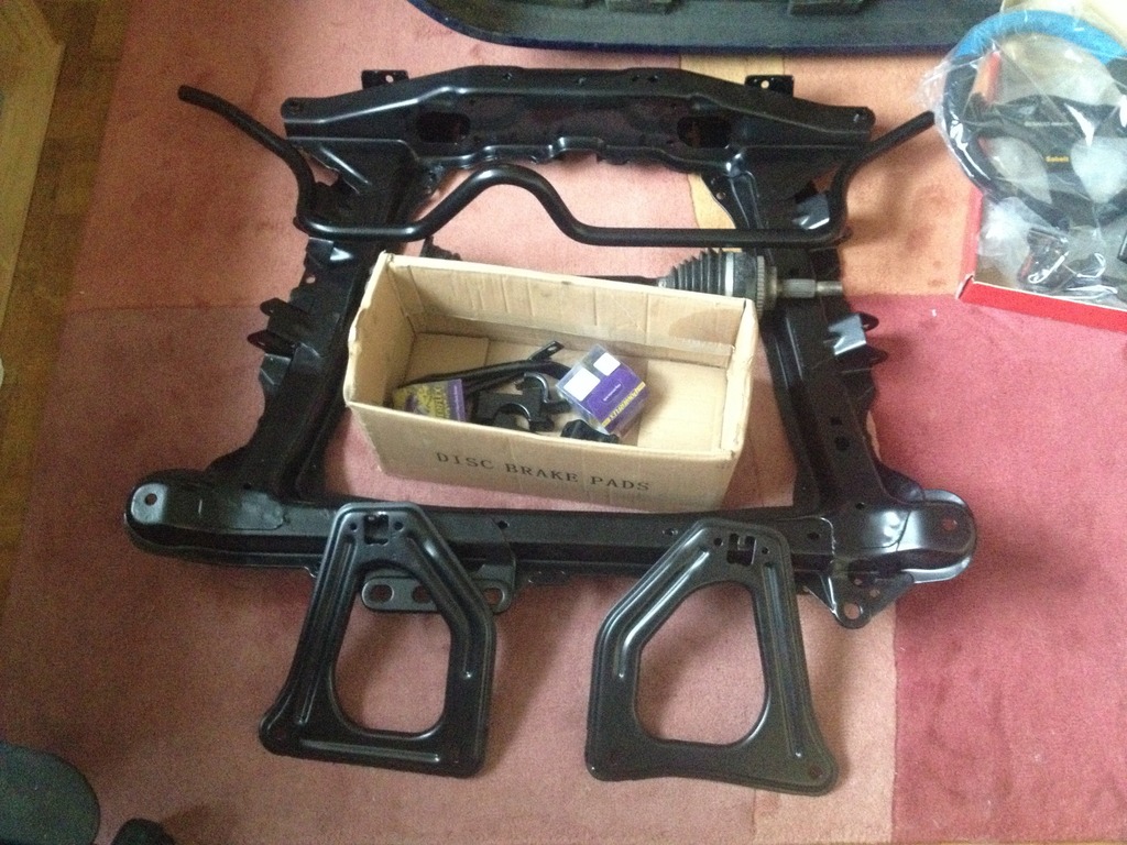

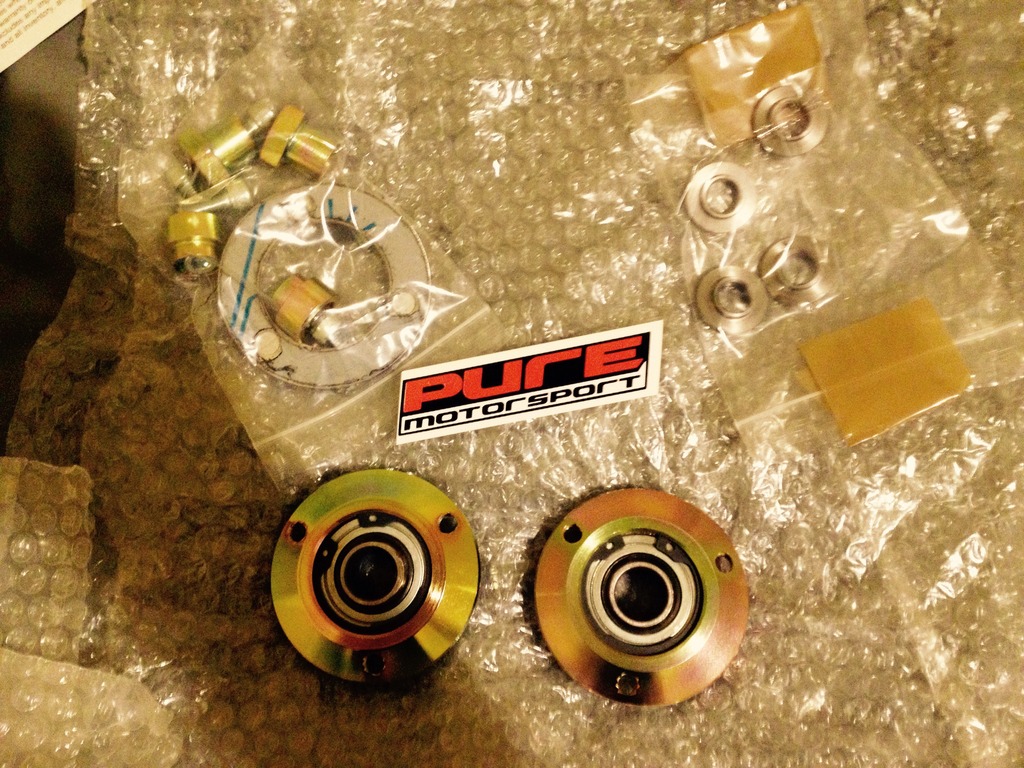

PMS top mounts have arrived along with the subframe repair kit.
Not done today...but all sat ready and waiting for fitment. Nothing at all wrong with the subframe that's currently on the car. Just being a fussy tit and want the car looking and feeling new.
I should really start a project thread!

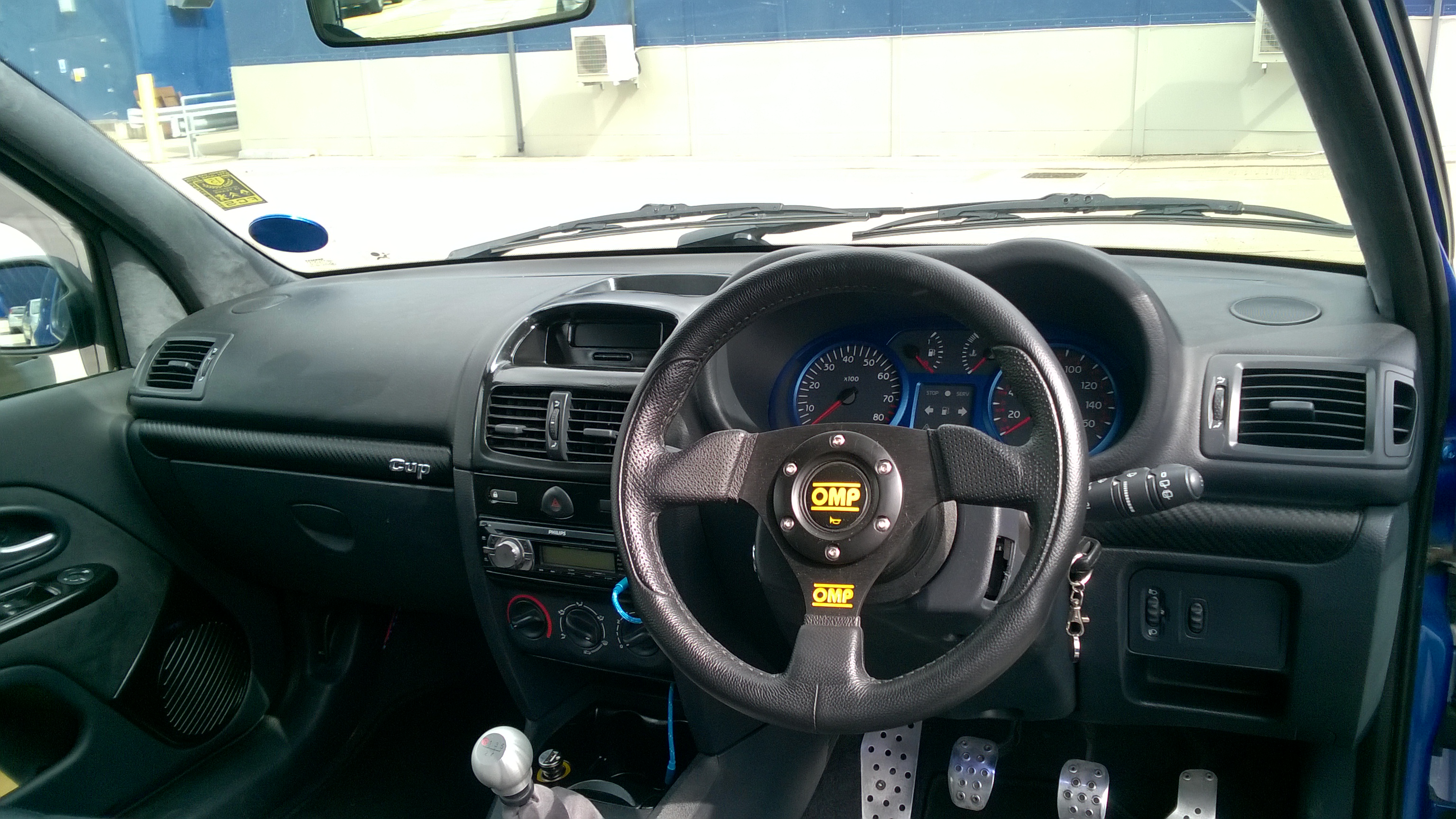

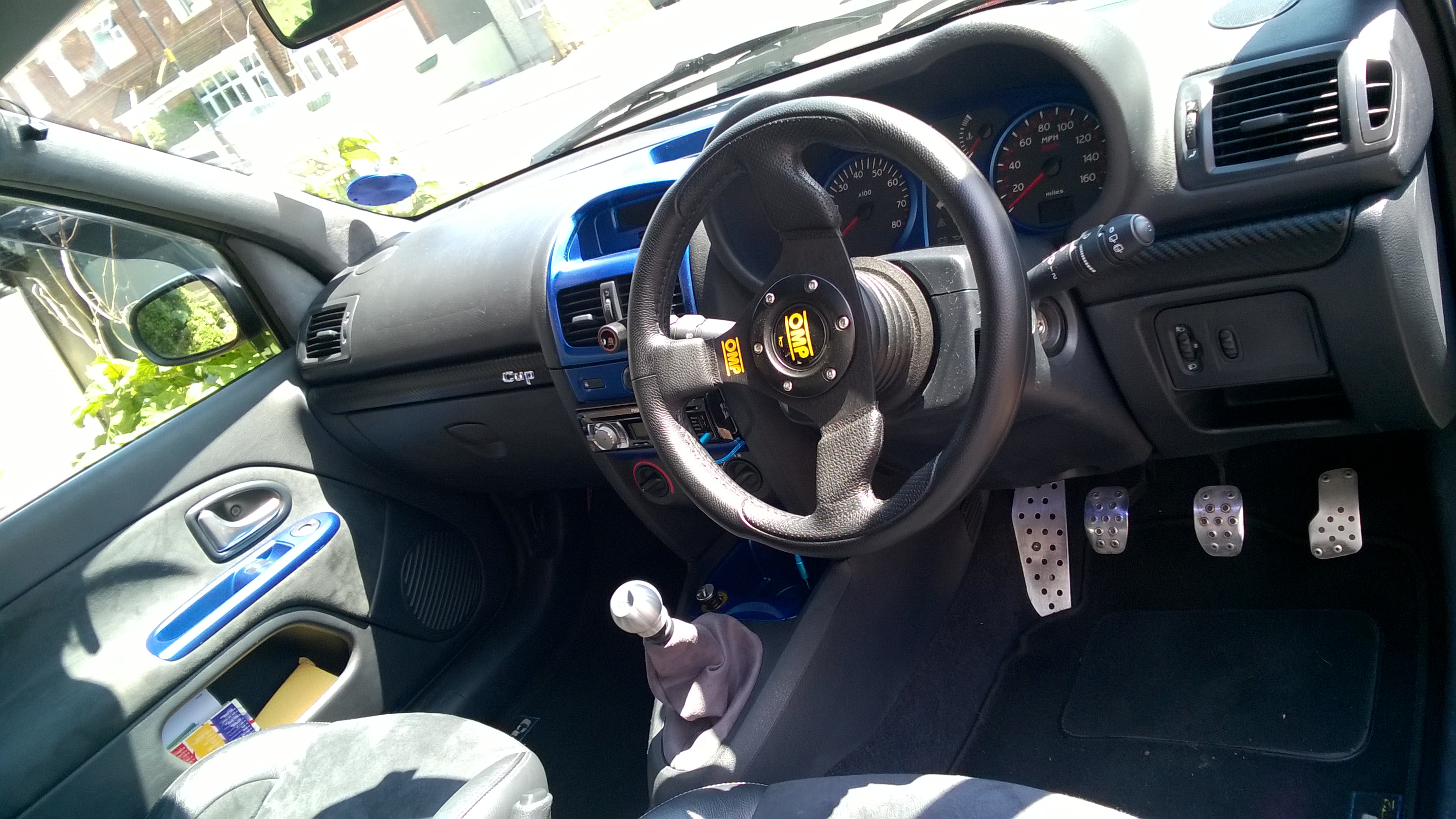

:up: looks miles better black. Really want a new wheel and gear knob in mine though:disappointed:
cheers. Wheel was £80 and knob was £25. Boss came with the car so saved £50. I do have a cheap mountney corsa d shape wheel for sale I interested! £20. Bought as a toe in the water before getting the omp. Its a bit flexy but miles better than a standard melty wheel.

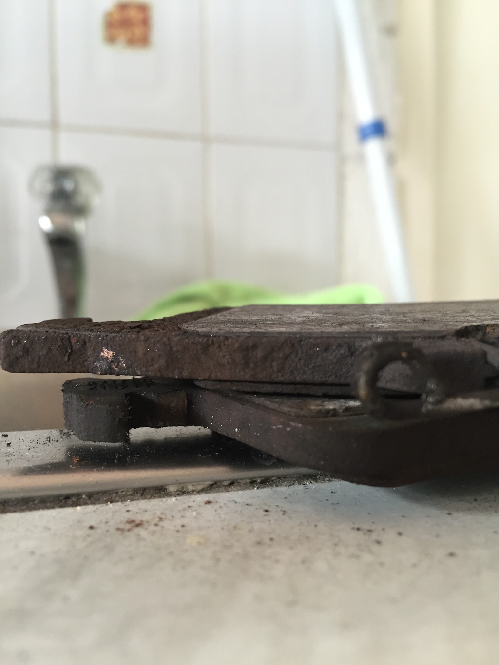

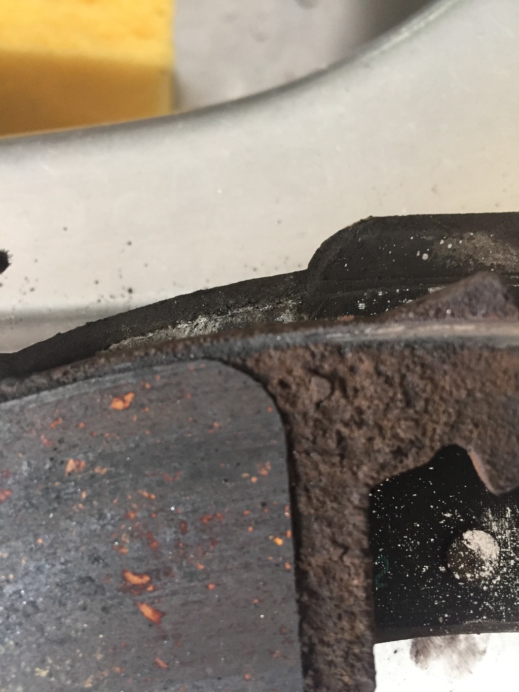

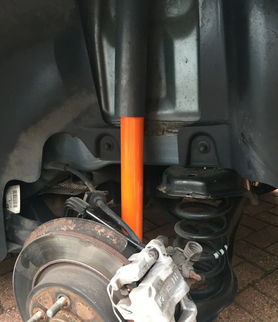

Figured out what the grinding noise was from the rear!
Oops!! lol
Managed to fit my new rear Koni STR.T shocks whilst changing them though!

@Filters That subframe looks awesome - did you get a second hand one and acid bath it and then powdercoat it? or are they available brand new?
Want to do the same.

They were cleaned up and powdercoated by the previous owner (I got what you see in this pic with the car)
I'll be sending the old one off to "Blastcoat" in wales to have done along with a few other bits and bobs.
http://www.blastcoat.net/
I'm not sure where he had them done so... @philly w where did you have these done mate?

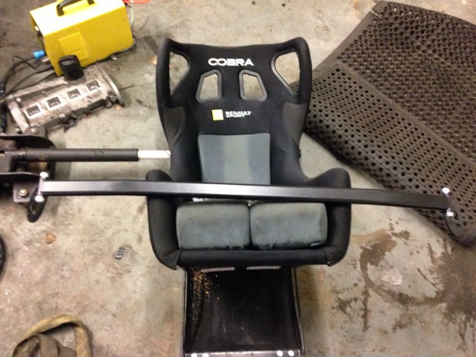

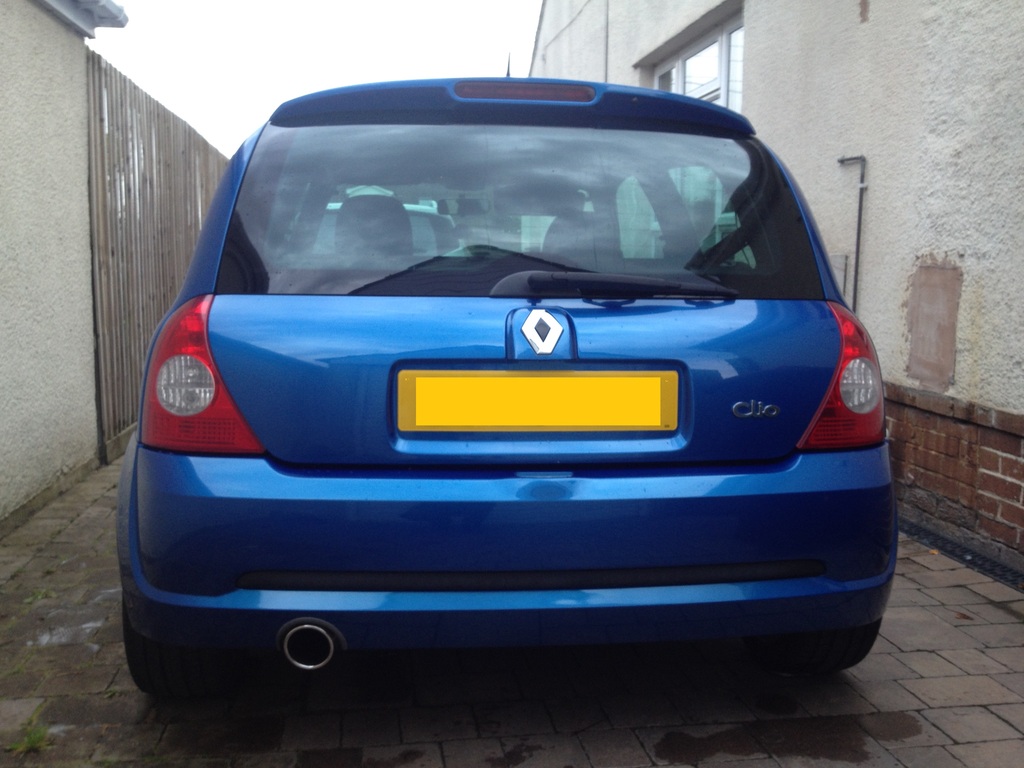

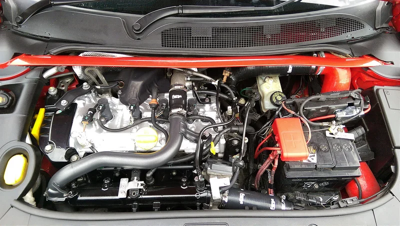

Polished my tip (oooer) and removed the renault ELF sticker as part of it had been torn off.
Purchased a PMS strut brace to go with the top mounts - sadly the seats not mine though it's made me think about seat options for track.
