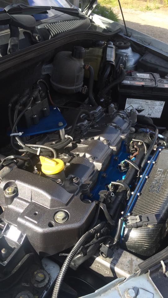

yesterday I started to paint/tidy up my engine bay, its a start lol

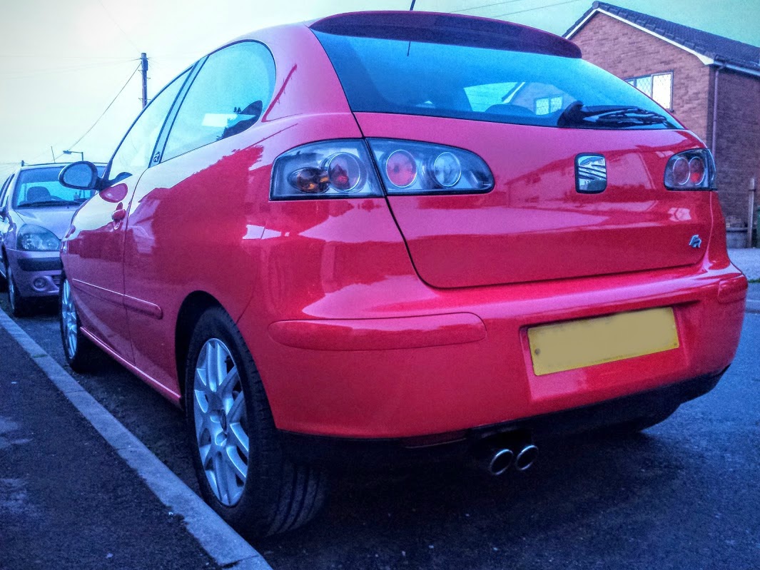

Did it yesterday but didn't get round to posting. The Ibiza has been a bit neglected since buying the Clio, so gave her a good clean and a coat of AF Tripple.

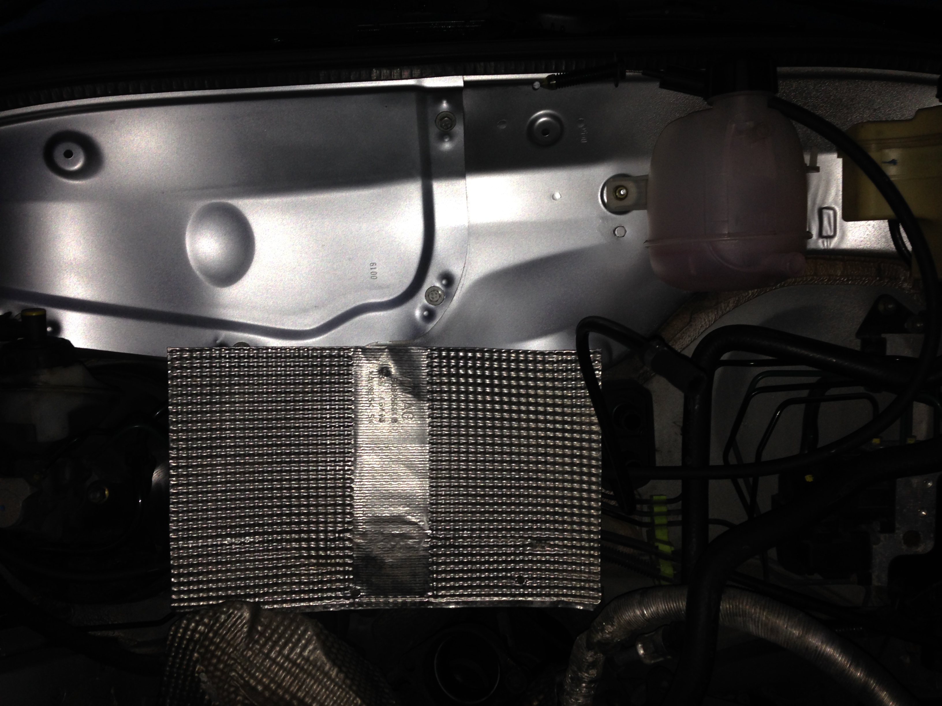

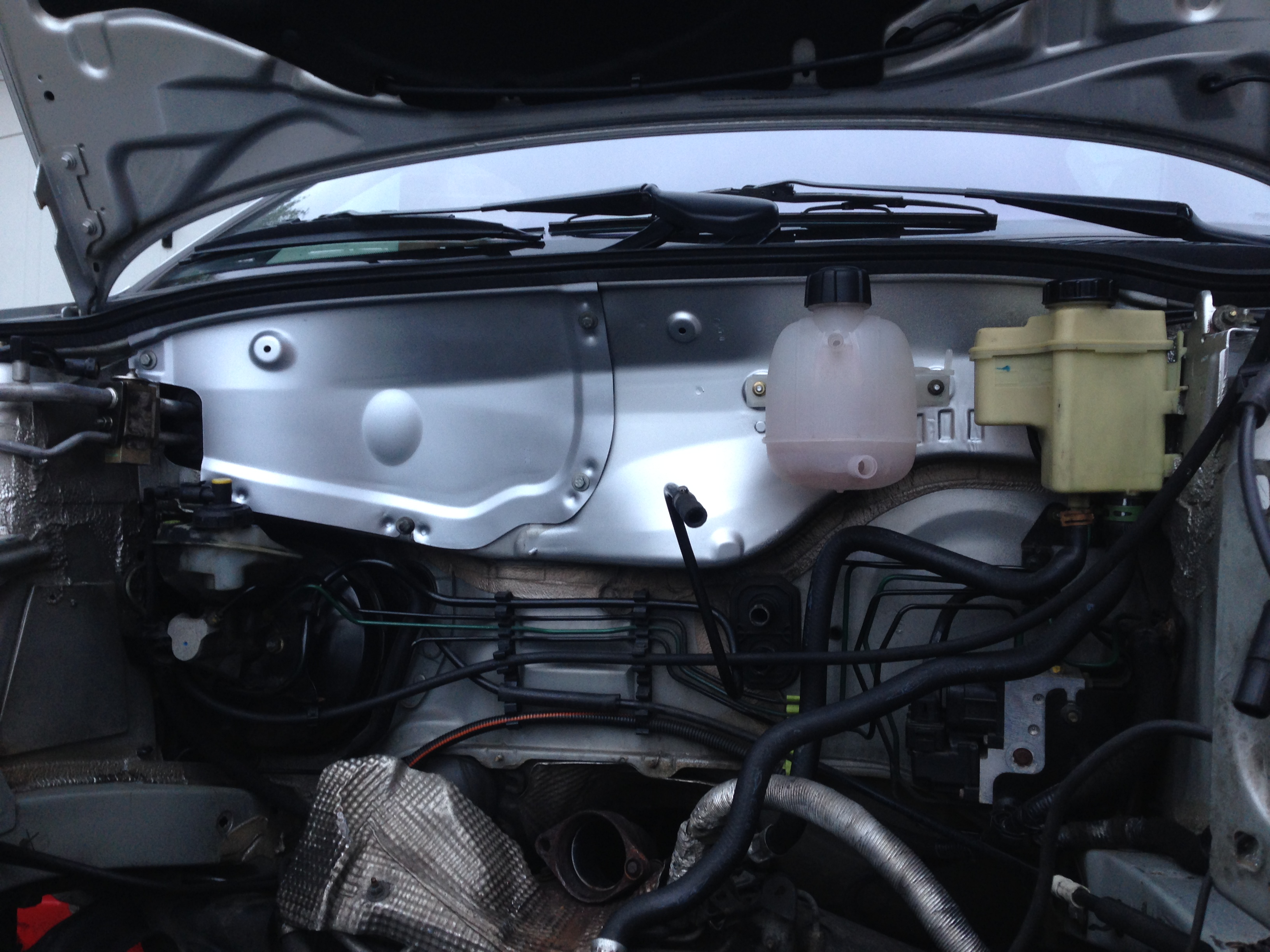

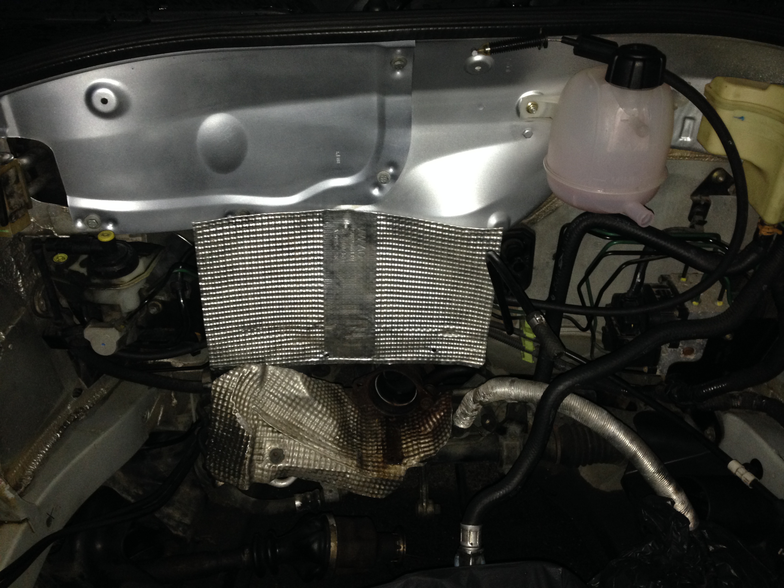

Managed to get an old bit of exhaust heatshield from a warranty job at work so thought what can I use that for ....
gonna run it without the old mangled heat proofing so figured I better have something to protect the cables etc.
Comments welcome :)

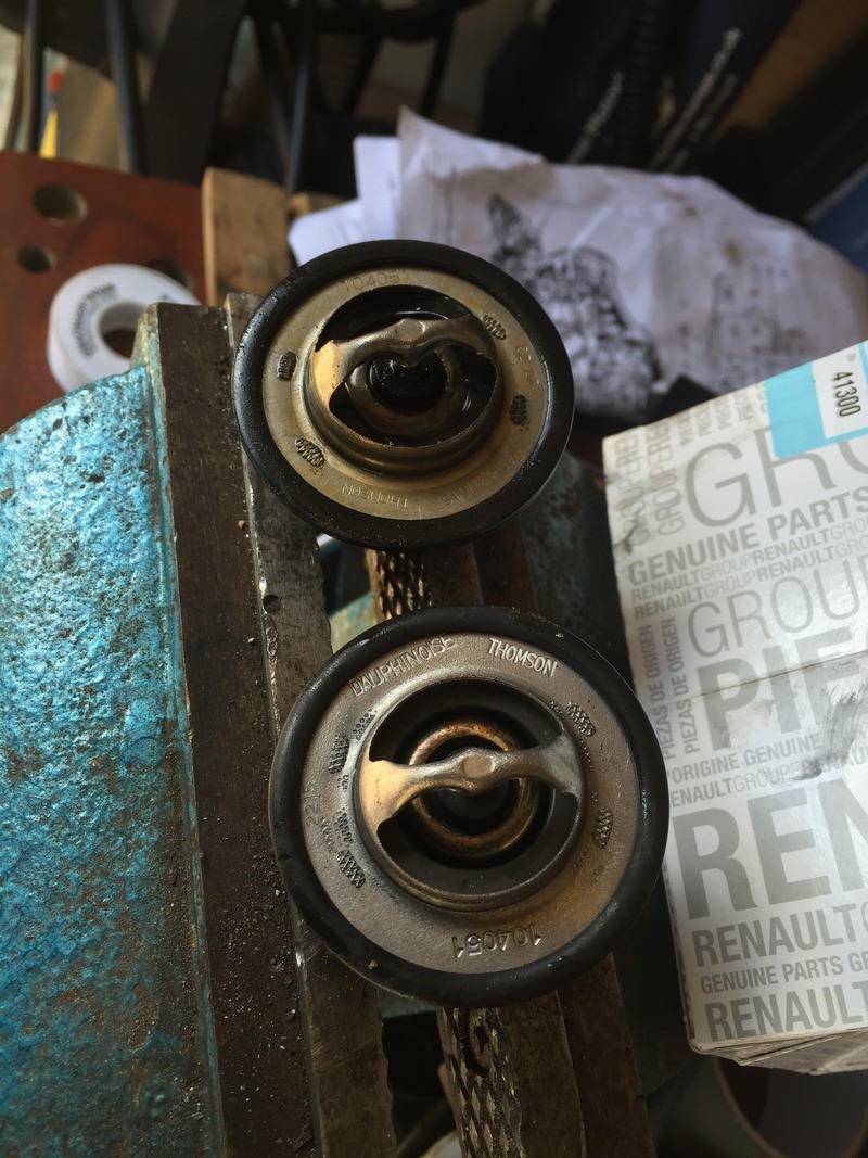

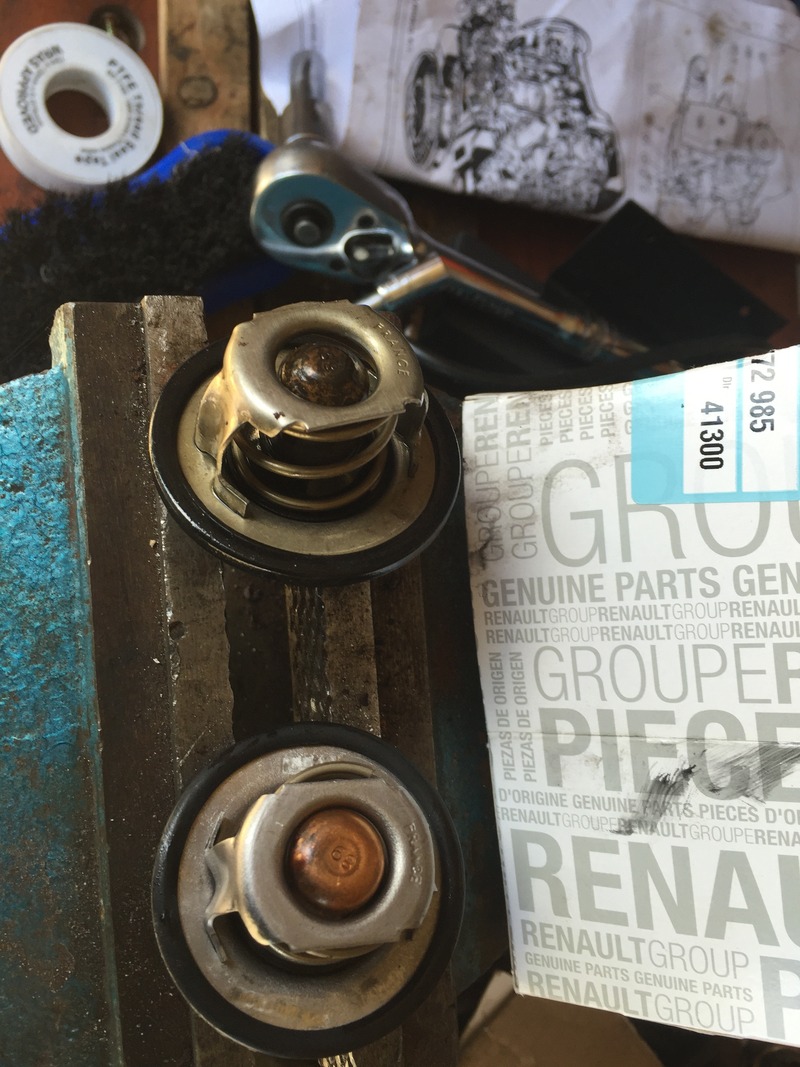

It has been a quite one for me but I have been making progress. There is less to change on the car (Steering wheel if I am picky but it is not bad by any stretch, and maybe a front end respray, but again it is not that bad especially for it being a daily and maybe the top engine mount), it is almost feeling strange!
When the car went to BTM Performance Fred commented on the car's great condition but pointed out a few things I should keep an eye on. While most of these have been taken care of the thermostat had not. He reckoned that with a new one the car would run a little smoother and be just so. With the old thermostat the gauge used to sit bang on half way, maybe go under by half a mm or go the other way, where they tend to sit (slightly above halfway). On the basis that winter is coming and there seems to be little evidence of the coolant being changed I went to Renault to purchase some Type D and a new thermostat.
Initially all looks fine:
Again, everything looks OK:

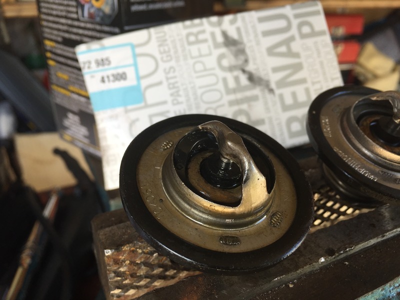

Errrr, maybe not! The inner thermostat seal had perished and split, causing one side of the seal to expand and come away.
I then filled the engine up with Type-D until coolant came out of the bleed hose when I then filled the coolant to the max and fired it up. It seemed to warm up quicker than previously and the gauge stayed just slightly above 1/2 way without budging at all! On my drive back the coolant level dropped to the minimum where I promptly topped it up once the car had cooled down. I would like to think that the level has settled and all air has come out.
Maybe it is placebo but the car was quite sharp on the throttle which I put down to the remap ; a friend of mine was not too keen about this from his 172. It does seem to be smoother than before as well. The heater is also hotter than before, handy with winter not being miles away and for those cold nights. I had had cars where the gauge does not even approach halfway!

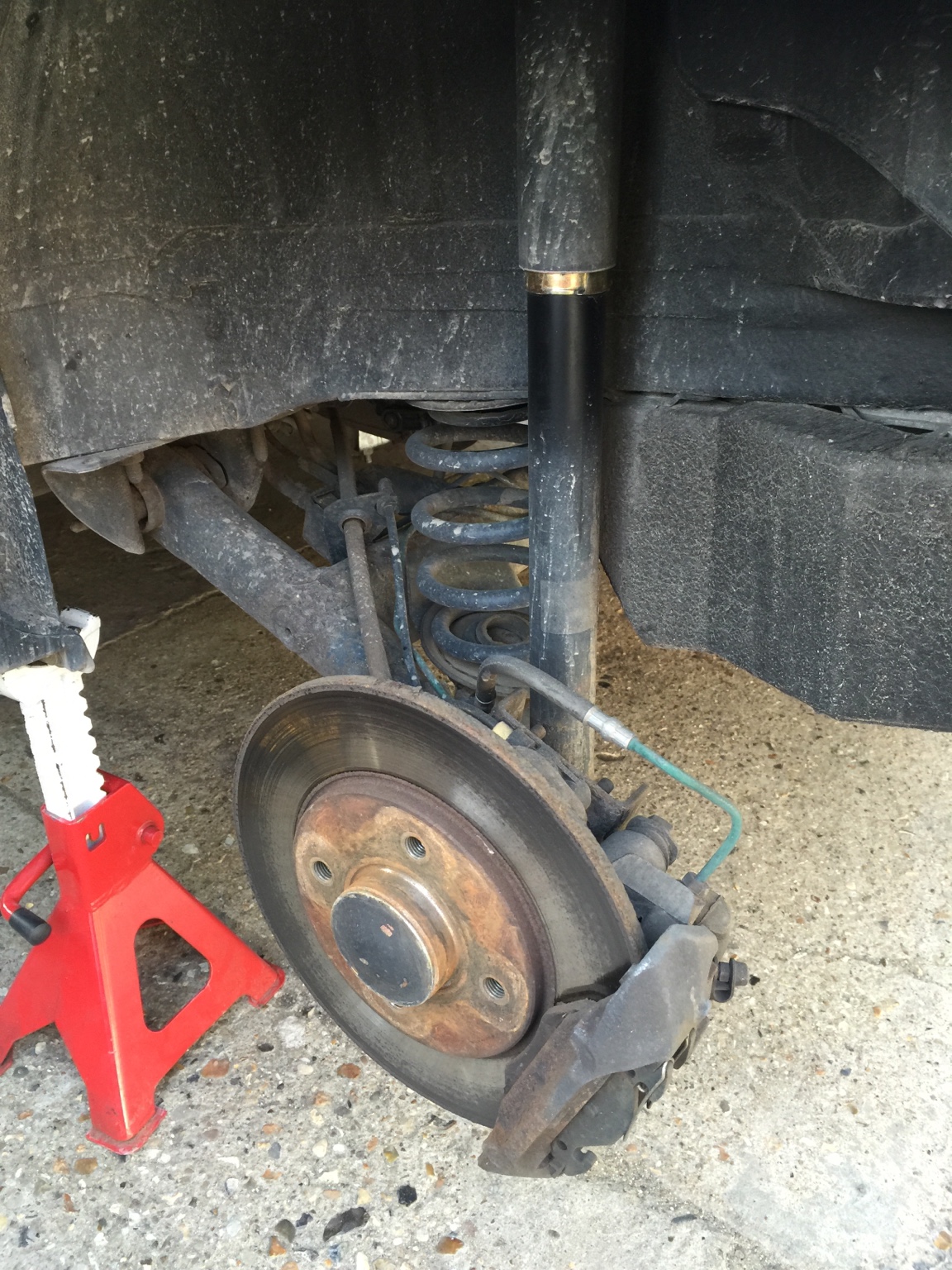

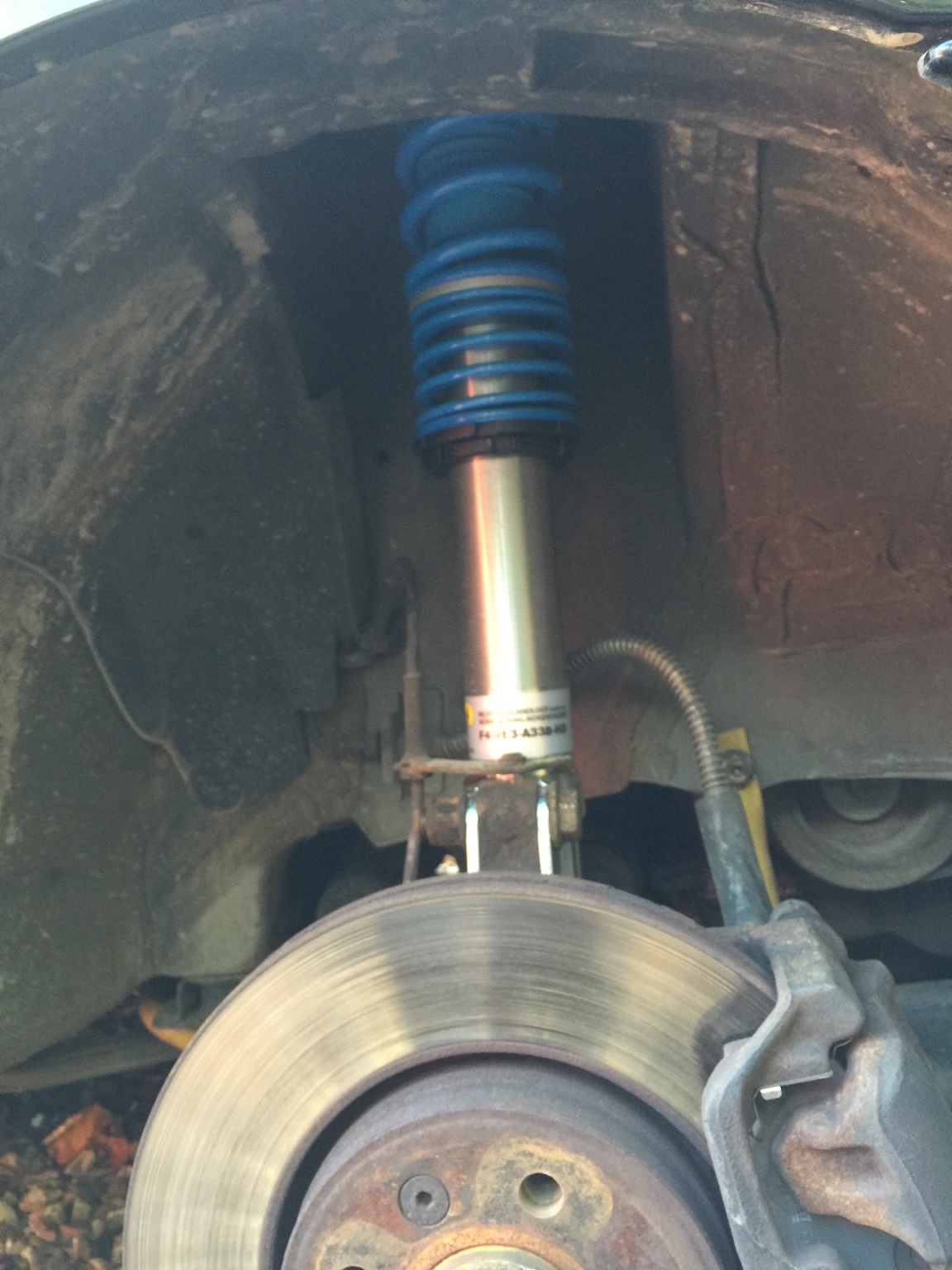

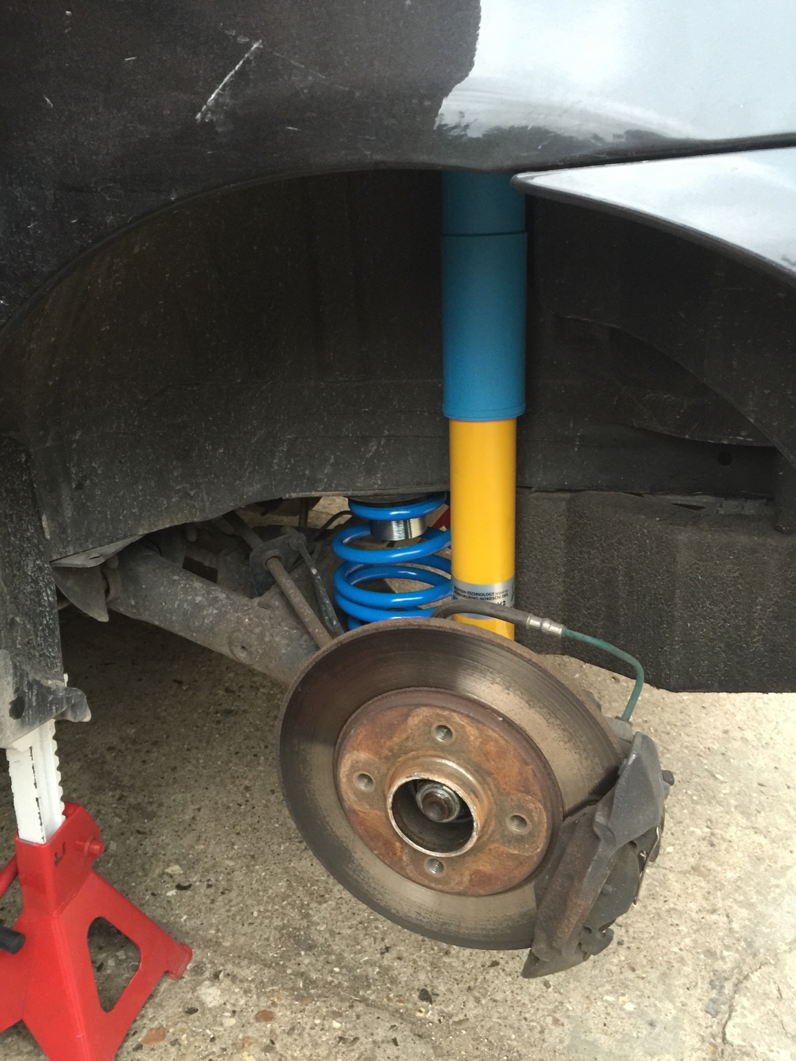

Fitted bilsteins and PMS solid top mounts
Get some grease or coilover covers on them mate. Looks great though.
If they are stainless bodies it will not be an issue at all :smile:.
How do they compare to what came off in terms of roadholding, comfort and handling? Is your car a Cup or not? I'm going with either going genuine Renault on mine next year or with the Bilsteins.

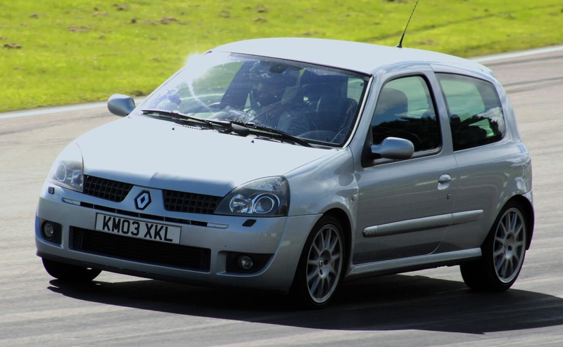

The scary thing is that I was debating taking it on a track day a week earlier! The Clio went instead and it was a joy to drive around:
I forgot to say, I was enjoying driving the RST but the caliper bolt fell out of one of the calipers. Yikes was one word to come to my mind!
Yeh it's made a huge difference mate they are pretty solid but still comfortable for the road .
Did a long motorway trip with them and made the car me so much more confident at higher speeds if you know what I mean. the the old suspension which actually got abit dodgey when going for it
Corning is also much better with no body roll etc
I don't know how old the old shocks n springs were so couldn't compare to new Renault ones as I've never had it
And the car is just a standard 172
I'm going to try get some covers for the coilovers as a lot of dirt and grit is getting in them and all up the thread which made it hard to adjust them without cleaning them first.
But I definitely recommend them

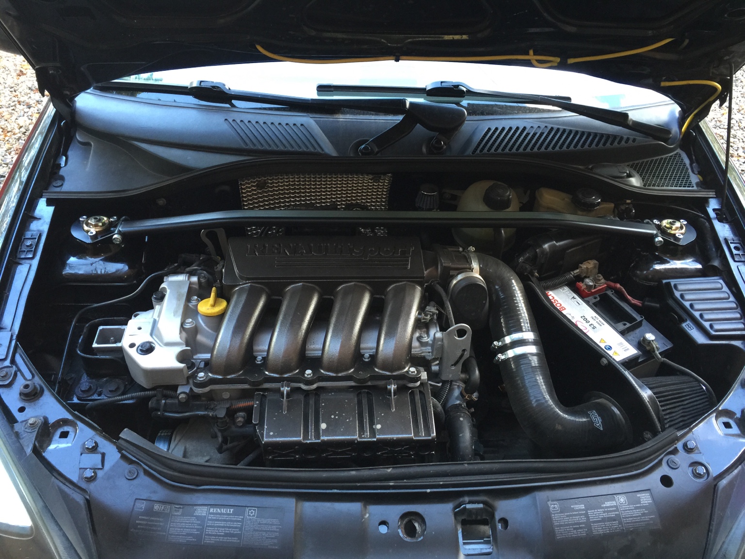

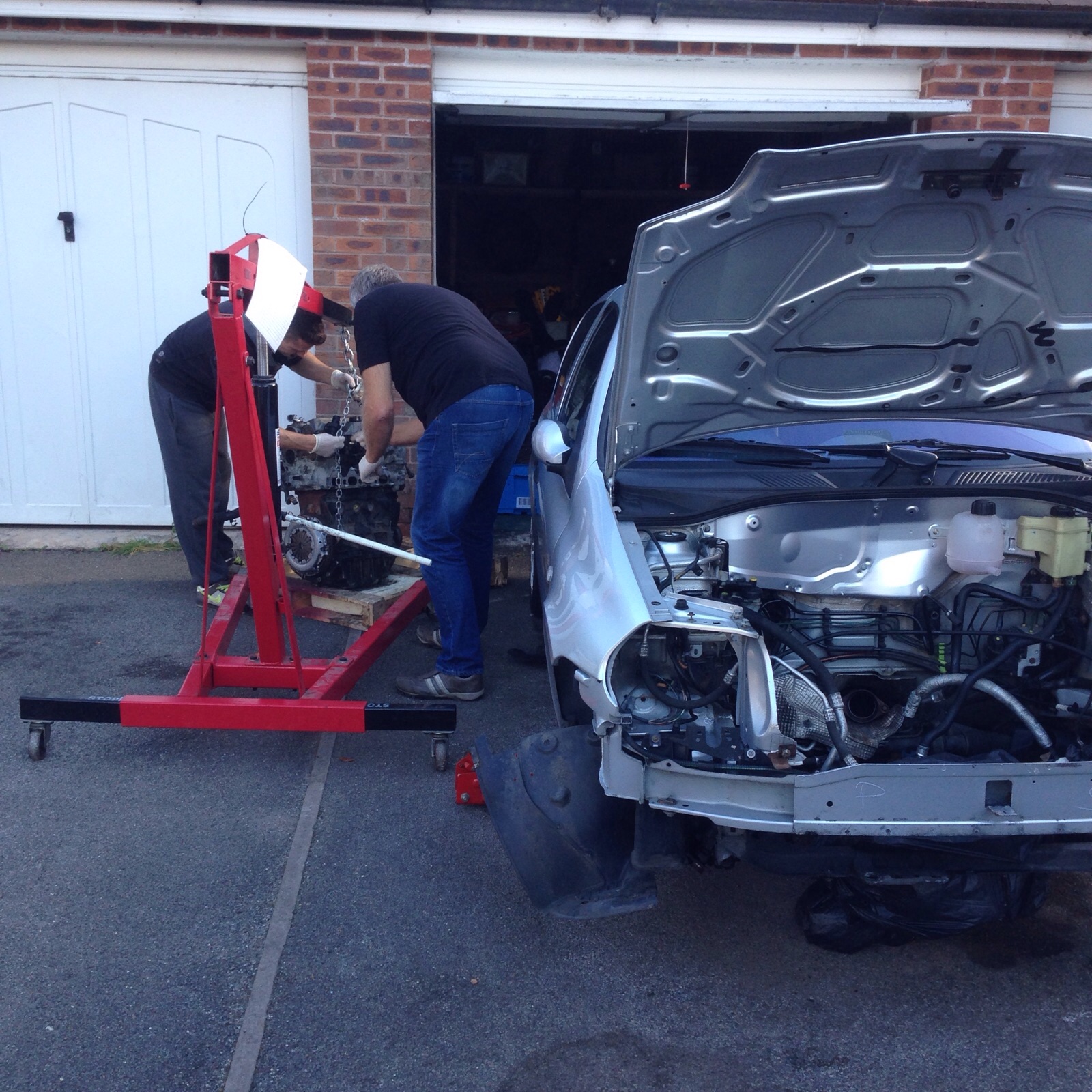

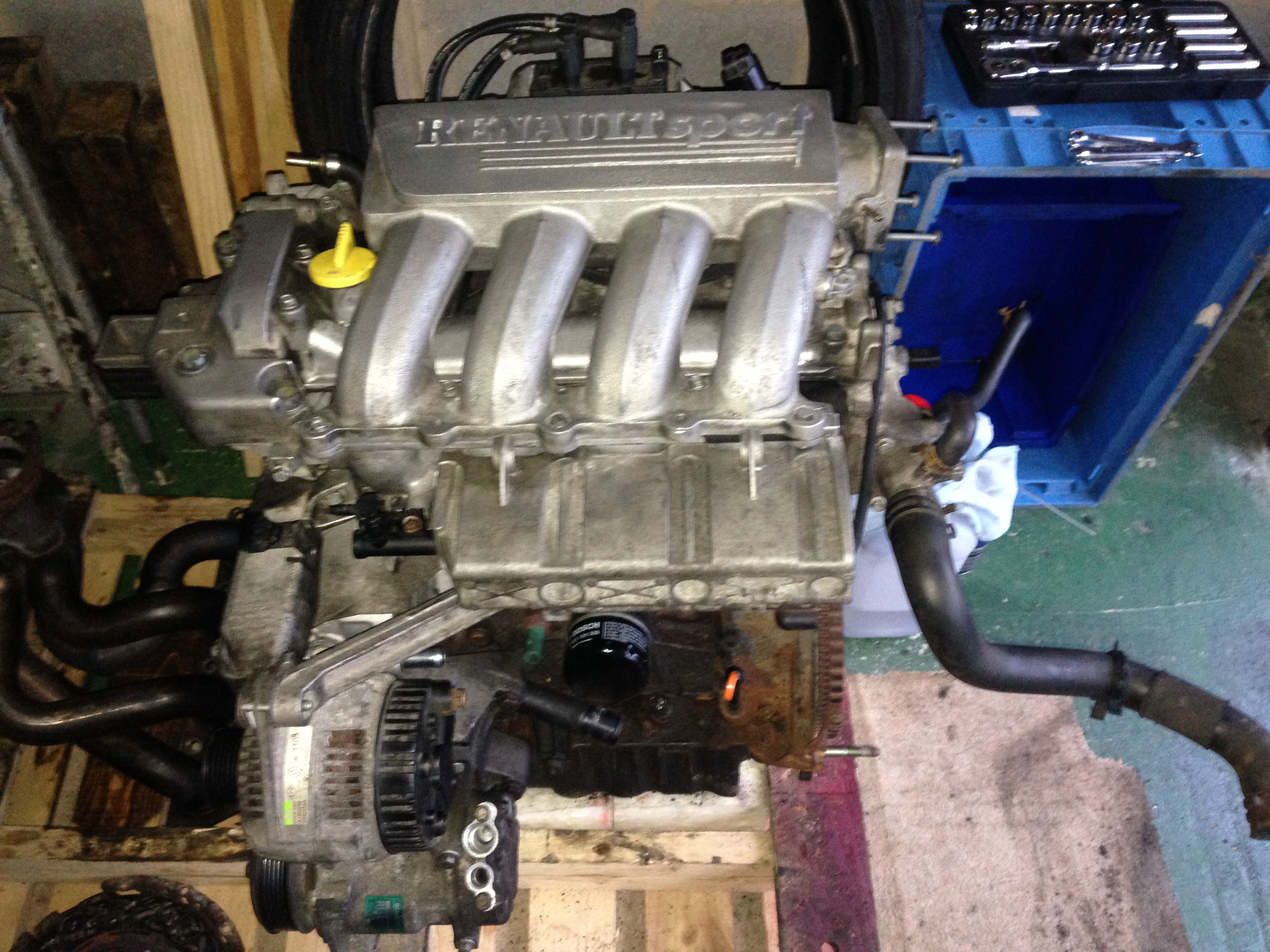

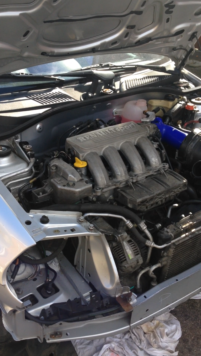

A very long weekend spent dropping the engine in and getting it up and running ...
Only to find the radiator sprung a leak so had to drain it again ready for a new rad
Still Im happy its good progress made and sounds pretty sweet running which is a big rerelief :-D
