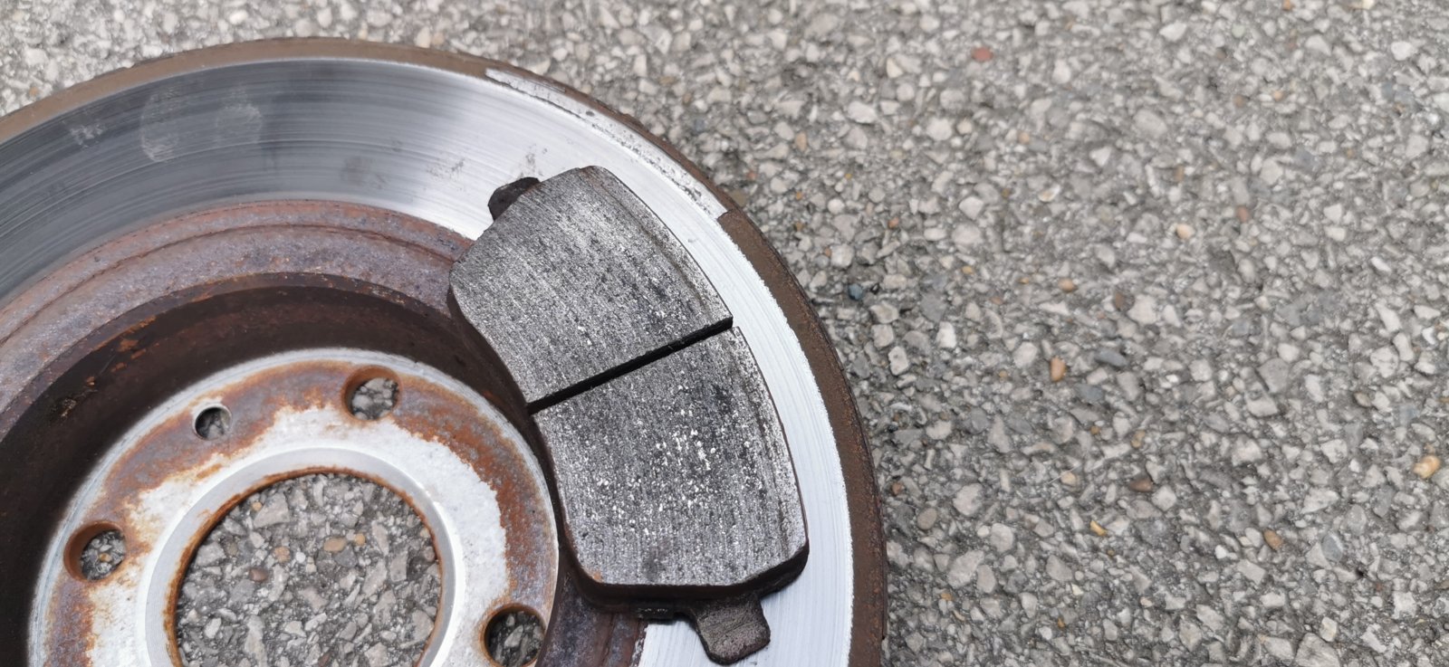

Changed the front discs and pads on the wife's car after 7 months of being fucked about by the garage that fitted the noisiest pads ever to a shopping car. If these start to squeal it's going in the river.
Old fucked ones, I'm guessing they didn't bother to check for any lip on the disc as both inner pads had a big step on the outer edge.

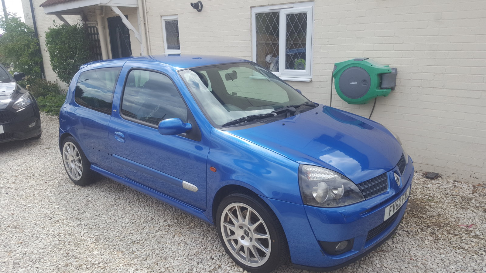

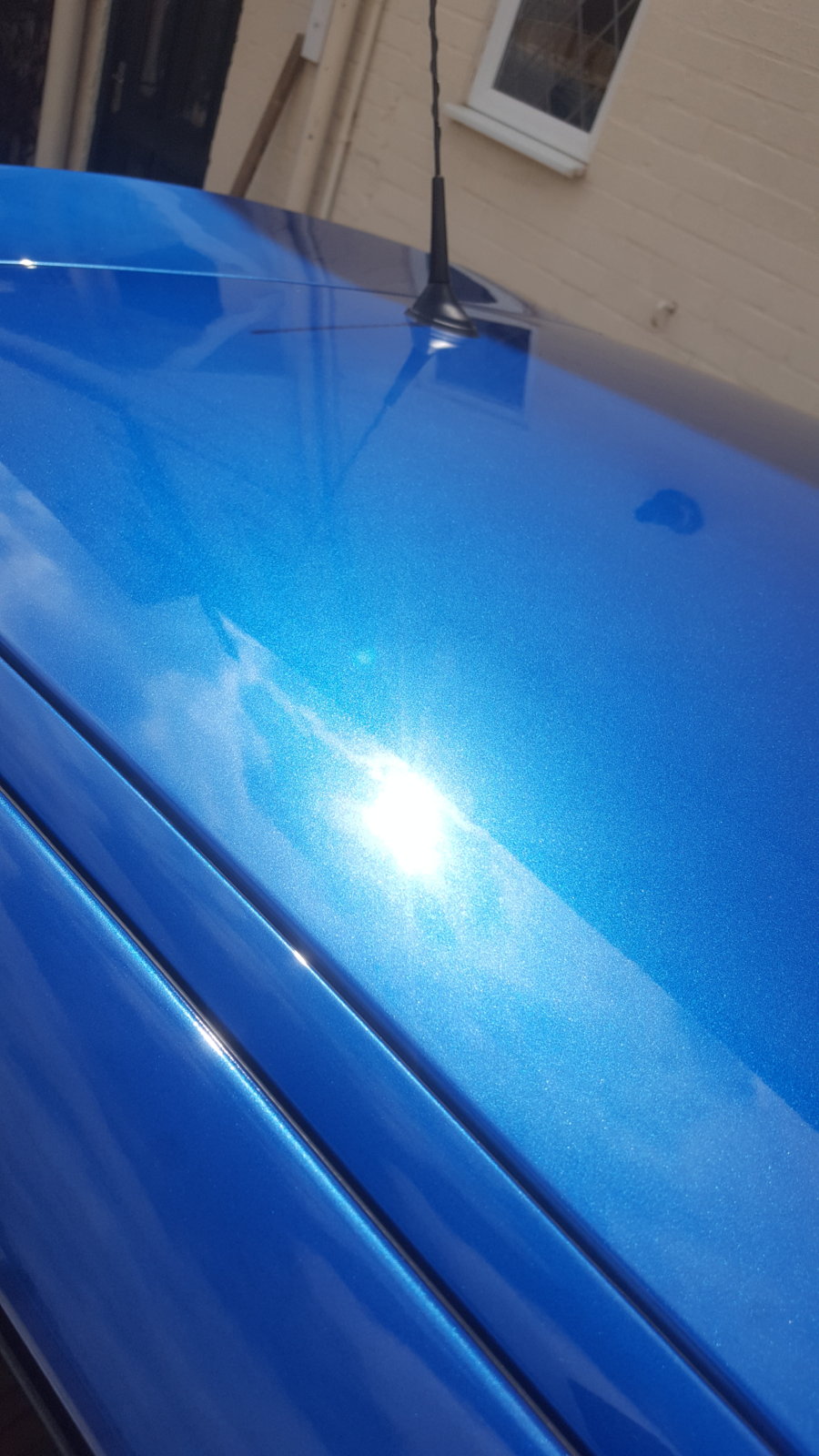

Gave the Cup a much needed bath. Was going to give it a proper going over with the machine polisher but patchy rain put paid to that. It really is in need of some paintwork correction.
Ended up using some old Jeffs Werkstat stuff I had kicking about instead.

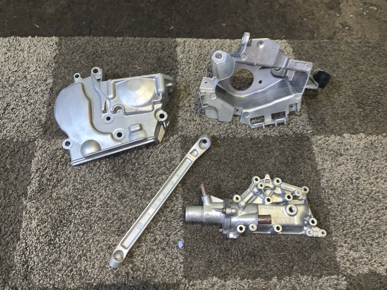

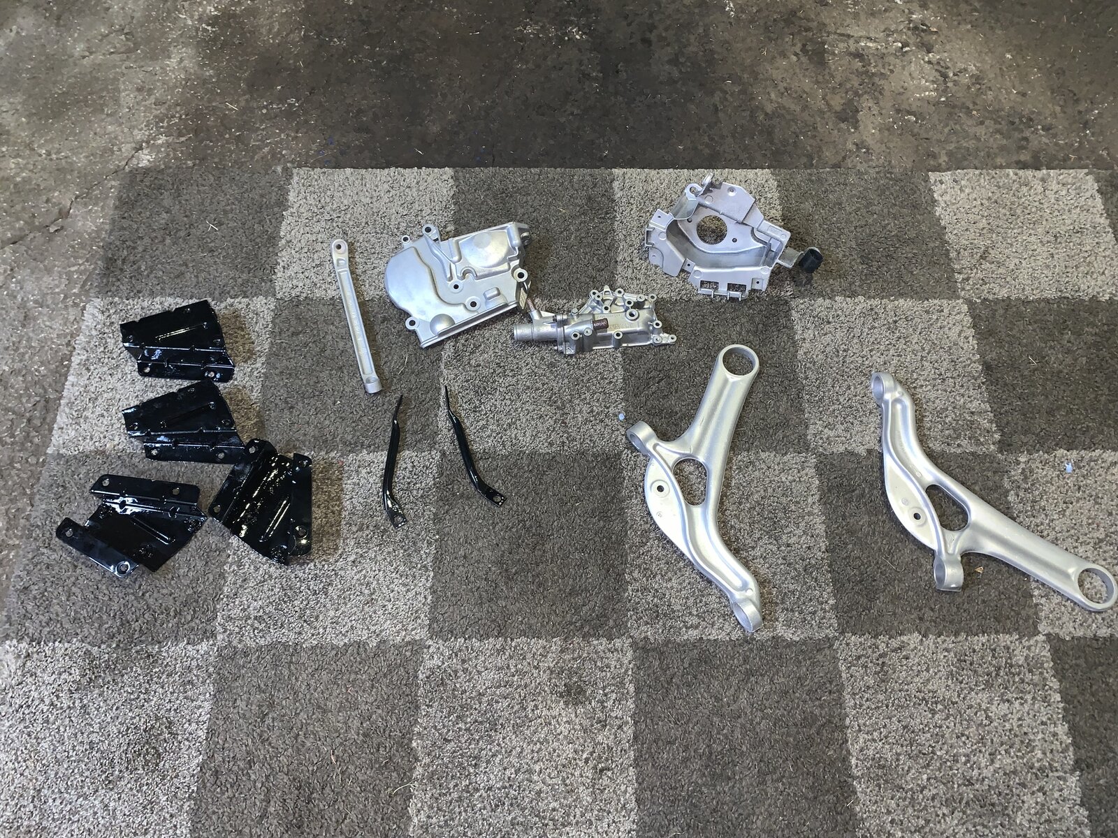

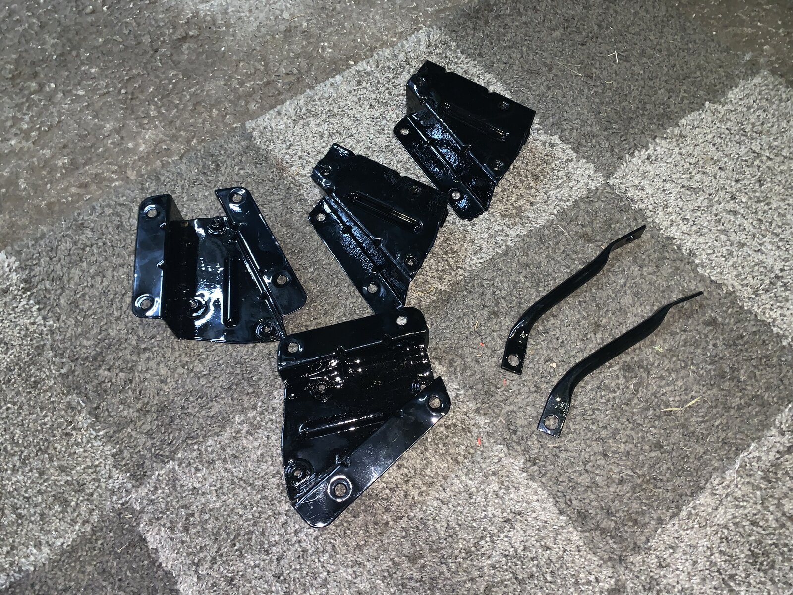

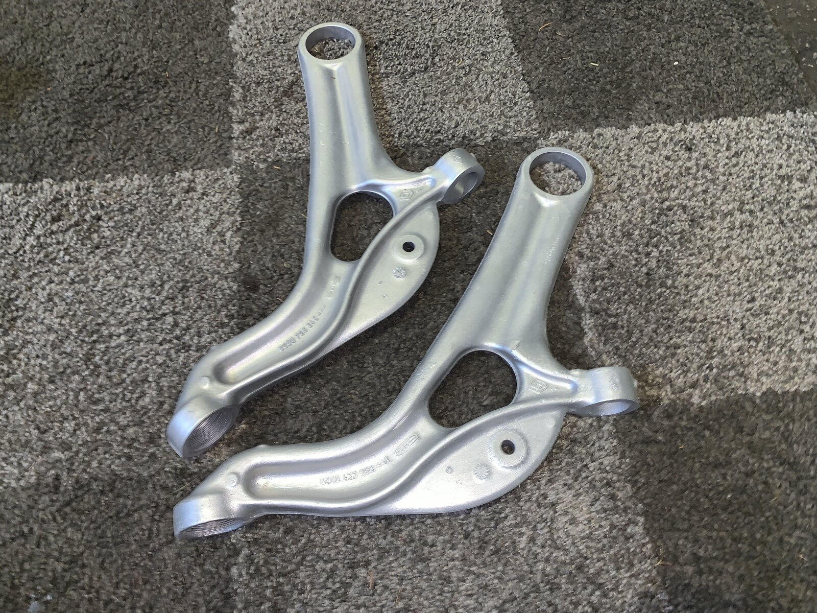

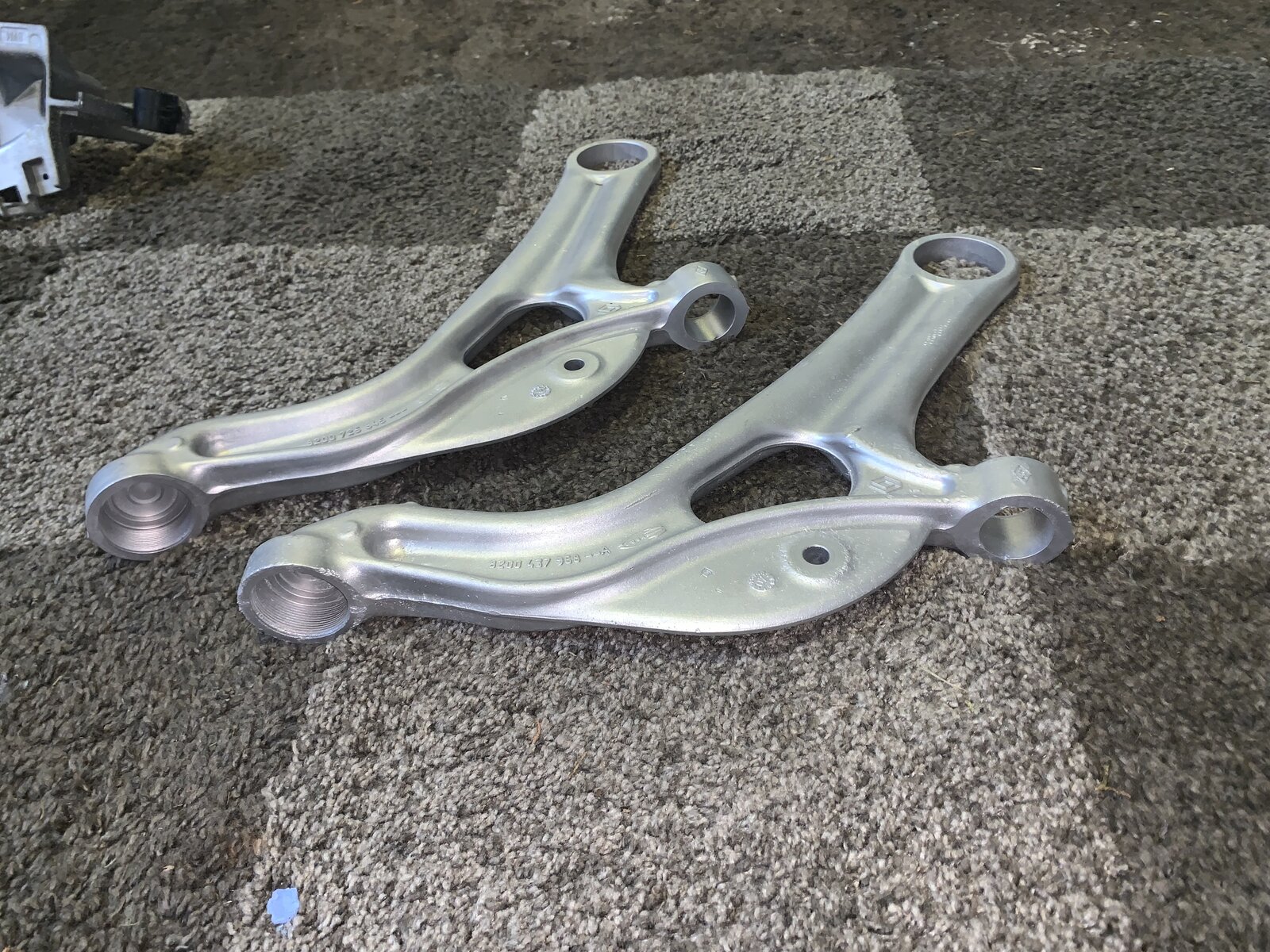

Collected from parts for the Trophy & The 197.
Still got more parts to get done and collected also.
197 bottom arms, Cam Cover & some other parts vapour blasted.
2 pairs of exhaust hangers blasted and powder coated black with subframe bars.

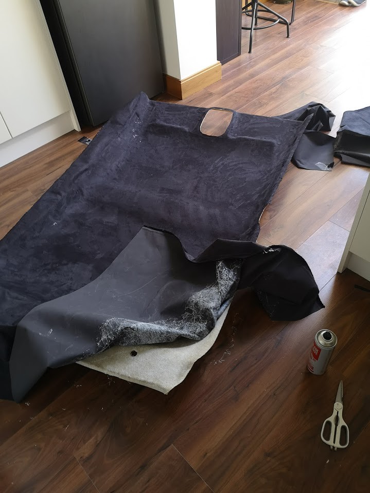

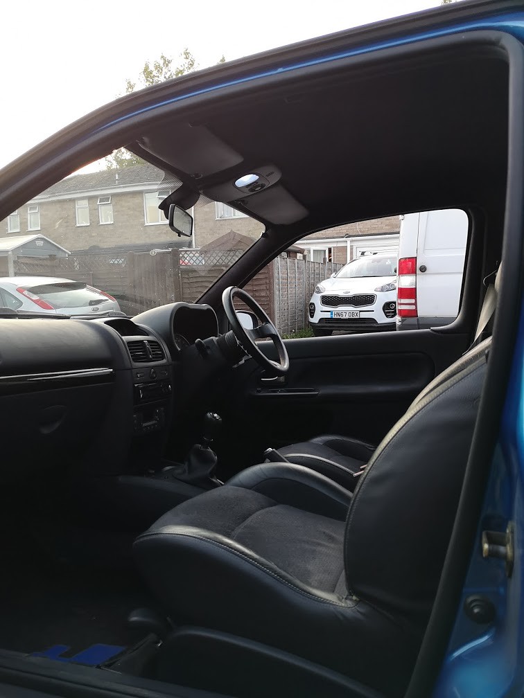

Finished retrimming/painting my headlining/handles etc, fitted front camber bolts, did alignment, new top mounts, new lca's, gave it a service.
Pretty chuffed with how the headlining came out.
Nice, got anymore pics of the headlining and trims? What did you retrim them with?
Only this one, I can get some more later. I bought 3m of 1.5m wide suede off Ebay and some trimfix. I have done a few cars in the past that I used to own, always prefer darker coloured headlinings. I painted the handles, sun visors and light surround with Halfords satin black paint, with some plastic primer underneath.
I do prefer black headlining etc. Always liked that in my old Golfs.
Looks a good job you’ve done there 👍🏻

Did you glue the headlining back in or just rely on the grab handles etc to hold it up, I did the latter but my redo it as it's a bit loose feeling

No, I pulled the headlining out on a hot day and all the glue came with it, wasn't really doing much and only a small amount was on there. Seems solid where I've put it back in, didn't see any need. I reckon they used to stick them to the roof during assembly to make putting the rest of the interior back in.
