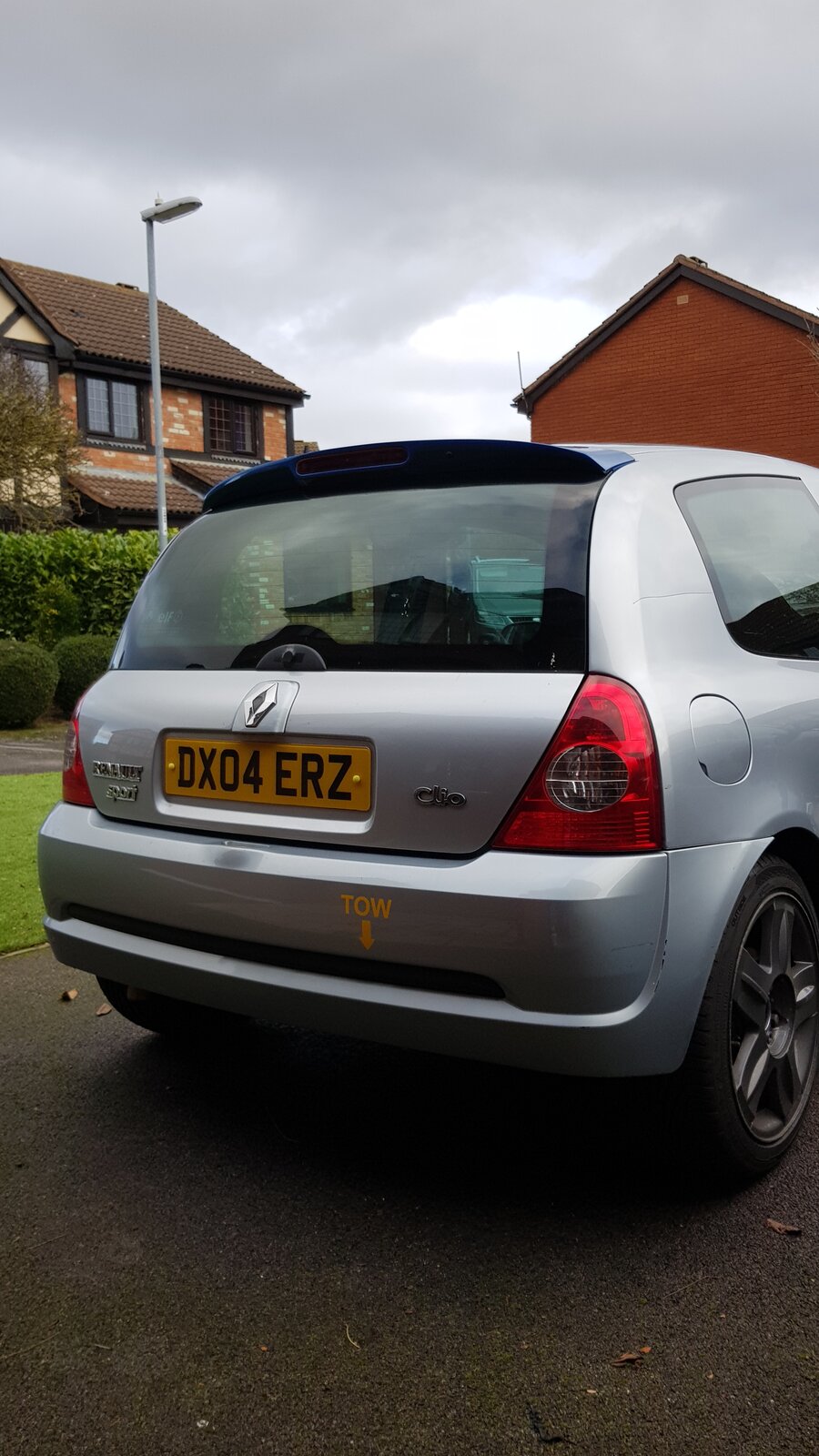

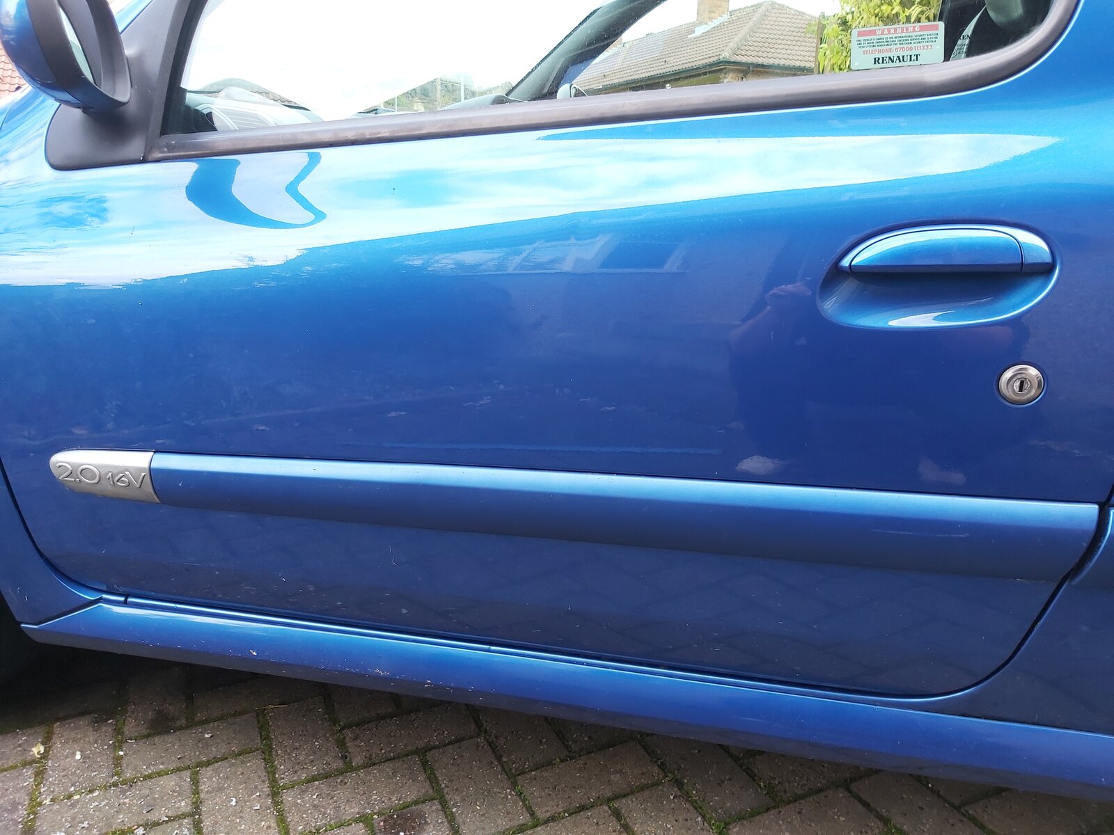

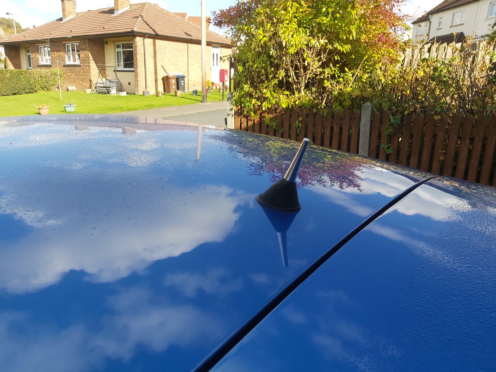

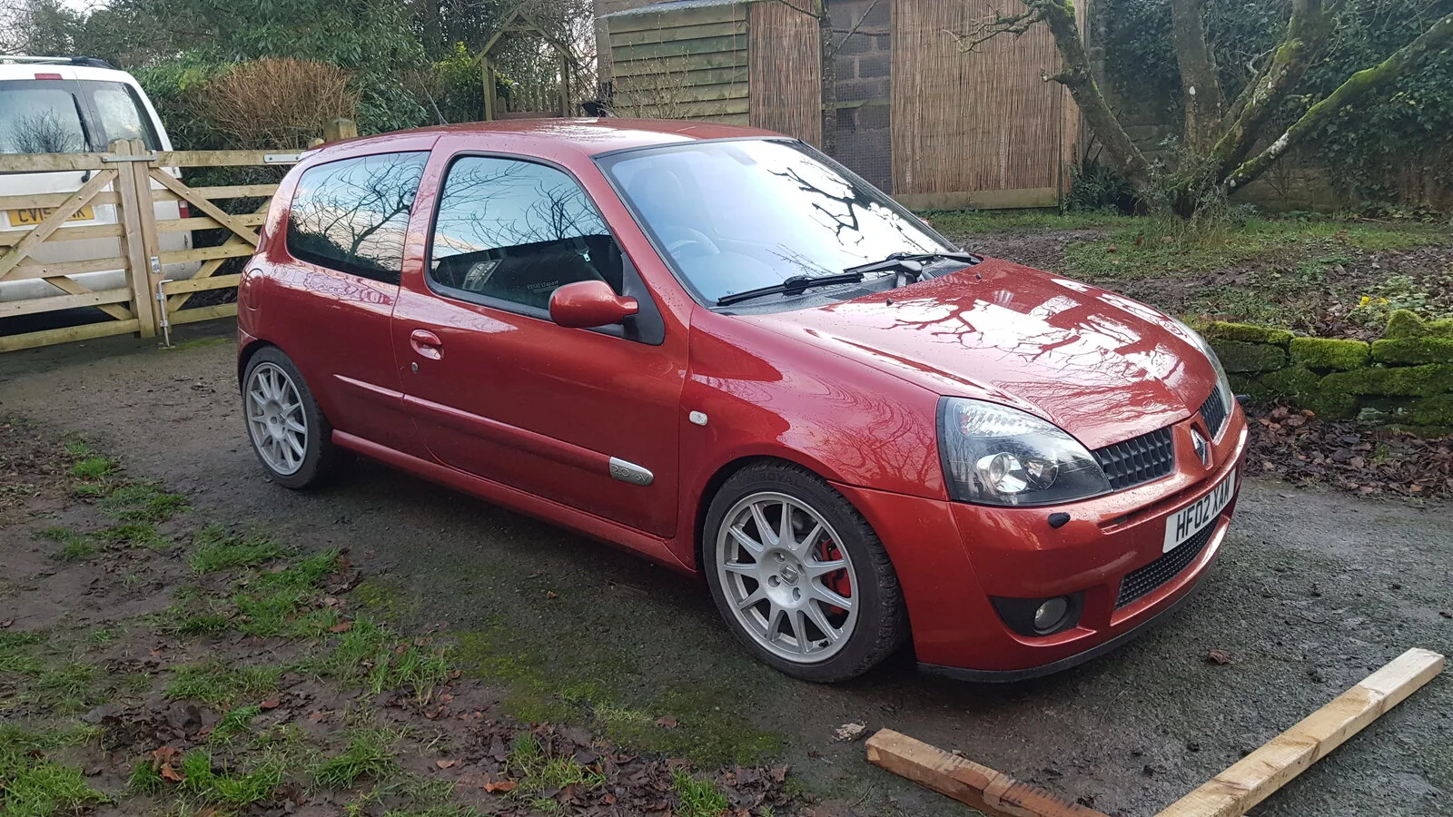

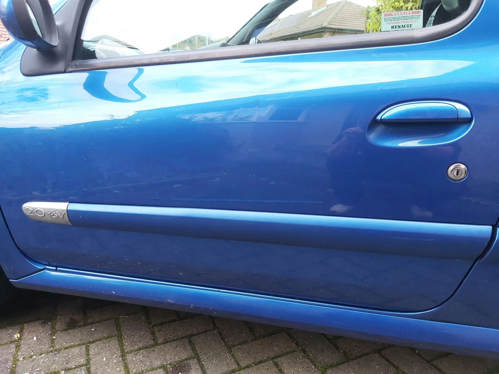

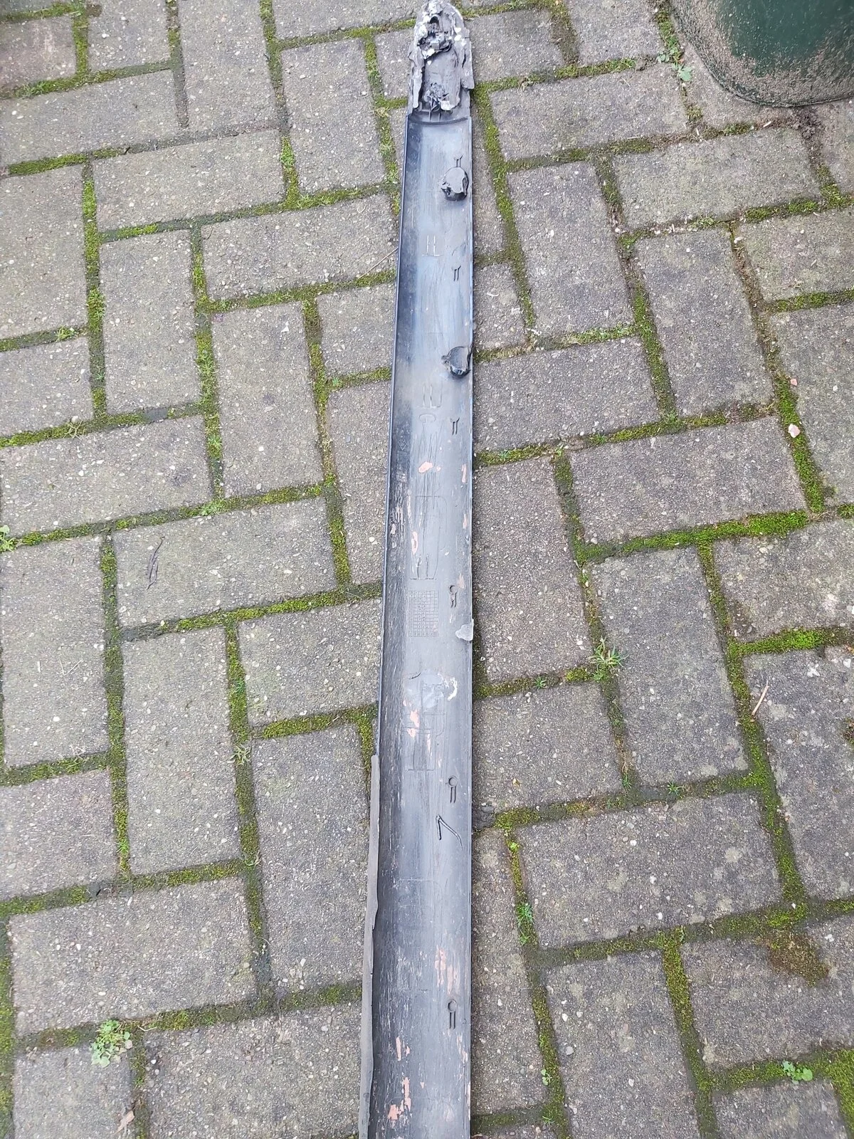

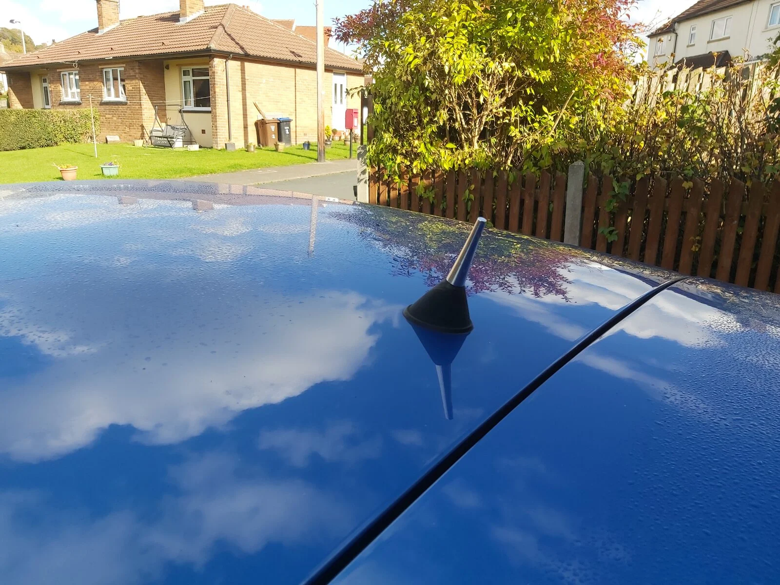

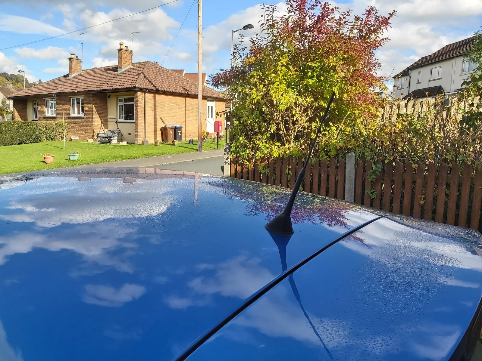

First Job was to sign up as a paid member, secondly I wanted to change the silver bee sting aerial for a standard (shorter) black one.

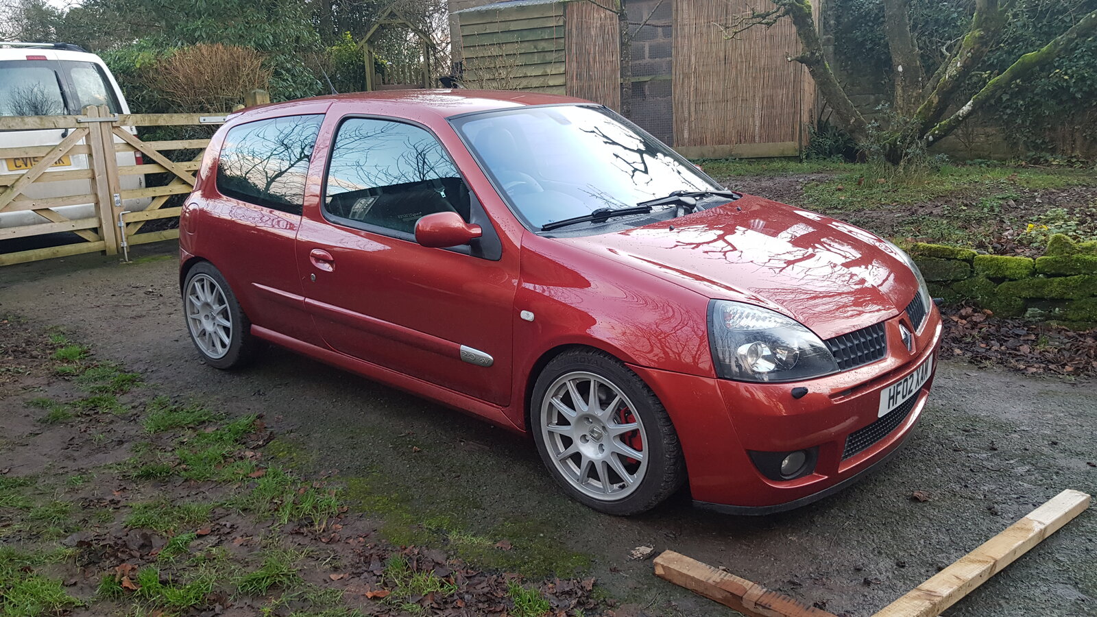

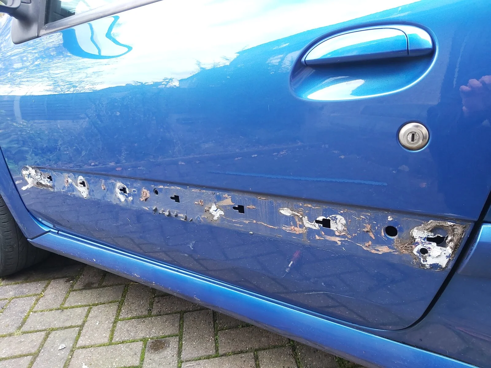

And finally the bullet badges had been painted black, which were peeling. Upon removing the N/s bullet badge I found it had been held on with some putty adhesive, after closer inspection and when attempting to remove the bullet the whole side rub strip was peeling away. It became apparent that that too was held on with strong adhesive.
Onto ebay I went to source some standard silver bullet badges and a mondial blue N/S rub strip.
After an hour or so of peeling,scrubbing and prodding I managed to remove all the adhesive putty and sand the area down. On with the side strip and bullet badge. And back to standard! :)

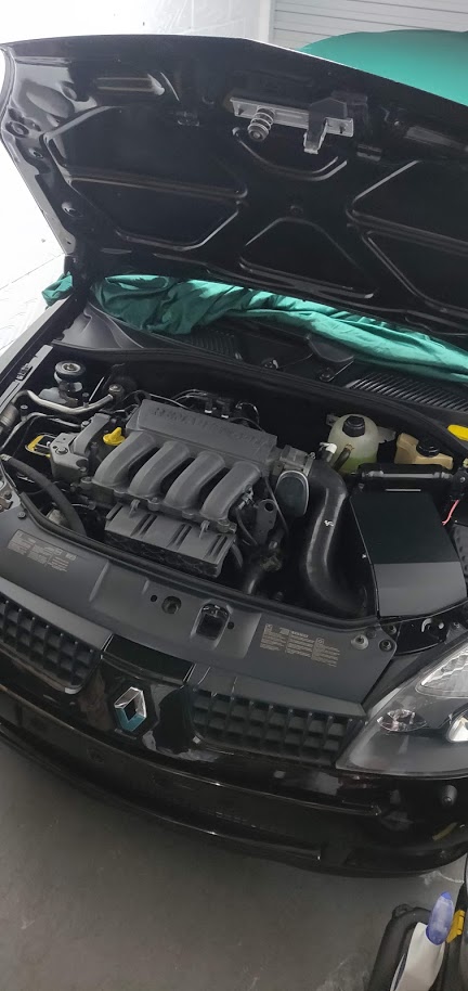

Engine bay tidied up - bonnet catch rust treated and resprayed & replaced the upper engine mount as it was a bit rusty (3 years old).

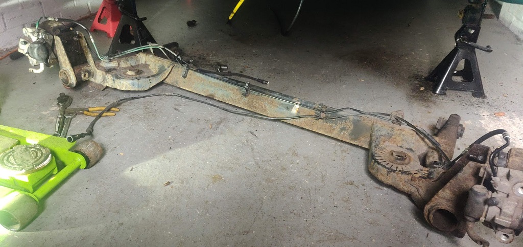

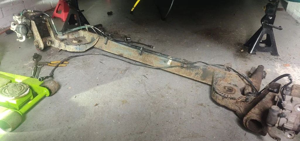

Then onto the rear beam in preparation for a PMS anti-rollbar and new bushes (the last ones to be updated on the car).
Rear beam dropped and now off with the powdercoaters -

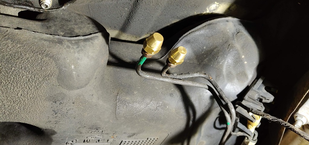

Useful little brake line blanks -

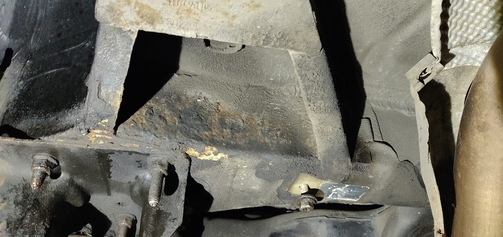

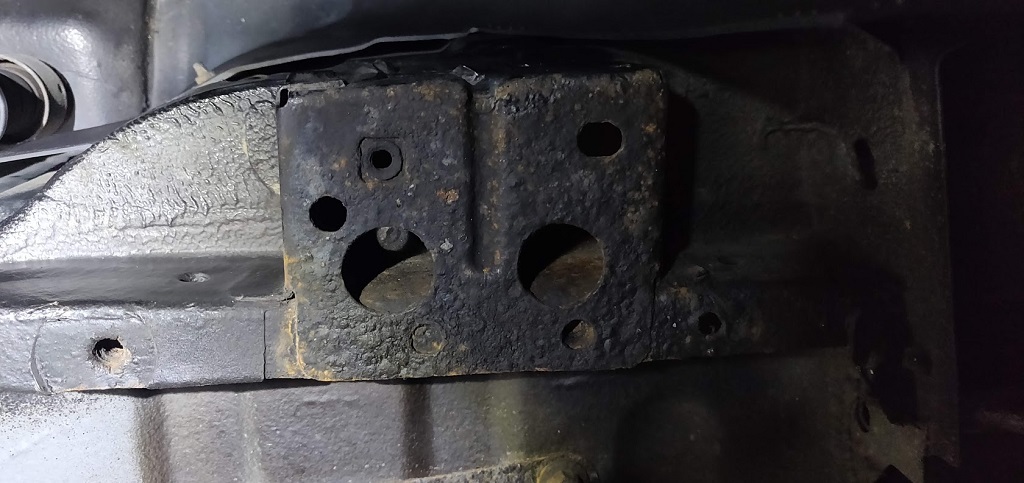

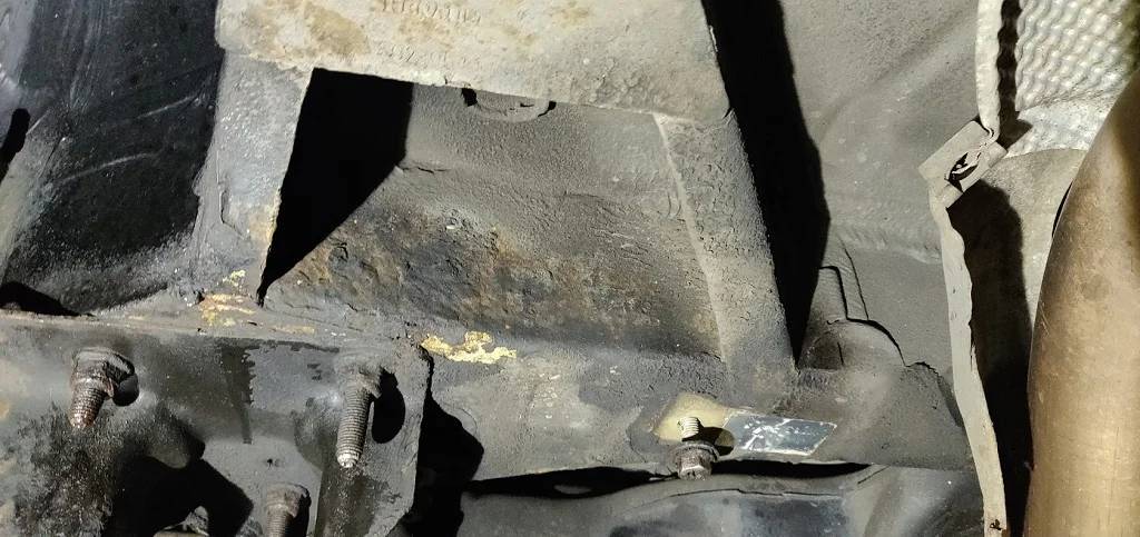

With good access to the rear of the car I decided it was now a good time to look for and treat any surface corrosion -

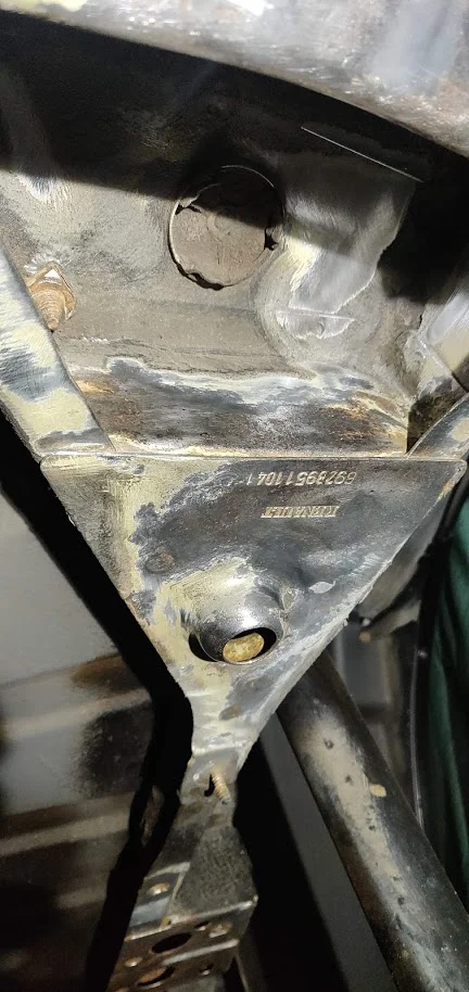

Grinded back, this is where the rear springs meet the body -

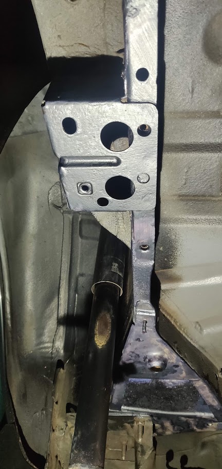

Treated with Hydate 80 and ready for undersealing -

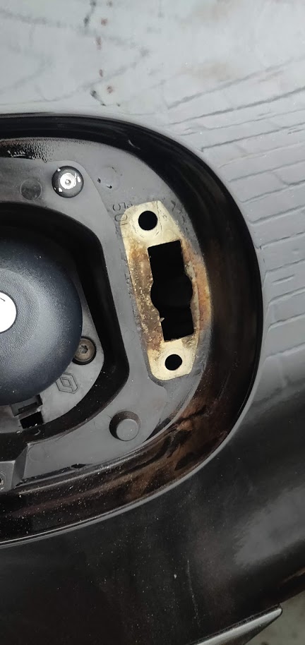

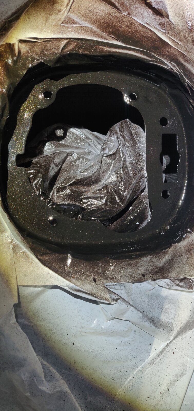

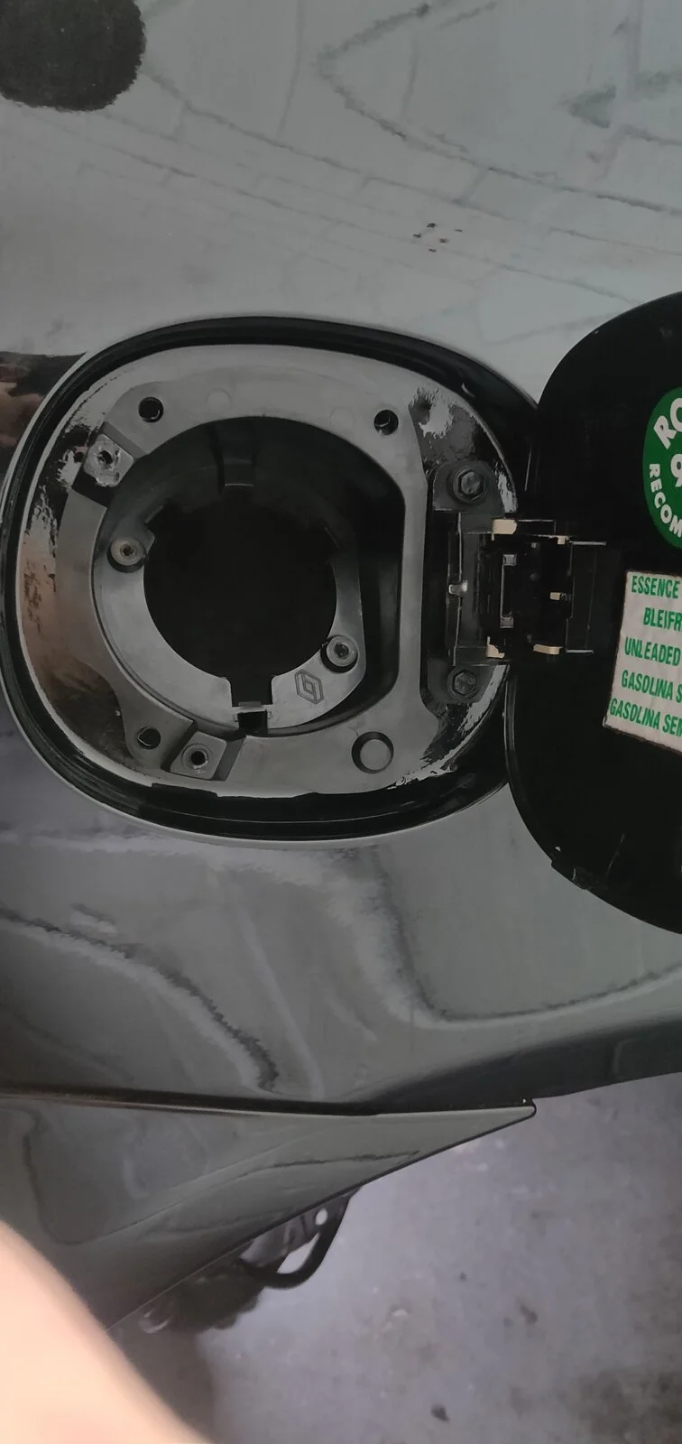

Fuel door removed (and now the fuel cap etc), only a little rust but on the list to treat before putting the rear beam back on -

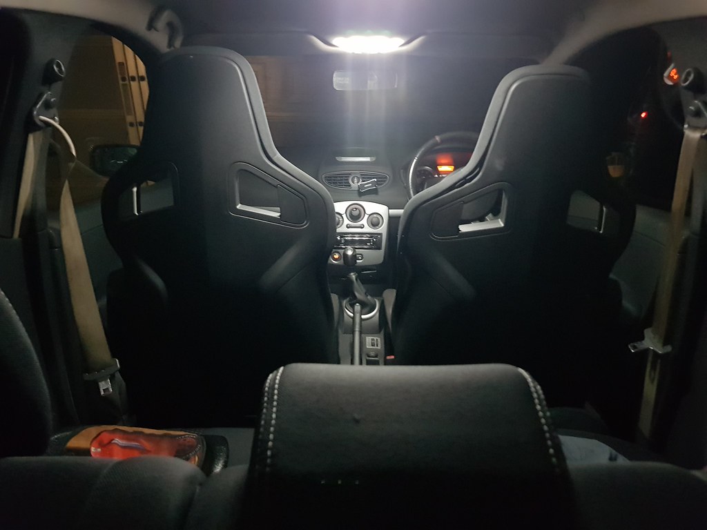

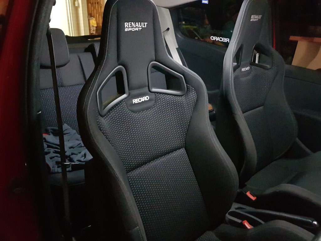

Debobbled my replacement seats for my 172, 180 grit sandpaper does an amazing job if brushed over it carefully followed by a bic razor

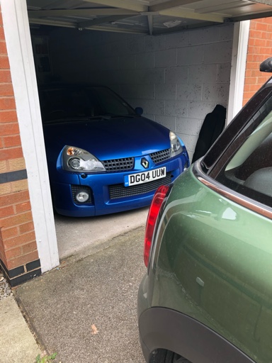

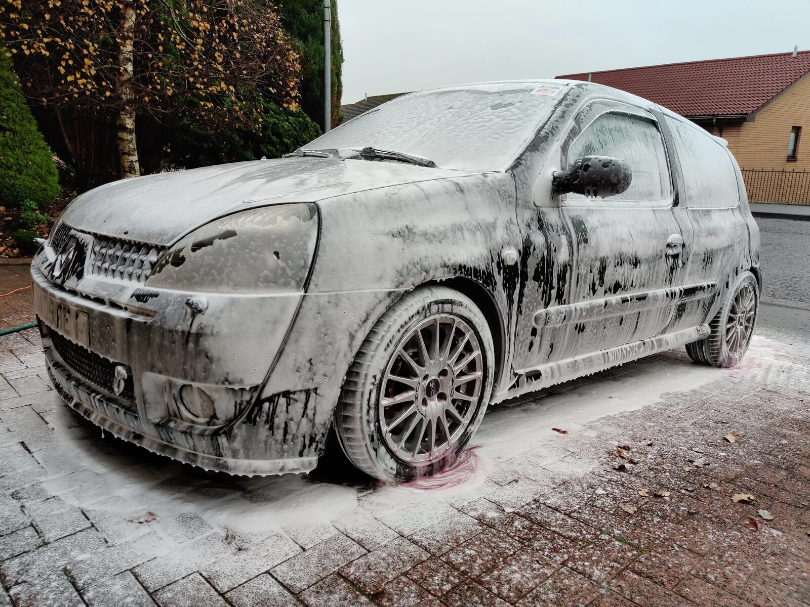

I would really like to say something different but one again.
Opened the door, Switched the light on, Had a look and then went and and messed about with something else.
Foamed it, blasted it and left washing it for another weekend

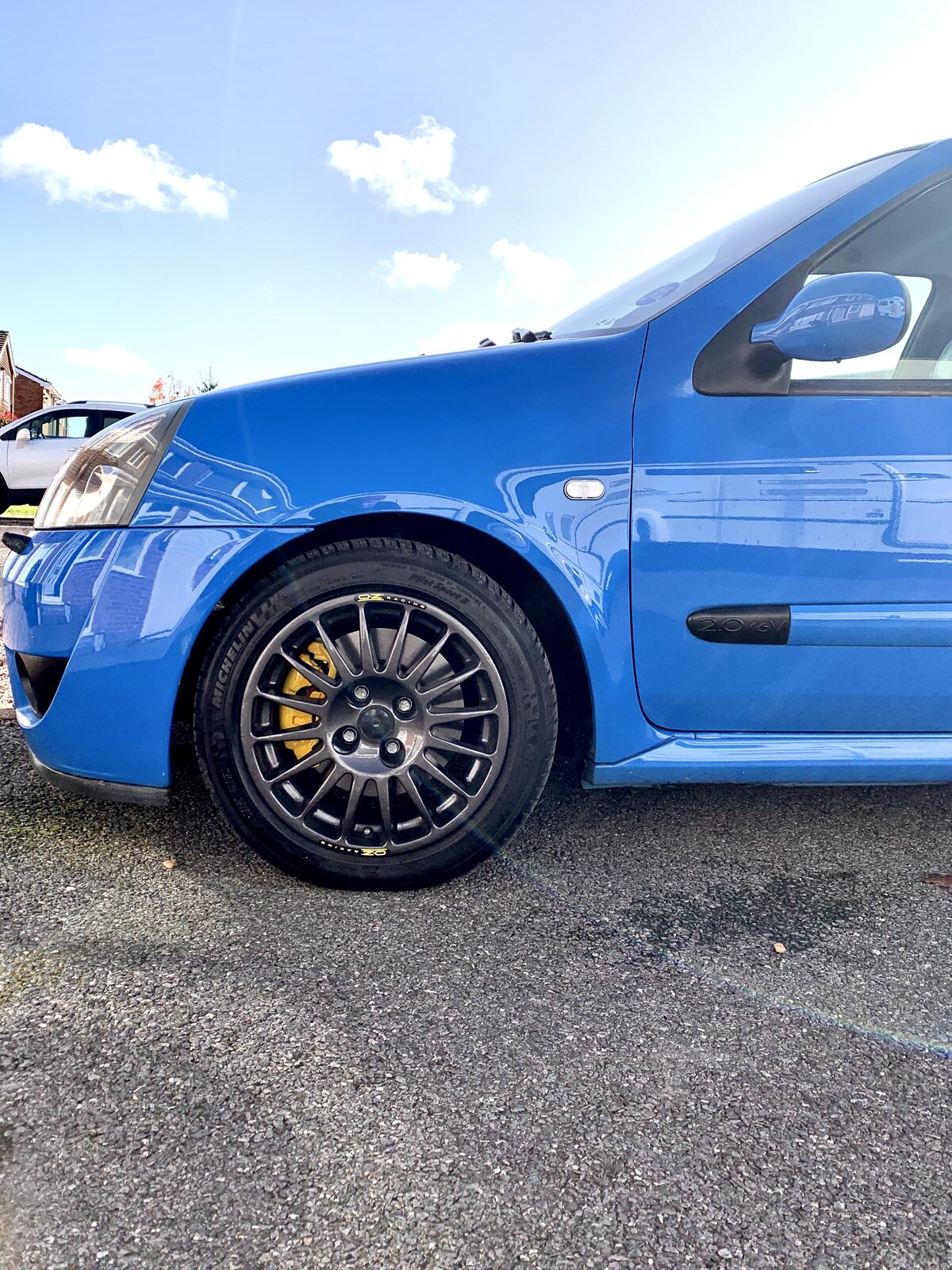

Fitted 16mm hubcentric spacers to the front which took longer than it should have thanks to a seized disc retaining bolt that was proud of the mounting face, a centre punch saw to that eventually.

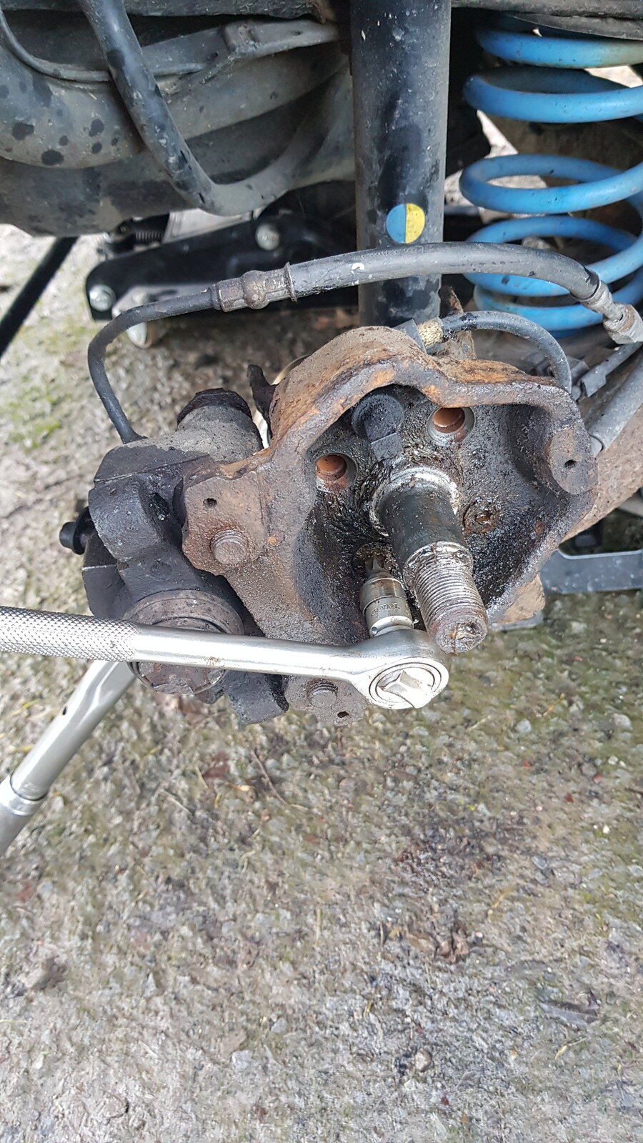

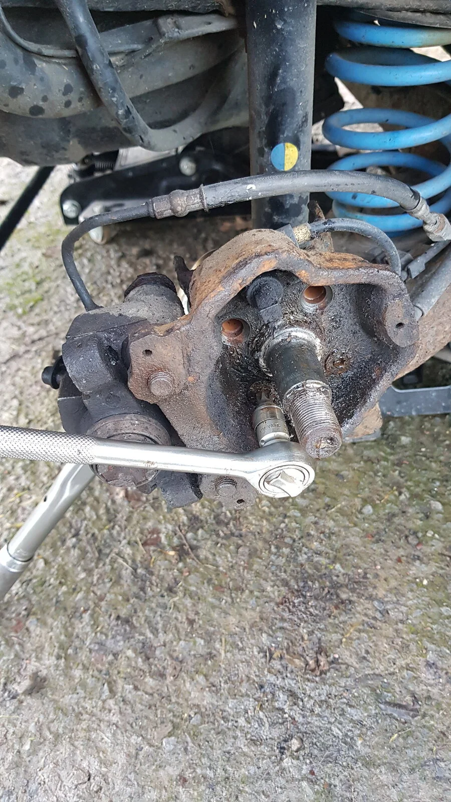

Started to fit PMS 10mm stub axle spacers to the rear, wasn't all that bad considering the 17 years of corrosion on the four hub bolts however this has lead me to think I need to overhaul my calipers judging by the split seals and general grime build up.
I'm not happy with that now, I should have cleaned the hubs up and painted them but fitting it all in was going to be tight. I think I'll be stripping it back down when we get lighter evenings but at least the bolts will come off easily.

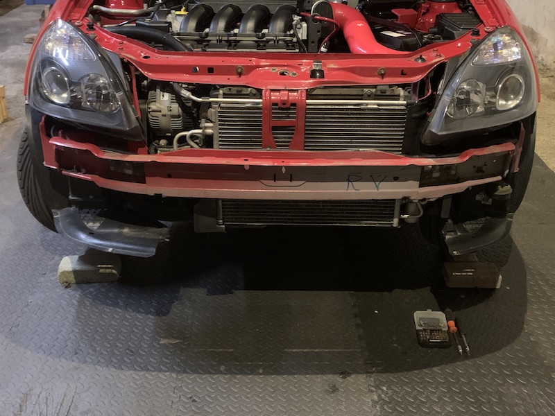

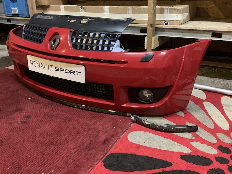

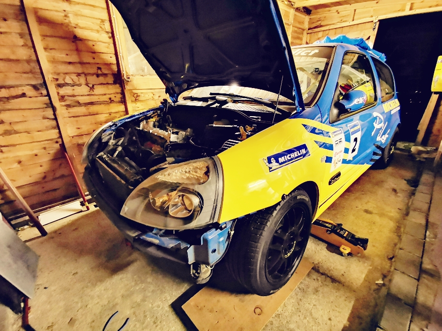

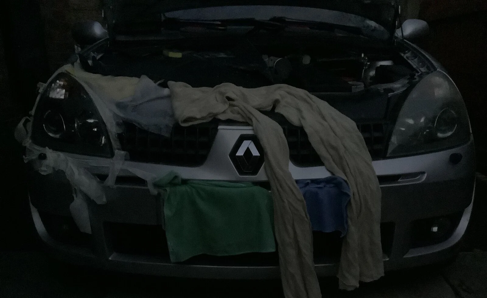

Over the last few days ripped the front bumper off teh car, Changed nuts & bolts from rust to new Allen hex heads and also popped all the Grills off also as have new ones to put on but want to give them a coat of gtechniq C4 Permanent Trim Restorer to have them looking really fresh.

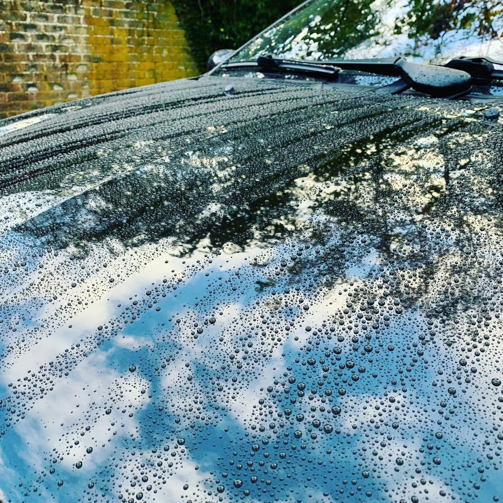

Just a quick clean today

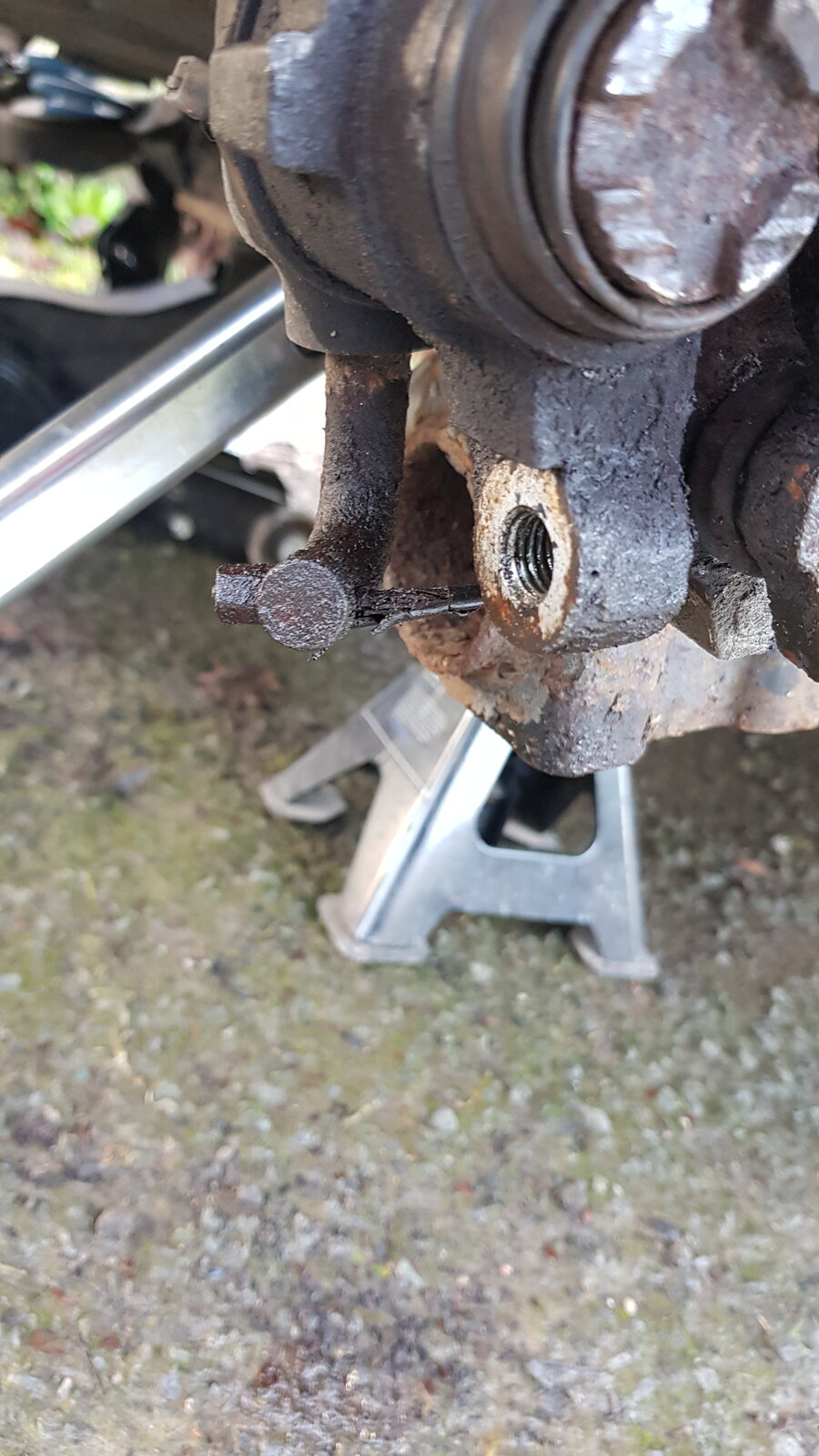

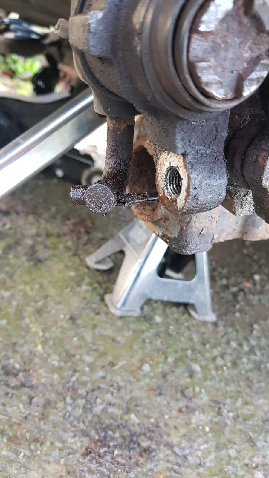

Finished fitting the rear stub axle spacers, found a new problem
