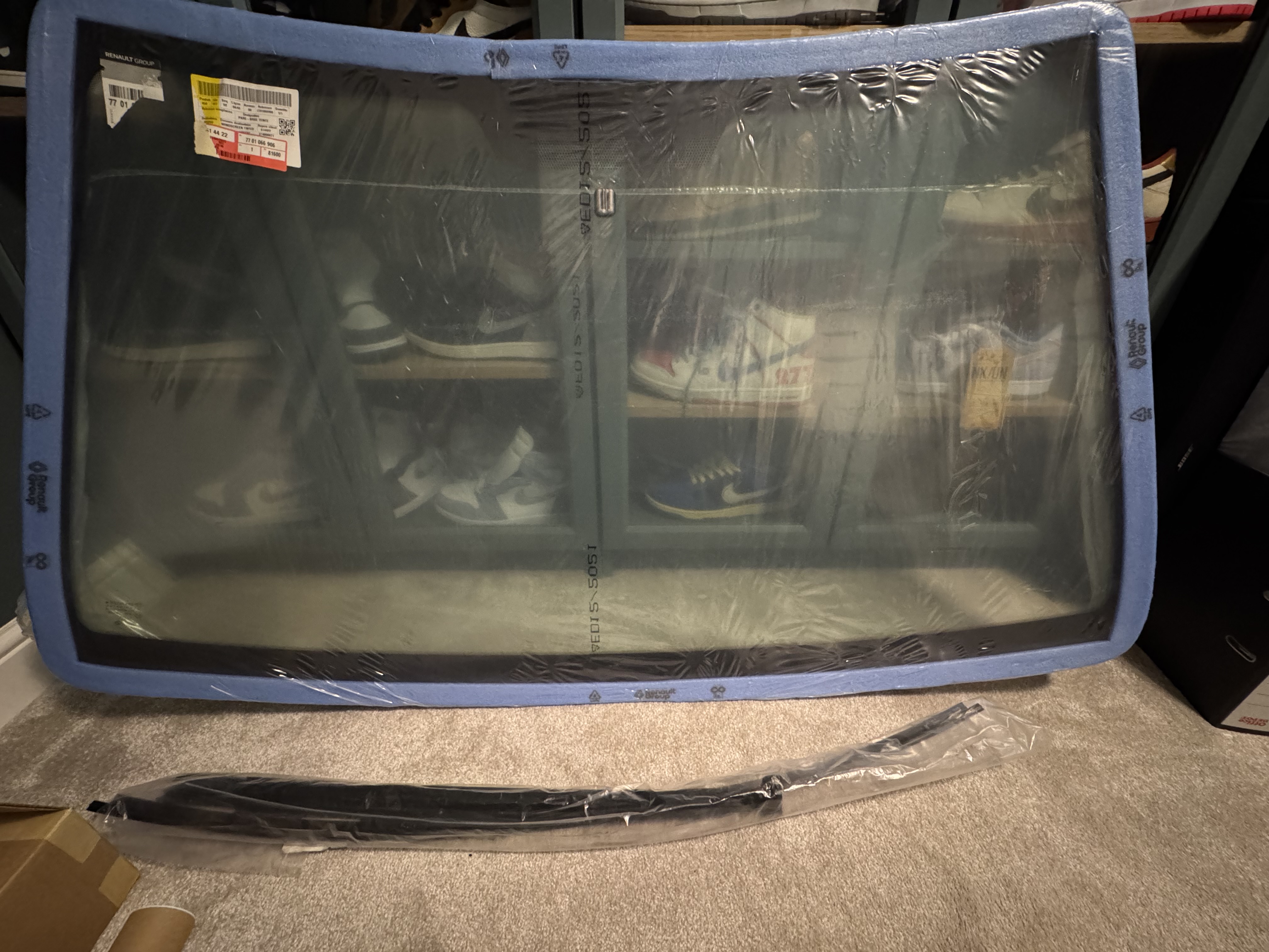

First of all I rang Renault for the part no and to see if they could order one for me? The back order from there had no eta which I presume meant they won’t be able to get me one.
Fortunately a fella on Facebook contacted me selling an original screen that his mate didn’t get round to using.
I then got a local firm come round to my house remove the old screen to fit the new one.
Yours might be easier to get hold of being a FF as it’ll have the regular blue tinted screen.

I'll get searching for one. Hopefully it will be easy to get one. It has some chips and has started to delaminate in the bottom corners. It looks ok at first glance, but bugs me!
I'll get a new screen surround kit too :)
