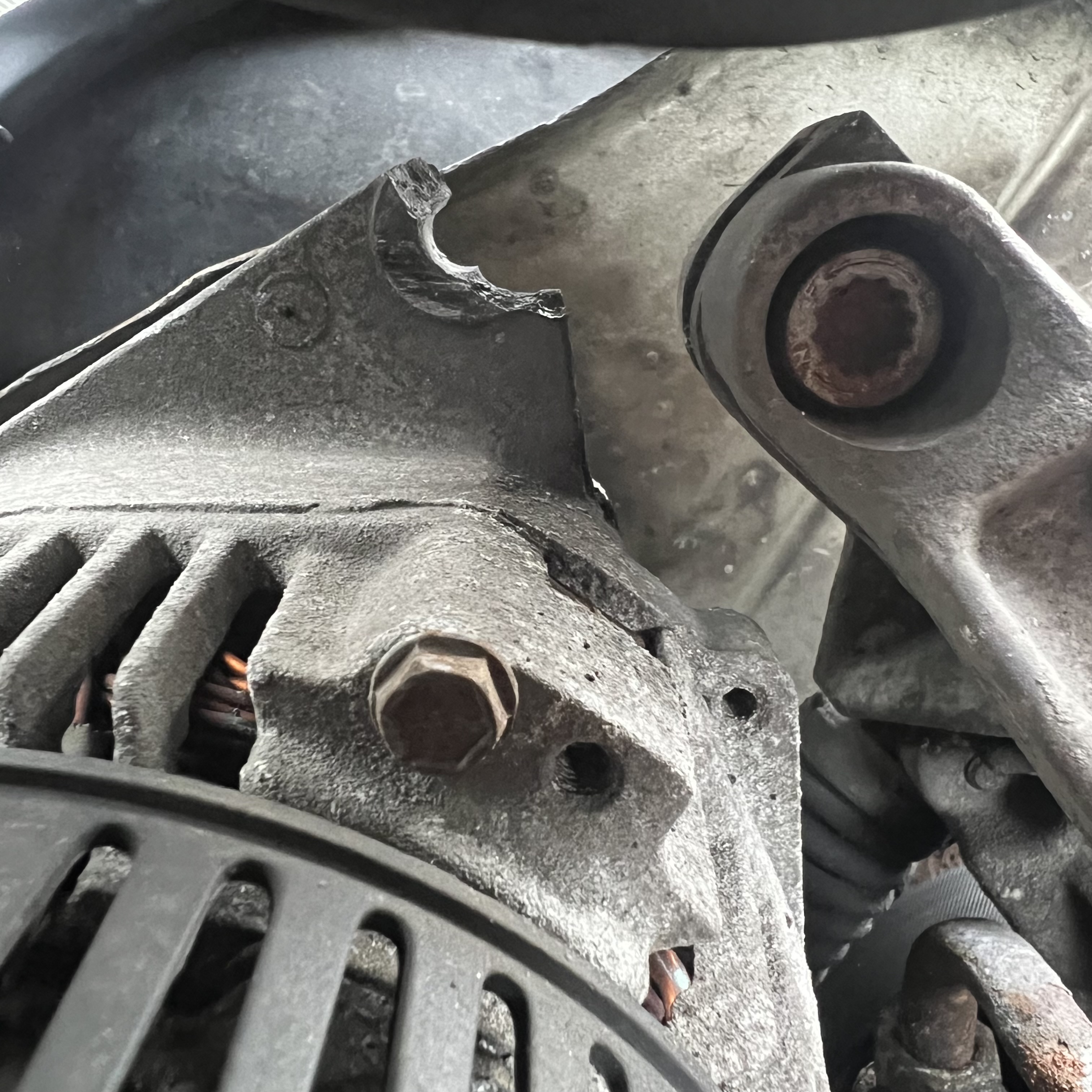

Alternator fecked on my shitbox daily.
Thought it was just the top end gone but after removing the alternator the mount at the bottom was gone which more than likely shook the top end until it snapped.

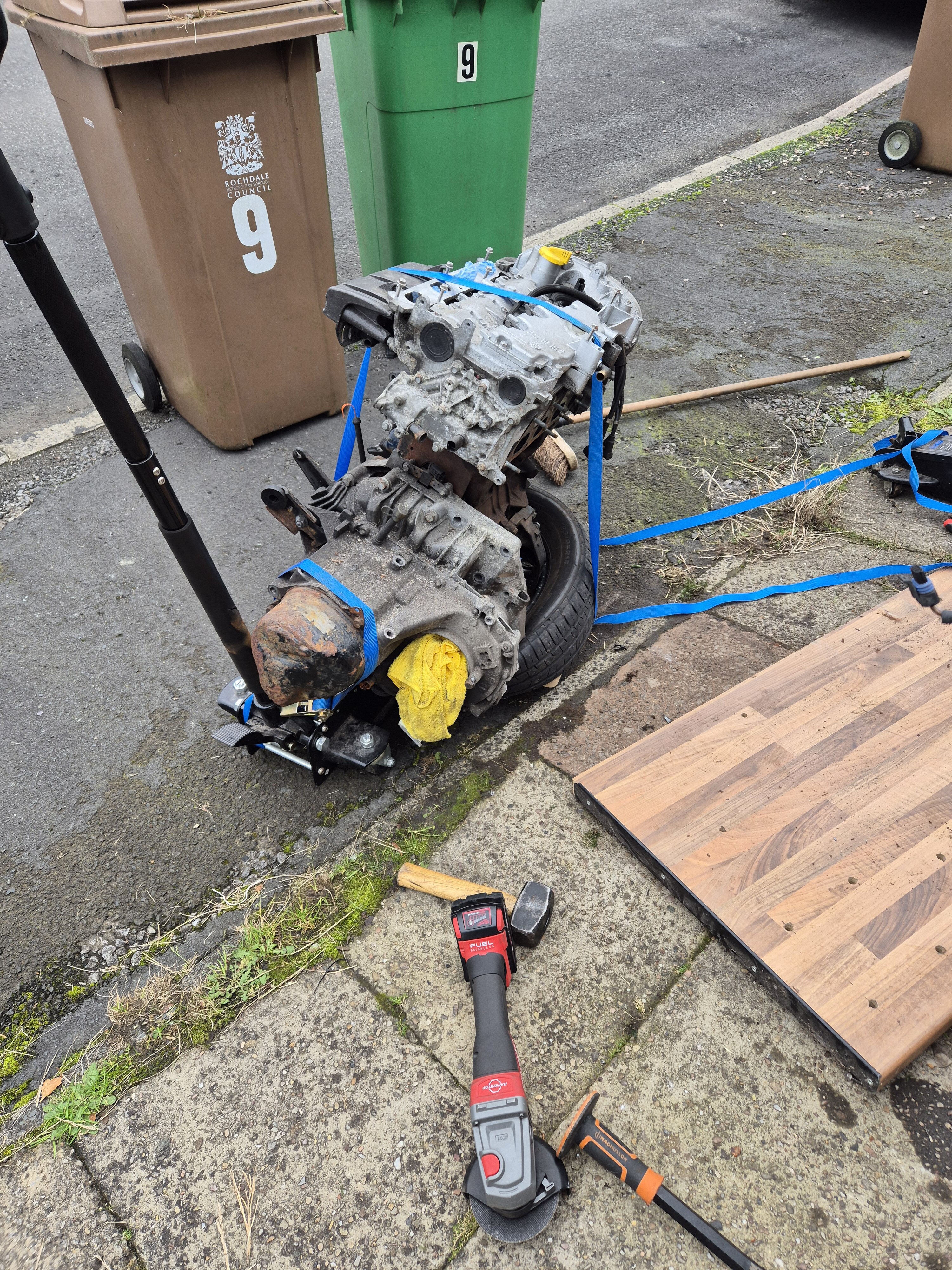

Currently building another engine for this shell.
So luckily the bottom mount was available as I’m fitting an air con delete kit.
So bought a new alternator for the new engine and
Stole the older one for the shitbox.

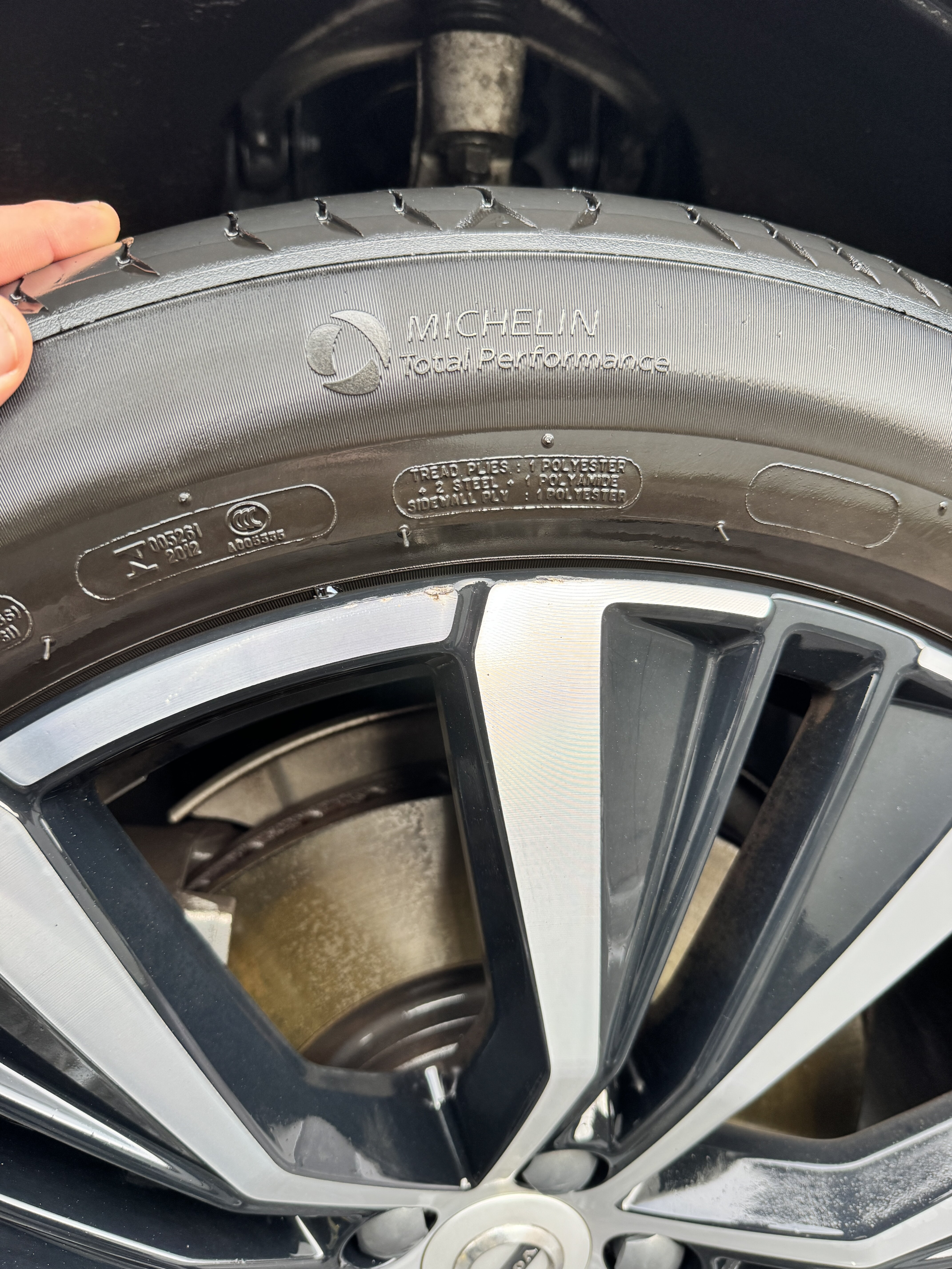

Noticed that one of the rear tyres was low on pressure (it was 16 and should have been 40). I’ve not driven the car much since getting out of storage, so not sure how long it’s been low.
Pumped it up and wanted to take it off to see if I could see a nail.
Taking the wheel off involved a 1.5 hour hunt for the locking wheel nut key. At least the garage is a bit tidier now, after me tuning upside down looking for said key.

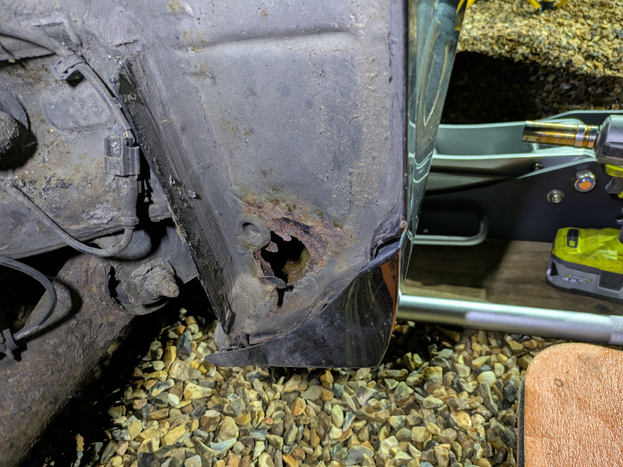

Continued stripping the Clio tonight for race prep. Took the half cage out tonight and found some... Well.. Oh...
It'll be fine... To be fair I've looked inside the sill and it all looks clean and tidy, this is just where the arch liner clip goes onto. It'll get plated tomorrow when the cage gets welded in.

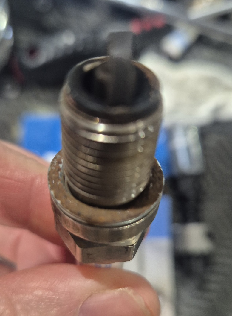

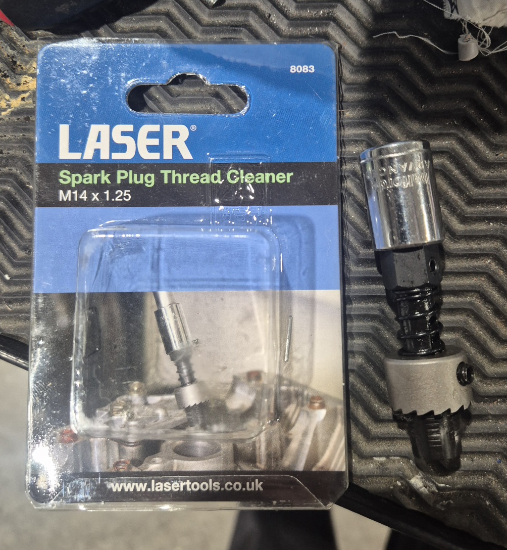

In spite of finishing the 'jobs list' I decided to check the scuttle drains and could clearly see the tide mark on the driver's side. I cleared that and fitted new trim clips to the scuttle cover and then decided to check the plugs. That turned out to be a bigger job than expected. One of the plug wells had clearly been full of water at some point, fully rust stained and with a heavily corroded plug washer. 3 of the 4 plug seats had black deposits under the washers, one of them with added crusty rust. I got the rust by carefully dripping vinegar onto the seat, which worked really well. The black deposits (carbon? hard burnt oil?) Were a bit more stubborn. If not down the bottom of the plug well, a scotchbrite pad would have sorted it in 2 minutes. After a few days working intermittently and using brake clean and a home-made aluminium scraper, I gave up and bought a Laser plug seat cleaner. This is a great tool, and cleaned up the seats really well.

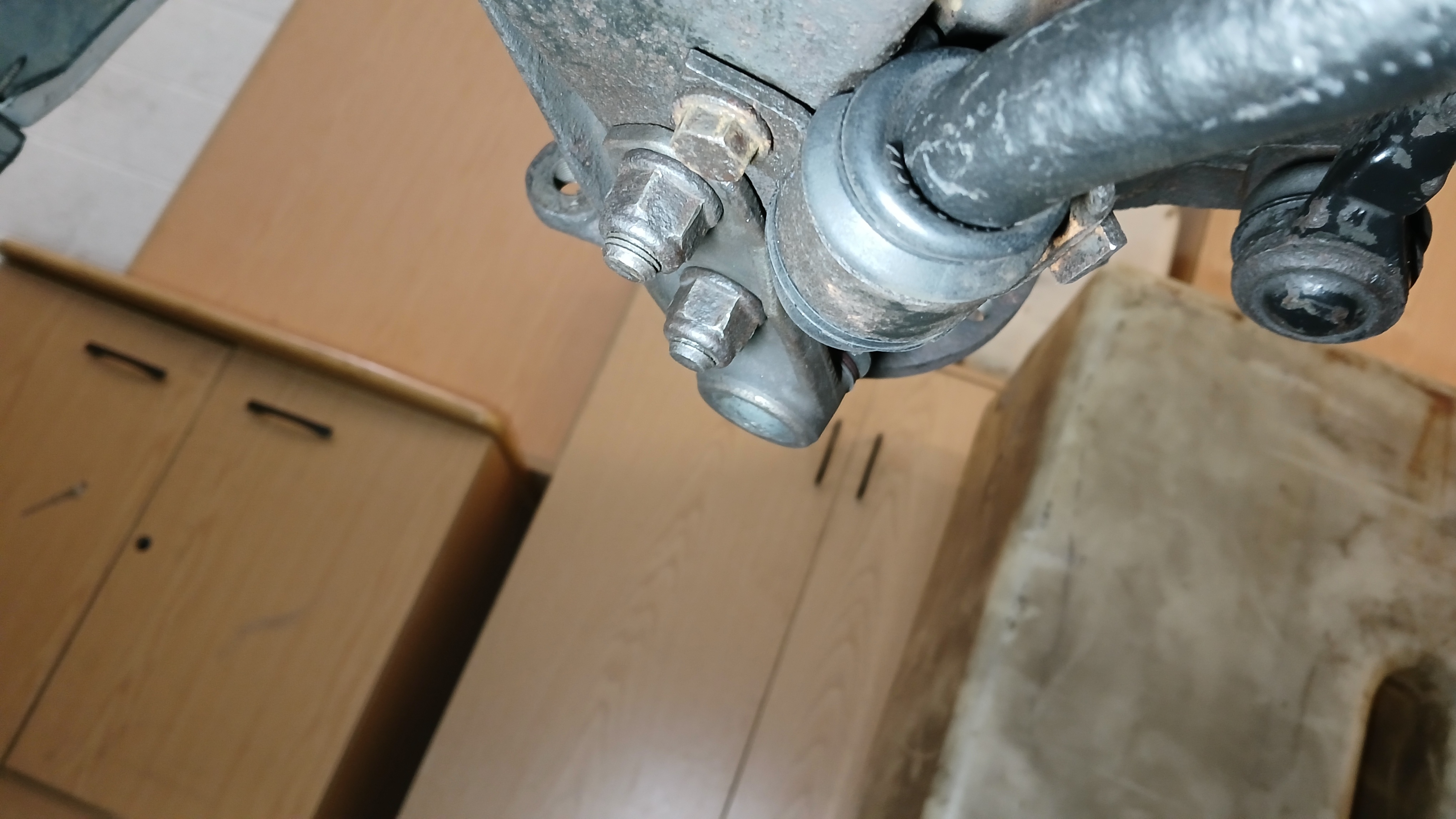

Well set out to replace the front antiroll bar bushes. Cleaned and sprayed the arb, brackets etc. Set to this morning by 3 ive managed to get the drivers side done , thanks to the guide 👍 hope to attack the passenger side tomorrow 😀

Gave in the next day. attacked today but hurrah 😀 5hrs many swear words later but it's done! What would you do without G clamp.

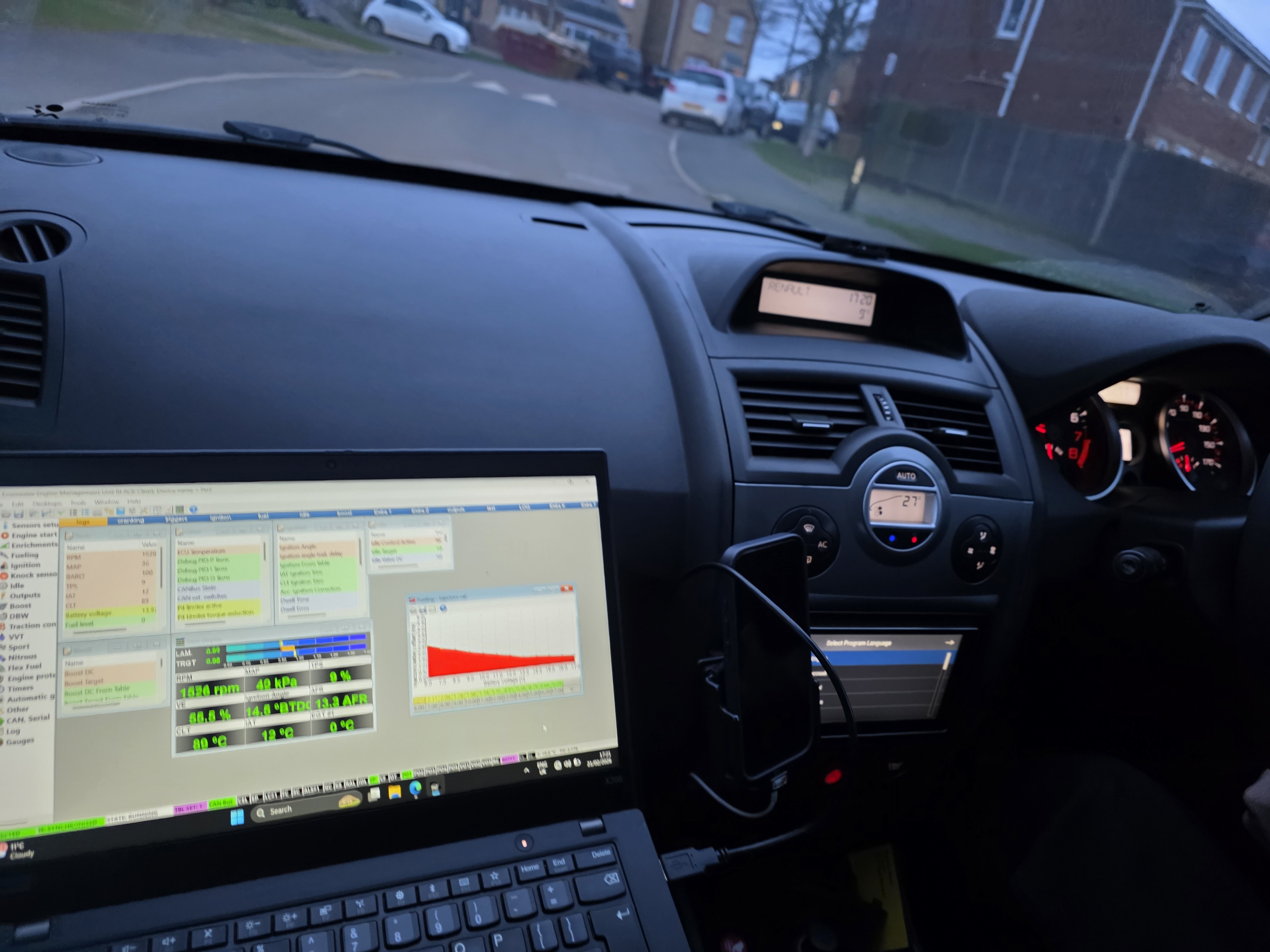

Sat - Ecumaster black sebimotorsport PnP standalone ecu install on a high powered megane r26.
The car has been recently mapped at 458hp, built engine/large garrett g25 585 turbo on oem ecu, which was pretty crap as boost was too agressive. This needs more flexibility of a modern ecu to control using boost by gear etc and traction strategies.
Up and running in 2 hours on base map with 3krpm limiter. Installed mac valve, edl-1 datalogger, lsu 4.9 wideband sensor, wired in switch for boost blend and a few other wiring repairs i.e. coilpack clips etc. Got it started easy on 875cc injectors and base map, then done a few small tweaks to the fuel ve map so it does not foul the plugs when loading onto trailer for mapping and it idled / revved fine, no warning lights on dash etc. Quick shot round the block to check vehicle speed etc was working for boost by gear. Prepped for dyno tuning and a few other bits done, retrimmed steering wheel fitted etc.

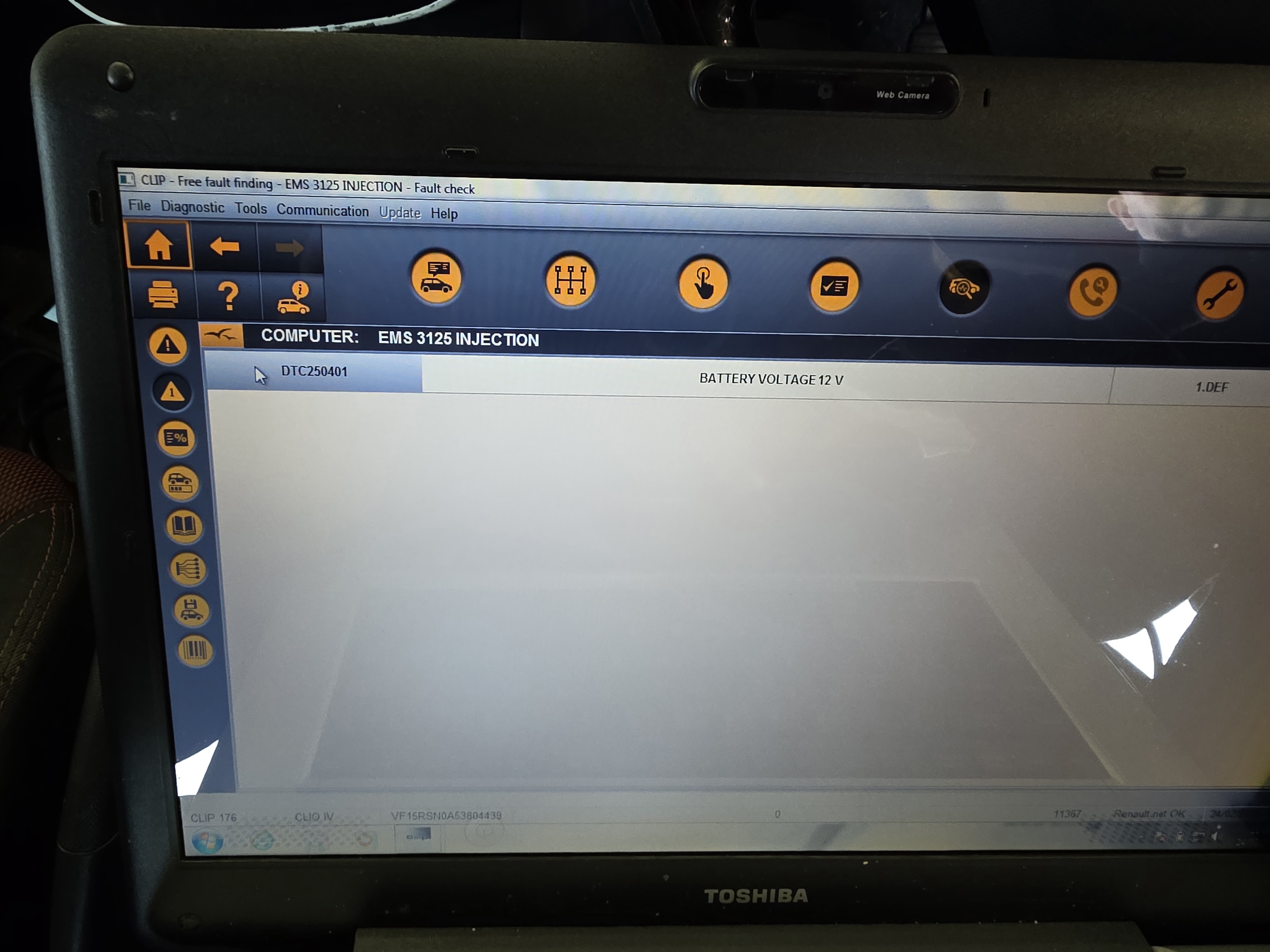

Tuesday - diag on a 65 reg clio in my local garage. Spanner light on, alternator was dying and voltage down on idle. Left to the garage to fix as diag only.

Sat - Ecumaster black sebimotorsport PnP standalone ecu install on a high powered megane r26.View attachment 1778550View attachment 1778551

Tuesday - diag on a 65 reg clio in my local garage. Spanner light on, alternator was dying and voltage down on idle. Left to the garage to fix as diag only.View attachment 1778554
