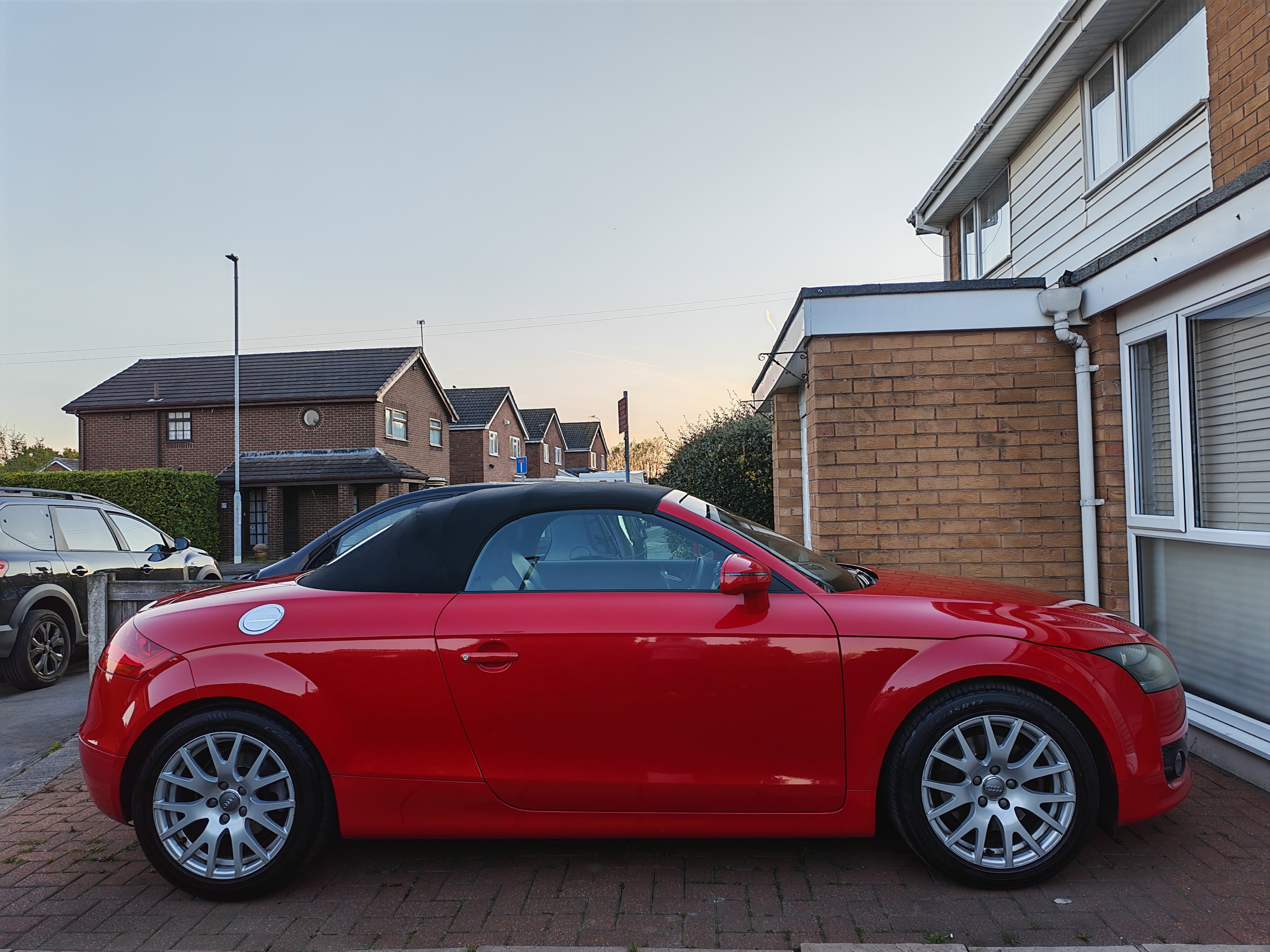

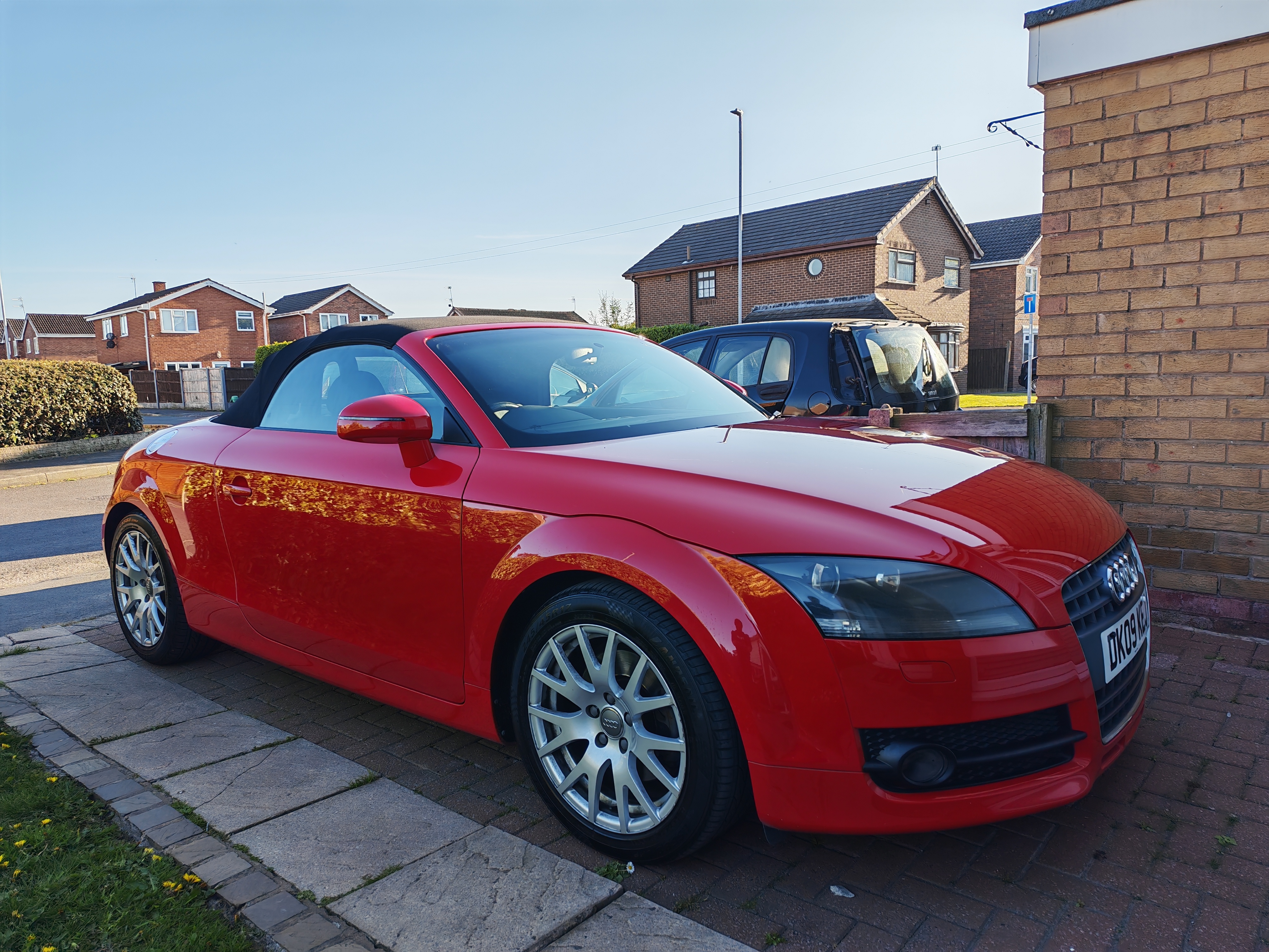

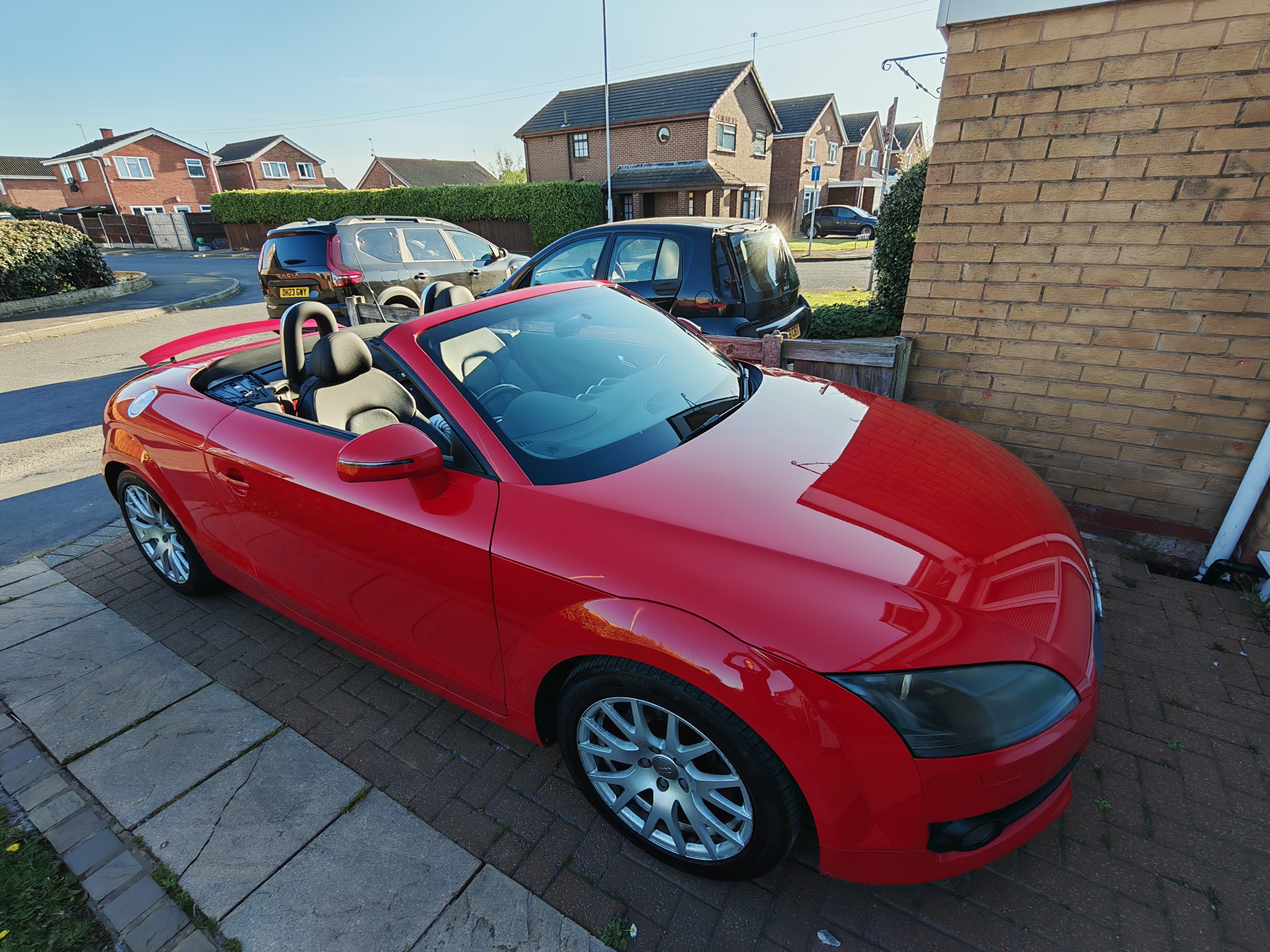

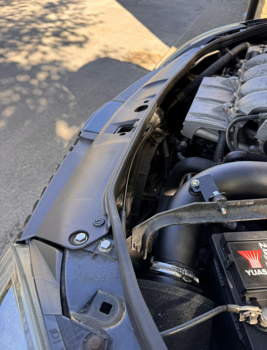

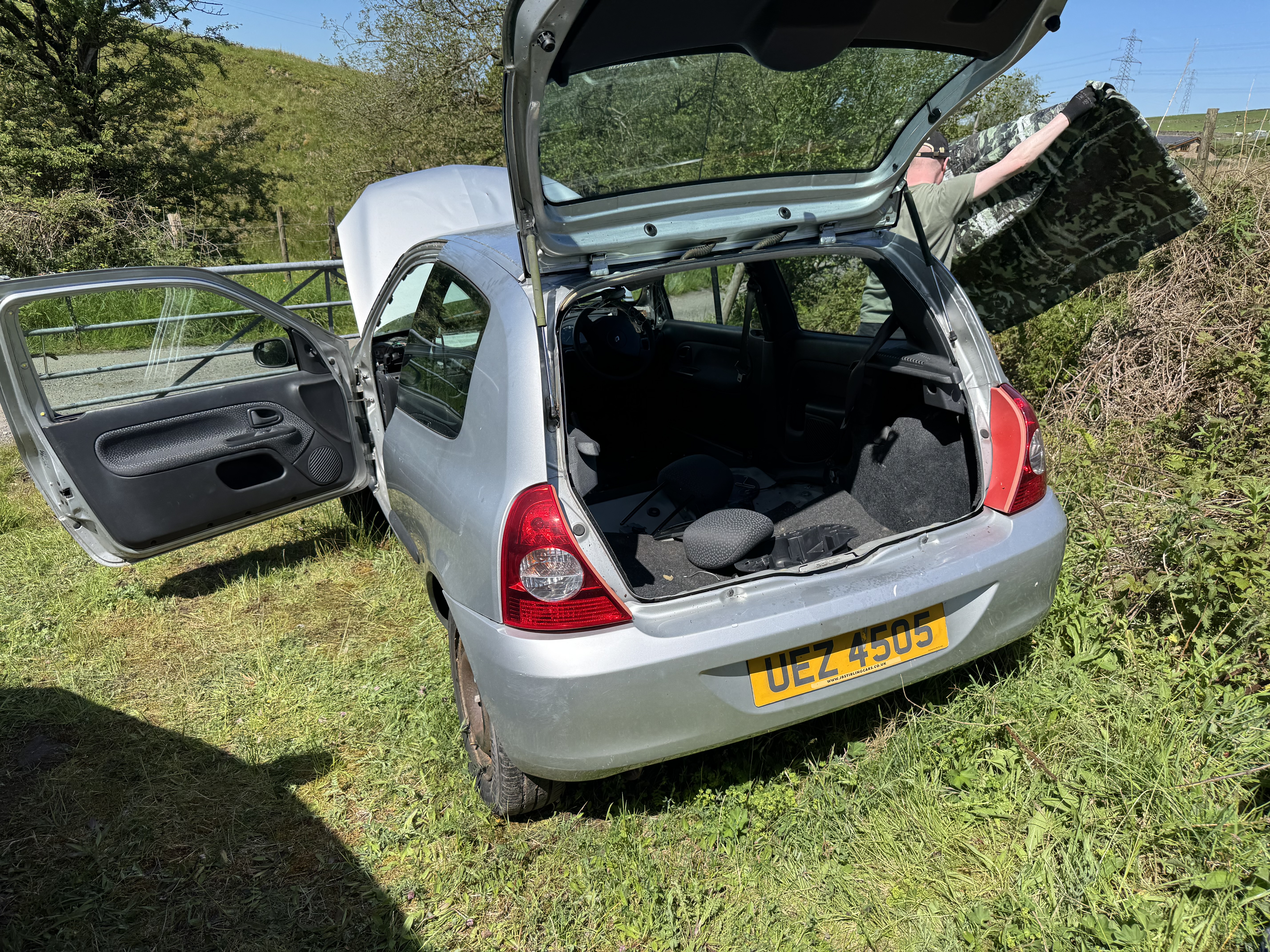

Got it ready to sell, maybe....
I'm putting the blame squarely on it being at a garage at some point and it being removed then! I wouldn't have removed it and left it off.... :)
Your slam panel has been off and replaced as I am sure I remember it missing the Renault stickers.

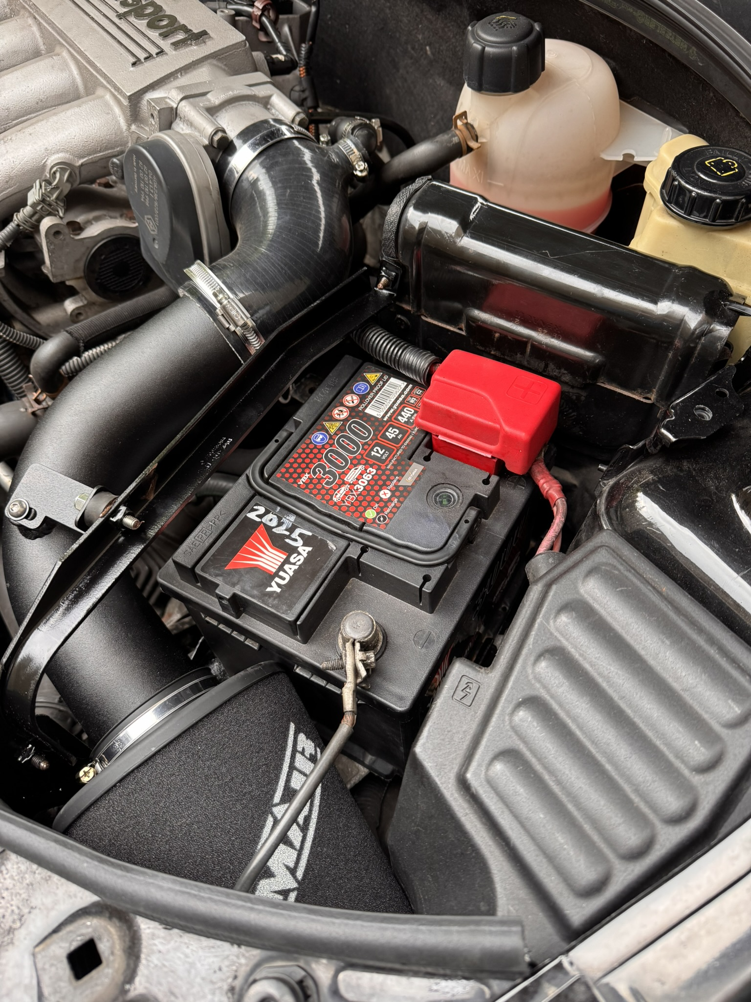

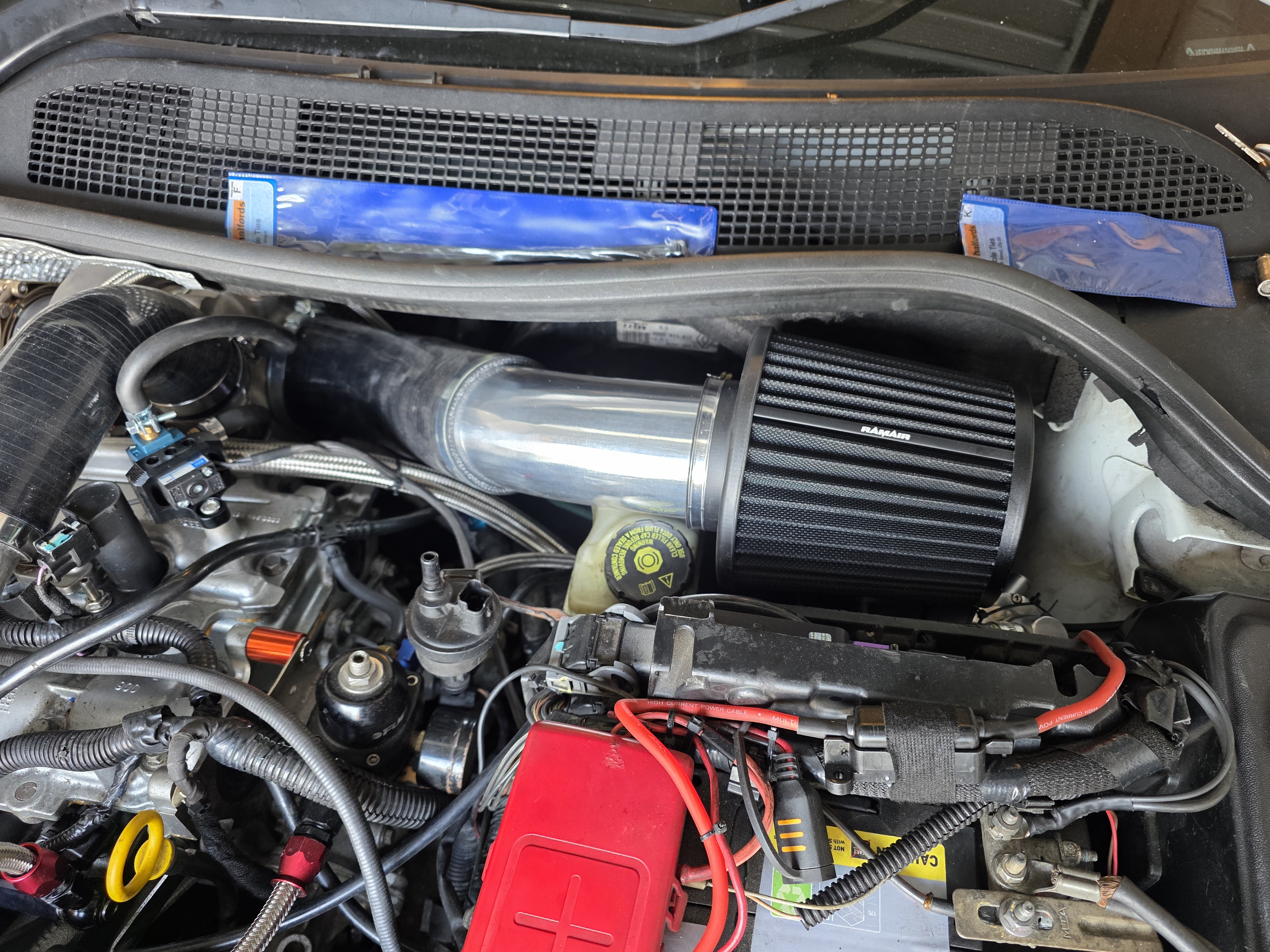

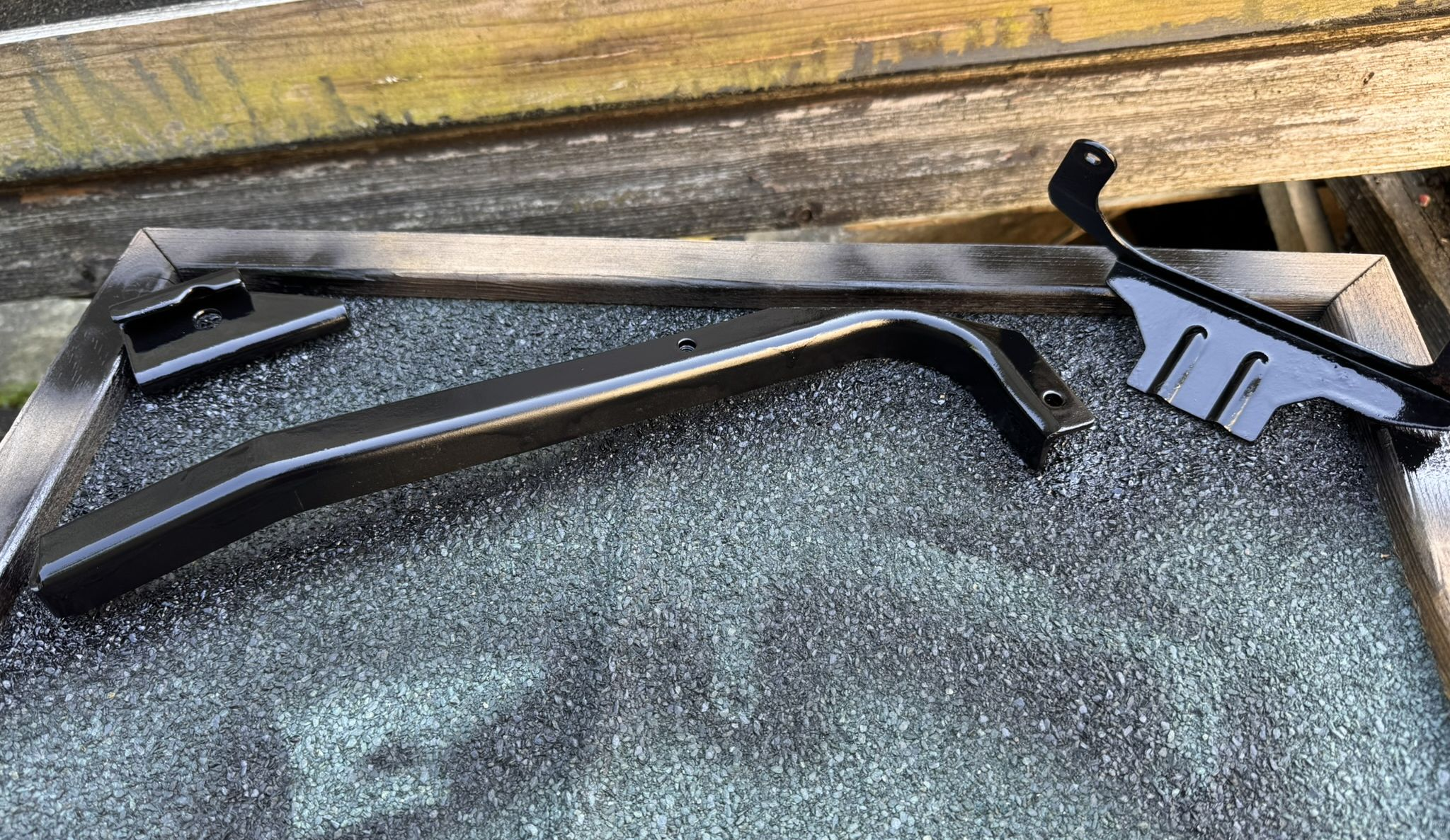

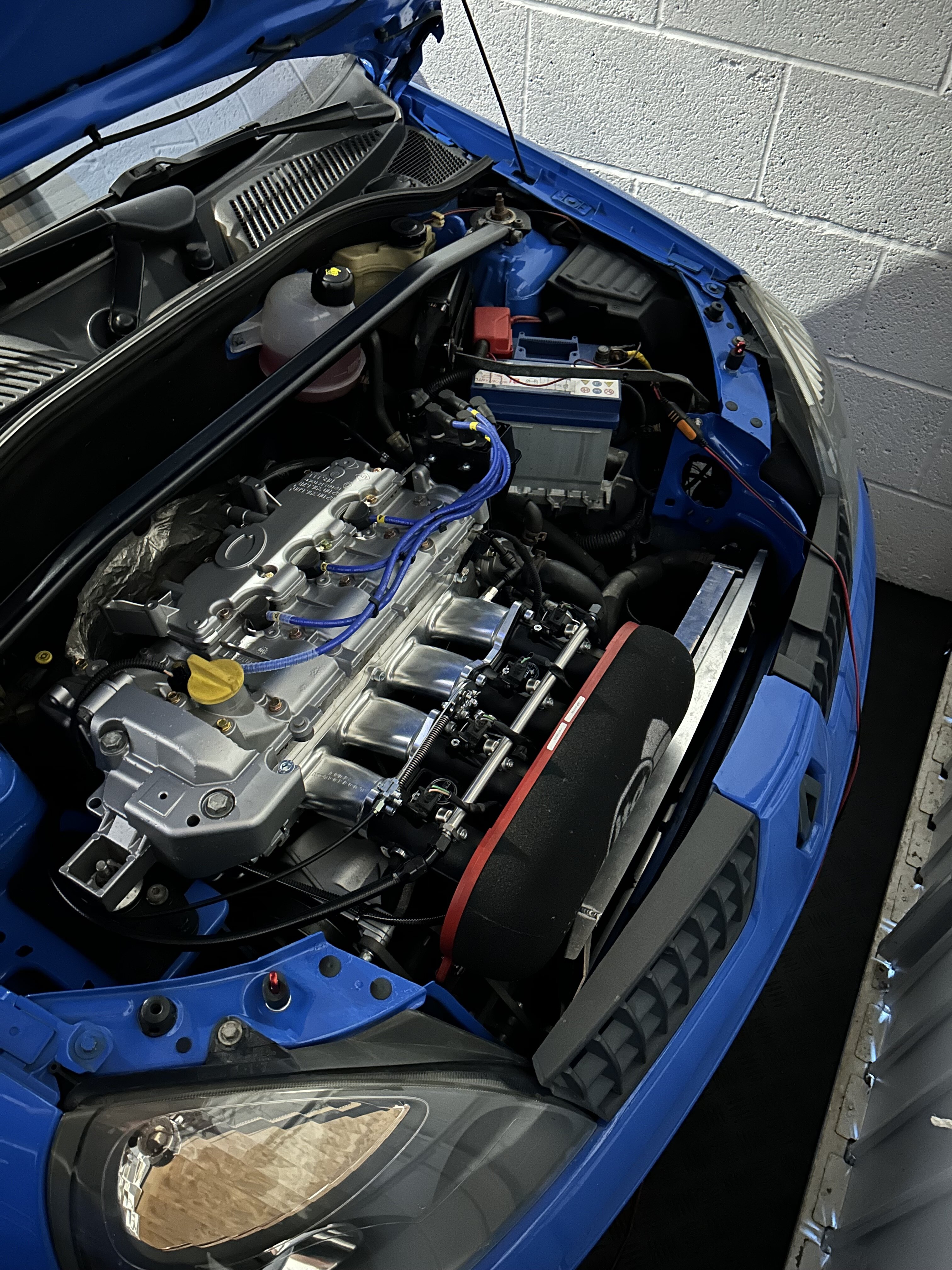

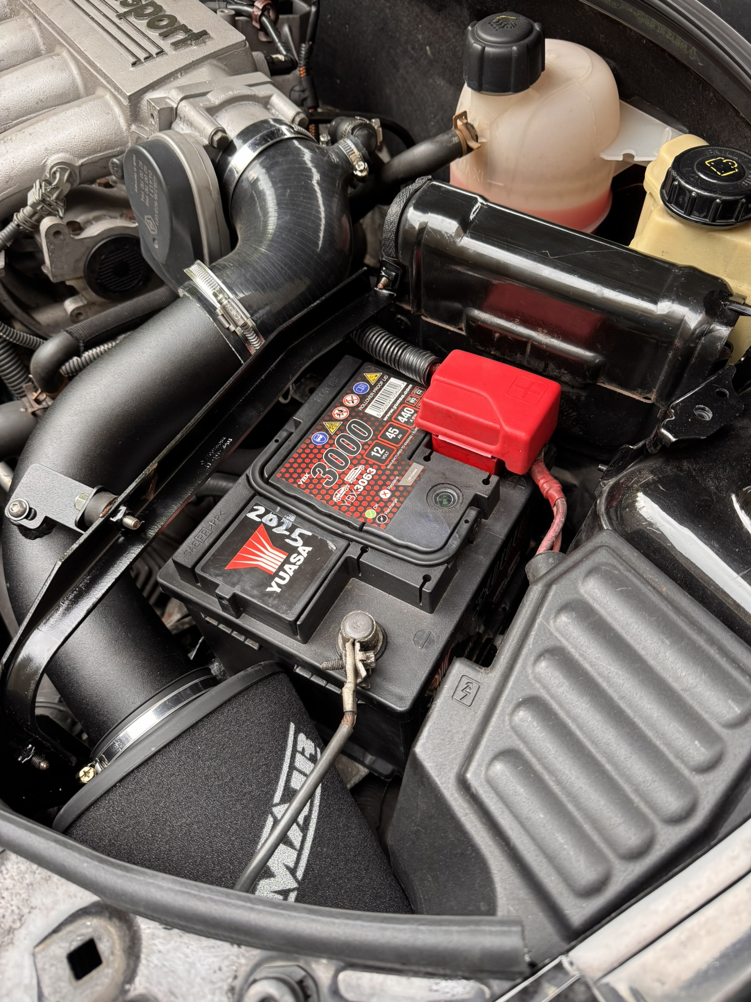

Out with the shitty Pipercross foam air filter and in with the Ramair.
Found it much easier to fit with the battery temporarily removed (probably not essential) - but glad I did as the right-side battery retainer clip was very loose.

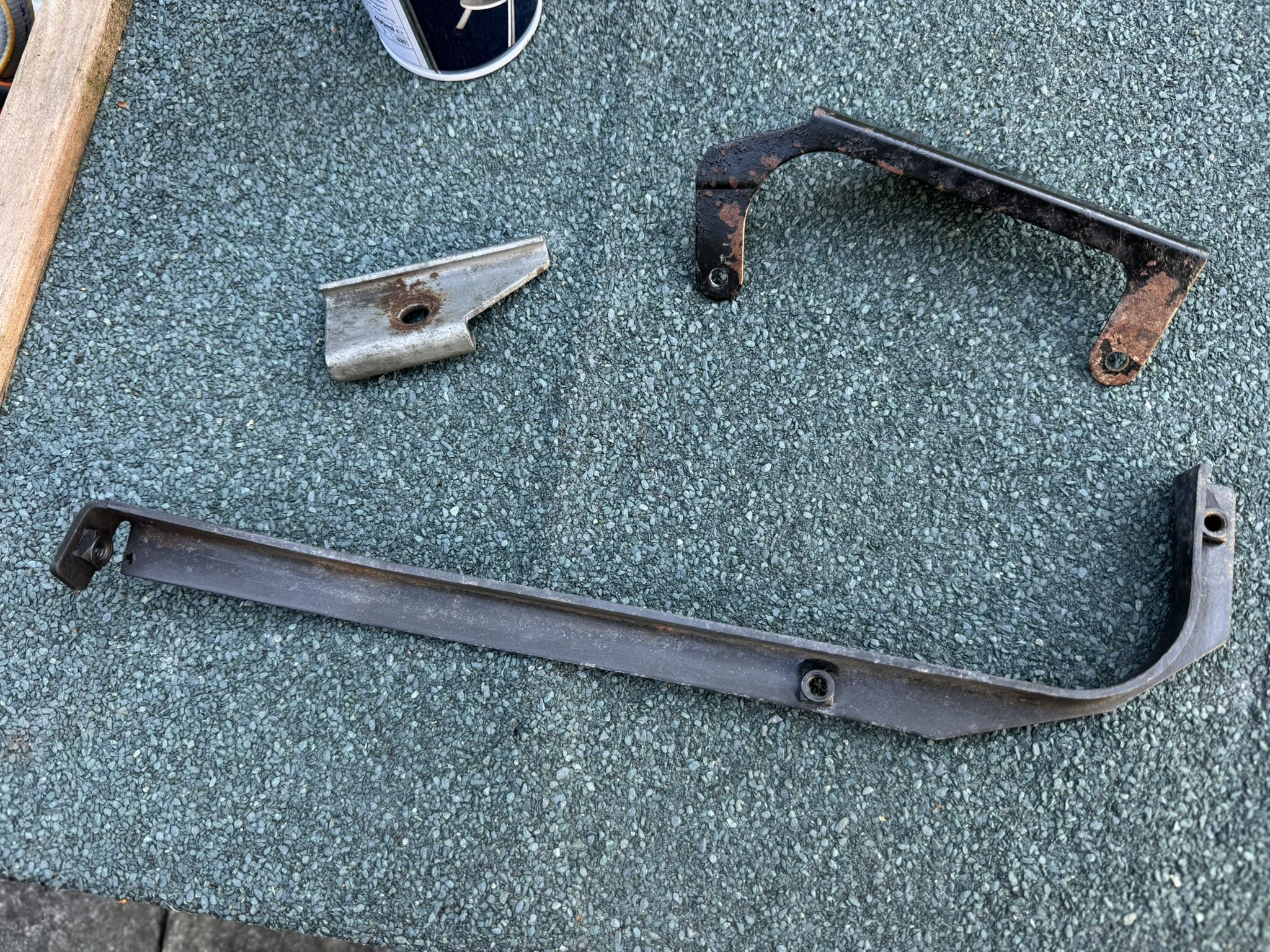

Me being me and finding a rattle-can of Hammerite knocking about - I had to tart-up the two battery brackets and airbox support to look a bit nicer at least.
A bit of wire-brushing and wipe down for these...

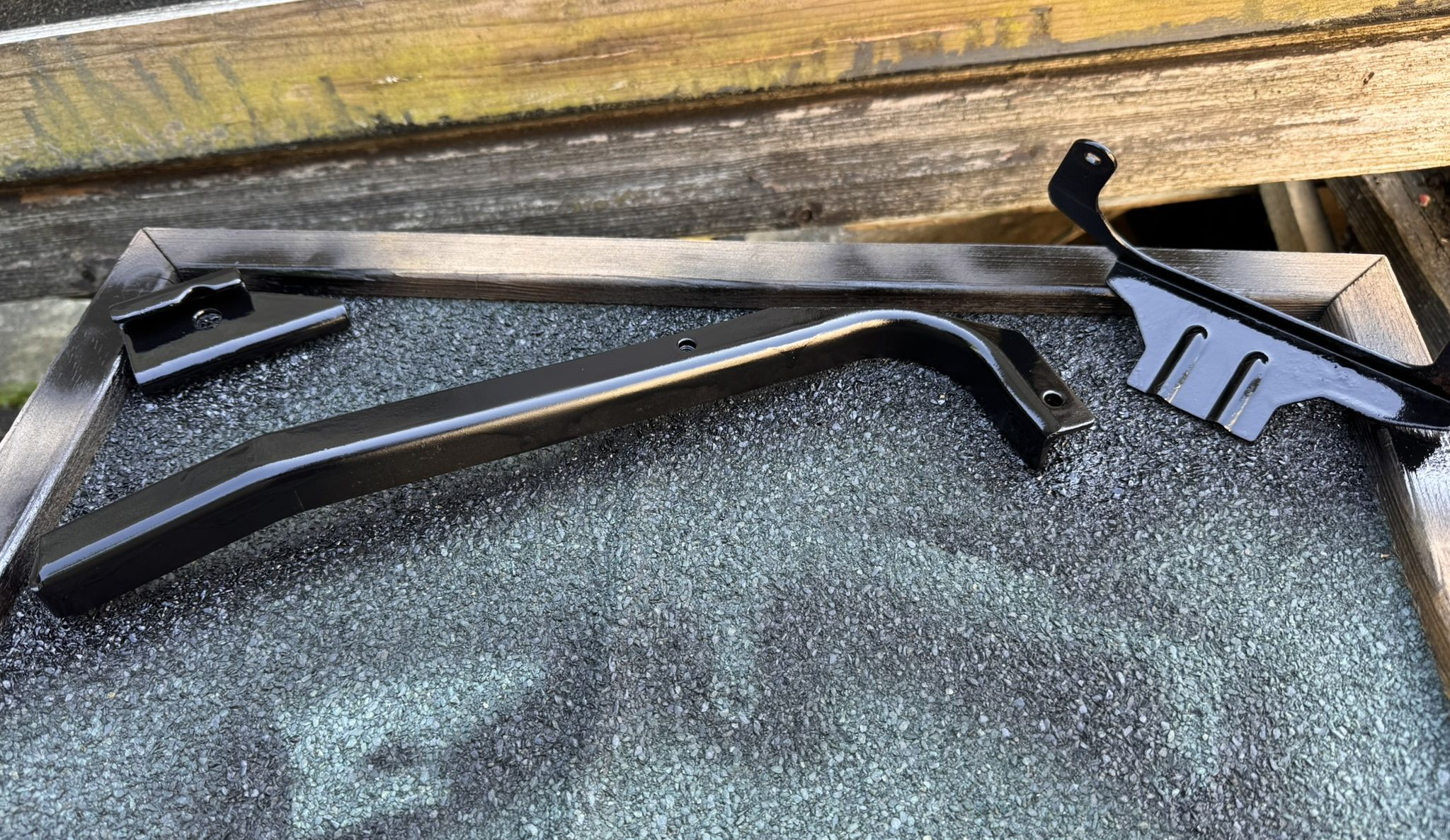

Got them looking better after a few light coats.
End result...

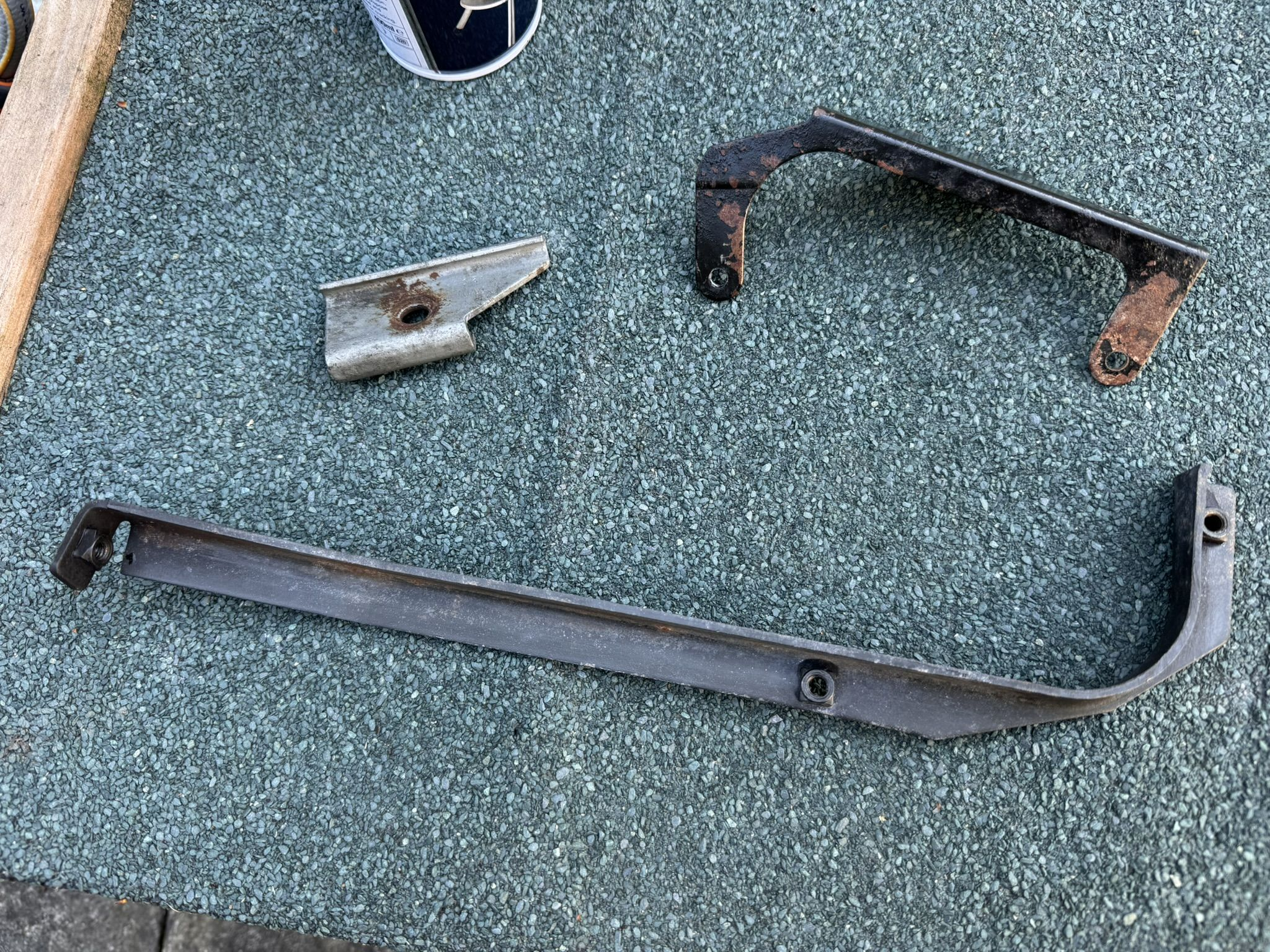

That looks very tidy!

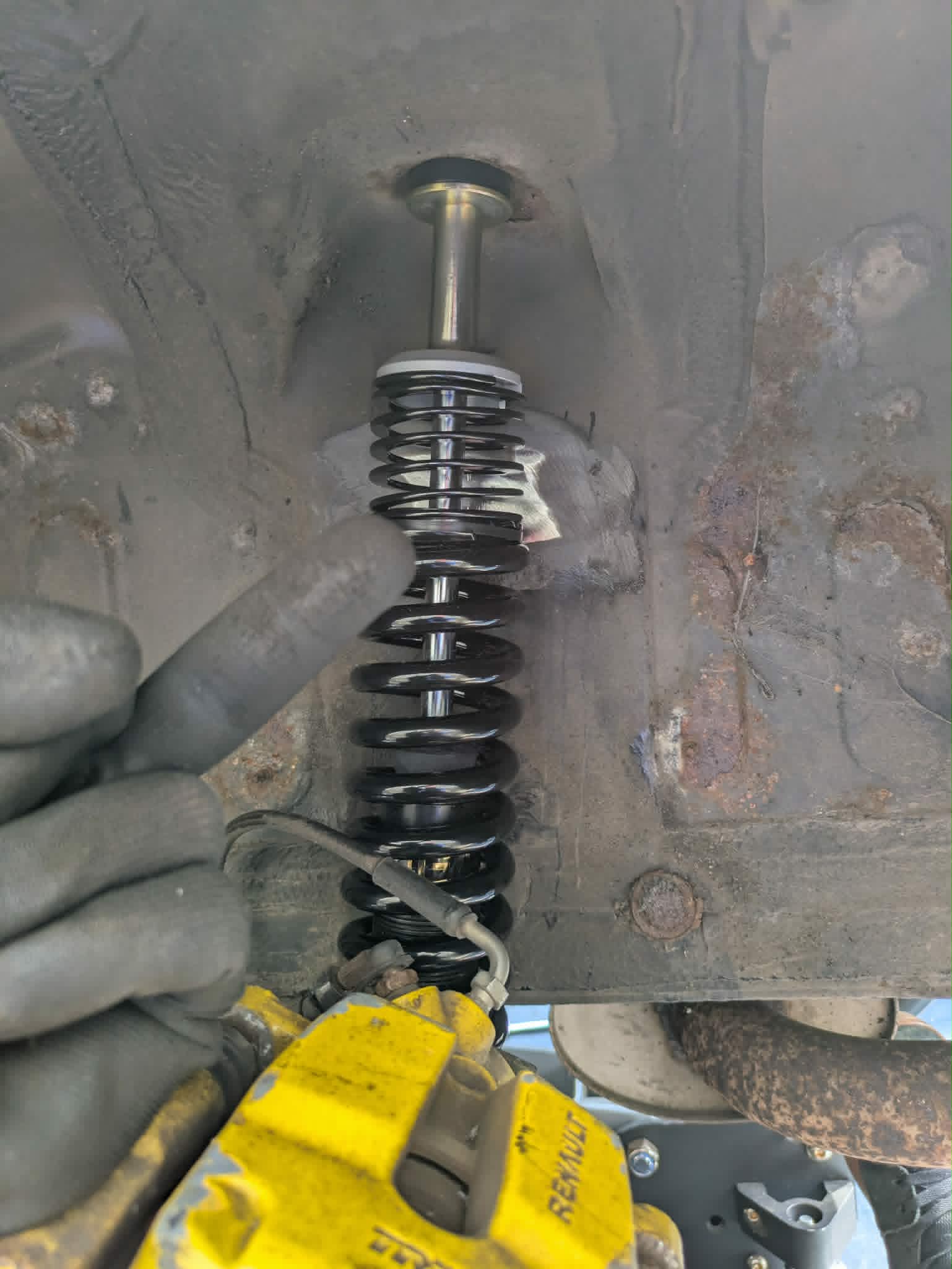

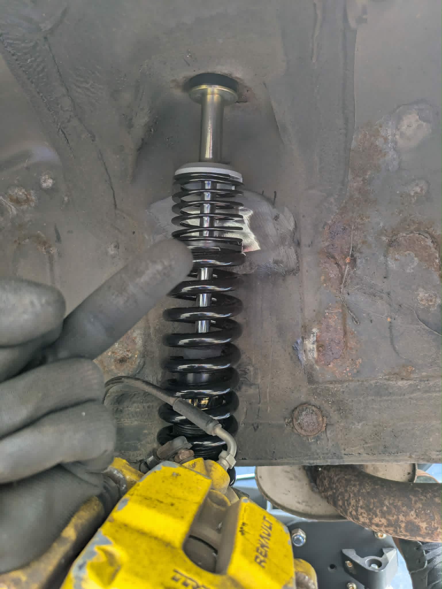

Got around to fitting the rear GAZ Golds today, I know you need to fettle the inner arch/body on the NSR but holy s**t I didn't realise how much you need to beat the living s**t out of it.
Is that because they are coil on shock design you had to get the hammer out?
Yeah rather than the old divorced shock and spring setup, the GAZ Golds are a true coilover. OSR has enough space between the spring and body that you could house a small CS.net forum member.

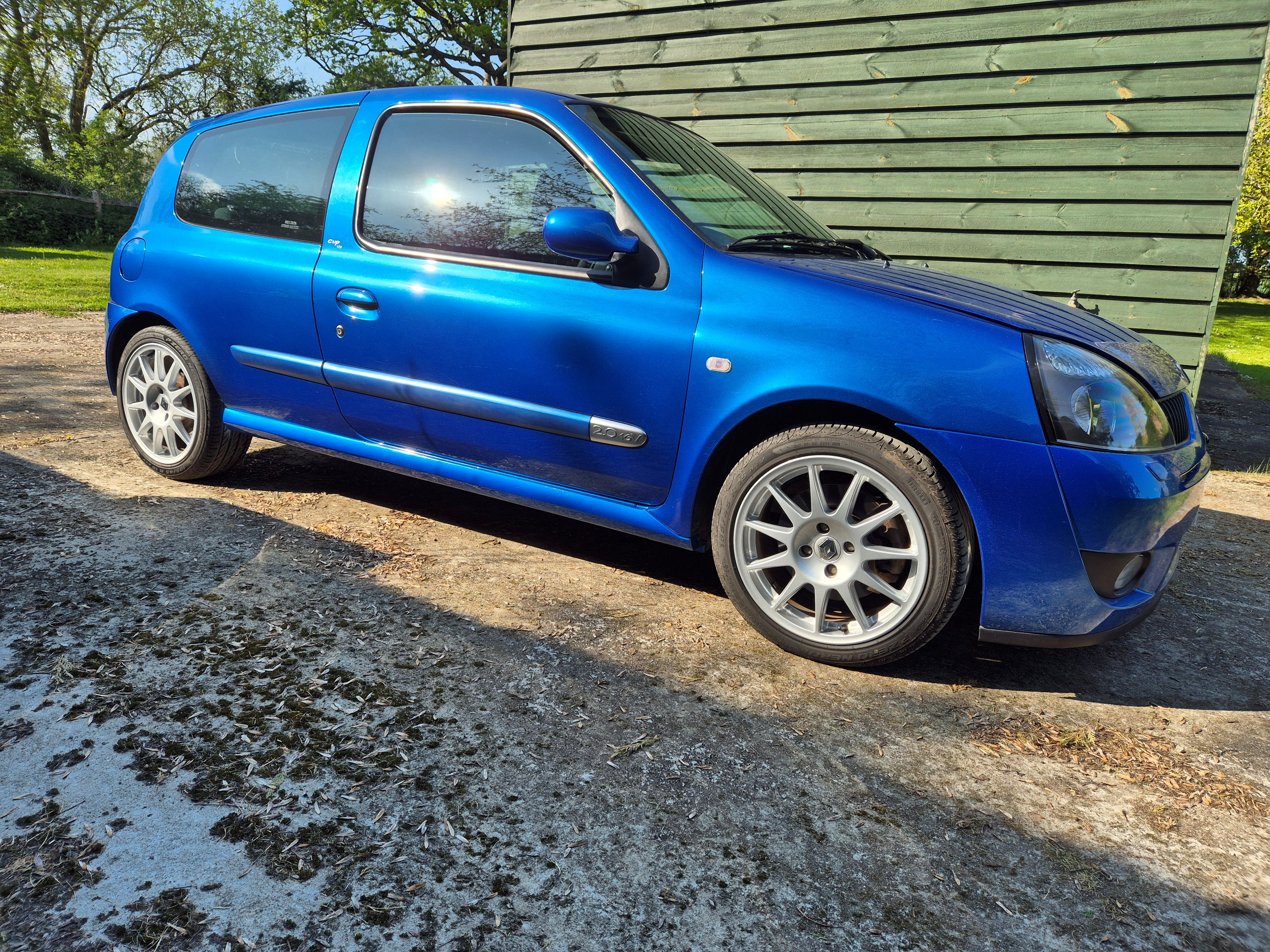

I went and got the 172 out last night. I haven't driven it in about six weeks. It has just touched 91k and the right indicator that didn't work (so I thought it was the UCH) has sorted itself out. Good car!!

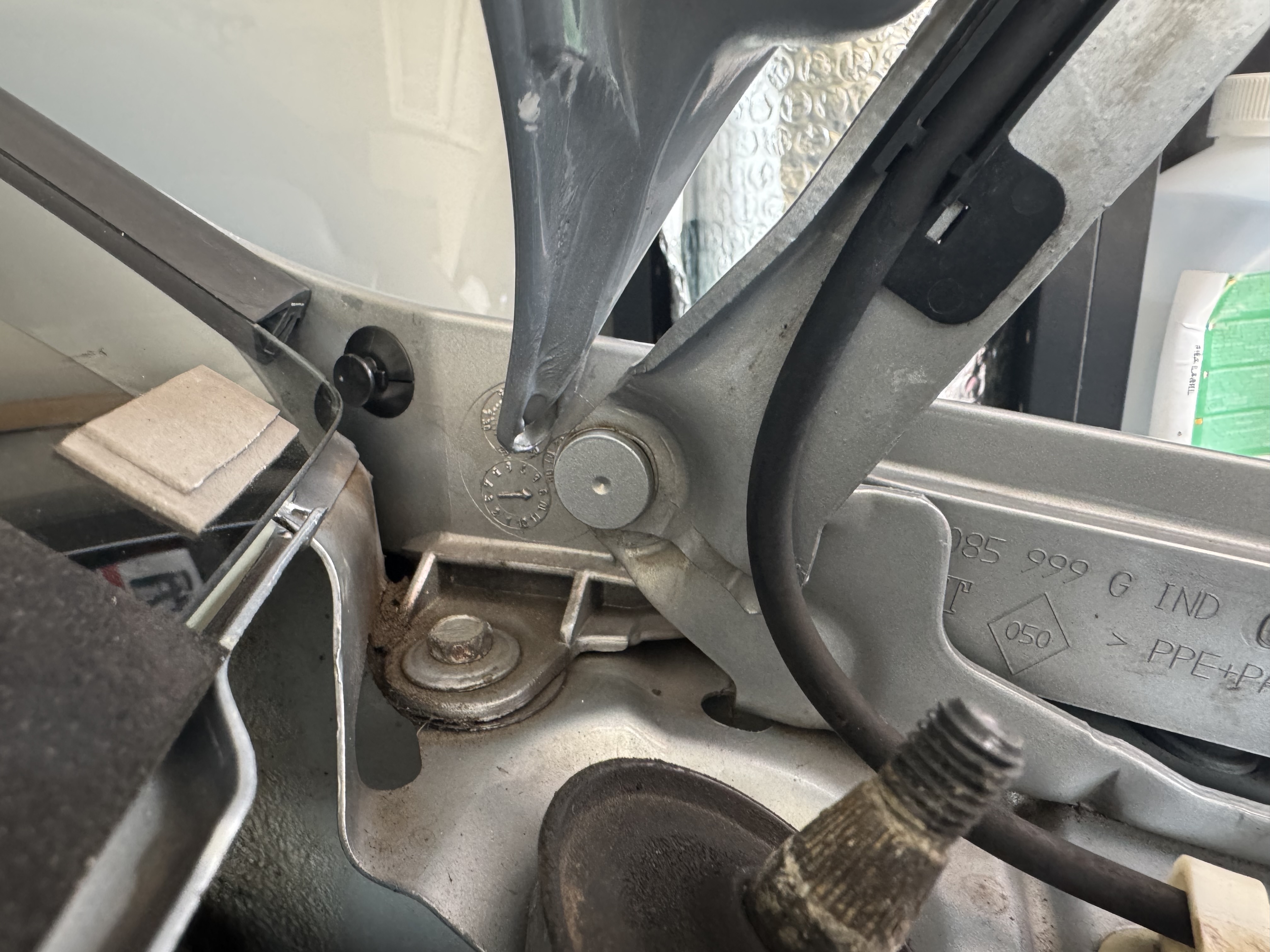

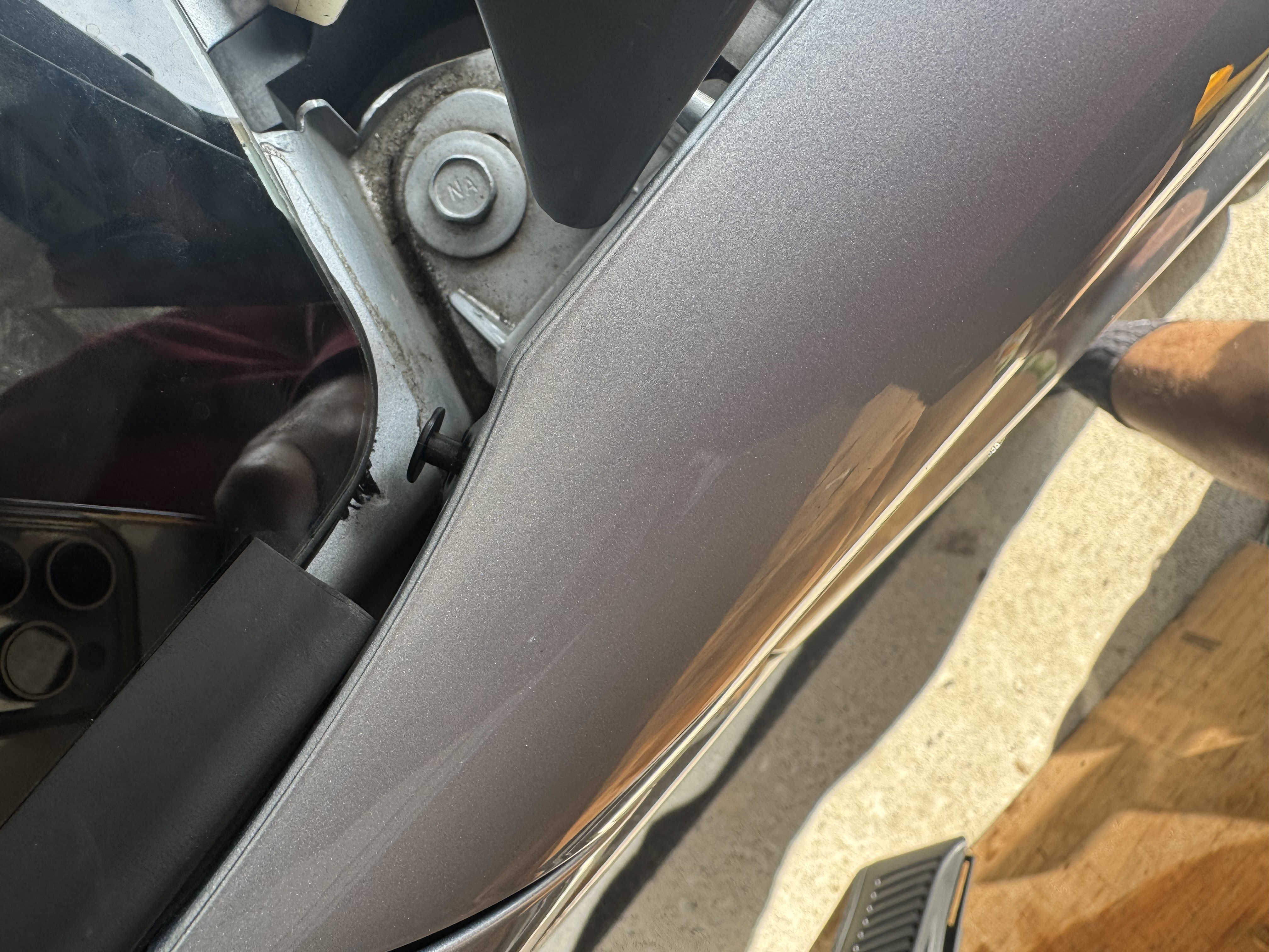

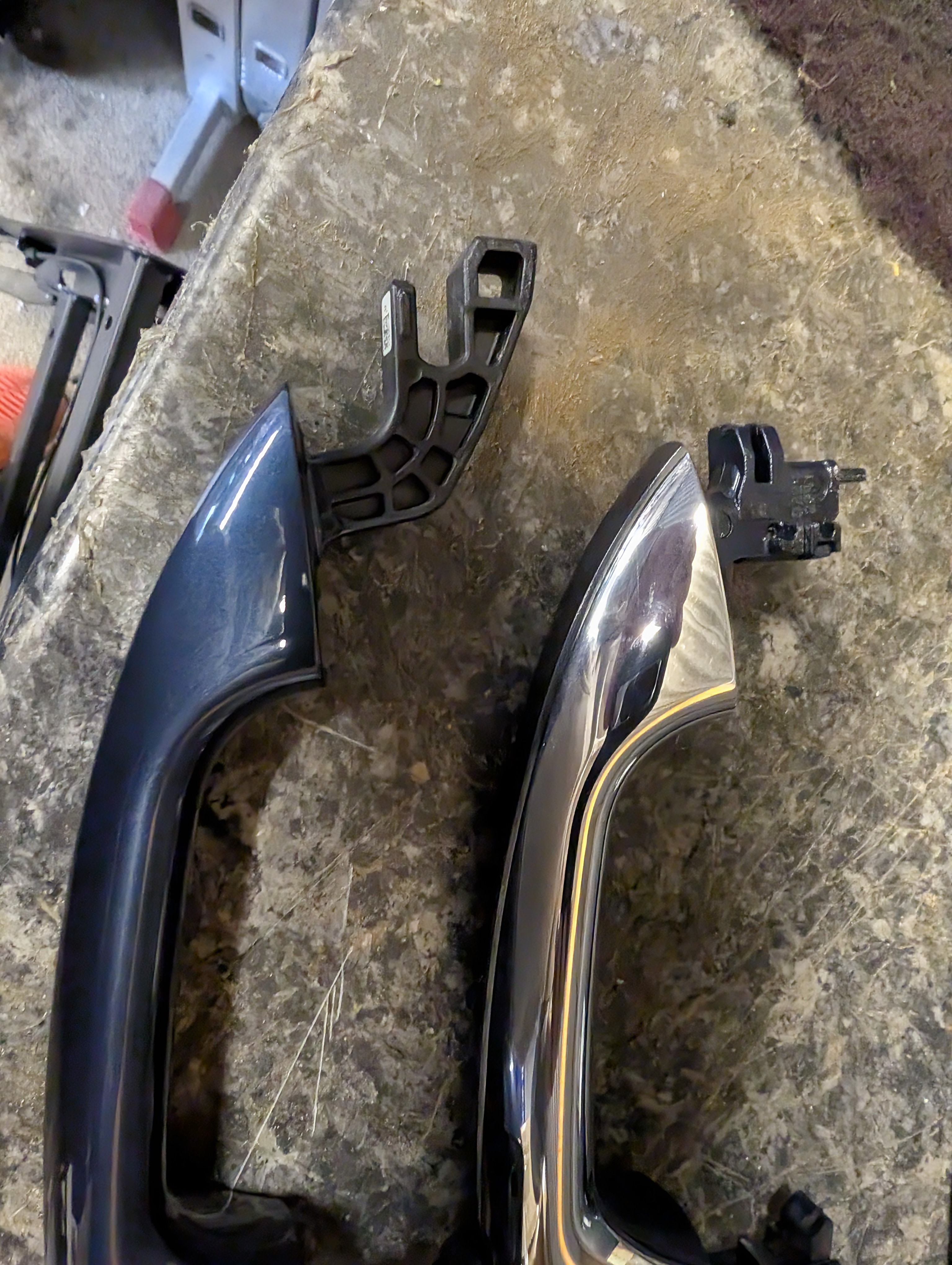

Went to swap the door handles over on my sons merc since the replacement doors have a chrome strip on the handles and the body shop didn't paint them when they did the doors. But...
f**king Germans have to go changing s**t for no apparent reason 🙄. Ffs.

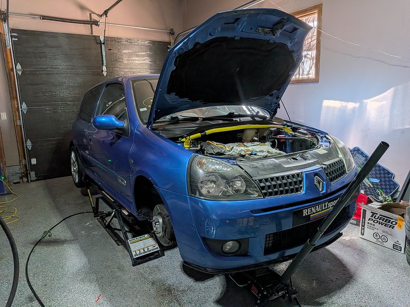

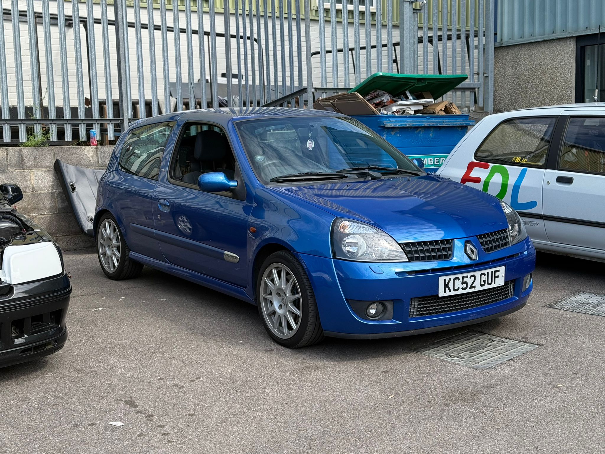

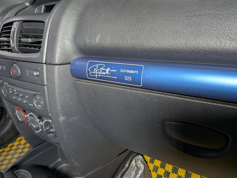

Busy times for the Jean Ragnotti:
  • Cambelt + Dephaser + Pulleys + Crank Pulley
  • Aux Belt + Tensioners etc.
  • Sump Pan Gasket
  • Gearbox Selector Leak
  • Engine + Gearbox Fluid Changes
  • Disc & Pads All Around
  • Plugs
  • New Wheel + Tires + Spacers
  • Studs
  • Engine Mount + Gearbox Mount
  • Bunch of Cleaning etc.
Just want to put a new clutch in the car and then she should be good for a while!

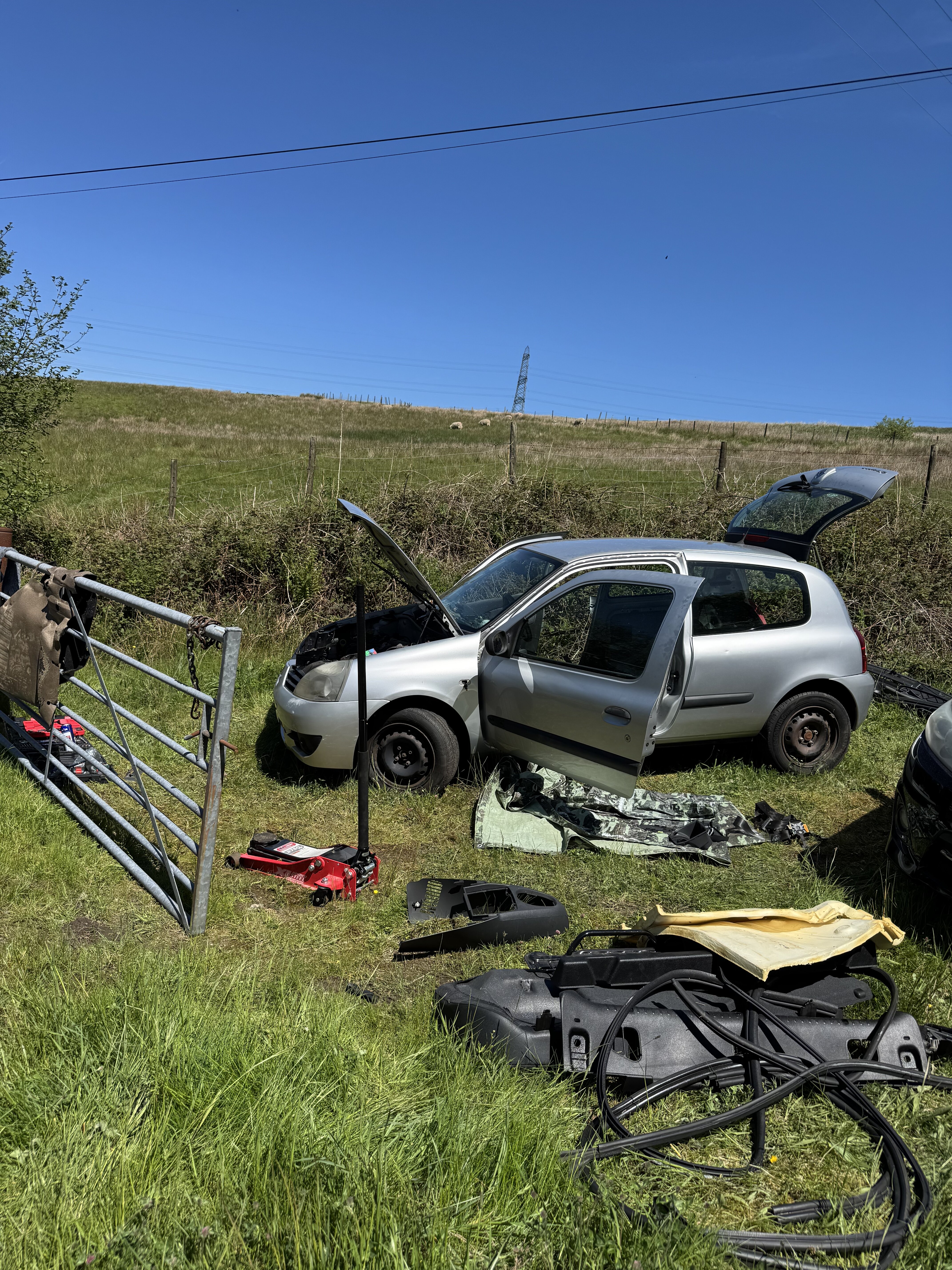

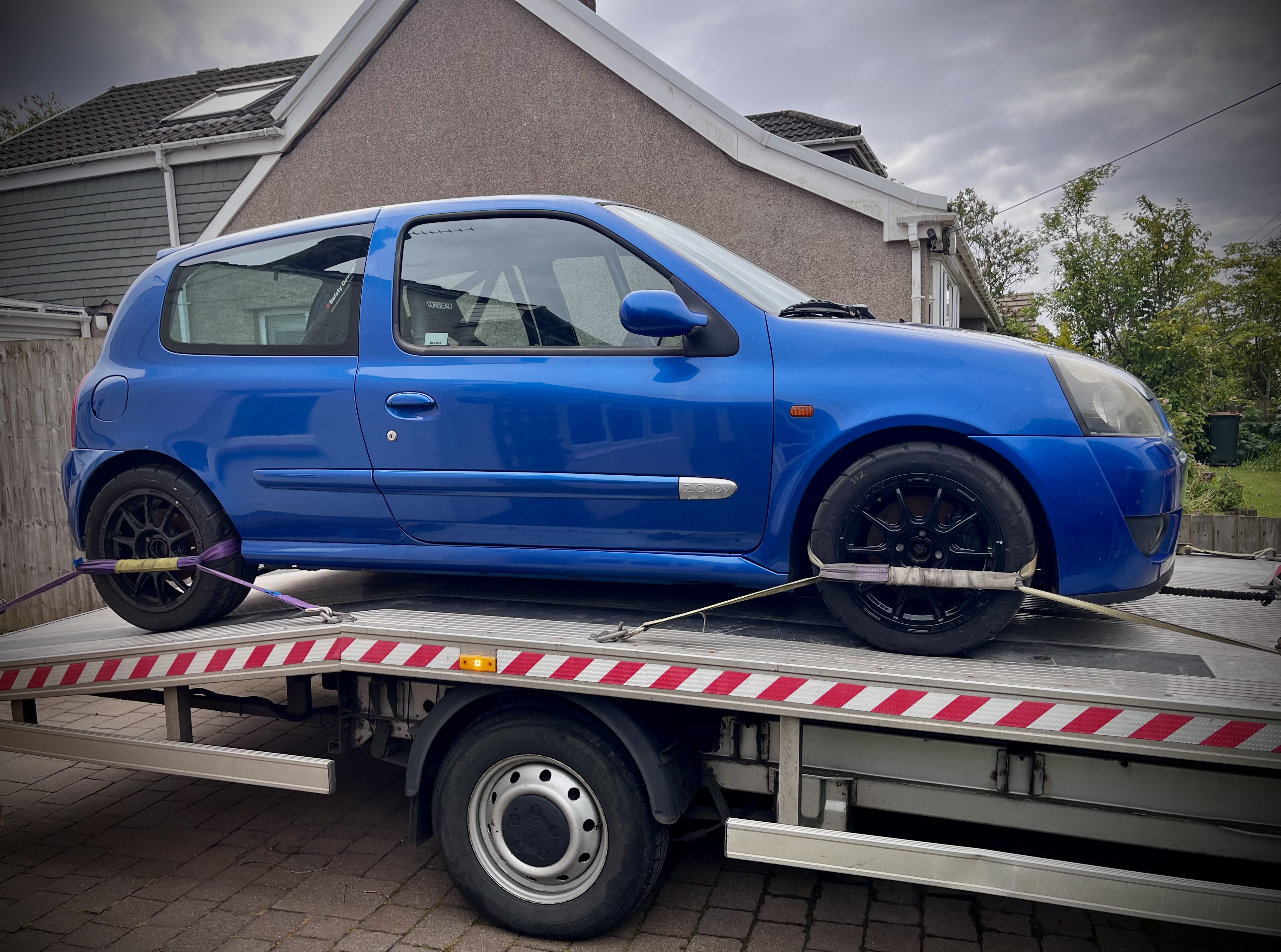

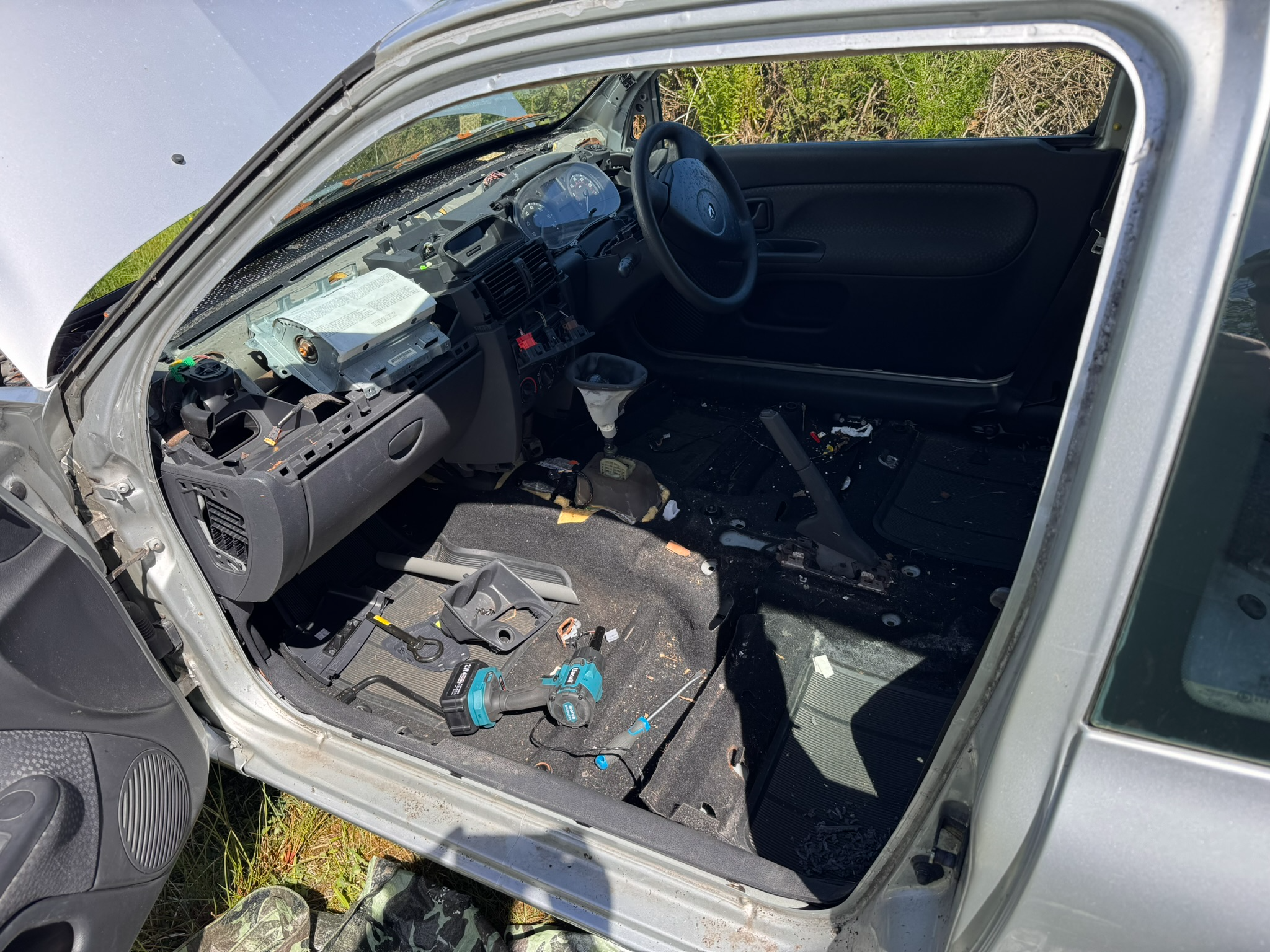

Dragged it out of retirement. Shouted at it and sent her straight to time out.
Off for wiring.
New ePAS
PMS shifter
Passenger seat and harness
New driveshafts
Brakes
Fresh fluids.
New alternator
Service/recommission.
MOT

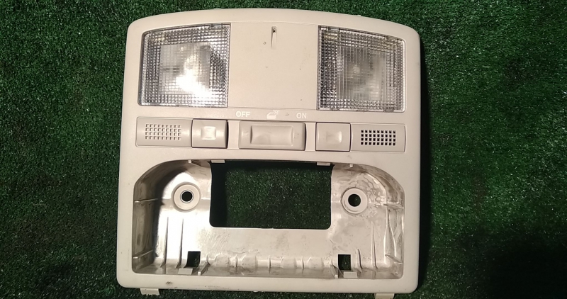

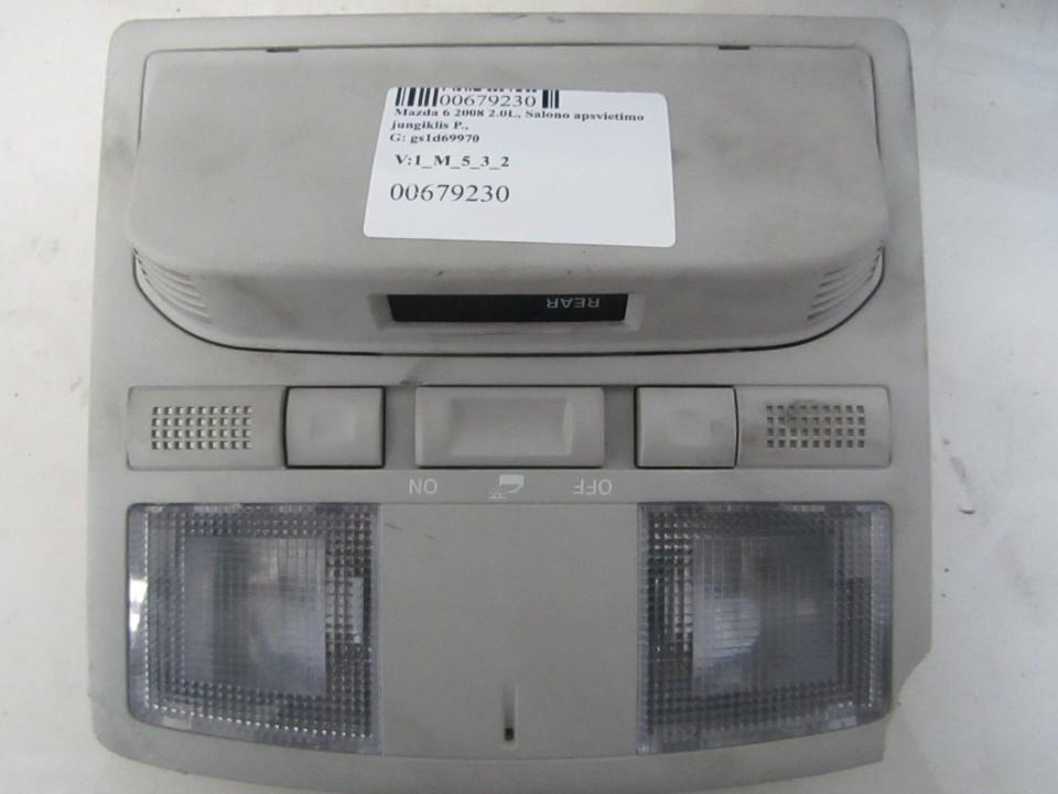

My girlfriend's car has developed a fault with the rear seatbelt sensors, where they randomly beep a warning despite being done up correctly. I decided to quickly stop the noise by simply disconnecting the little display/speaker in the interior light panel. (Pic for reference, the part with the sticker on)
Was very simple to remove, and unplugging one connector completely solved the issue 👌🏻
Unfortunately as I gently pressed it back into place, every single plastic clip snapped off so I had to remove it completely and now there's just a big hole where the display should be (another pic for reference)
I'm starting to think I should stop trying to work on cars 🤣

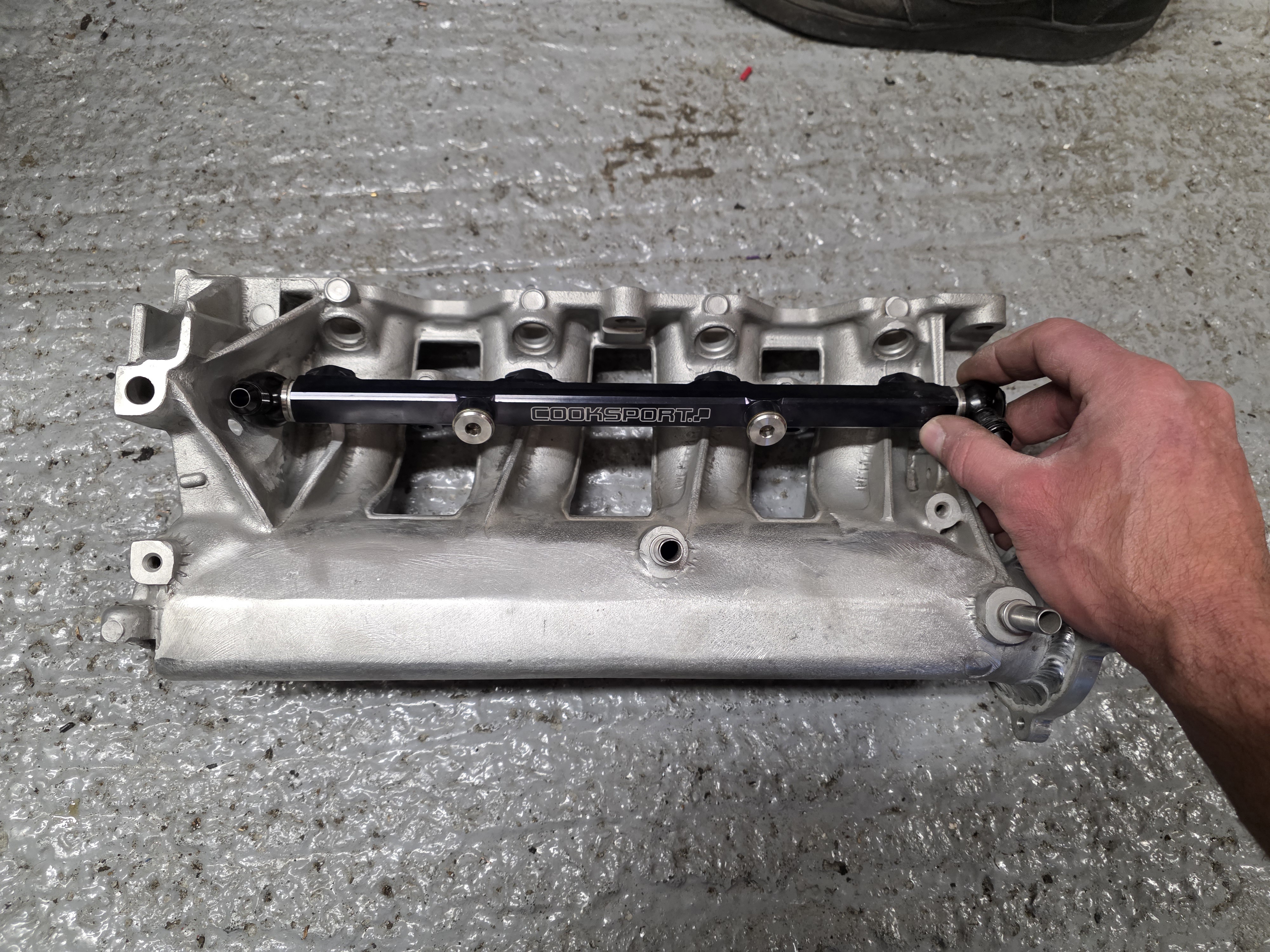

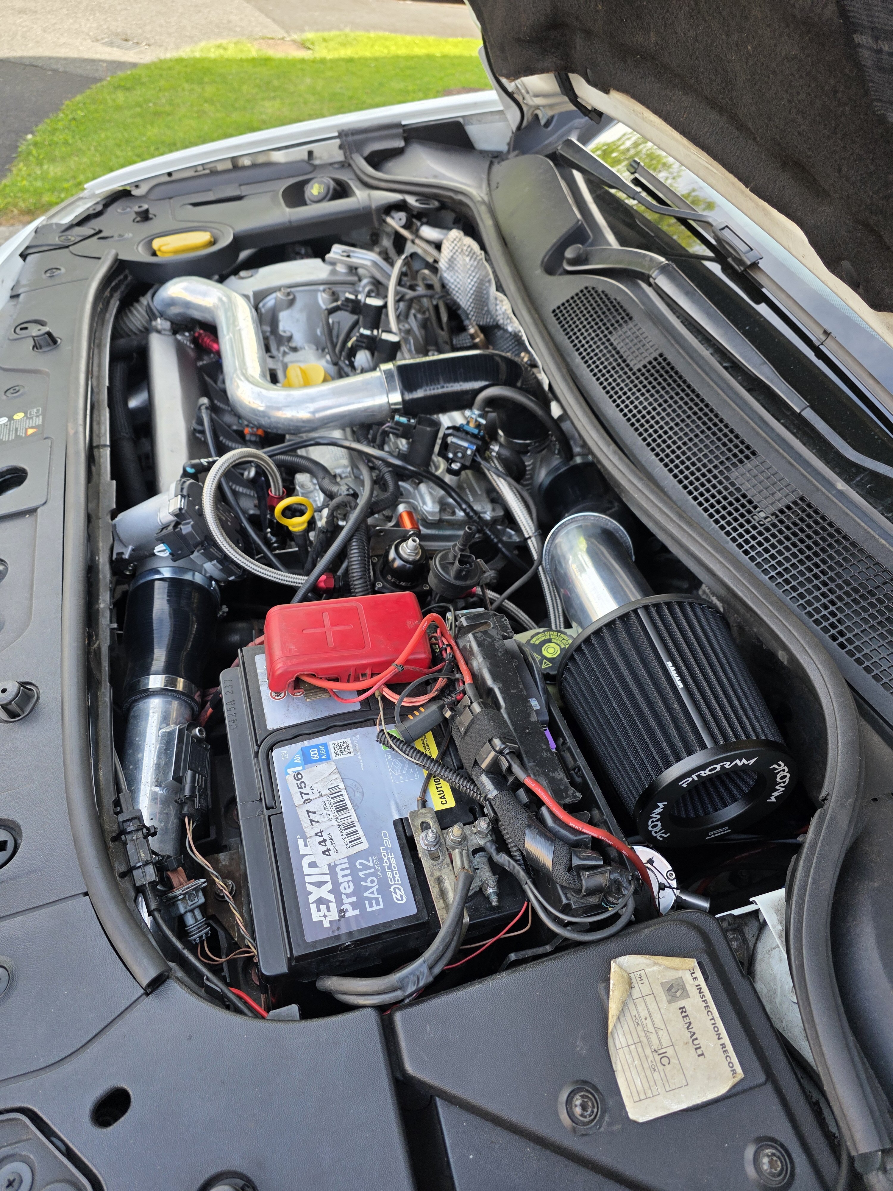

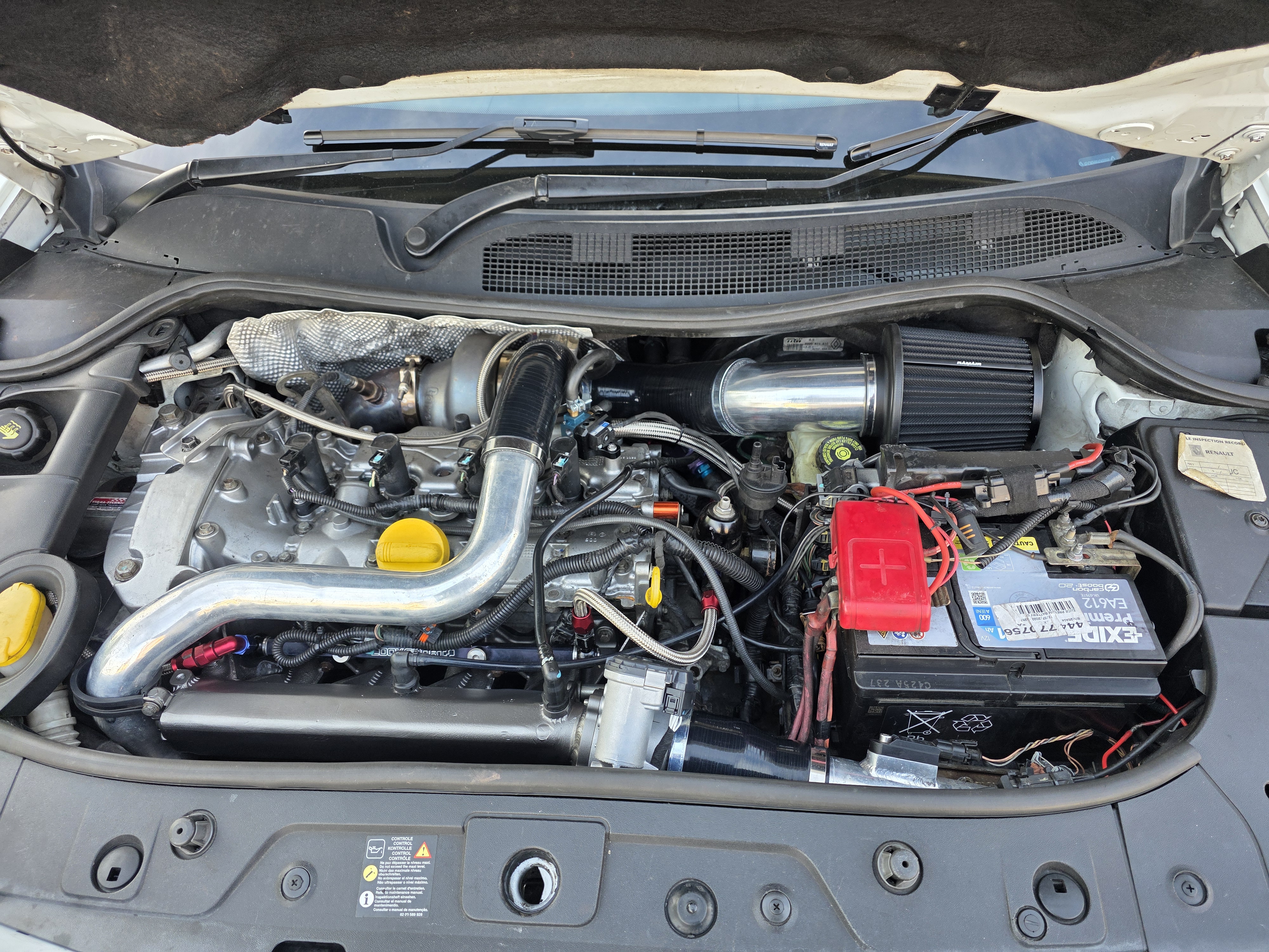

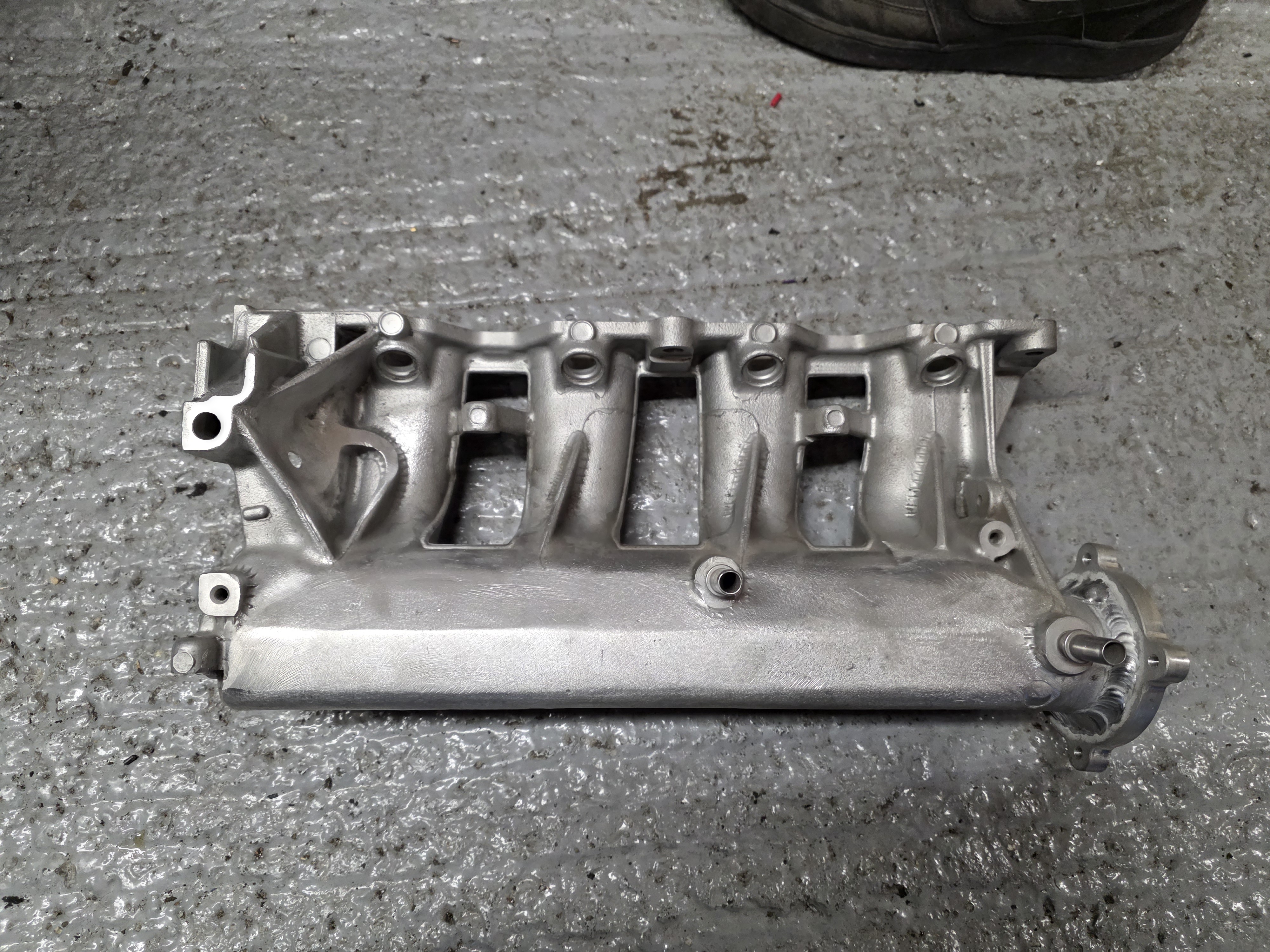

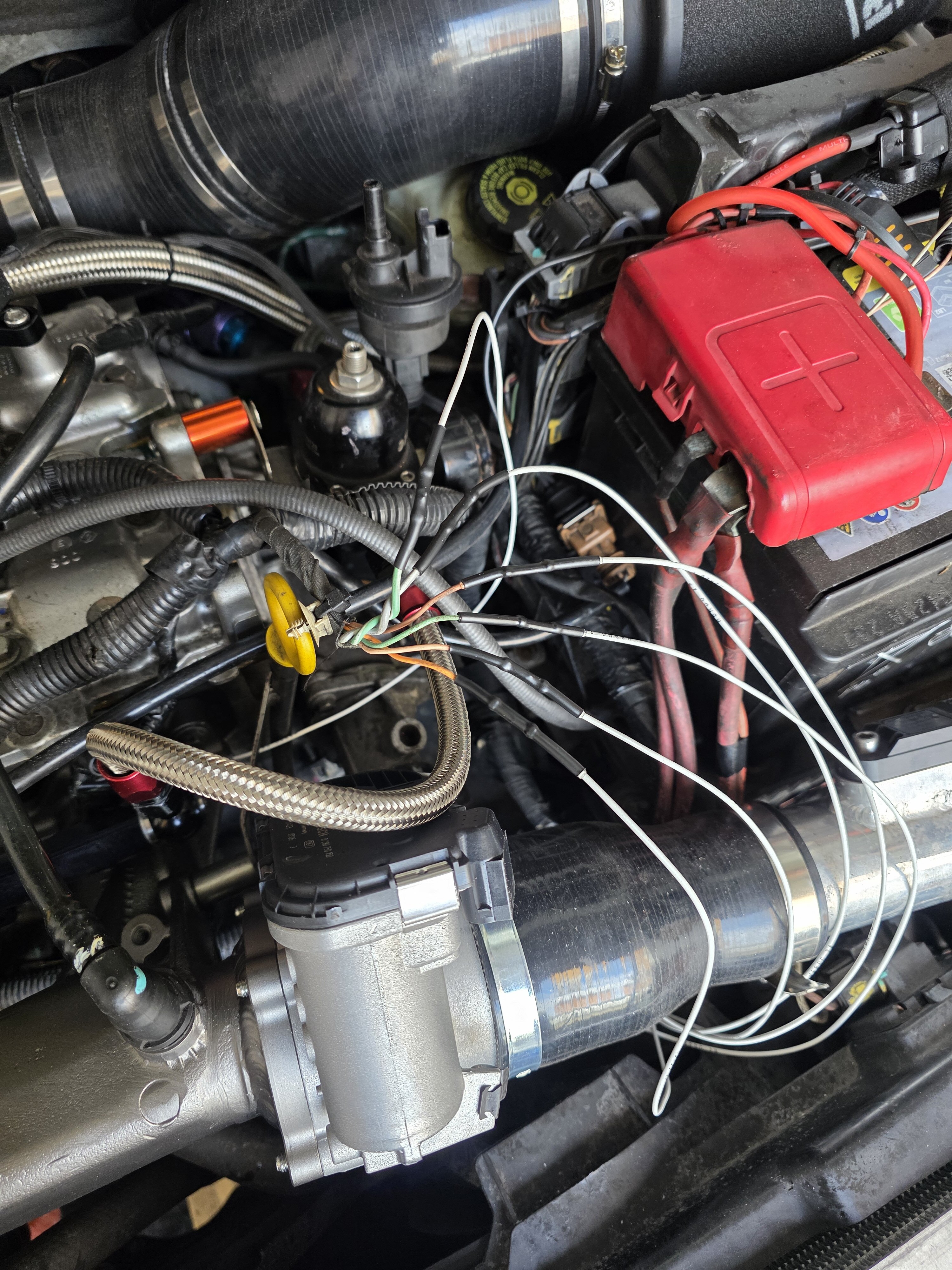

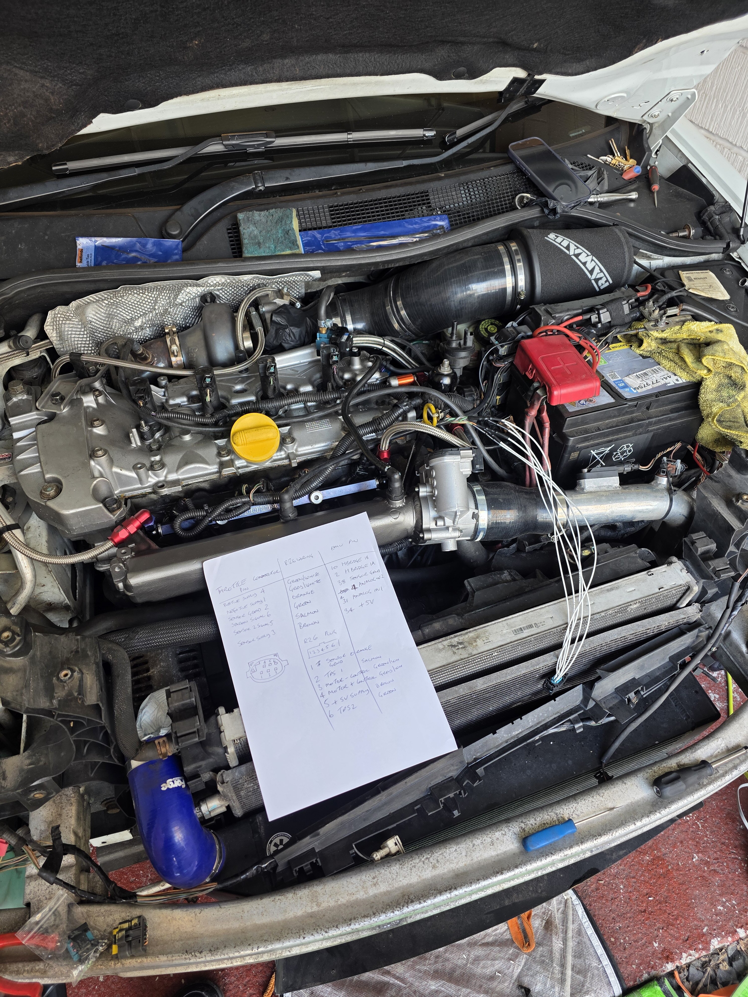

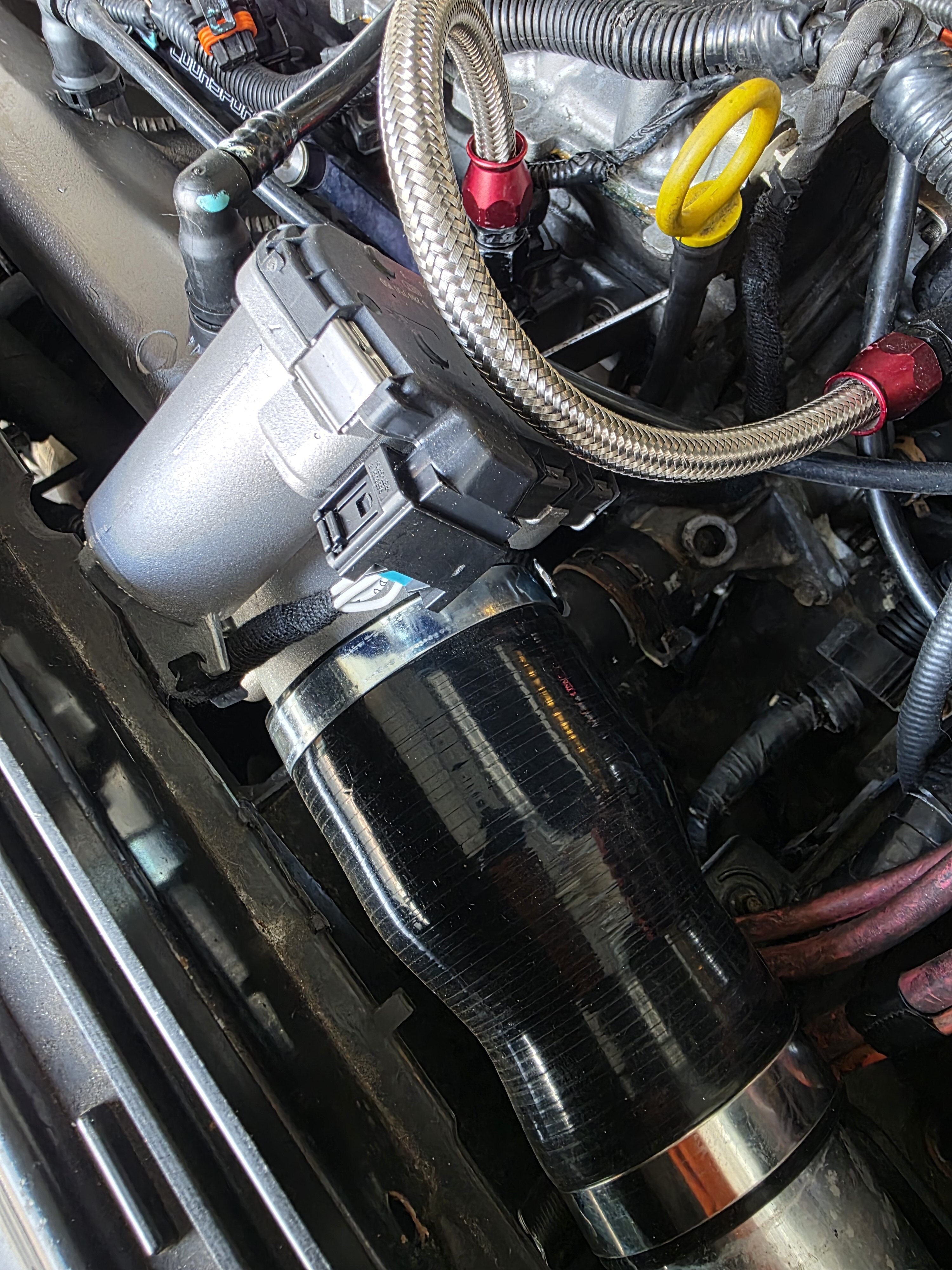

Bit of work yesterday on the megane r26 i fitted ecumaster black to a few month back.
Oem throttle was flapping all over on boost. No bolt on options so had a spare inlet manifold modified for bosch motorsport throttle. Local fabricator tig welded new flange on and i modded it for the cooksport fuel rail last week. Much die grinding😬
Fitted all of it yesterday and wired in the new throttle.
Crimp and dual wall heatshrink for solid reilable connections.
Done.
Note the s**t ill fitting intake and foam filter on the turbo in previous pics. Replaced for Brigsyspec intake. Also replaced poor fitting slicone hose on boost pipe from turbo.

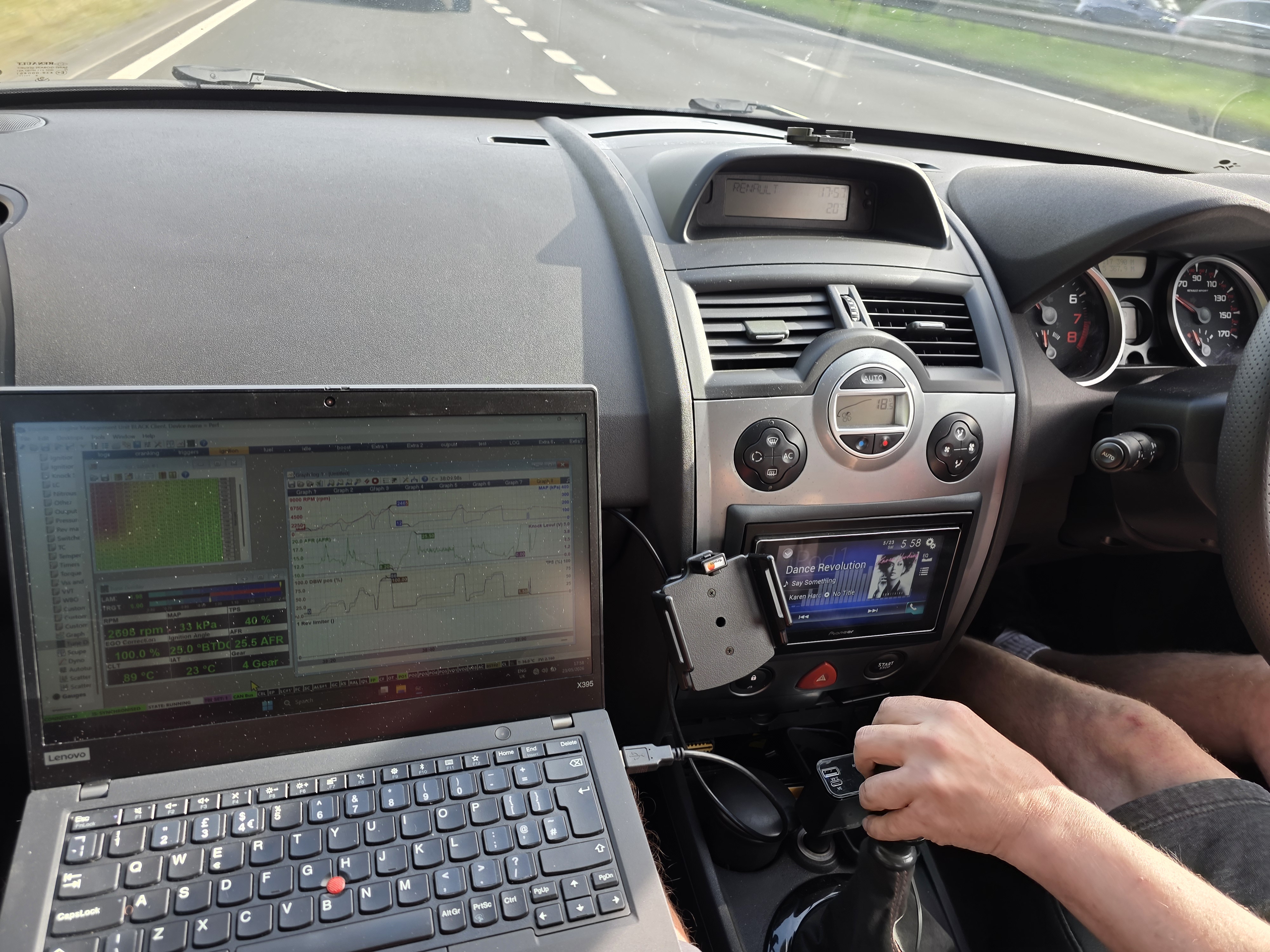

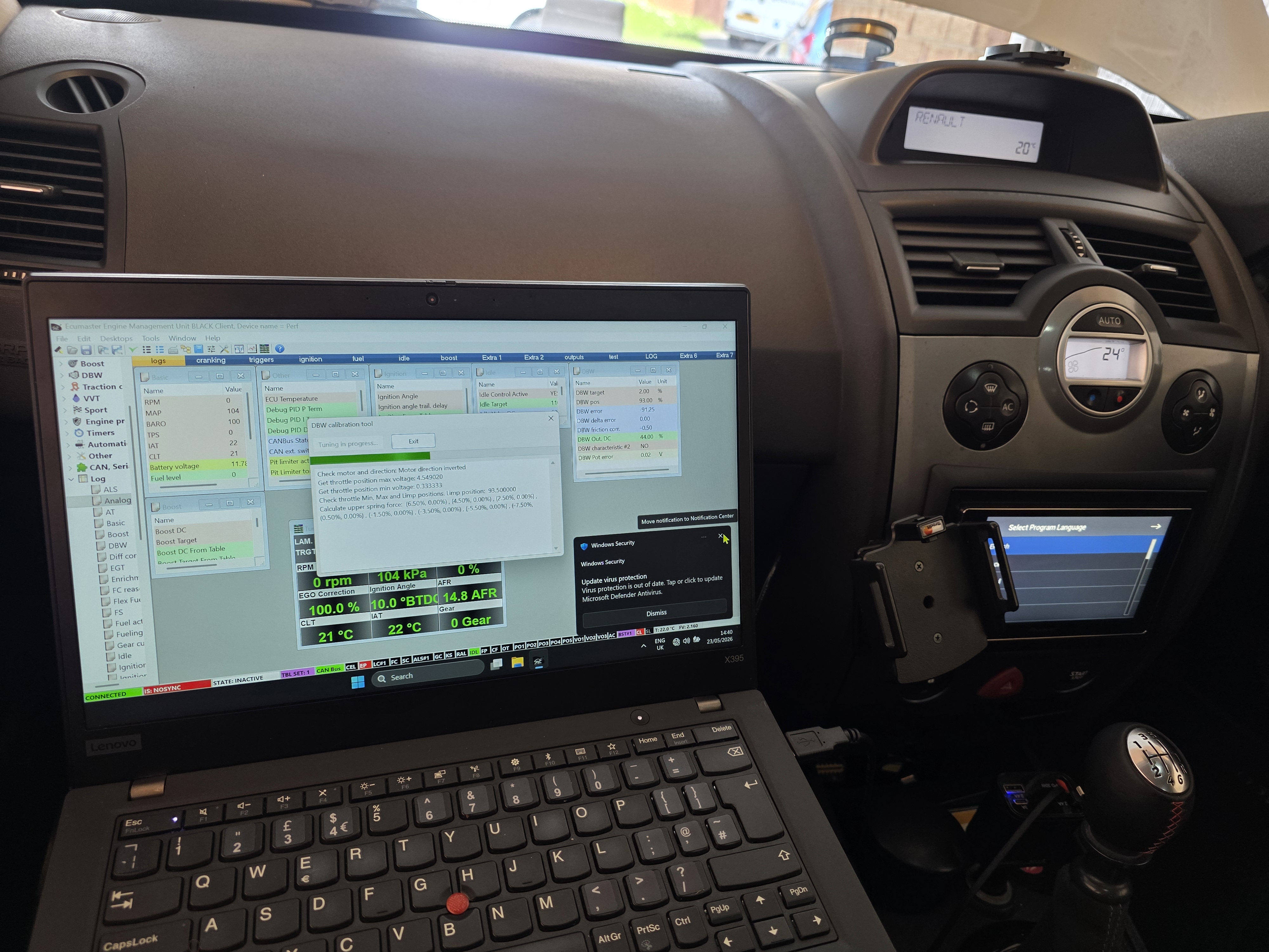

Dbw calibration done on ecumaster software.

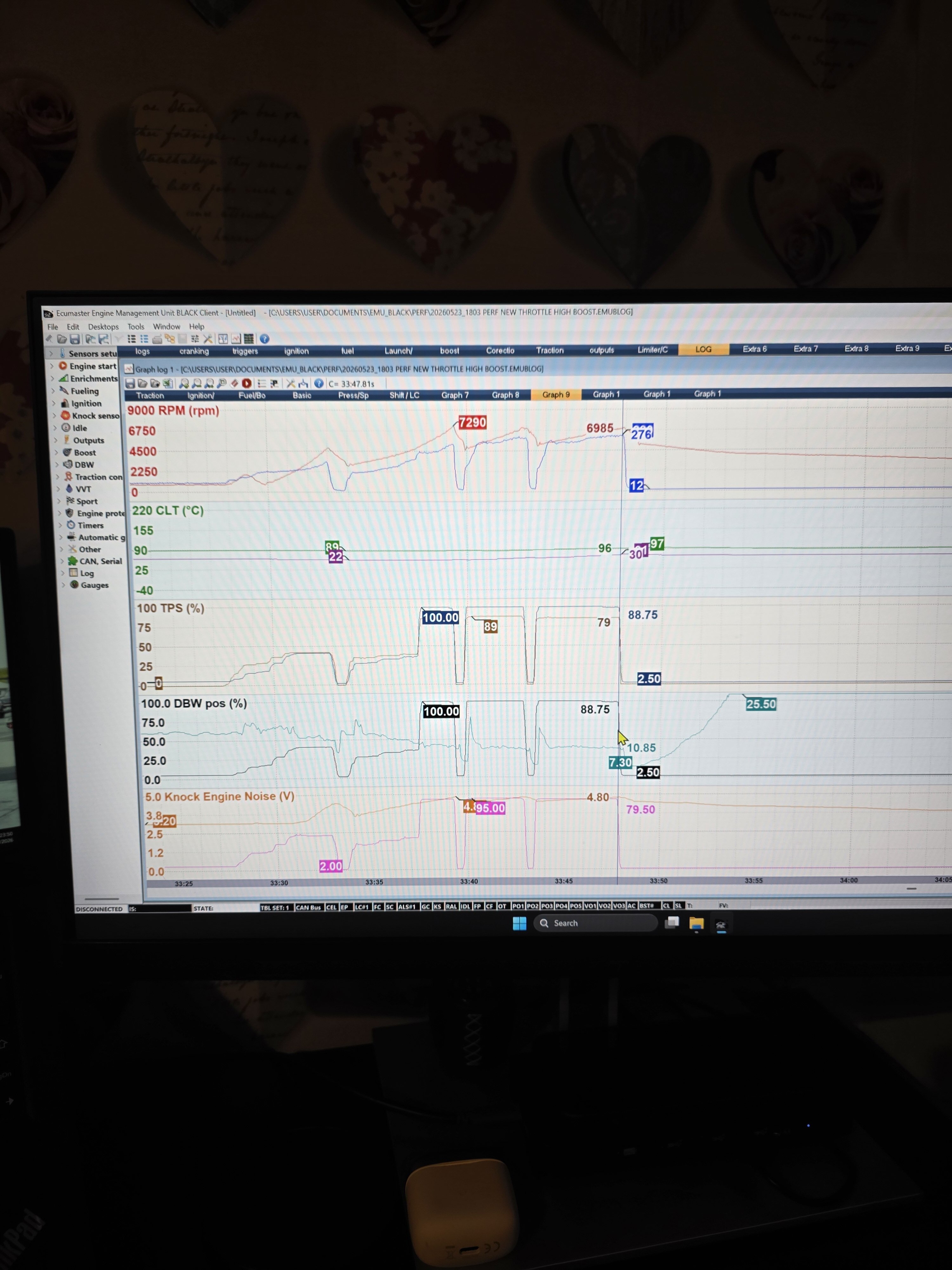

Checked function was ok and started up. Adjusted idle a bit on settings. Datalogged on road test to check afr and throttle is ok. All issues are cured, throttle stays open no flapping. New intake sounds loads better on liftoff.
Fuelling and boost still bang on the money so give it a good few pulls. All i can say is this is fast on high boost now, owner said it feels mega. Its back to Efi for a map tweak as it needs idle tweaking slightly and see if we can turn it up a little more as throttle limited it last time. Be interesting to see if it will make more than 430hp as only at 24psi boost.

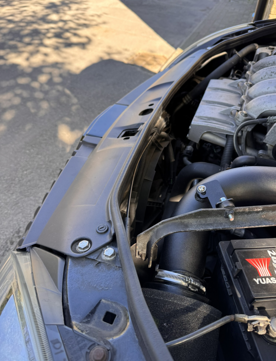

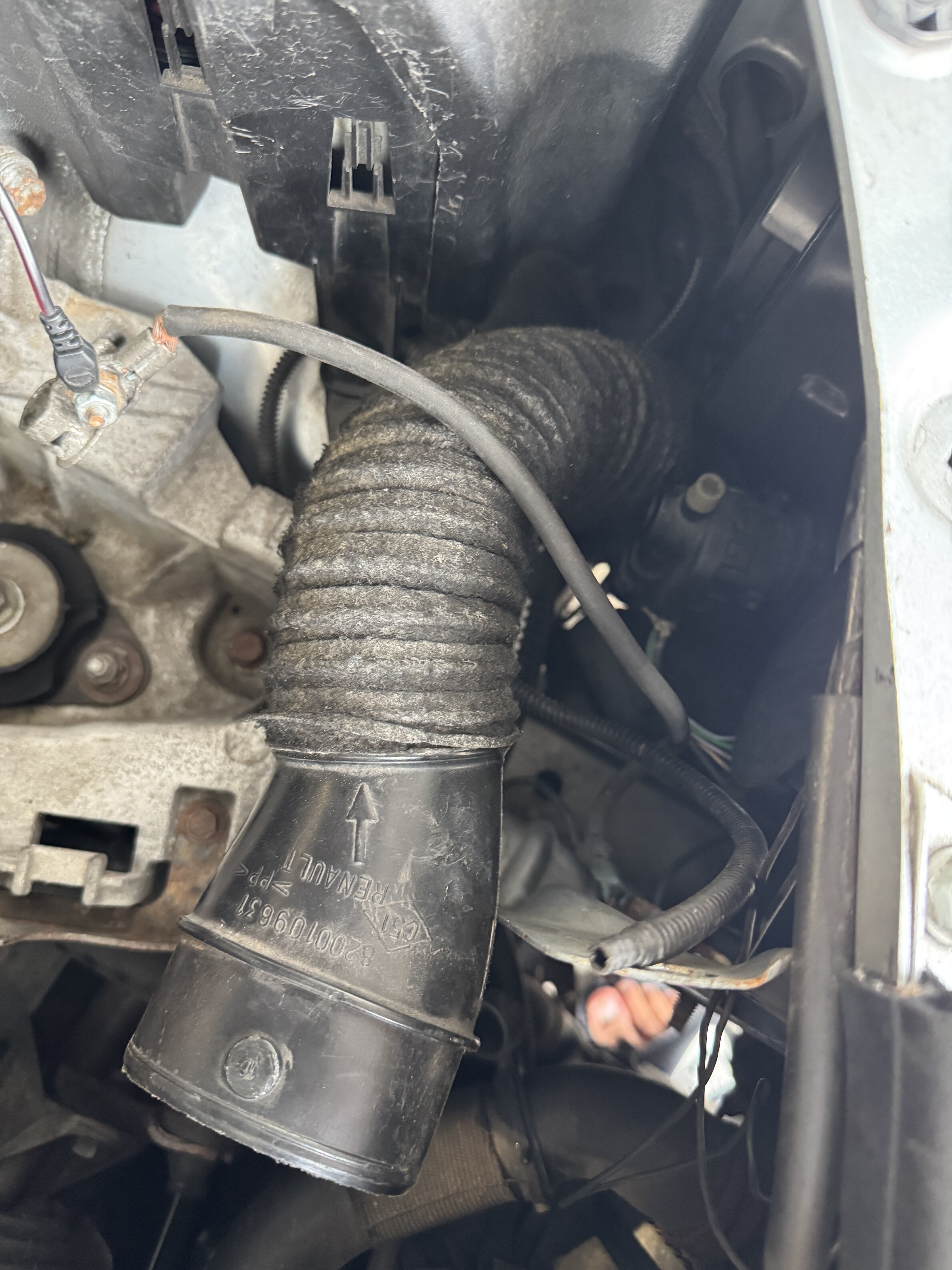

Question more than a what I have done. But to get this acoustic pipe off is it a case of bumper off and head light out to remove it?
