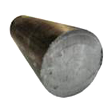

ive got the metal bar and the grinder im gonna make em up tonight
http://www.powertools-china.com/images/BenchGrinder_7270.jpg
