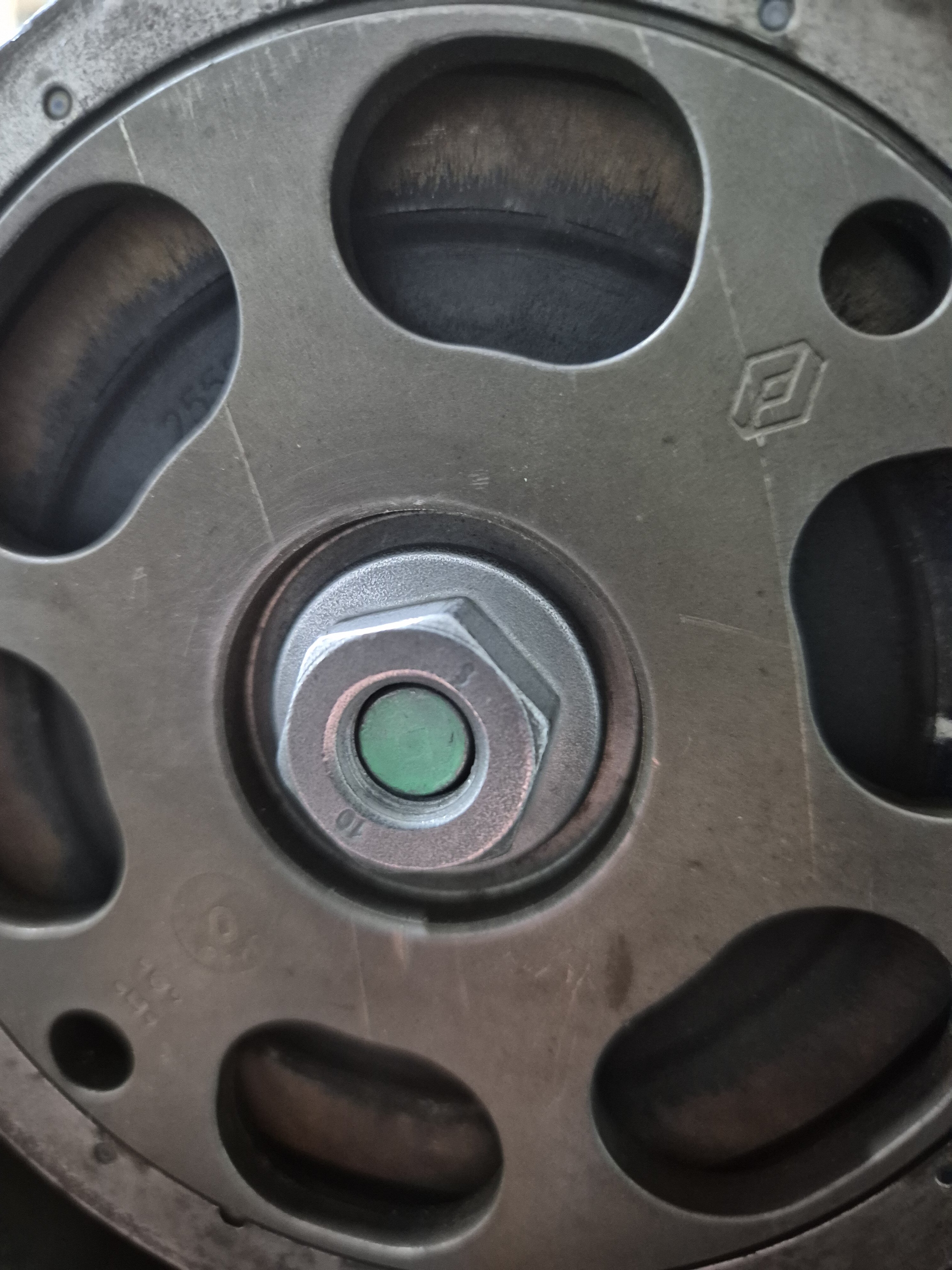

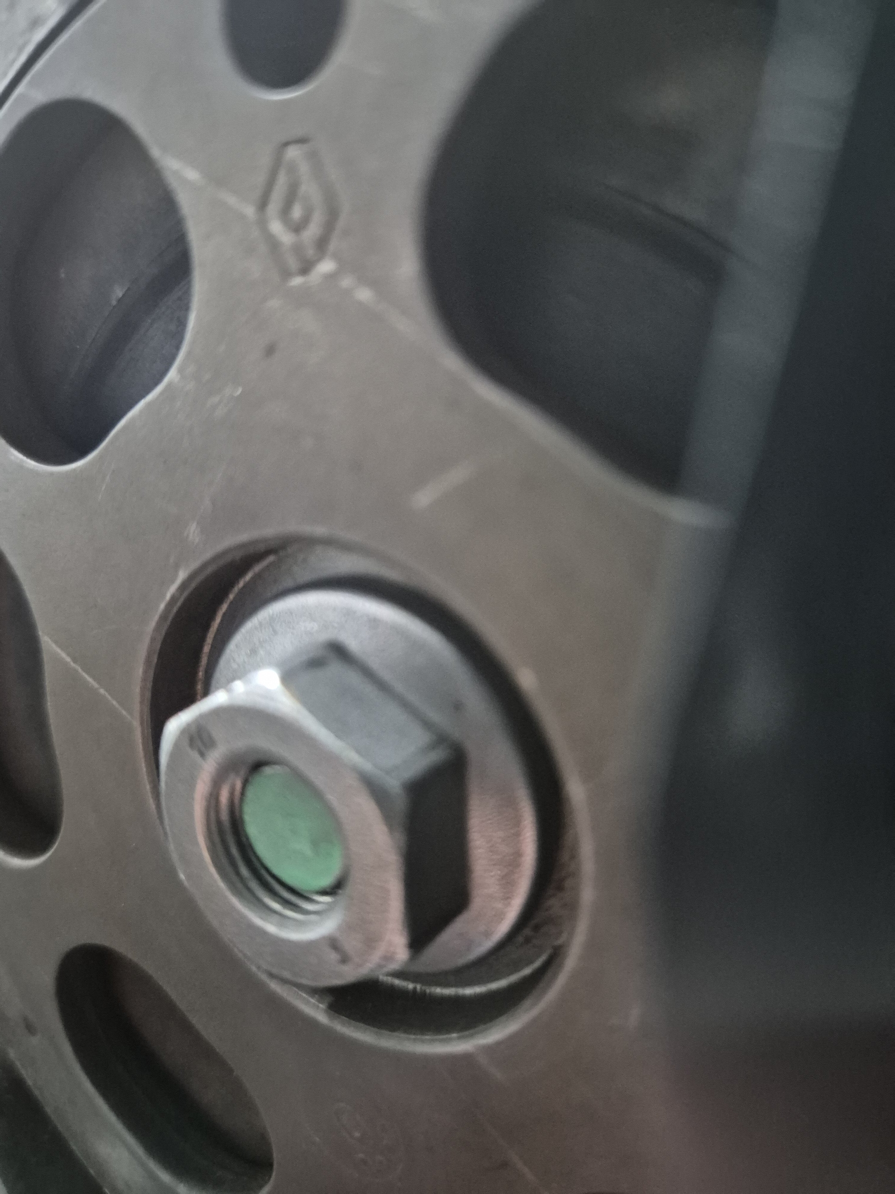

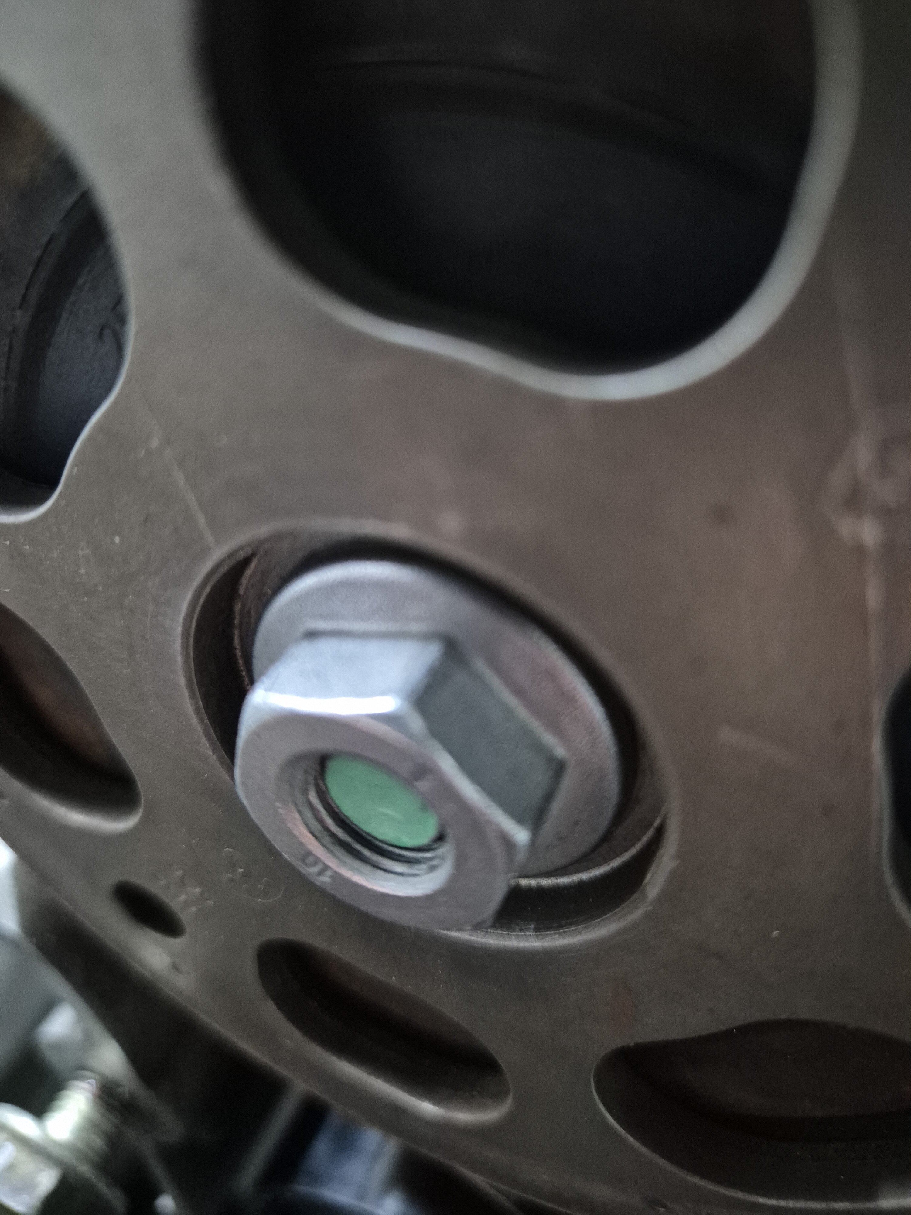

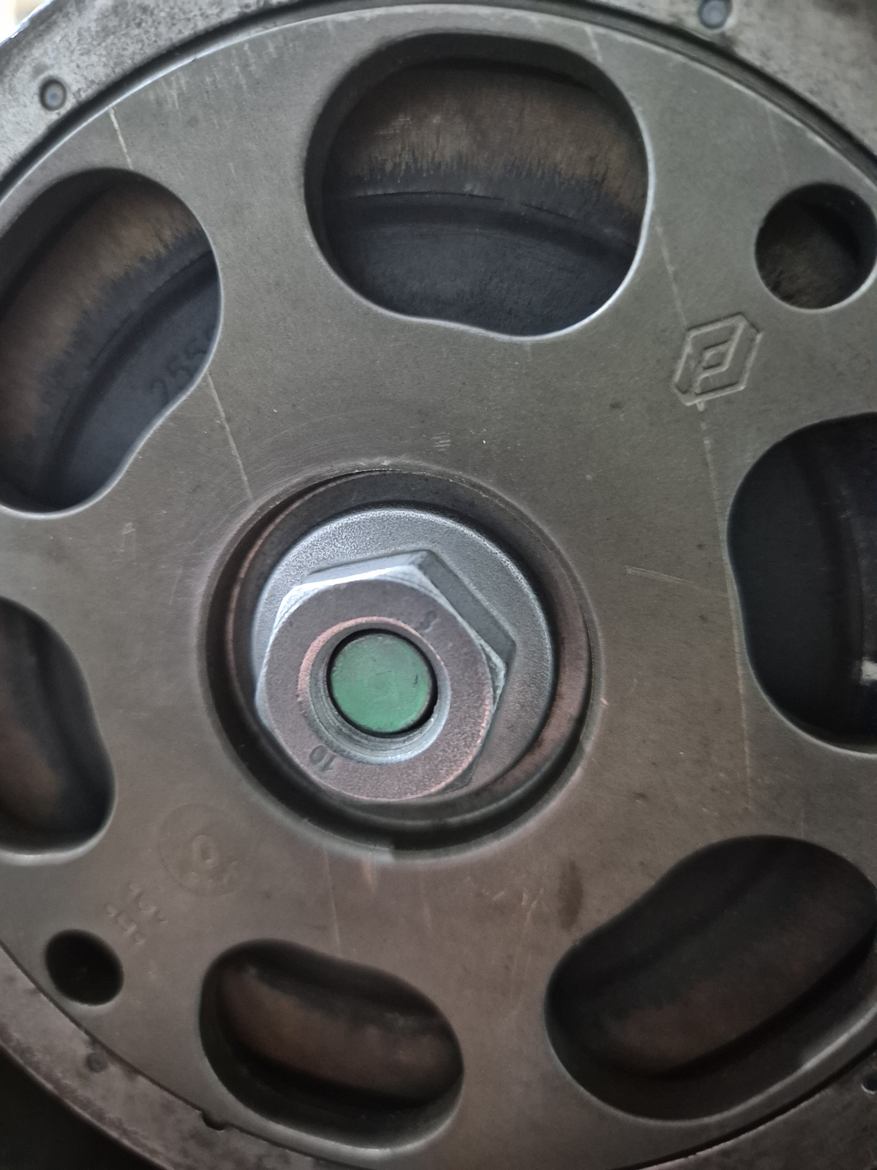

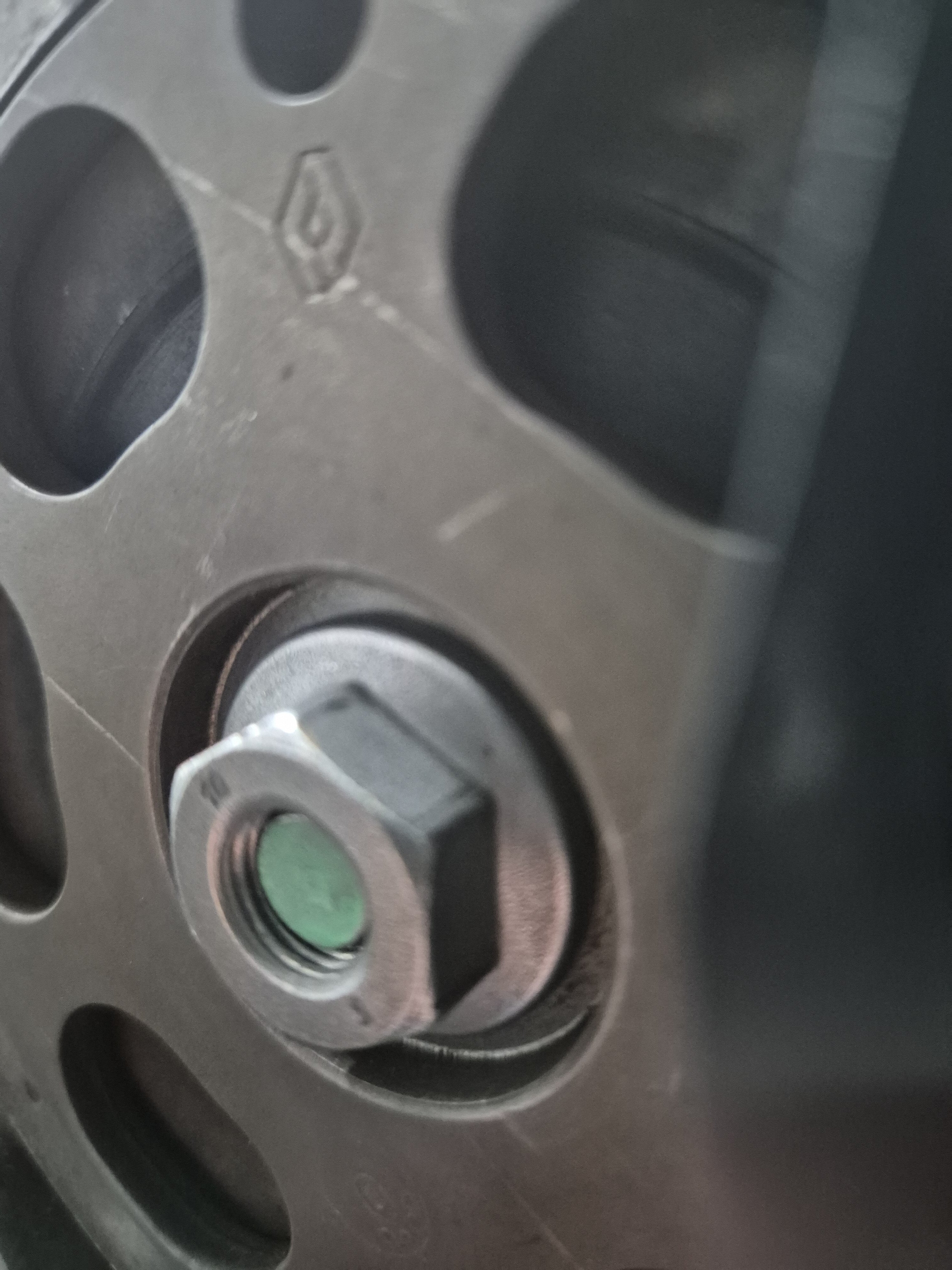

Anyone came across this issue with fitting a new exhaust cam stud on cat cams?
With the nut just nipped up (not torqued) Im not getting a full nut and I doubt I would gain 2 - 3 threads when torquing.
Genuine new stud used and wound in until bottomed out on the shoulder. Bit wary to build it like this
Mulled this over for a few days and thought must be ok as even if there was a deeper thread in the cat cams, it wouldn't matter as would still bottom out on the non - threaded shoulder on the stud
Torqued the exhaust cam and low and behold, didnt get enough 'stretch' to gain a full nut.
Have looked at other photos of exhaust cams and they all seem to achieve a full nut. Grabbed the packet out the bin to double check part numbers aswell

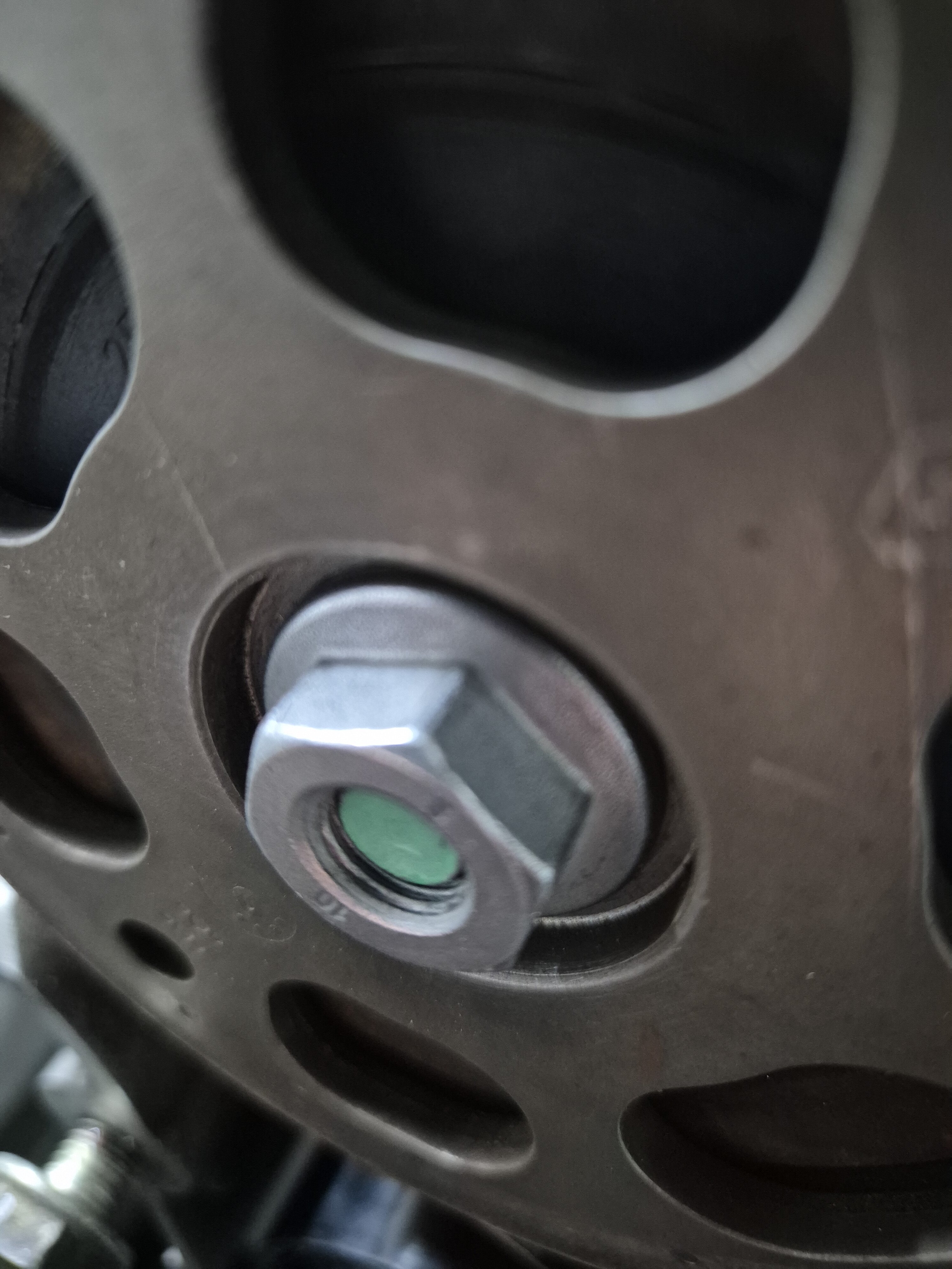

Photos for reference

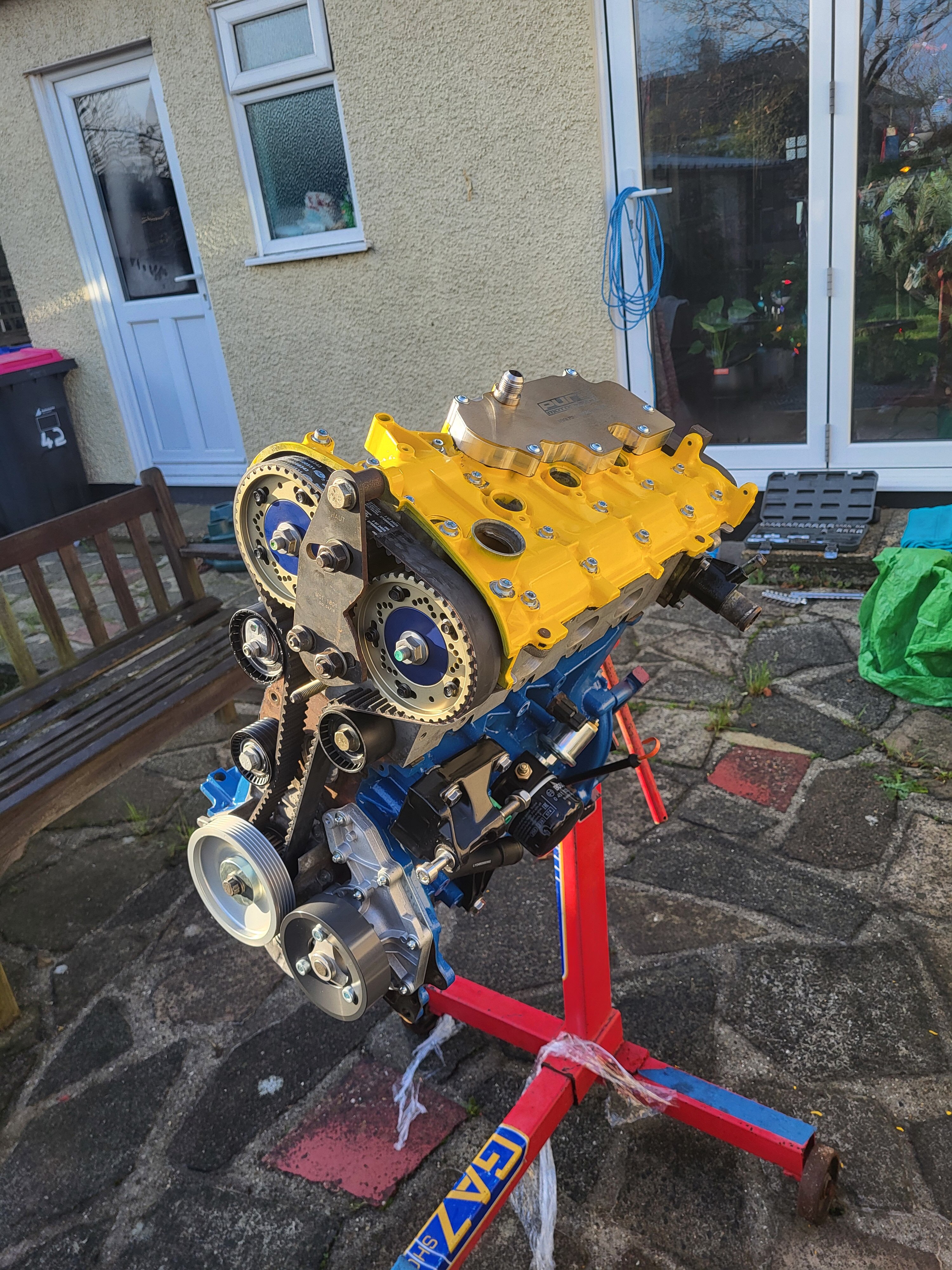

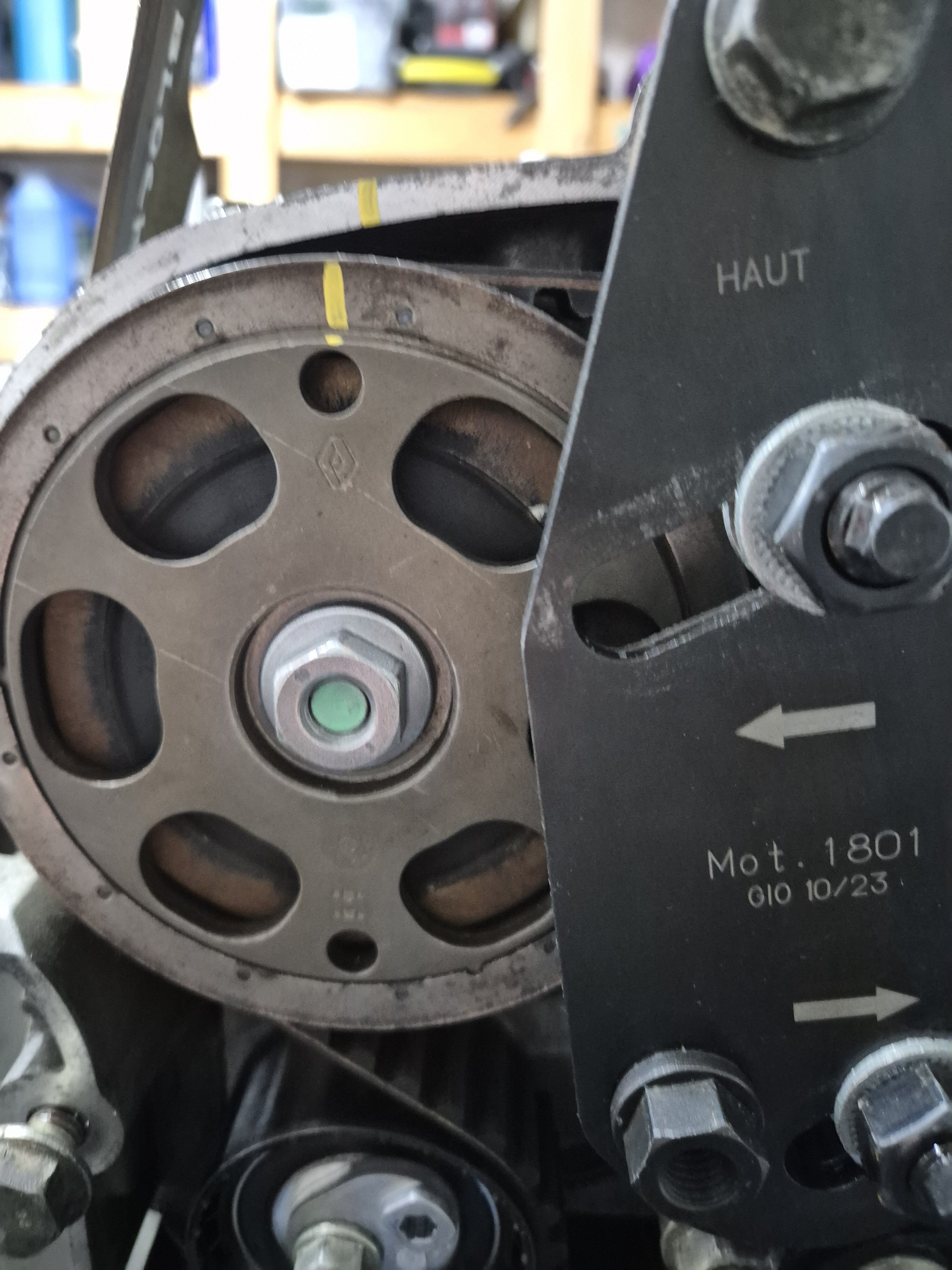

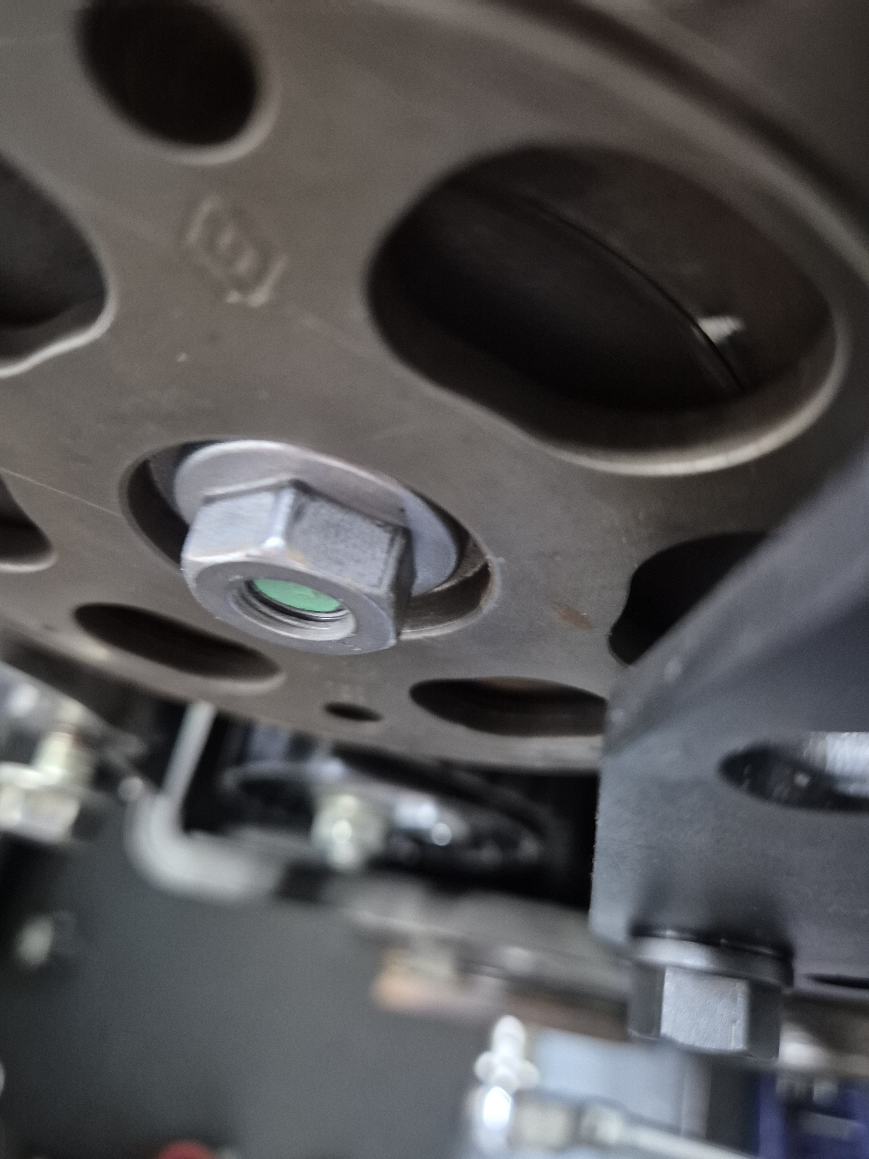

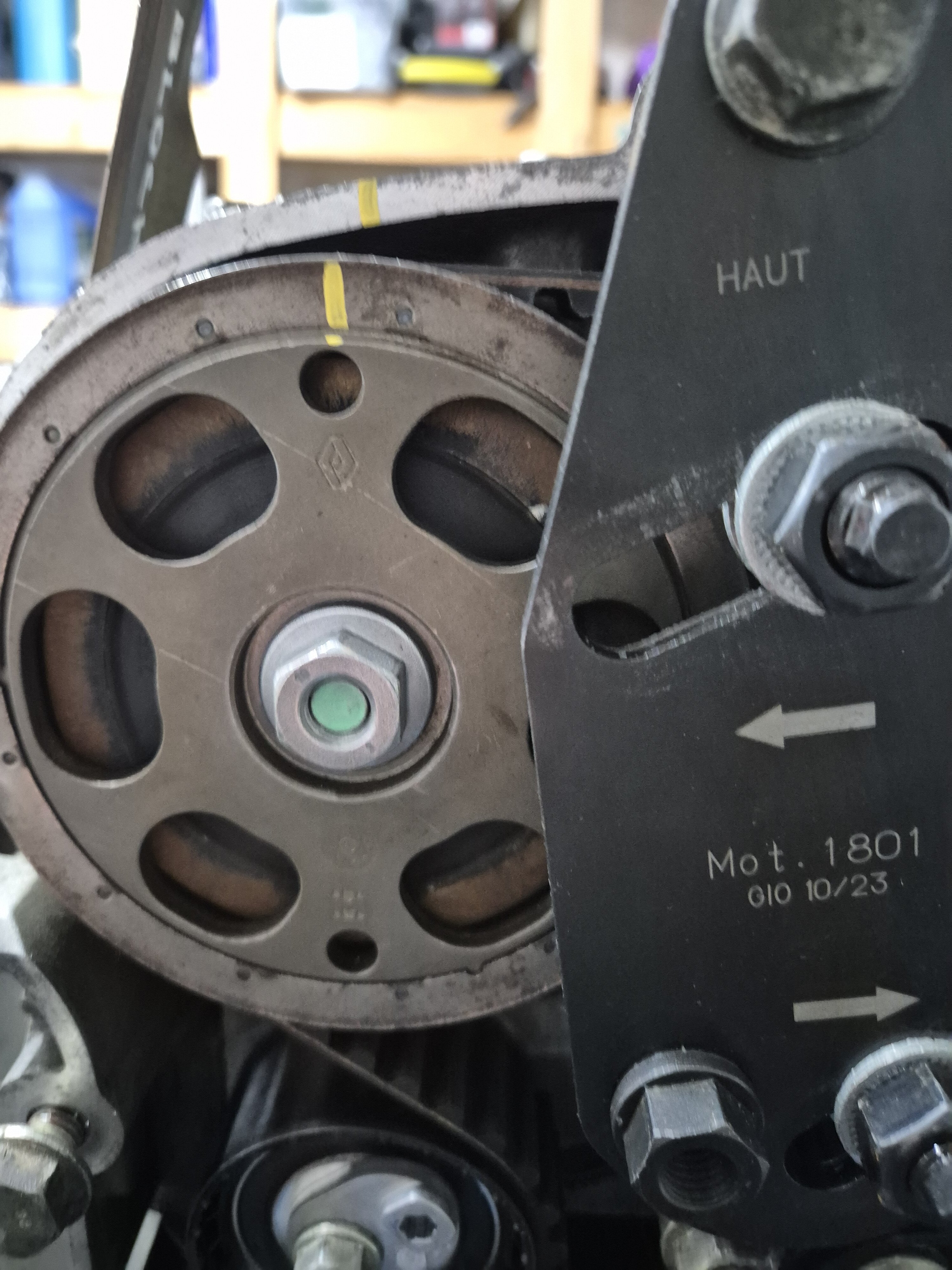

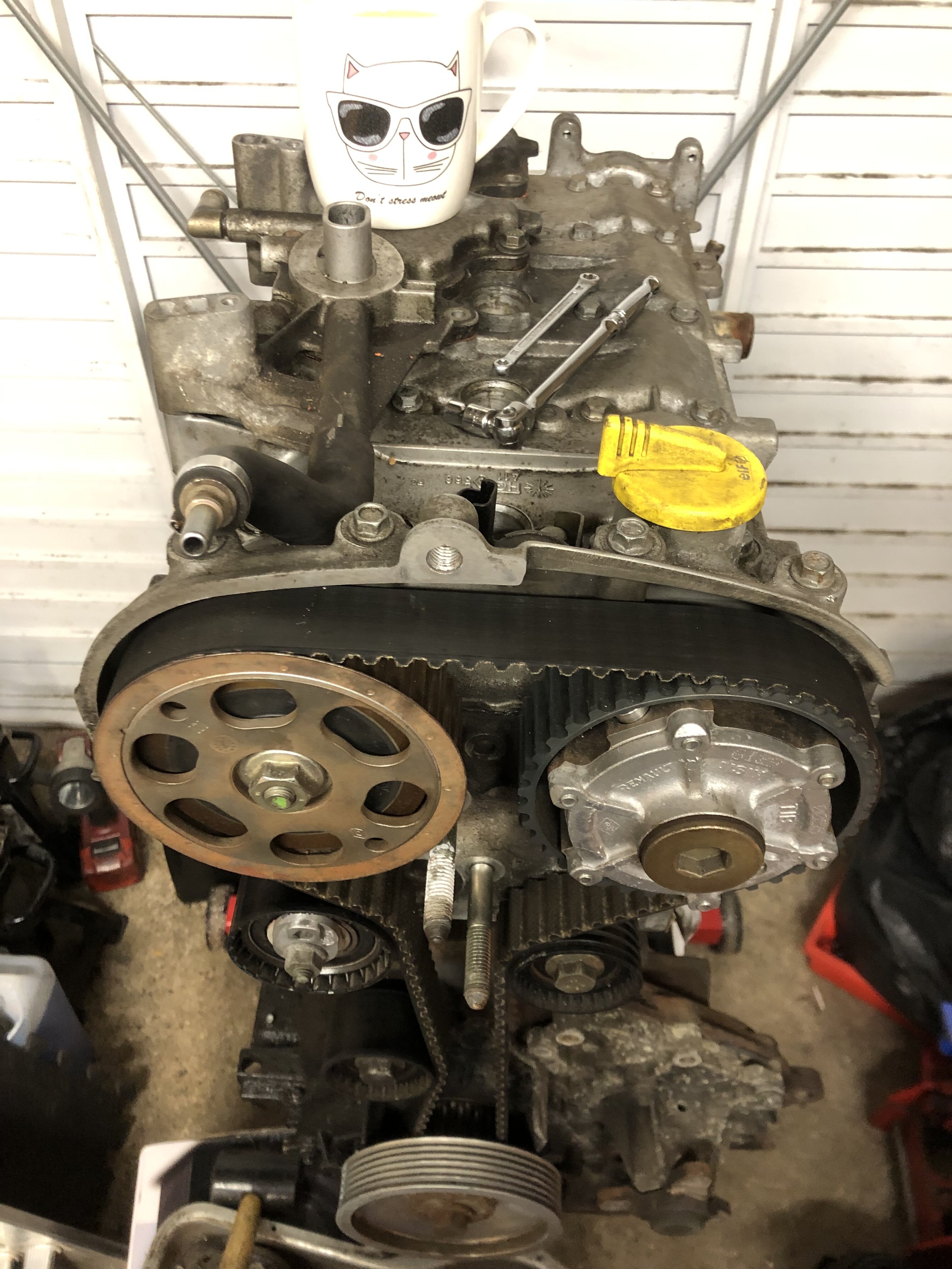

Not sure how useful it is as the pulleys are different but this is mine using catcams and the catcams stud. How thick is the OEM exhaust pulley? Could it be that the stud is designed to be used only with the catcams pulleys?

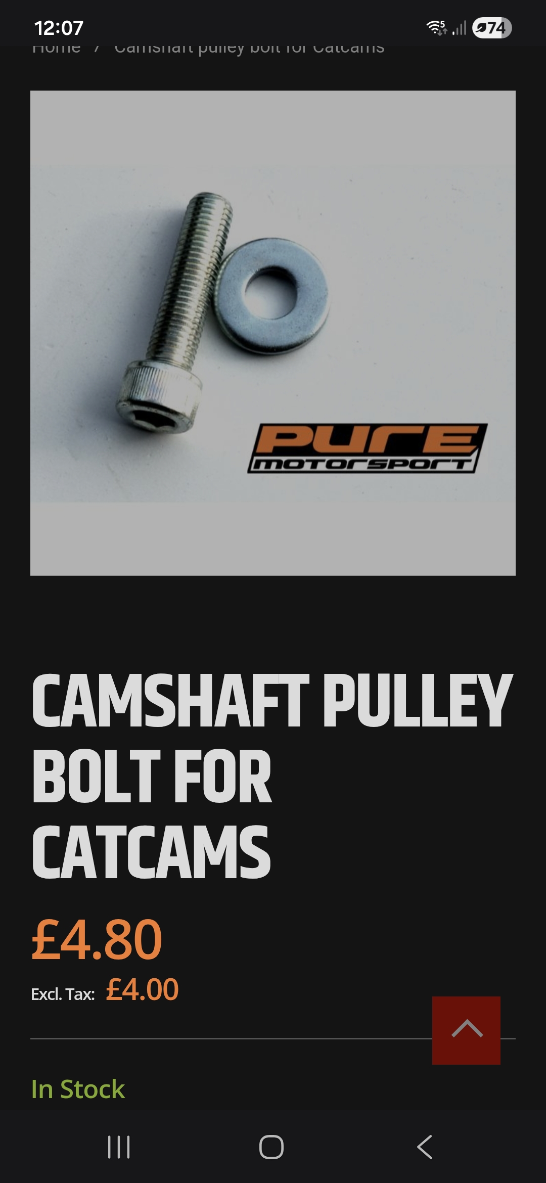

Spoke to Nick as I was messaging about the tensioner issues. The provide a cap screw for this application as the countersink on the cams swallows up some of the length.
Link below incase anyone else comes across this or for future searching.
Cheers for the info struggler, definately looks alot healthier with the vernier pulleys and plenty stud showing. Just what Id expect.
Heres hoping I can remove the stud without having to remove the cams & heat them......

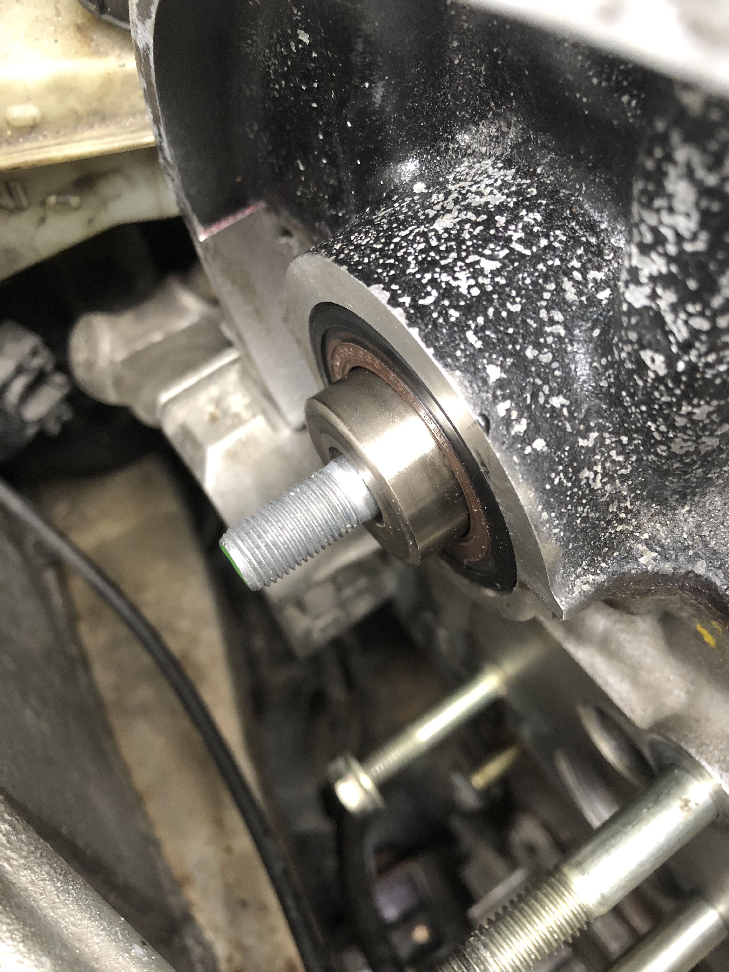

I'm surprised they're recommending that solution. Studs and bolts aren't the same.

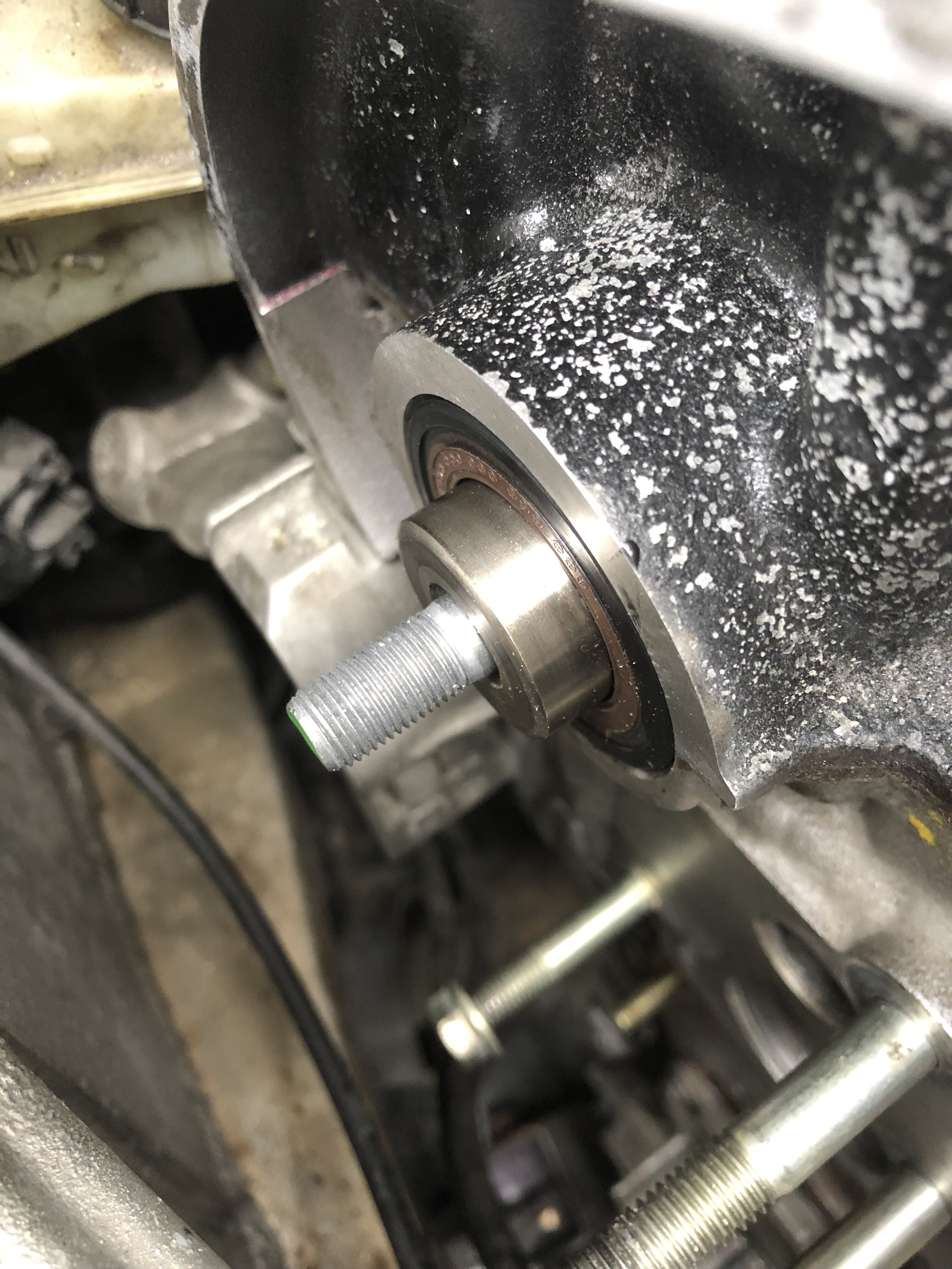

Studs also don't need to be bottomed out in a blind hole to work, I would set the stud to the correct installed length in the cam with Loctite 242 to get 2-3 threads of protrusion on the nut when fitted.
What @MAXRUNDOWN said , I myself set the stud length accordingly to the amount of protrusion needed to accommodate the nut correctly.
