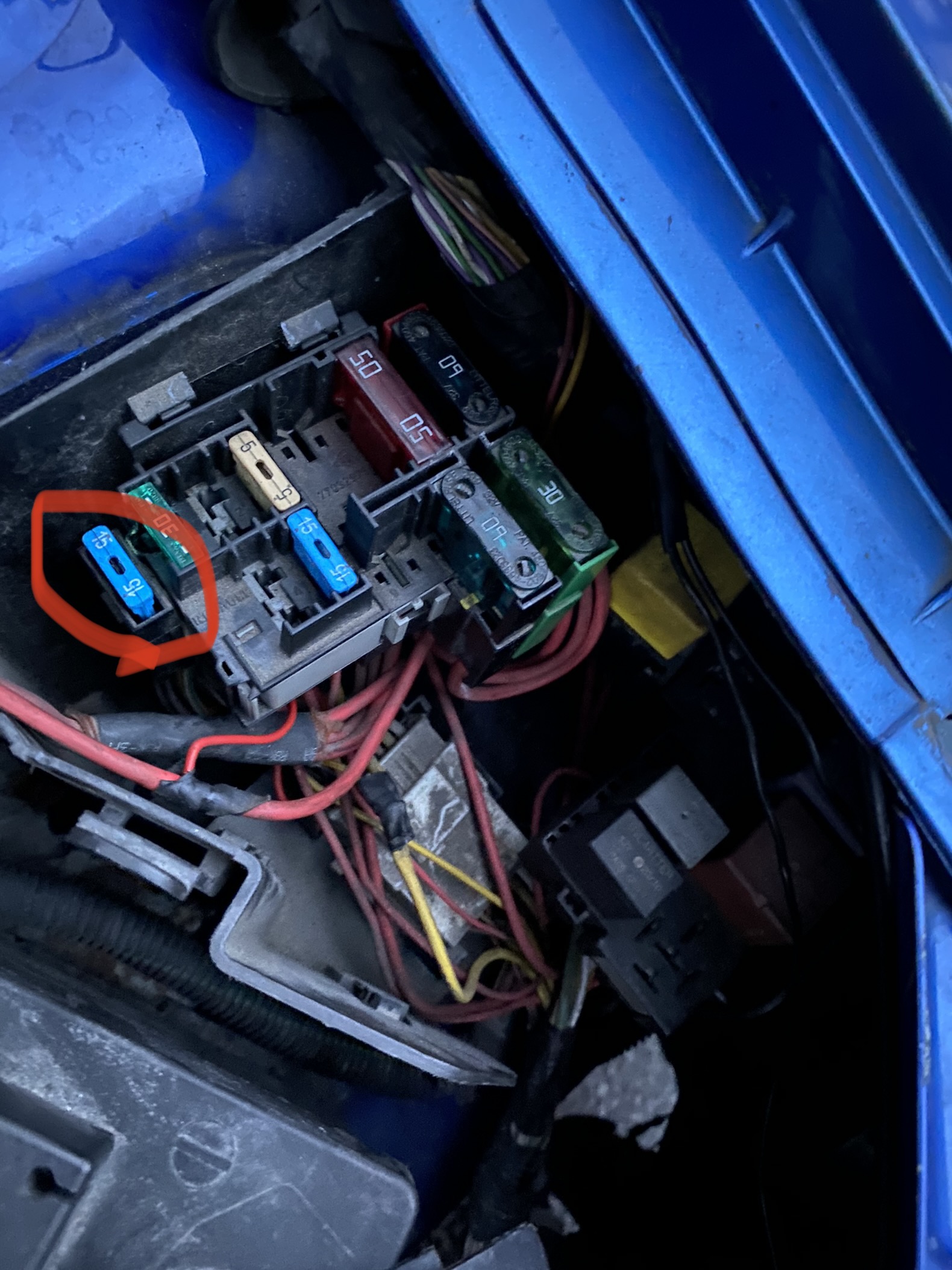

Hi everyone. What is this fuse for? Highlighted. I can’t see it on the fuse diagram.
Yeah I was going to say it’s like an “extra” because it’s not on any fuse diagram I can find.Doesn't look factory![]()
I’ve just took it out and it’s not affected anything at all. Weird.Only one 15A fuse in the box I think.
Tadaaaaa can tell I've stripped way to many lmfaoYeah ive traced it and it appears to be an aftermarket alarm, which explains why it’s always going off!
