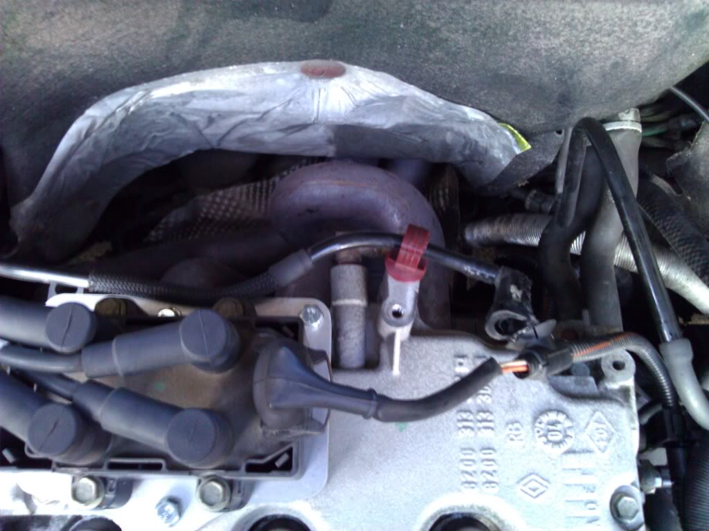

what is this?
Car  182

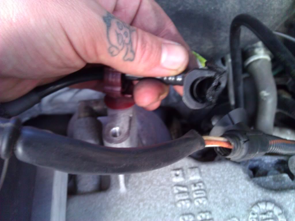

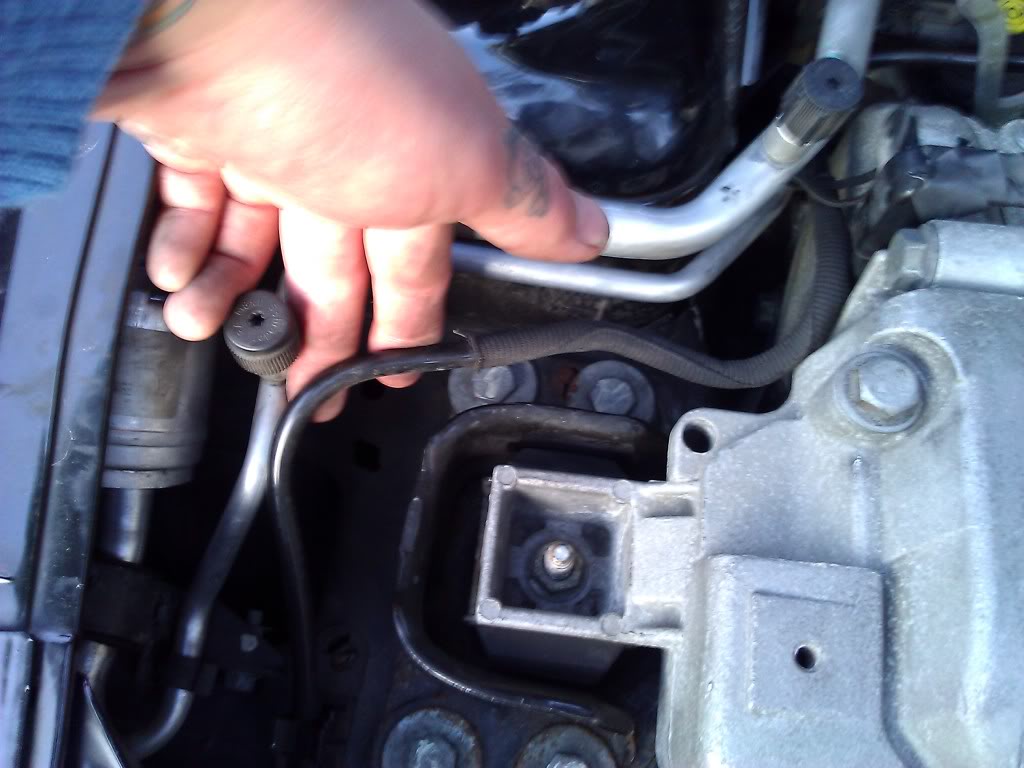

As above and do i need it? I assume its not connected to anything since i had my bodies fitted, but when i looked under the bonnet it had fallen down the back of the engine and was melted to the manifold?
goes to the carbon cannister iirc, can remove it along with the cannister now you have itb's fitted
also, the 'L' shaped one under it (90 degree right), that's an oil breather, i would get a catch tank rigged up to that to collect oil vapour
don't really want any oil dripping down onto a red hot manifold
cheers for the info ill look into getting it removed then if i dont need it!
yea the catch tank is on the very long list to buy :)
