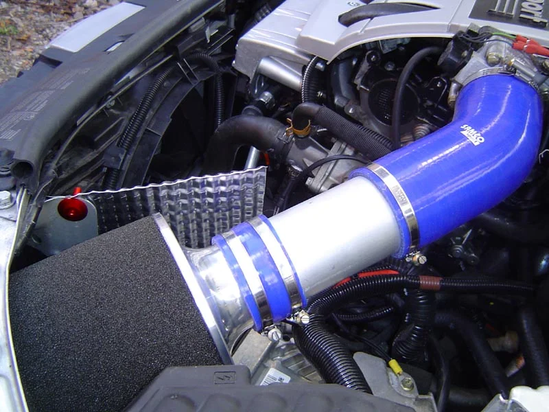

As said above. For best value, you would be better off buying a PiperX foam panel, removing the acoustic valve, uprating the induction feed to a 70mm bore tube either to the base of the wheel arch liner or to the foglight and replacing the inlet elbow with a silicone item. This little lot can be done for £50-60.
I can't see a Viper gaining much on that lot.

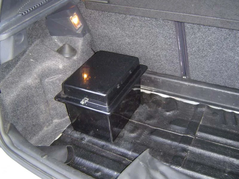

If you put the battery in the boot you can have an open filter behind the headlamp.
If you do it yourself cost would be
£50 for batt box
£30 cable and connectors
£90 for ITG maxogen filter and samco hoses and alu joiner
Here is a pic of mine.
