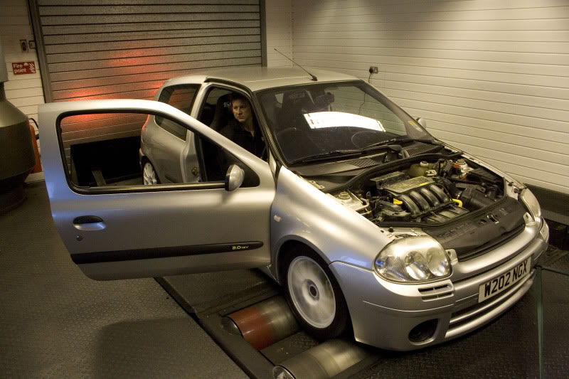

Wurzel’s Renault Clio 172 rolled off the production line in 2000 and it has been cared for like a little baby. The 70,000 mile motor has, as you’d expect from our anally retentive crayon monkey, been serviced on the dot. So it’s fair to say the Renault is as fit as a butcher’s dog.
///Stock filter - £14///
In factory form the 2.0-litre 16v lump made a healthy 173.2 bhp and 144.1 lb/ft of torque. As you’d expect the induction note was quiet, refined and, well… standard sounding.
The drive: Out on the road the car sounded like a standard Clio 172 – refined at lower revs and then roarty at the top-end. In stock form the induction note was pretty good and the car didn’t feel strangled at the higher end of the rev range like some cars do.
Verdict: The OEM (Original Equipment Manufacture) filter is a cheap paper item that does a good job of filtration and the stock air box doesn’t look too restrictive. Wurzel’s Clio pulled hard all the way through to the redline suggesting that the air box is well designed. The OEM paper filter will have to be thrown away and replaced with a new one at each service and it can’t washed in between service intervals. And with the UK’s shitty, dusty, dirt ridden roads it’s wise to replace your air filter more regularly than recommended in the service manual to retain optimum engine performance. Because OEM filters aren’t washable, this means you’ve gotta bin you old filter and replace it with a new one. This is wasteful and bad on your wallet. Bad times.

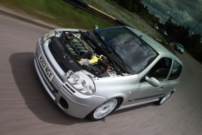

Heat soak occurs when heat generated by the engine warms the air being sucked in through the intake to the motor. By volume cold air contains more oxygen than warm air. Cold air allows your motor to burn more fuel, which results in more power. So heat soak is bad.
///Pipercross Viper induction kit - £195///
The Viper was one of the first enclosed induction kits to hit the market back at the end of the 1990s. At the time there were few other kits similar and it was an instant success on show cars, street race weapons and daily drivers. Now, the kits are still a success and deliver great results on many motors. Designed to massively reduce heat soak, the Viper features a top quality Pipercross foam filter surrounded by carbon fibre which acts as a heat shield. On the rollers, the Viper performed much the same as the Powertec SL-1 induction kit with peak power at 172 bhp and a max torque figure of 142.5 lb/ft.
The drive: On the road the Pipercross Viper was comparable to the Pipercross performance filter we used in the stock air box. The best thing about the Viper induction kit is its ability to feed cold air to the inlet, whilst protecting the foam filter from the heat of the engine and reduce heat soak.
Verdict: Once again, Renault’s well engineered air box resulted in no benefits on the power and torque front. As we’ve already said, this set-up may be a great option if you’re planning on tuning your car with camshafts, inlet modifications and an ECU re-map. The free flowing filter combined with the sexy looking carbon fibre housing would perhaps be better suited to an engine in a higher state of tune.
WIN: Washable filter, protects from heat soak.
FAIL: Uneven power and torque curves.
