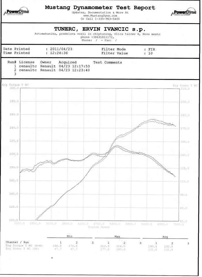

OK we had Renault club dyno day and here is my result. Clio RS 182 with 165.000km (>100.000 miles). Custom fi 60mm exhaust, to small (50mm!) cat, maped with Fastchip generic 182 map. First run is with stock airbox (+Pipercross filter) and second with JMS V6 airbox (+Pipercross filter). V6 airbox does give few (around 3) HP from 4500 RPM and few Nm (2-3) all over the graph. Not much but is better than stock.
But what was interesting is that my friends' 182 FF with only decat, Miltek and same generic map from Fastchip got 189 hp and 220 Nm! :cool: Decat is my next project. :D
So here it is, stock airbox vs JMS V6 airbox:
