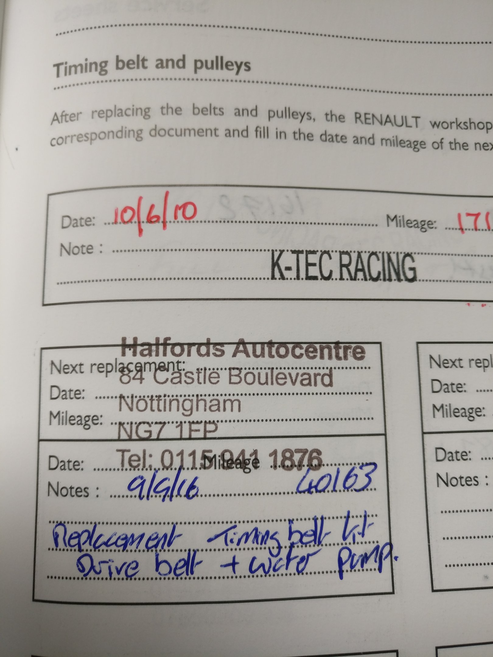

Oh yes, knew there'd be something I'd miss off the list. They were done last year and before that in 2010. It's been very well looked after.
This is what it says on the service book.

Wow, halfords [emoji90][emoji90]
Doesn't look like its had a dephaser done. Providing it runs fine and such would suggest the belt change has actually been done right.
My suggestion would be keep an ear for the dephaser going faulty, you wont miss it your car will sound like a diesel when warm. When that happens take it to your closest specialist and get the full set changed. (Timing belt kit, dephaser, cam seals?, aux belt and the tentioner.
Until then enjoy the car! Cant see much else you've missed
