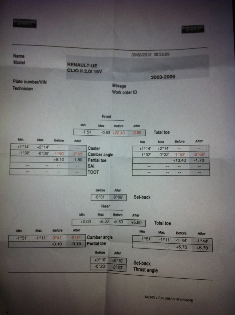

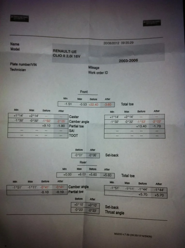

Sorry to hijack the thread but how do you correct camber and toe the same time on the back? Do you fit two sets of camber shims on different angles? This is my geo, as you can see the rear is a little out
v16 - you've probably got a knackered rear wheel bearing there
adding a 10min shim to balance out the difference between 1.36 and 1.46 is a waste of time, 10min is sod all, if it were 50min+ then maybe but again when stuff gets that far off its either a knackered bearing or you've bent something
