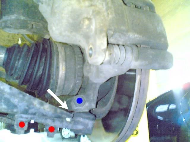

I am planning on replacing the two lower ball joints on my Ph2.
Before i attempt to remove bolts and possibly snap them (even though they will be soaked in WD40)i was wandering if anyone knows what size the bolts are so i have spares ready and the car aint of the road.
And is the top bolt (One with blue dot on stolen ball joint pic below) threaded all the way down its shank/shaft ?

Pinch bolt is M10 which isn't threaded it's full length.
Bottom bolts are M12 (I think), they're bigger than the M10 anyway.

For any one in the future these are M10 X 55 10.9 half thread bolts. Just got a pair with nuts for £5 from my local fastener shop.
