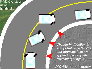

Like this?

Steer into it, and get on the gas smoothly...but HARD.
If the backs coming round, the car isn't balanced i.e too much weight at the front, not enough at the rear.
Steering the front into it will slow how much the back comes round but you are still out of balance.
Getting hard on the gas helps by driving the front further into the skid and also shifting a bit of weight rearwards to help regain balance and traction.
