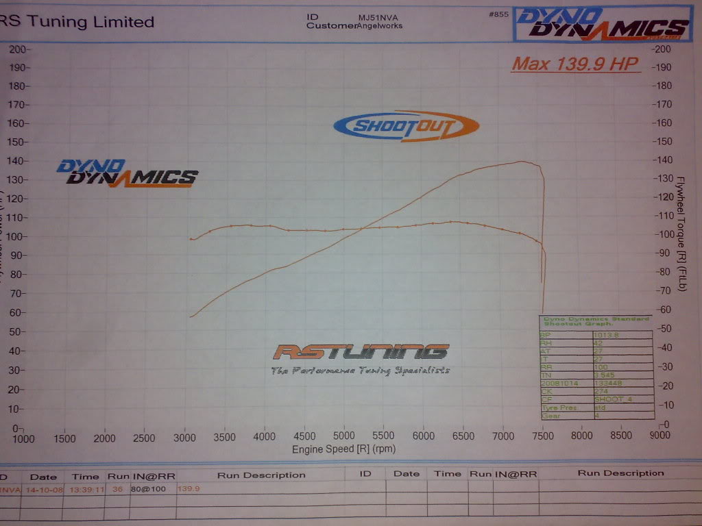

I'm running a 7.5k rev limiter, makes power right up to it and torque starts to drop off
around 6.5-7, which is probably dude to the short runners.
  Clio II 1.6 16v 2 Doors
Mini-valver, tell me... 139.9HP on wheel or on the Engine? How many Torque in Newton-Meters and in what RPM is it´s max? Can´t see on the graphs.
Thanks mate!
