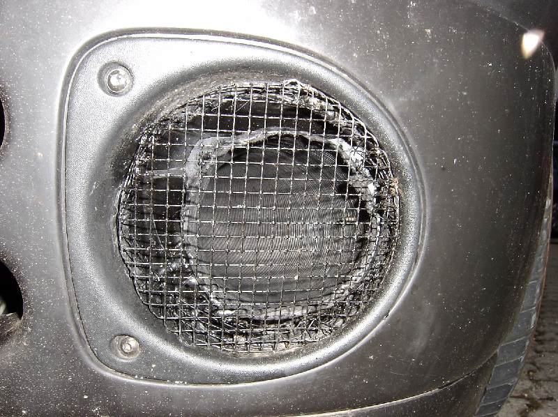

Regarding your air intake, basically not bad, but in my opinion the diameter of the air-box inlet is too small. And also I would let him suck from another location, mine sucks from the left fog-light....

Nice installation man! congrats... I should do the same on mine droping the intake to the bumper to see the effect.
