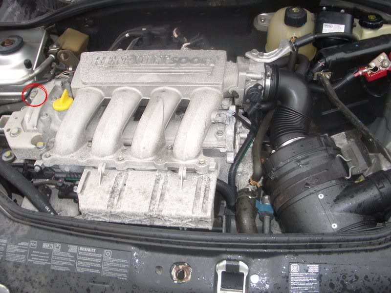

I have just found the bolt shown circled jumping about when the engine is running...
Basically it's lost its thread somehow!!! Is the car still safe to drive to a garage or what? :dapprove:

Your engine is different from mine, but it looks like it's for the engine mount? If it is I imagine you'll have a bit of unwanted noise and vibration.. somebody else should know for sure though.

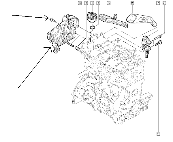

that's the top engine cover/mount bracket. I've seen a couple strip threads, but if you fit a longer bolt there's normally enough there to hold it quite strong enough

I have no idea what the part is called... Any ideas?
I actually have a brand new upper engine mount but its obviously not that part!

Cam cover bolt has been overtightened - common fault nothing to worry about if yours is the same. There £15 + vat from us and i will supply the bolt
