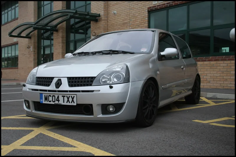

Just saw this photo on a thread:
What's the purpose of the hole/vent in the bottom grill? (the one between the fog lights)
Ive seen it on a few cars here but have never worked out what the EXACT purpse of it is. I assume its just an induction vent.

Hope you dont mind my using your pic Mullen, the car looks mint!

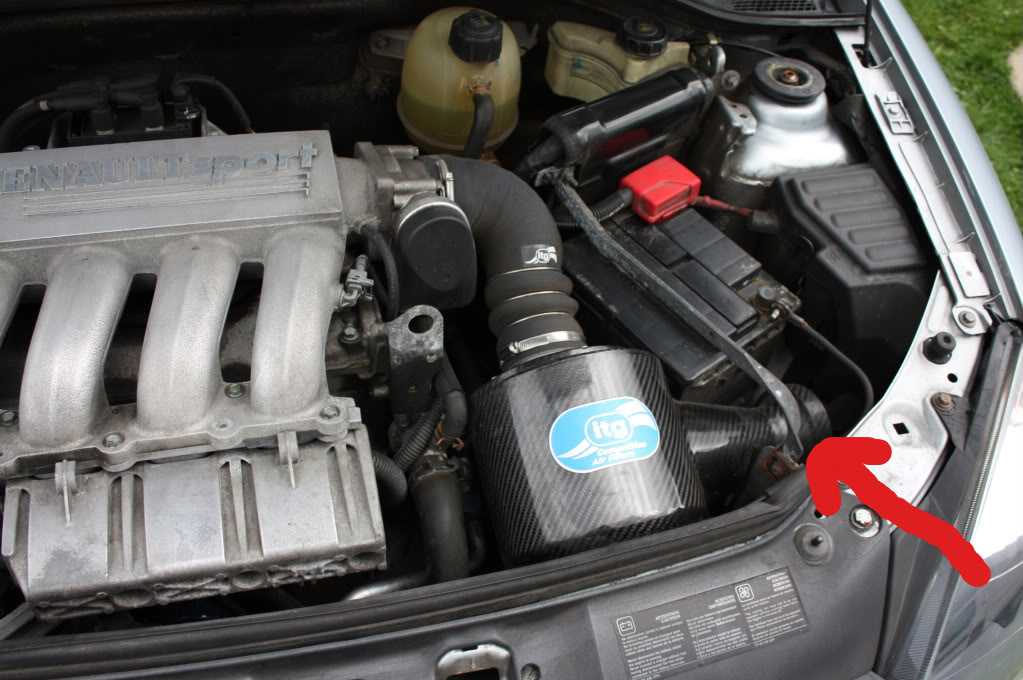

CAF Trumpet - you can see the CAF in this Pic
and you can just about see where it runs to at the bottom of this Pic (As Ali said remove Std Air Feeds and Acoustic valve 1st)
