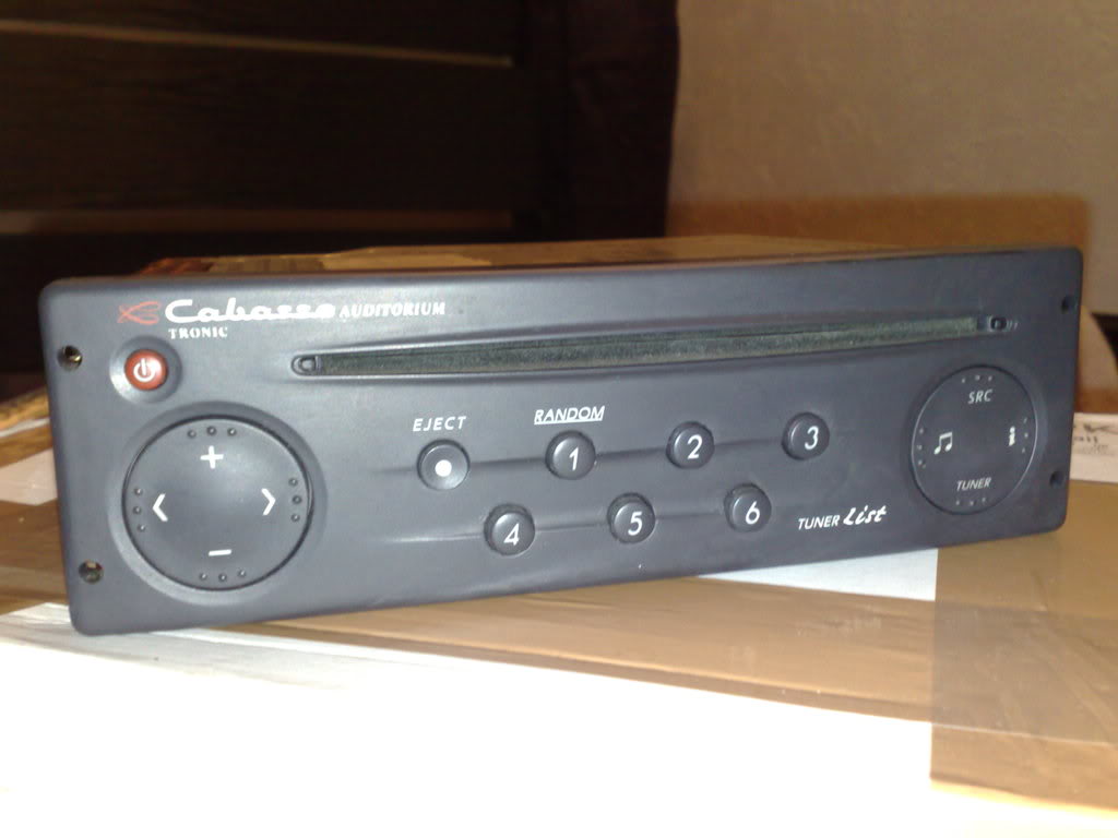

whats this worth??
Car  Clio Sport 172
just wonderd how much i could sell this for? its the wrong colour for my car :(
whats the difference between the cabasse and my one that looks the same but without the cabasse ^^
normal ones that come in dynamiques, cups, etc are only 10w output to each speaker, cabasse are 40w per speaker iirc

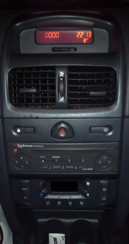

i had the same problem as the OP when i got the cabasse unit, it was the wrong color. so i took the front plastic face off my original dynamique unit and put it onto the cabasse unit....looks factory fit now

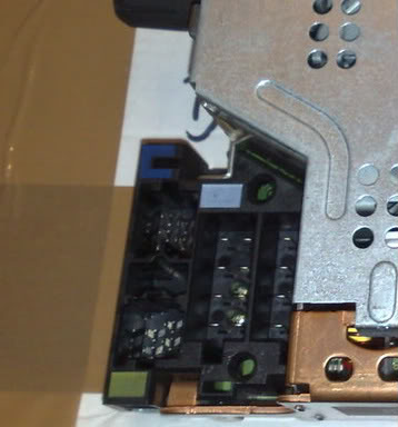

cant seem to get the front off? how much of the front comes off? took the clips off but there seem to be no give?
ok
undo the silver torx screw
then the sides should be loose with a bit of a pull, not too hard though...
then IIRC there is a lip along the top and the bottom, maybe a clip or two...i dont have my torx bits to hand so i cant do it to confirm
pic of lip...
