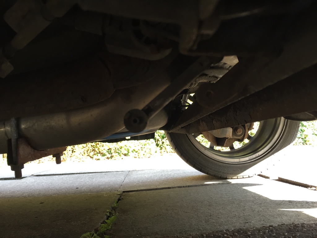

What's this??
Car  Arctic 182
I'm guessing it's broken
My guess would be the xenon headlight auto leveling eh arm lol. The thing that adjusts your headlight beam so you don't dazzle oncoming cars.
Yup, self levelling linkage. Hooks into the rear beam there, a bolt and a nylock nut will see that one working again, if you knock it through and make it a through hole (just don't do it up tight)
