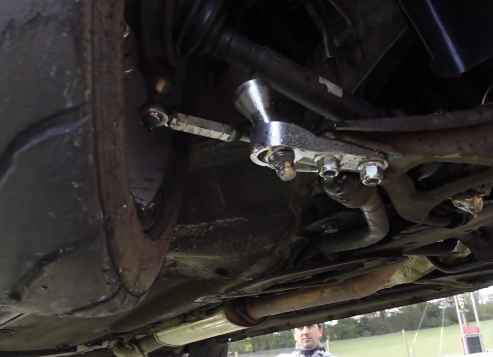

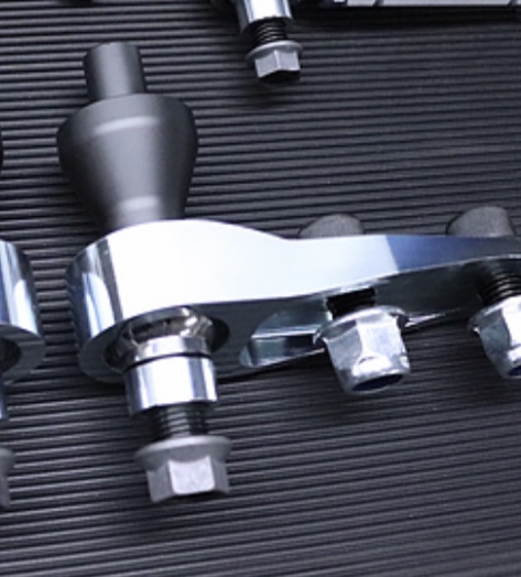

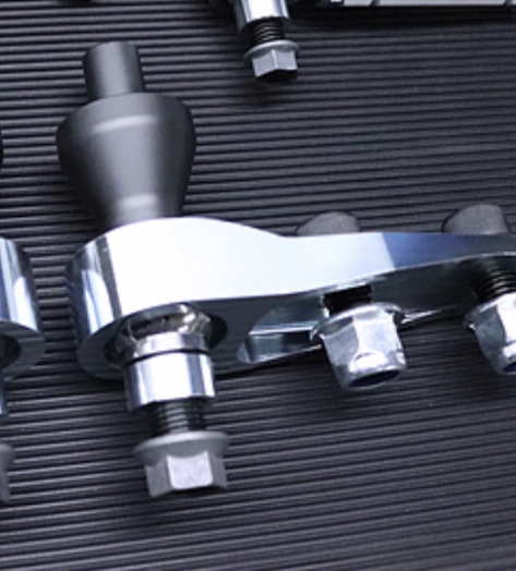

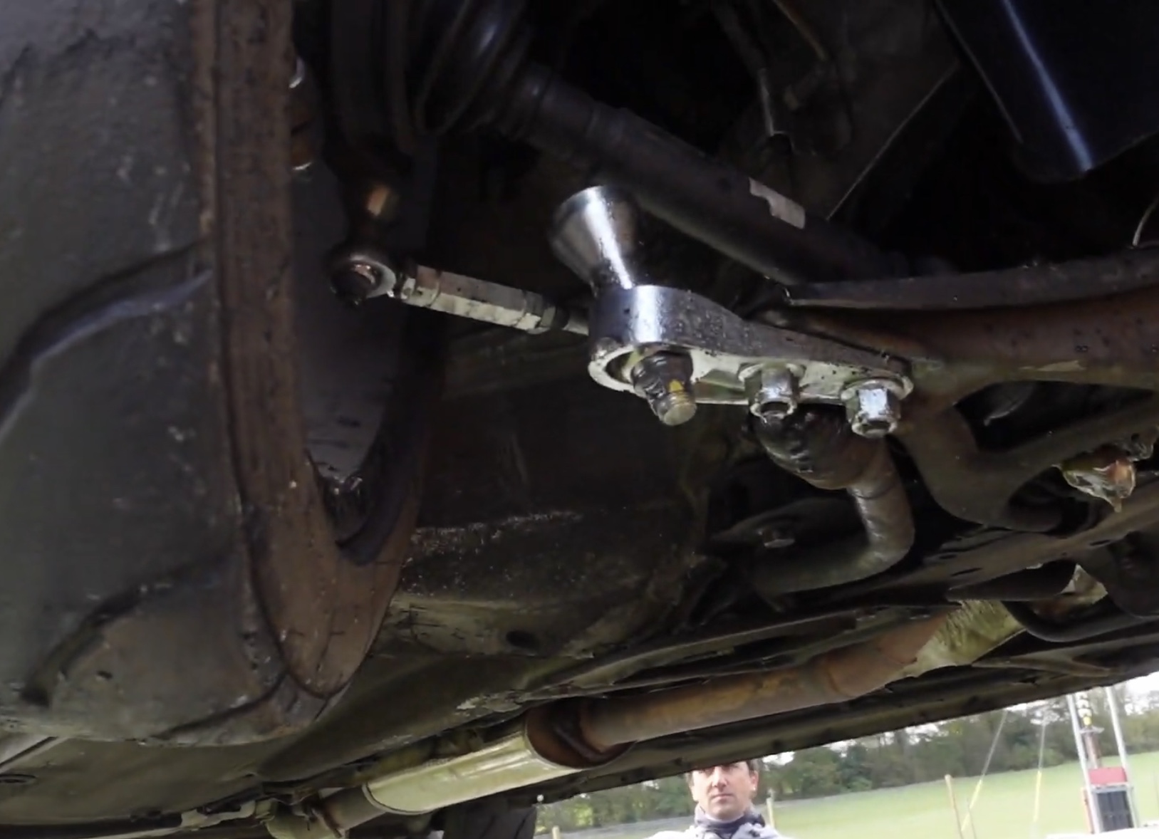

It’ll be interesting to see how it actually failed. If I was the supplier I’d seek to get hold of the upright assembly to figure it out, that way improvements to the kit or installation procedures can be made.
Looks like Roll Centre Correction Kit failure on Jay’s 172! Bloody lucky at Cadwell!
Was a good vid, do love these boys proper no BS, down to earth gents. Could watch them all day.
Shame about the roll centre kit, I’ve always thought they must be under some serious stress with the design they way you can lean on these cars with sticky tyres but it looked complete from the quick glance? Almost like the bolt had come out maybe?
I did read a comment from them saying they’re not throwing blame or naming but something is in hand so sure they’ll update. It was an expensive kit (£500) so could prob narrow it down.

I believe on this one the bottom ball joint snapped off due to it being made out of stainless (fatigue failure)
Yeah does look like the peg that fits into the bottom of the hub has snapped.
Looking online some seem to be hardened steel and some stainless. Even this make below when you google shows in google images as stainless steel, click on the website and the pics are hardened steel now.
Mad that was ever made of stainless!
