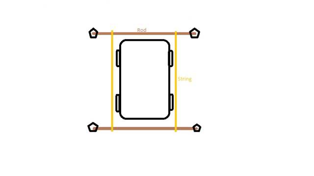

So Phil is talking about doing it like this? Groove's in the wood equal distance apart, string running parallel to car from groove to groove.
Measure from string to centre of wheel to get string parallel.
Measure from rear of wheel to string, and front of wheel to string. Adjust accordingly.
Yup exactly that mate - obviously rear wheels can't be altered easily you have to fit toe shims etc... but front you can then just turn the track rods in or out till the back of the wheel is 1mm further in than the front of the wheel - for 10minutes of toe out
Just found this while searching for something else.
This is exactly how I do it and it does give you quite a high degree of accuracy so long as you take your time.

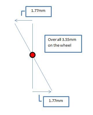

Use this
You put in the degrees you want over both wheels so 1 degree put into the equation gives you half a degree per wheel
Example: with a wheel size of 16" (406.4mm)
Over both wheels 1 degree toe in/out
you get out
This means you adjust the track rod end until you see this adjustment away from straight line like this
Hope that makes sense :)
