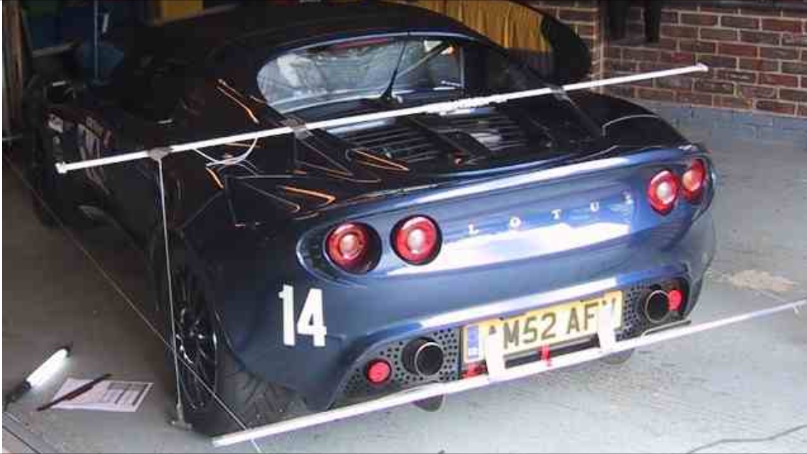

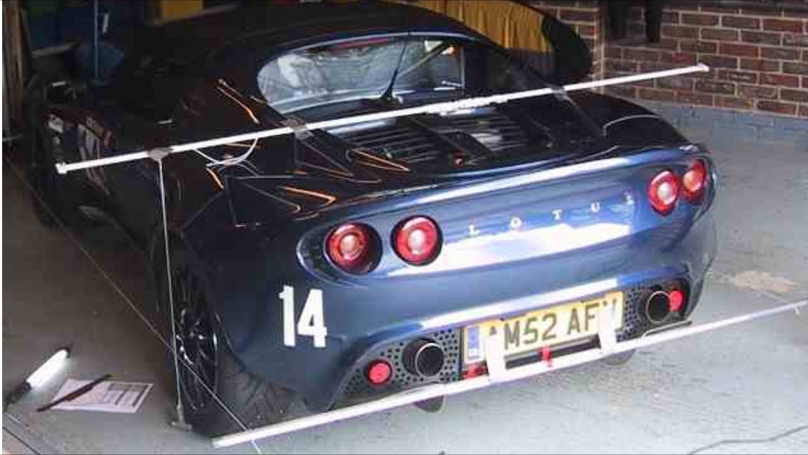

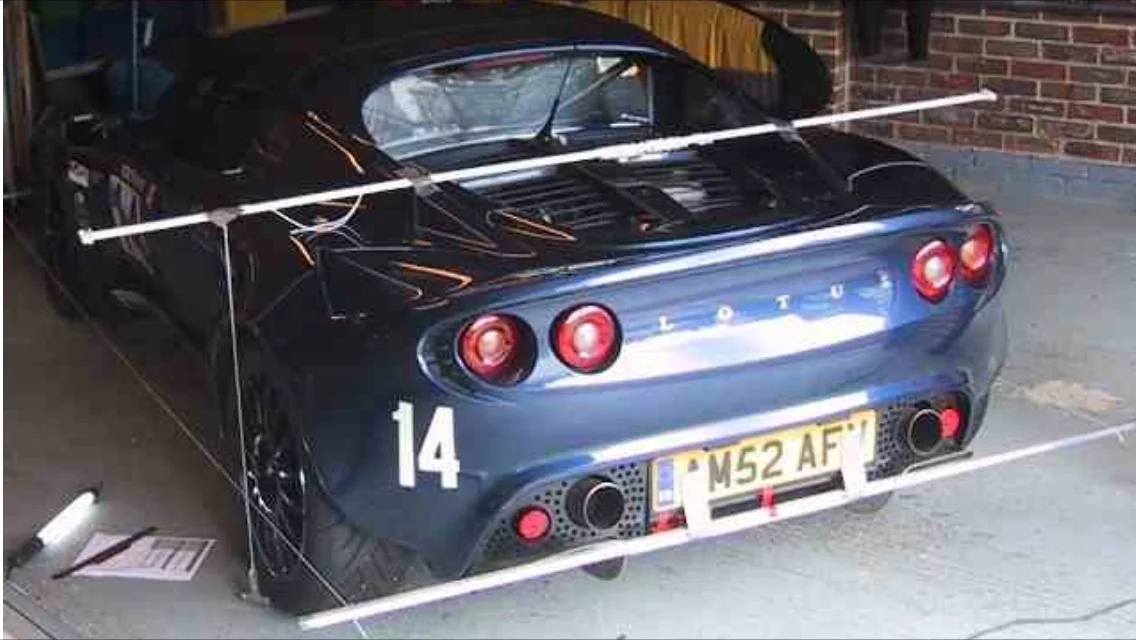

String (fluo coloured fishing line) and a couple of aluminium rods cable tied to the front and rear sections ( with the clams off) worked fine with a ruler when I use to set this up (many moons ago).

You need two bars, one behind the car and one in front, with slots cut into them so you can slide string (I use coloured fishing line not actual string as its thinner so more accurate) onto them.
They MUST have the slots at the SAME distance, doesnt matter what the distance is so long as its a bit wider than the car, but it must be the SAME on both bars, otherwise the strings wont ever get parellel.
Then four axle stands to sit the two bars at the height of the centre of the wheel
And a steel ruler to measure the distance between the wheel and the fishing line
Make sure the distance from the centre of the two front wheels forward to the bar is the same, and then the same at the back, this ensures the bars are perpendicular to the car (within a few mm is fine on this measurement as a few mm has no difference that effects us on a bar that long)
Make sure the car is parellel to the fishing lines by ensuring the 2 front distances to the centre of the wheel to the line are the same and then again on the rear (each time you adjust one end it throws the other out by a smaller amount so you have to adjust both ends a few times till its perfectly central)
So you then have a rig where you have a line on each side of the car which is parellel to the centreline of the car.
Get the steel rule, measure the distance from the front of the wheel, and the distance from the rear of the wheel, and that tells you the toe on each wheel as per the numbers Ive already posted.
So for example if you have the centre of the wheel at 17cm from the fishing line, then you might get a reading of front 16.9 and back 17.1 from the front and back of the wheel, which would be a 2mm total difference, or 1mm of toe.

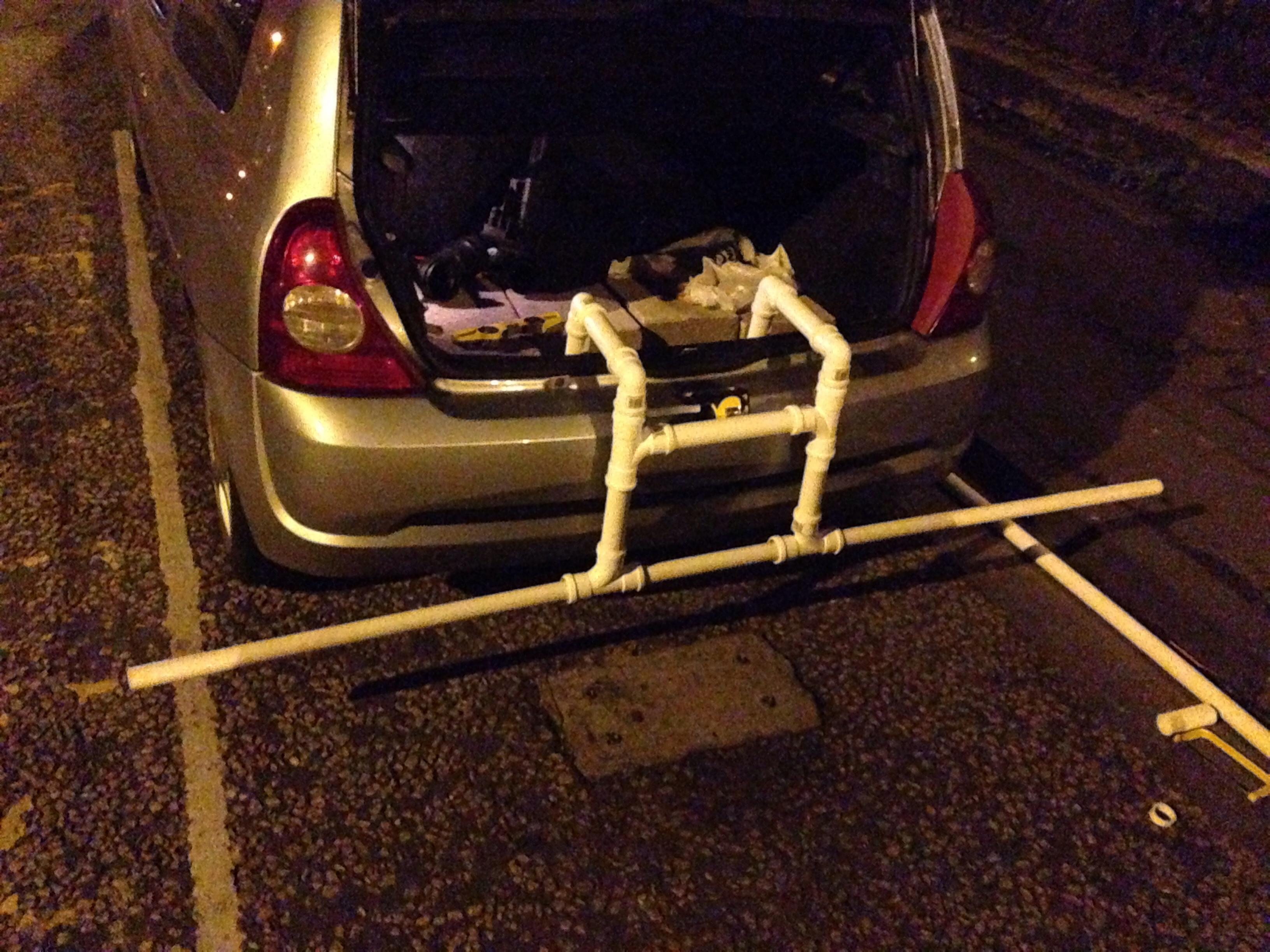

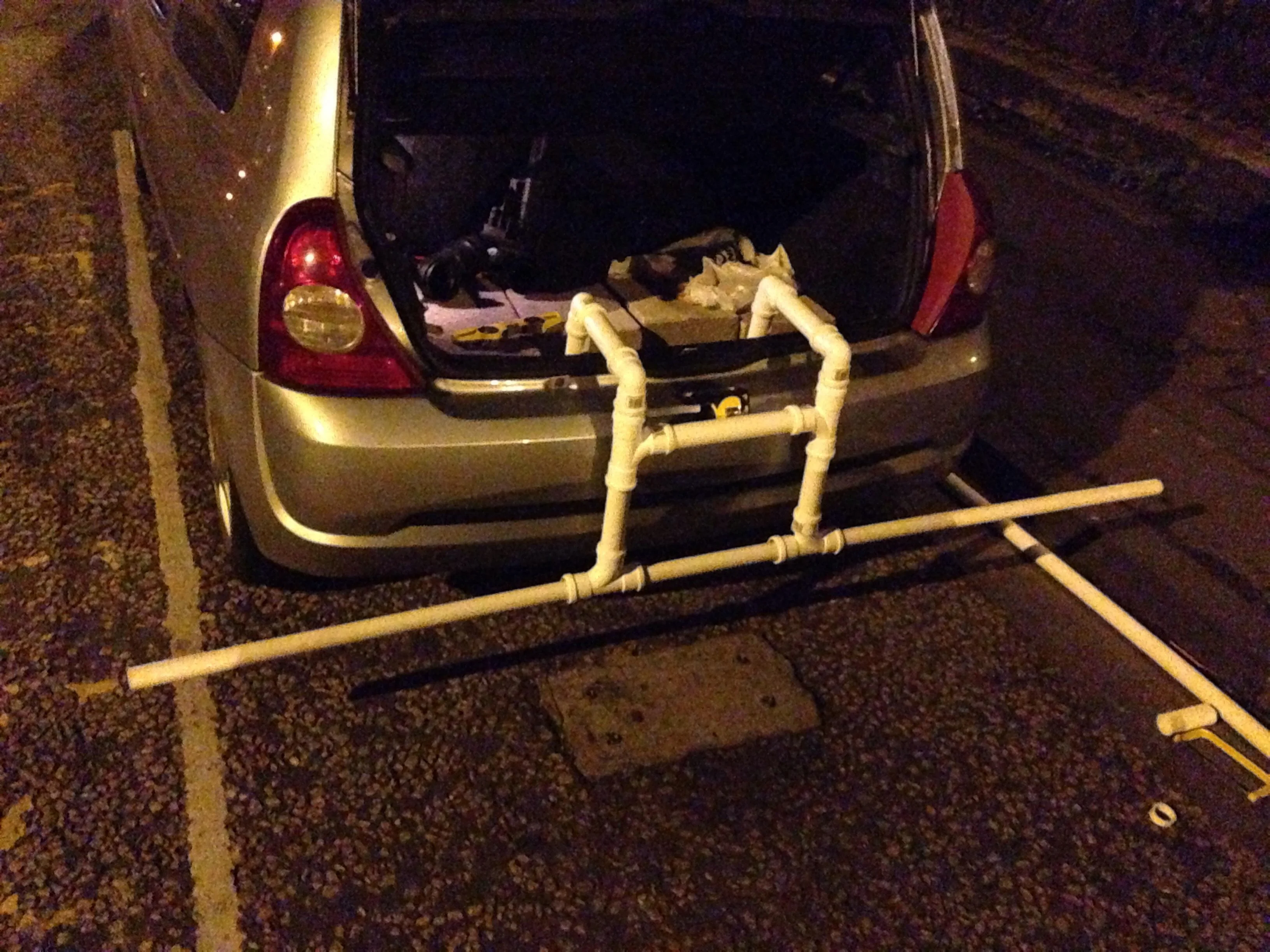

image.webpI made this for stringing the Clio. It allows you to move the car about when making adjustments.
Another bar just cabled to the front bumper then run the strings between them.
I haven't actually used it yet but no reason why it won't work.

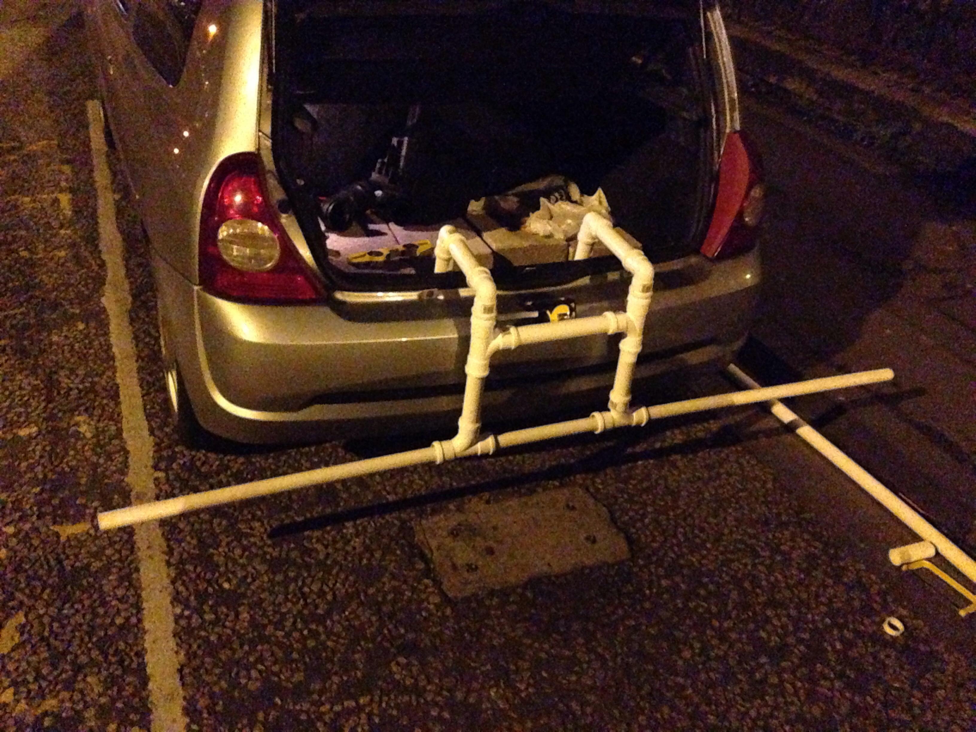

View attachment 108844I made this for stringing the Clio. It allows you to move the car about when making adjustments.
The key thing is going to be that its absolutely centrally located, 1mm off and it will make all your measurements pretty useless.
That's what I'm away to make but out of powder coated white steel (cheaper than ally) with an adjuster to pull the strings taught and one that hooks in through the front grill.
When I use it for the first time I am going to put a screw to stop the main bar from sliding. As the notches for the string will be cut exact distances apart then whenever one side of the car is aligned with the string I know that the other is parallel.
Ive just have weights on the end of the lines which means they are always tight.

By making front left match the front right. And rear left match the rear right. There is NO comparison required between front and back.
That is enough to ensure it's parellel. That's all you need so you can then measure each wheels toe relative to the string like Morgan says.
On my 172 turbo the front is about 50mm wider than the back. Still no problem.
r****d alert!
Please excuse my piss poor paint skills lol and wording of stuff.
If i was to set the string at 270mm off the front side and rear side of the rear wheels. All i need to do then is set the fronts to equal mm of distance to then run 0 degree toe??
So say 230mm frontside and backside of the front rim? And is perfectly ok for road use?
measurements are just an example.
Cow me near on an hour to set it up with 4 axle stands so i hope so......... i just done a full suspension refresh bar tie rods and ends (fairly new) Steering wheel is **** on centre now with no pulling either way and handles sublime:cool:
