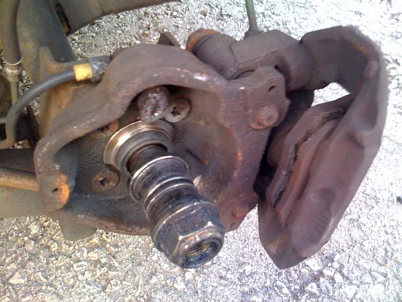

WHEEL CAME OFF THE CAR WHILST DRIVING!

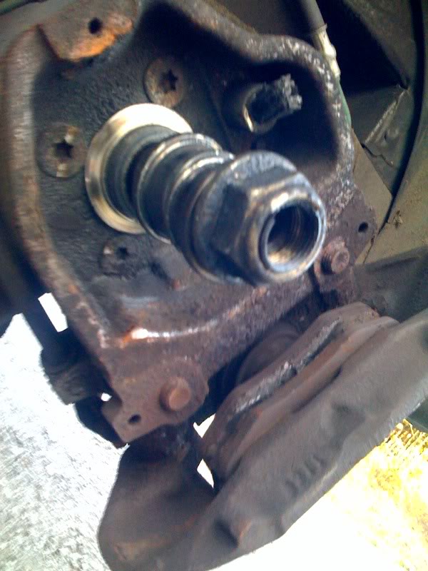

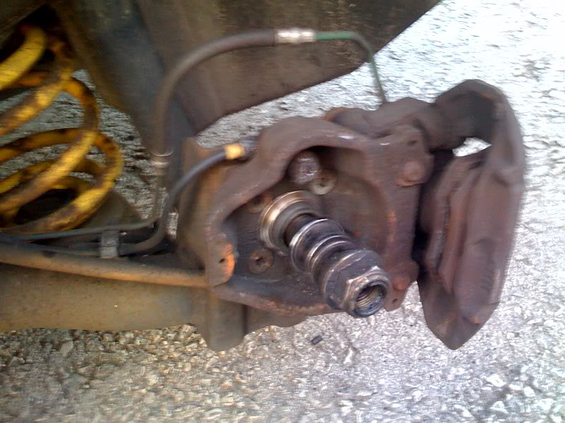

As it's on the left hand side, if the bearing seixed it would udue the nut? Unlike on the drivers side.
Jeez... Get the discs from Renault mate, Come complete with Bearing pressed and ABS ring fitted, Easier in the long run... FYI £95 + Vat (£107 ish).

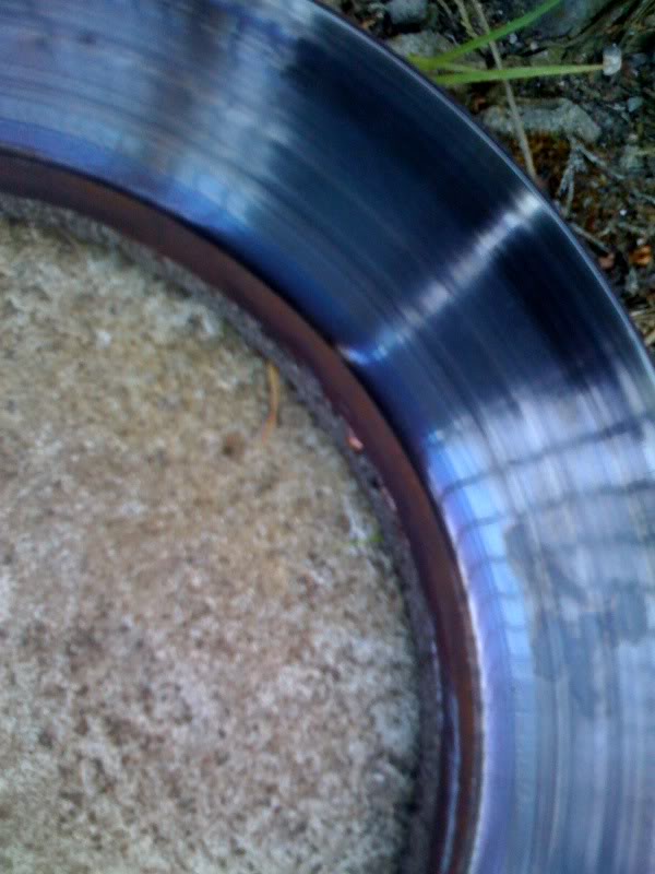

Pic 4, need to either drill the rest of the wheel bolts out, if your unlucky when its removed and the inside thread is nackerd, you could try and re tap it, or new flanj, which iirc about £60ish from renault or motor factors,

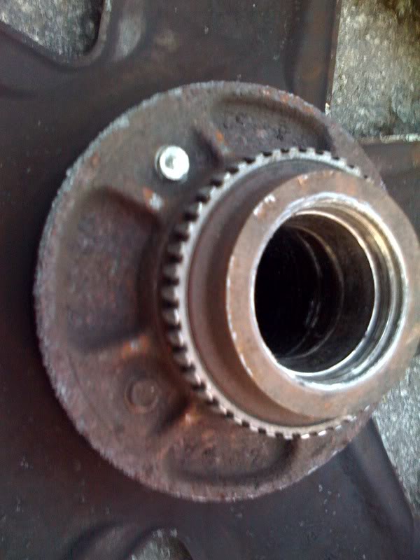

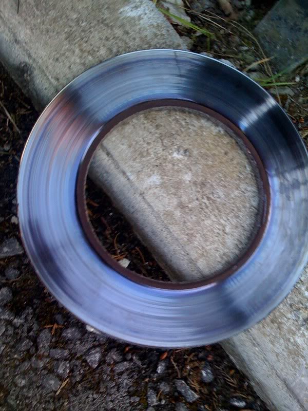

the nuts clearly come loose allowing the disc to move on the stub axel. The only thing holding it on would be the caliper (hence the extreme wear to the rear discs and pads & heat / smoking) eventually as its loosened off and the disc probably sheared when it hit the tarmack as it was so badly worn!

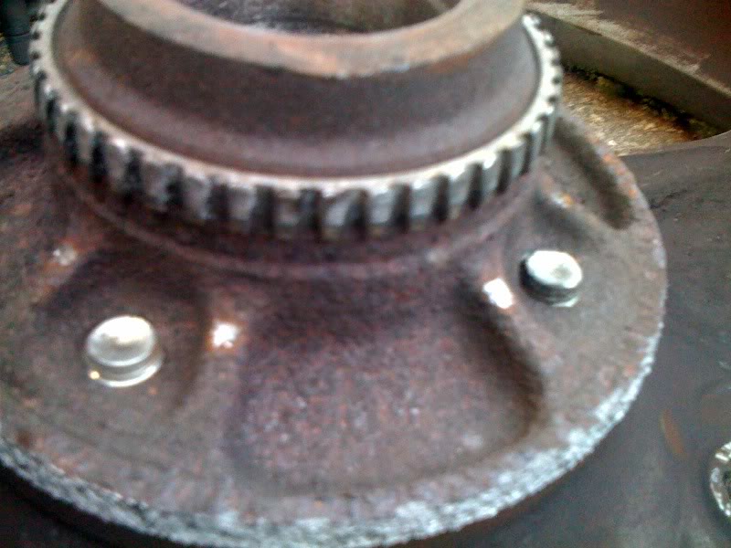

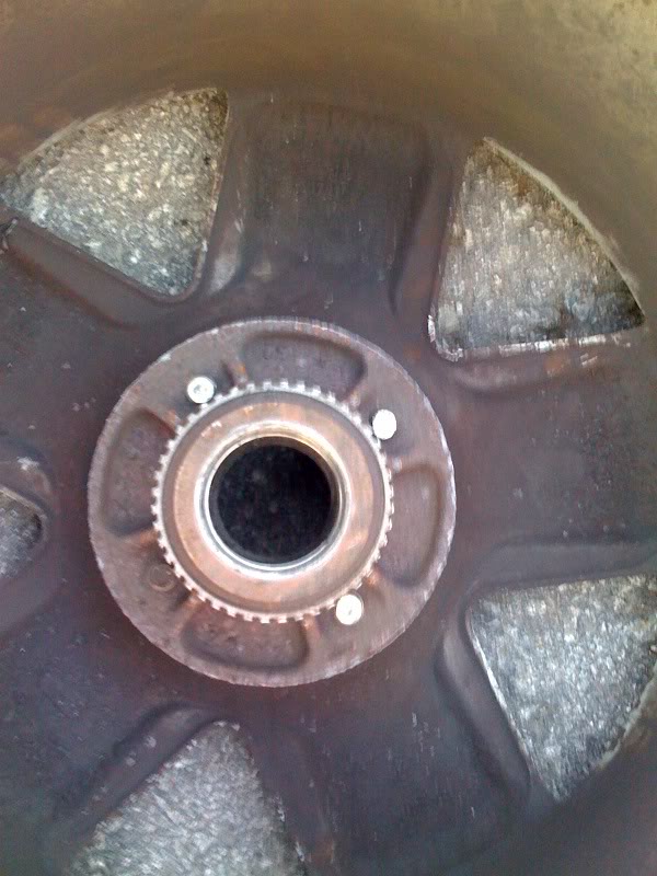

That pic is of the inside of the disc, the bolts can be undone from the old disc centre and bolted into the new one.
look at the pic, the wheels bolts have snapped, how you gona undo something that snapped? trust me, iv had the snappin problem had to strip my hub off the car and take it to the garage, they couldnt re-tap the thread as it would be a few mm to big, so safest bet was to replace the flanj..
Thanks again for your input dude. I appreciate everyones help but those wheel nuts are not snapped. 3 look silver because they are new and the other is a locking wheel nut.

Decided to replace both discs, bearings and pads.
Bought so far,
2 x Discs, with ABS ring and Bearing pressed in from renault. £114.72
4 x new Rear Pads £20

Oh and by the way. A1 told me today that the stub axel needed to be replaced as part of the £600.
My mechanic had a good look at it and laughed, he said there was nothing wrong with it at all.

we have had exactly the same happen on the rally car, did a stage with weird camber/toe out. put the car on jacks, no disk left and pulled wheel off :S when these bearings fail they go propper
Same almost happened to me last week mate... I recently changed my discs, pads and bearings.... about a week of it being spot on I noticed it was grinding again.... then heard it go and the back end was all over the place!!
Managed to get the car home only to discover the rear wheel had been wobbling and hitting the inner arch, took the wheel off and the bearing was seized and had shattered!!!...

Similar happend to me but I stopped before the wheel came off. The stub axel had cracked and the bearing was buggered. Sorted under warranty.
Update on this for anyone whos interested. (Don't forget A1 wanted £650 + VAT for this)
Got the car back yesterday good as new.
Parts £159.72
Labour £80.00
Total cost £239.72
