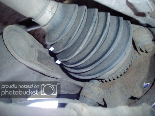

right just had a look. if i turn the driveshaft in my hand i can feel a knock/clunk which i can tell if its coming from gearbox end or cv boot end. I javked up the otherside and this also had a clunk. Is this just the cogs moving normally?

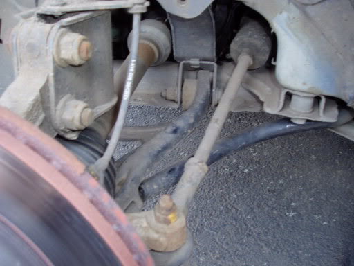

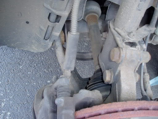

I have took some pics. There is no movement or play in any of the other parts in that area. So i'm guessing driveshaft or cv joint?
you will get slight play in the drive shaft at the gearbox end due to the way it connects to the diff. get a big bar stick it in the wishbone, move it up and down and check for play in the ball joint and track rod end.

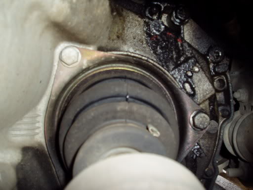

hi mate,im a new member and have been reading your problems with your motor' i have same problem with my clio sport and have had it investigated by renault specialists i know what it is its your gearbox thats where you are getting the movement from your driveshafts,the bad news being your gearbox is damaged you will need a new gearbox or the cheaper opition getting your gearbox re-conditioned this should sort the problem.
get the tracking done first mate mine used to bang slightly when setting off quick but my tracking was well out since ive had it done its never banged or owt
Uh Ohh, hope it isn't your gearbox mate. Where is that oil coming from in the first pic? Can't work it out but oil looks fairly fresh...?
