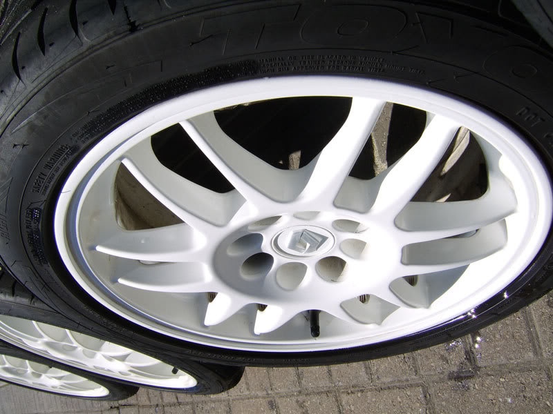

I am selling these on ebay, but someone has asked me what offest they are.
I dont know :o. lol.
Can anyone help me?
There Oz alloys off a 172
These ones,
HI I WAS LOOKING FOR THE SAME THING THE OTHER DAY THE OFF SET SHOULD BE ON THE OTHER SIDE OF THE RIM MAKED ET, MY TITANS WAS ET 37 I WOULD HAVE THOUGHT YOURS WILL BE SOME WHERE ON THAT LINE :rasp:
I'm not posting an ebay link, cause my paid membership ran out so cant post in the for sale section anymore. so i best not post it here.
Unless i am allowed?
just been looking, all i can find is,
7J x 15-4 H2 43
Apart from that, its just the Renault Stamp and made in Italy ??
According to that wee guide, it is this??
Clio 2 16V & 2.0 RS after 99
PCD -
4x100
OFFSET
35 to 38
Centra Bore -
60.1
ummm not sure tbh they all around the 35 / 38 mark!
try and google it mate or try alloy shop like www.potn.co.uk or .com ?? not sure or demon tweeks
PCD - 4x100
OFFSET 35 to 38
Centra Bore - 60.1
not fully accurate as the 2001 - 172 has about ET 40, 182 is 45 and I think these are 43
Mk2 Ph2 172 with 15" wheels is ET 48.5 mm.
182 with 16" wheels is ET 45 mm.
So 7J15ET43 wheels would fit nicely on either of those.
