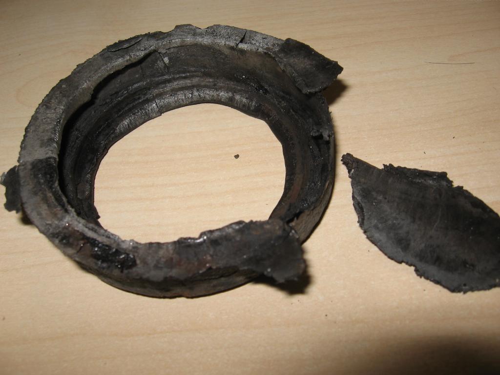

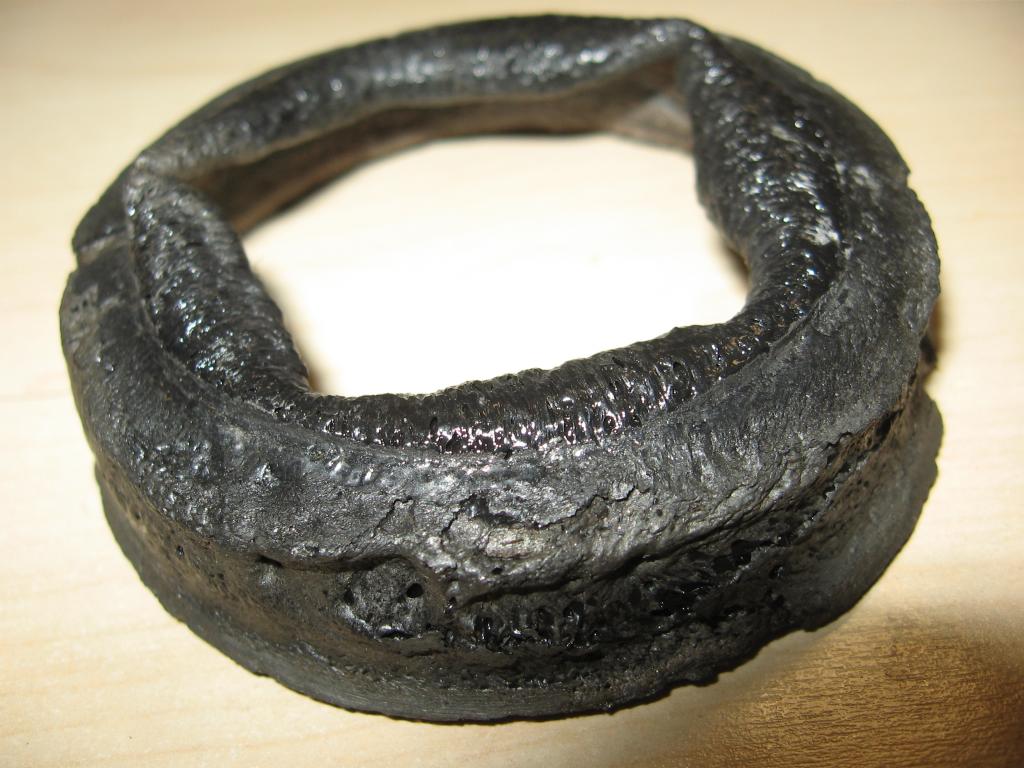

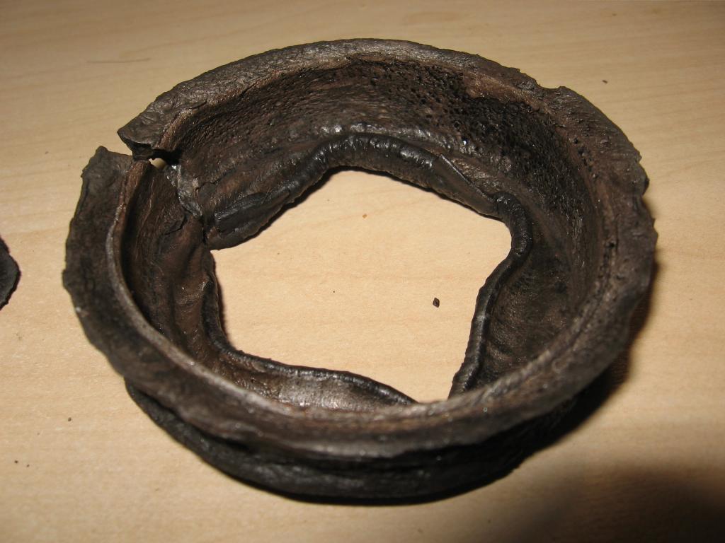

Just took my front wheels off to get balanced and found these, not sure if they are separate spiggot rings or part of/included with the wheels. The wheels are team dynamics 1.2's, these parts have obviously not enjoyed the heat of braking much so looking for better replacements - need them reasonably quick as well.
Does anyone know a) Where to get them and b) what size they should be. I'm new to clio's so apologies if this is a very basic question!

You can measure the inner diameter on your wheel, and the outer diameter on the spigot you are going onto (60.1 for a clio normally) and just buy them online pretty readily.
E.g:
http://www.ebay.co.uk/itm/Spigot-Rings-Hub-72-6-60-1-RENAULT-CLIO-4-Rings-/130497117785
(you will need to check if yours are 72.6 though in the first place of course, that is just an example)
Thanks for that I'll measure the wheels when I get them back, will new ones like that just melt again though?

Potentially yes if you are getting the disks mega hot.
You could get some turned up from ally to prevent the problem, or just rely on the wheel bolts to locate and not use spigot adaptors.
