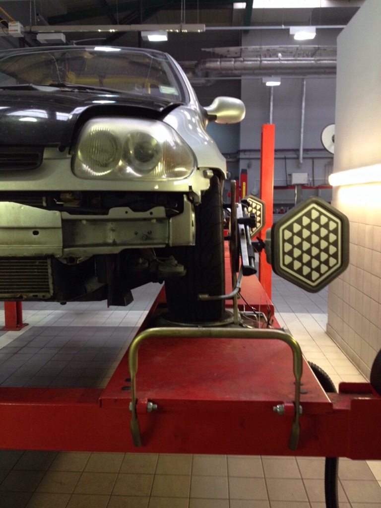

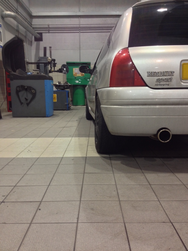

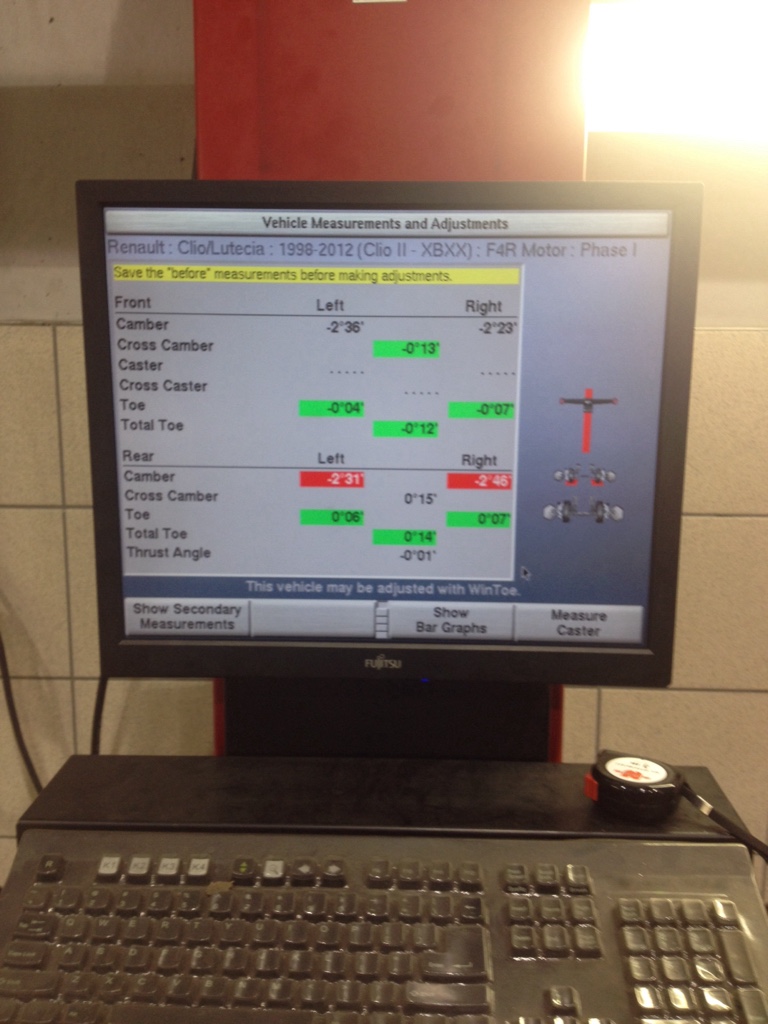

Rear 10mm with 1deg camber shim also
20mm front with 2.5 deg camber
If your not running any major camber the tyre will sit closer to the arch
imprezaworks
  Mk5 Golf GTI :)
How much is that lowered by mate. As I have 2degree shims rear, and run the same camber upfront.
