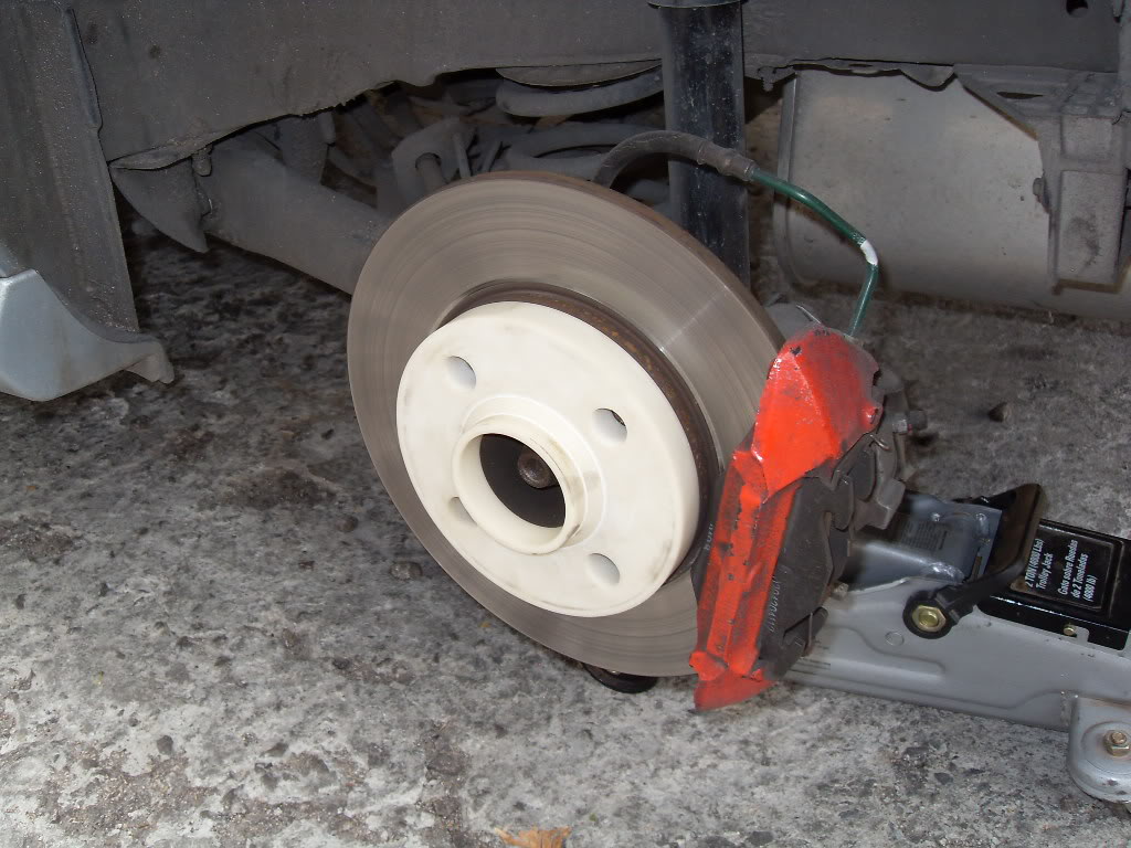

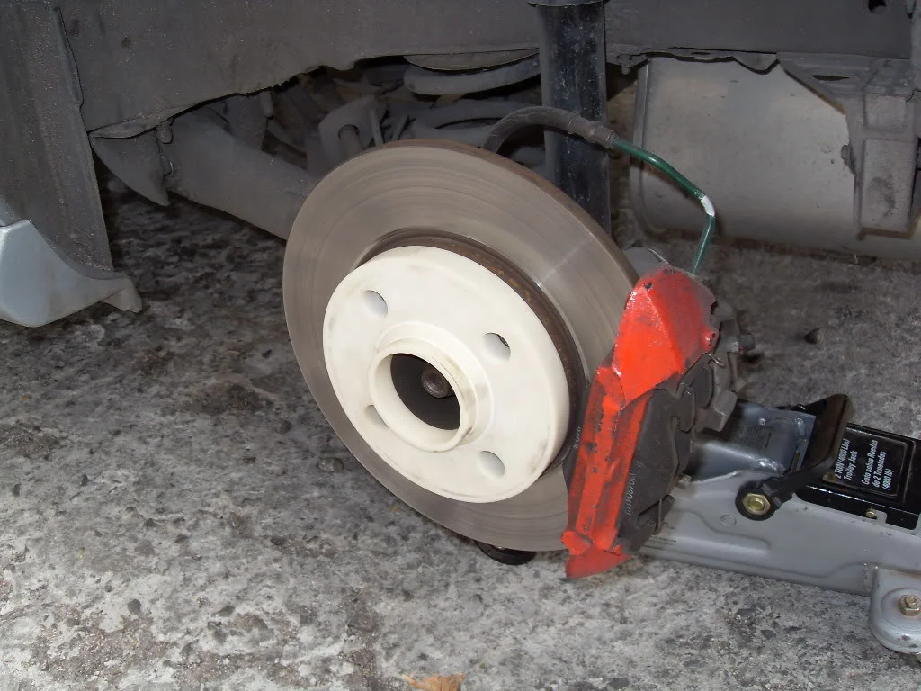

Not a PH1 but a PH2, which I guess are the same. These are 14.50mm
This is the prototype I did before making the final ones (Designed to my own spec, been there for 10,000mile, do not vibrate and better feeling overall)
Not sure if I used the correct terminology. There are two types; A & B = B uses bolts to secure the spacer on the hub, then a set of 4 new threaded holes with stainless steel shims for the wheel to secure into. A is as above, hub centric, but only with longer wheel bolts.
Ah, I know this already as I keep telling many people the difference between type A and type B, as both can be hubcentric.
I have no issues with type A as long as they are hunbcentric, had them on my car for many miles!
(I actually think they can be a bit more reliable, having both myself!)
Why did you choose 14.50mm, anything on the back?
Because it was the saftest smallest I could go with the appropiate wall thickness at the hub. I actually wanted to be 13 but wasn't save enough. I designed this in Catia and ran a CAE analysis.
My wheels are ET 48.5, add the 14.5 and I am at ET34 which is a bit too much for a 172. At the rear they don't rub at all even when fully loaded, but they do at the front, I need a bit more camber to correct that little issue.
And yes, I do have longer bolts
