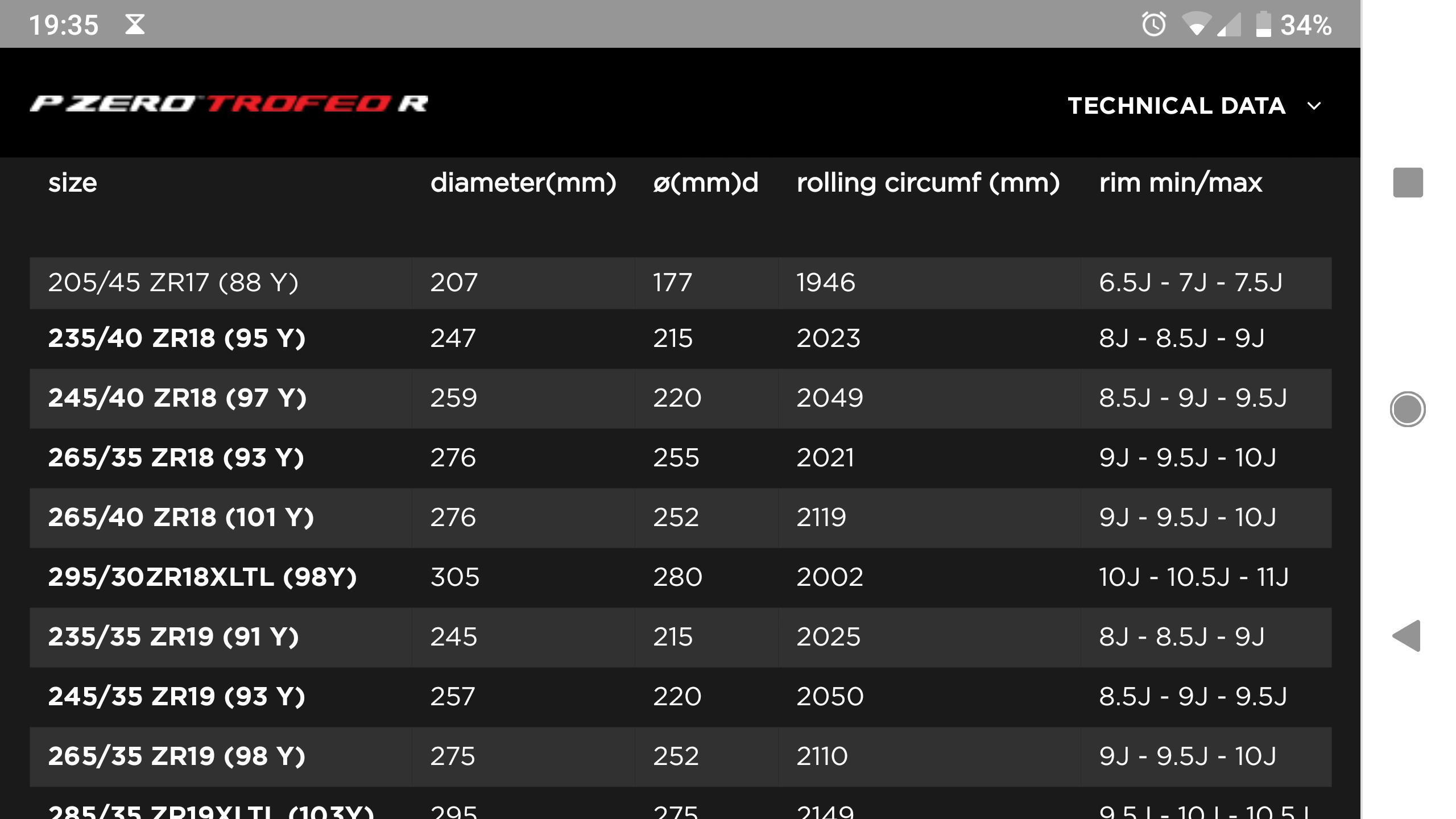

Pirelli Trofeo R. Their sizing is pretty broad but most competitors are using 7" rims. I think we can get a bit more from the tyres though with a bit more width...
Pirelli themselves say the 7" is not really ideal but no-one runs wider rims (mainly as you have to go custom)

Just had a look at the Trofeo R and 205/45/17 rim spec is 6.5j min, 7j optimal and 7,5j max.
I'm guessing you're on a 17" wheel?

15" rims :D I think its 205/50r15 off the top of my head. The other 225 width one we tested but its like a van tyre and needs an 9" rim I'd say

Its not on their common sizing guide, but you can scroll down for smaller fitments
