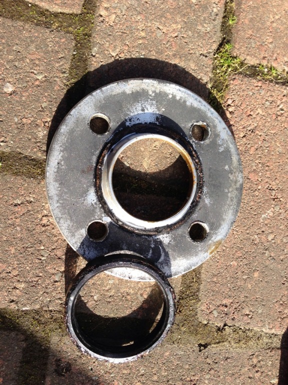

I got my wheels back last night and had a look at them this evening, they've sent me a new set of the exact same spigot rings they had originally supplied - the ones they told me on the phone were the wrong ones!
I'm at a loss as to what to do now.. if they've lied about that then I wonder if they actually bothered to inspect the wheels at all! I don't know whether to call Demon Tweeks tomorrow to complain and ask that they swap for some OZ's, or to just wash my hands of them altogether and machine up my own aluminium rings!
Nurburgring in 2 weeks and I have zero confidence that these wheels will stay on for a whole lap!

The spigot rings were sloppy on the hubs by 0.5-1.0mm so it was impossible to get the wheels centralised.. It was vibrating at speed as if the balance weights had all fallen off and wandering.. not excessively but noticeably, though it could have just been my paranoia!

  Cup In bits
I have pro race 1.2's with plastic spigot rings and melt a set every other time I used them on track. Some Clio's have worn threads in the hub and have this problem which I think you have. Go stud and nut or replace the wheel bolts and hub flanges.
And do to add to that, I don't get the problems you are having. I torque to 110nm prior to going on track, get heat into everything and re torque. Although its not proper practice to torque a hot bolt/stud that's what's needed.
  172 Cup
Thanks for the picture.. do you mind if I use it in my emails to Demon Tweeks / Team Dynamics while I try and sort it out, to show that the rings are known to fail under track use?

Fire on with the photo.
I have already complained to Team dynamics or rim stock iirc about it.... all I got was buy the proper wheels with custom spigots for Motorsport (surprisingly not much more than universal fitment) and I got 4 new spigots which melted again. Tbh I never had any vibration issues or wheels coming slack other than what others have said when some heat gets in and you re torque.
