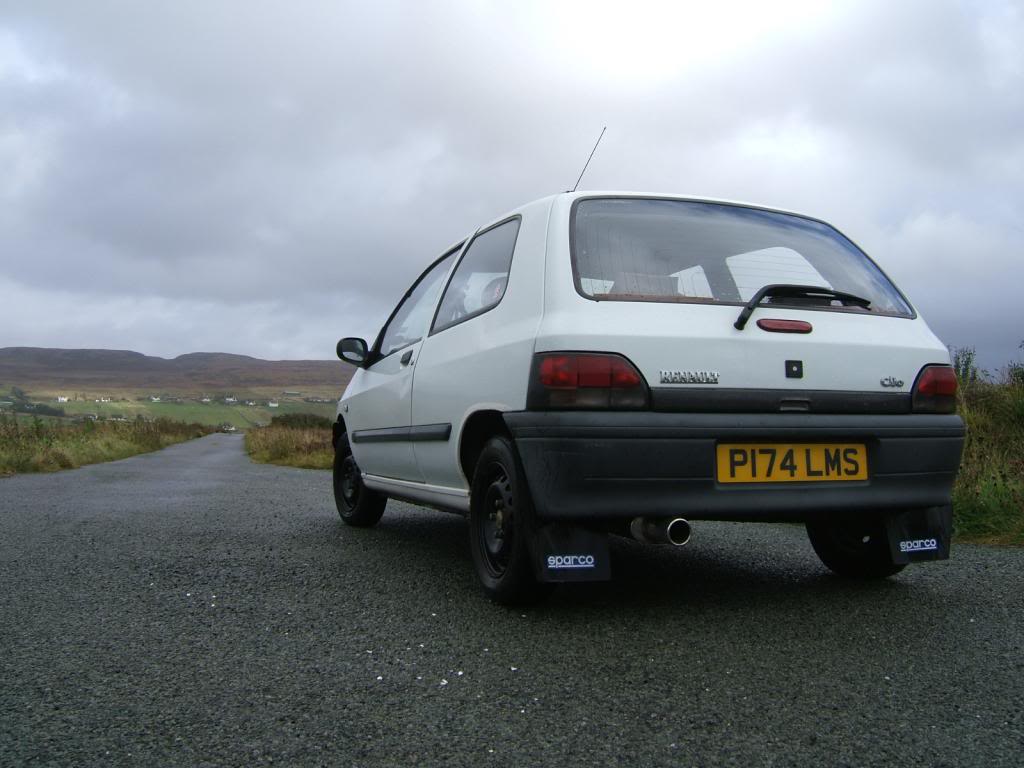

then ended up paining the steels black with hammerite and fitted sparco mudflaps and a backbox whick im unsure what make it was
[/URL][/IMG]

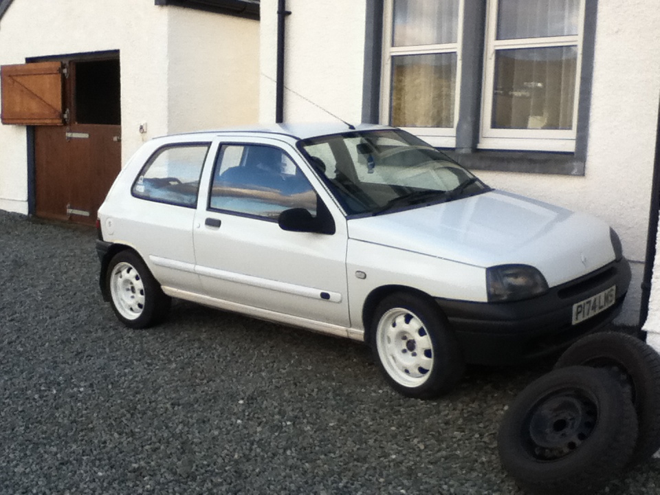

i had it like this for a while then i decided i needed some new wheels so i managed to purchase a set of williams spare wheels £70 for the lot with tires
[/URL][/IMG]
which i then later on painted glacier white and the side bump strips too
[/URL][/IMG]
and thats how it was in the end before it failed its MOT on rust all at the back end. it was a great car and i loved it but it was finished :(

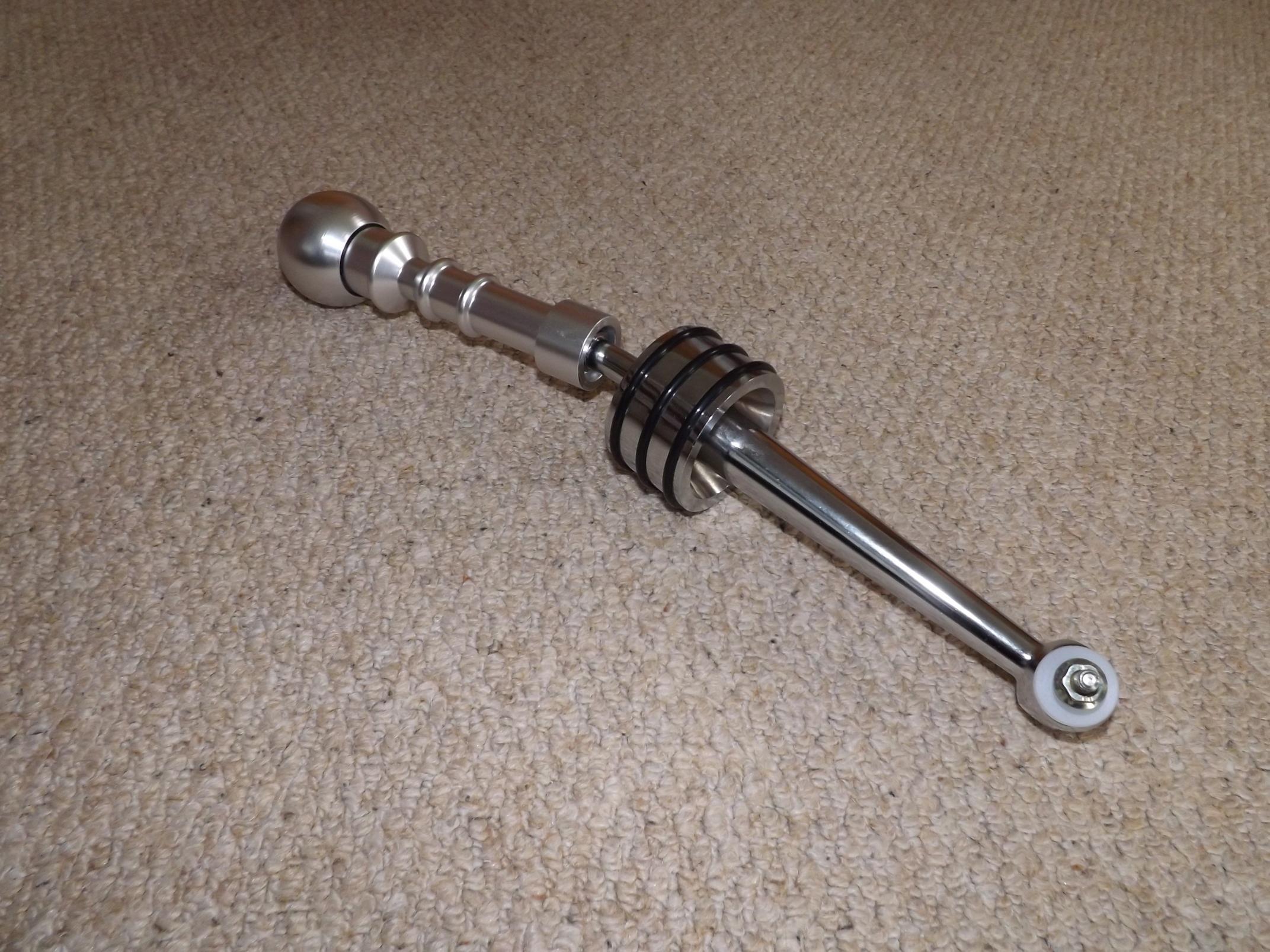

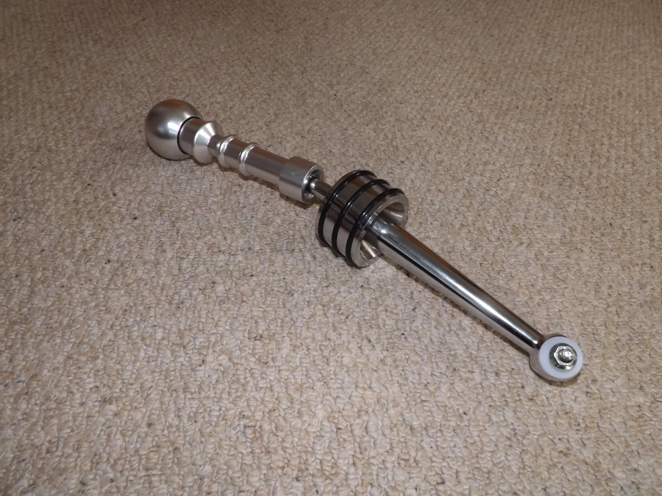

this arrived in the post today :D
[/IMG]
its so shiny! almost to good to put on the car will get round to installing it soon. :cool:

Hello well i fitted the short shifter today which was harder than i thought i didnt realise that the gearstick comes out the bottom of the surround and is held in with a circlip but to be honest its probably easy to do if you have the right tools for getting circlips out, but i only had long nose pliers so it took a bit of fiddling also i had to cut the old knob off as its glued on :S nice one renault! but the new short shifter just fits back in easily and im really pleased with how it looks :) i do have pictures of bit but i left the camera up the road so i'll put them on tomorrow.

ok so i worked on the car for a bit today and got some pics of the new short shifter
this is it before
[/URL][/IMG]
and this is it in the surround which i got bored and painted
[/URL][/IMG]
and back in the car
[/URL][/IMG]
with all the surround back on
[/URL][/IMG]
i think it looks really good it does feel really stiff but im sure once it is worn in it will move easier
