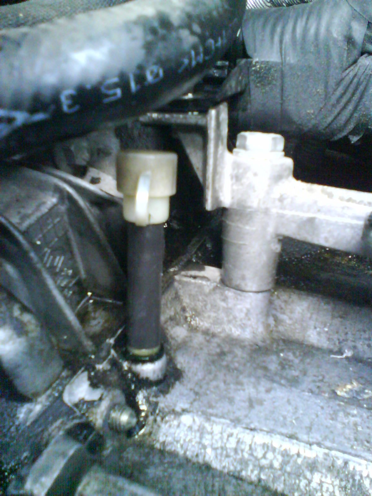

I cant find a butterfly screw on the front of the box but i found this-
Could this be where to top the gear oil up??

little white plastic wing nut, remove, top up. jobs a good one. Just a pain to get at. I use tubing to do it.
