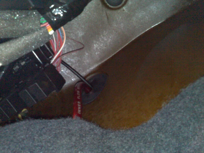

If you look up in the passenger footwell you will see the bonnet release cable going through a grommet about 12" up from the floor. I've attached pics, there not the best as there off me phone but you get the idea.
Thats 4awg cable which took me about 30mins of fighting and swearing to get it through but once you get enough through to get a hand hold of its easy peasy. Apparently you can squeeze bigger gauge cable through, i've also read it helps if you lube the cable up with fairy liquid and it helps it slide better
ballbag04 said:
yeah this is where i put mine. ballache tho. u need to move the water bottle thingy in the engine to get to it.
Only in the RS's as the normal ones don't have the lagging/soundproofing at the back of the bay.

Tigger said:
Will 1/0 awg fit through that?
Apparently according to someone on talkaudio yes, althought it looks too tight to me. I'd be tight as a ducks arse thats for sure. I thought 4awg was pushing the boundaries tbh.
2 fits ;) was over half an hour and had to do a little modification but it fits
0 would be stupid to get throught there I would drill my own
