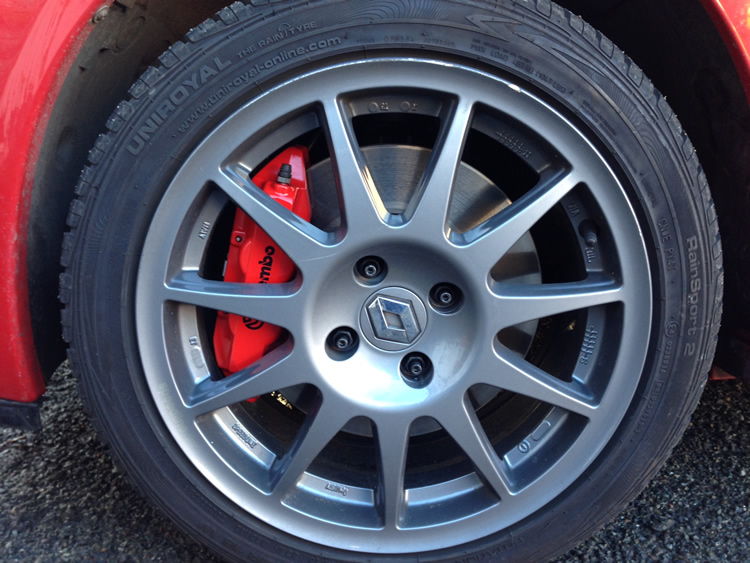

The RSR's on the Trophy are getting worn after two seasons, and seen as we always seem to bring a set of Rainsport's with us as well in a separate van, I am thinking about maybe using slicks on the next trackday season instead.
The car runs on 16inch diameter x 7 inch wide wheels ET45, which will have to be retained and the car is fitted with a cage.
Not sure where to get some slicks from or even what type ?

Got to be 16 inch wheels because of the 197 4 pot calipers and 300mm discs (15's wont fit) :

I'd like to know if anyone with 197 brembos have tried fitting them under 2118's with some spacers. I fitted some AP racing CP5200 calipers under them with only 20mm spacers for 300mm discs.
There is around 10mm clearance so still loads of room.
Slicks for 16's on that width of wheel will be rare. Can't think of a racing series that uses that size of wheel. Goes from 15 to 17 usually.
