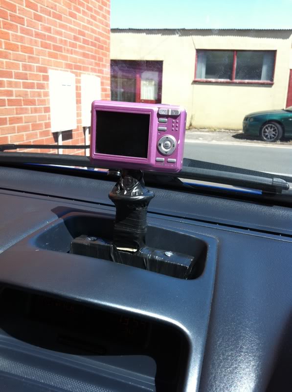

There was a bird on here called Emma who made a mount that screws into the holes in the tray behind the clock. One moment please.
Ph2 dash?
using the holes in the dash already.

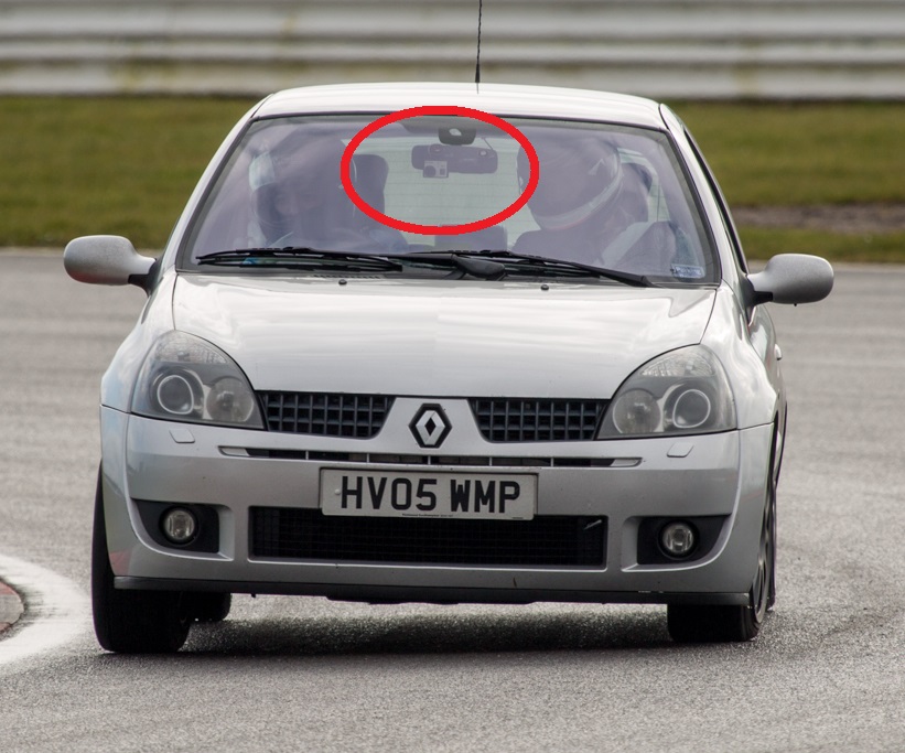

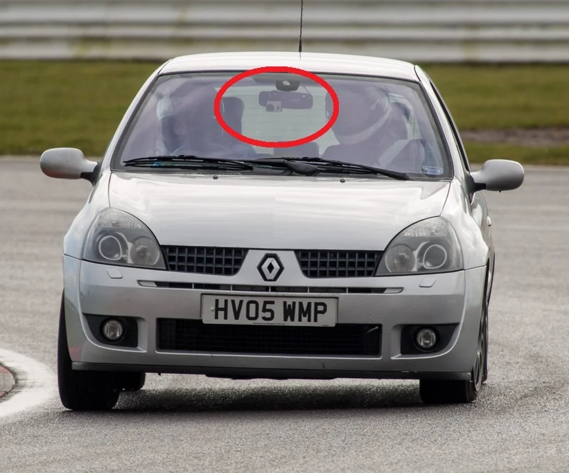

I had one on a mount that was stuck to the screen but it was hidden in the black edge by the rear view mirror. Worked really well and nobody mentioned it.

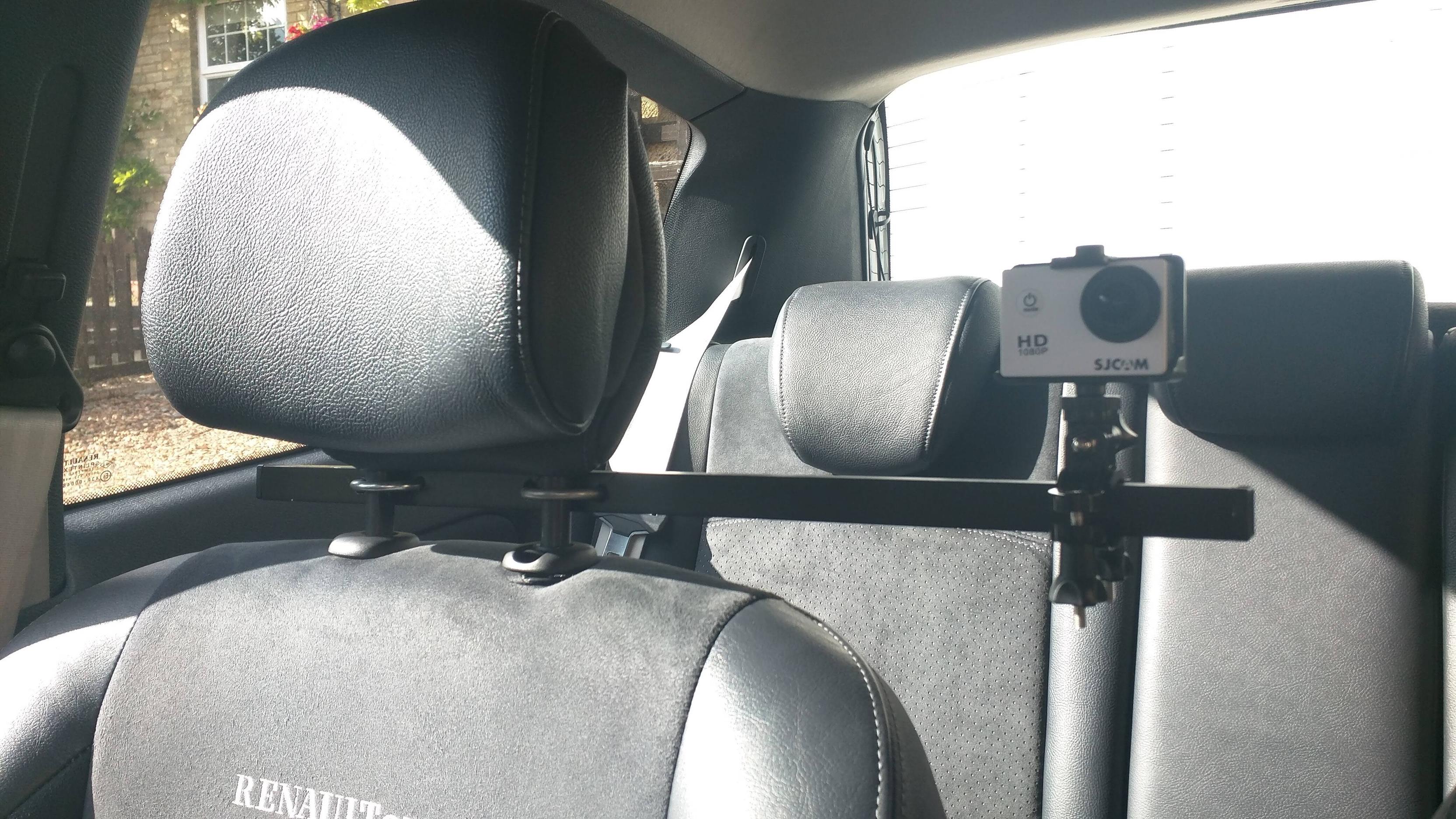

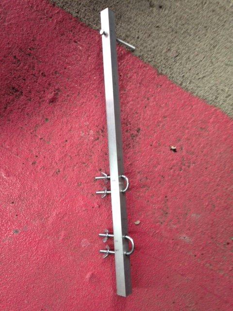

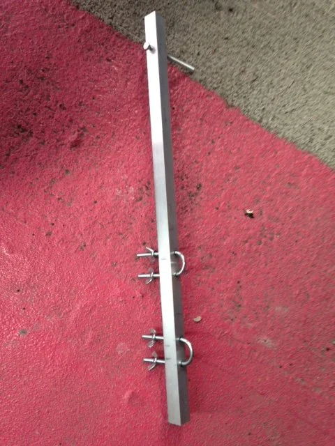

I made a mount with an aluminium bar that clamped to the passenger headrest struts and so sat in the middle of the front seats, got a good view from there.
Pretty simple, a length of square aluminium tubing, 2 u bolts with butterfly bolts to clamp to the headrest and then used an M10 bolt on the end to screw the go pro mount to (or use a clamp mount round the bar)
Cost about £10 and 15 minutes to make.
I'll take a pic of it
Here it is, a bit raw but does the job. Also full adjustable height and distance from windscreen by moving the headrest and seat LOL
Below is a link to a vid i took at Castle Combe using it (the trouble with this angle it doesn't make it look like your going very fast - oh hang on a minute, that might have been cause I wasn't going very fast haha

Not the best pic but it shows where I mounted mine (on the clock surround)

Have you got a breakdown of what you ordered mate?
@Amos91

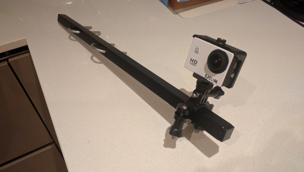

Sure thing -
Aluminium bar x1 - Outside Diameter: 19mm or 3/4" Length: 500mm or 20"
http://www.ebay.co.uk/itm/Aluminium-Square-Box-Tube-Various-Sizes-13mm-upto-51mm-/222164453796?
U Bolts x2 - (I just tighten these up with a 10mm spanner but you could get wing nuts for convenience)
http://www.ebay.co.uk/itm/231484221837?_trksid=p2060353.m2749.l2649&ssPageName=STRK:MEBIDX:IT
Plastic End Caps 19mm - (Only to finish it off)
http://www.ebay.co.uk/itm/221124360...49&var=520109779014&ssPageName=STRK:MEBIDX:IT
Then I just used the bicycle handle bar mount that came with my SJ4000 camera to fix it in place. Also used a bit of satin black paint I had laying around to tidy it up....
