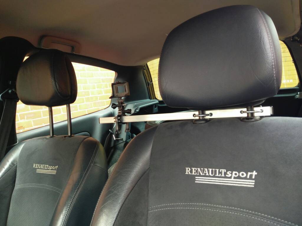

My homemade one was an old tube from a floor lamp. Drilled 2 holes to suit the headrest bars so it isnt bolted to them, but they pass through it and its held in by the headrest. Then just a standard handle bar camera mount for the camera itself.

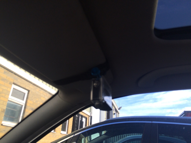

Generally I use a 3m sticky dashboard mount on top of the clock console with a secondary cable tie just in case. Most operators are happy with this :)
Used my mount at the weekend so reminded me to add some photos for this thread:

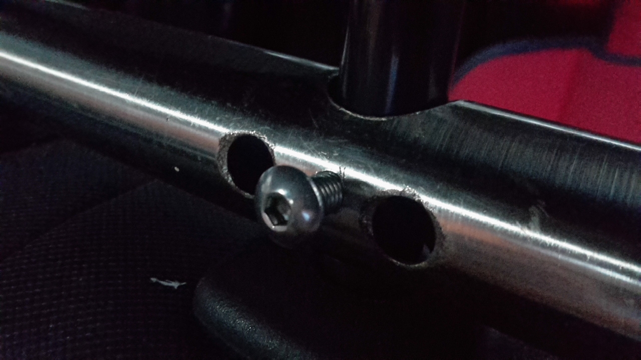

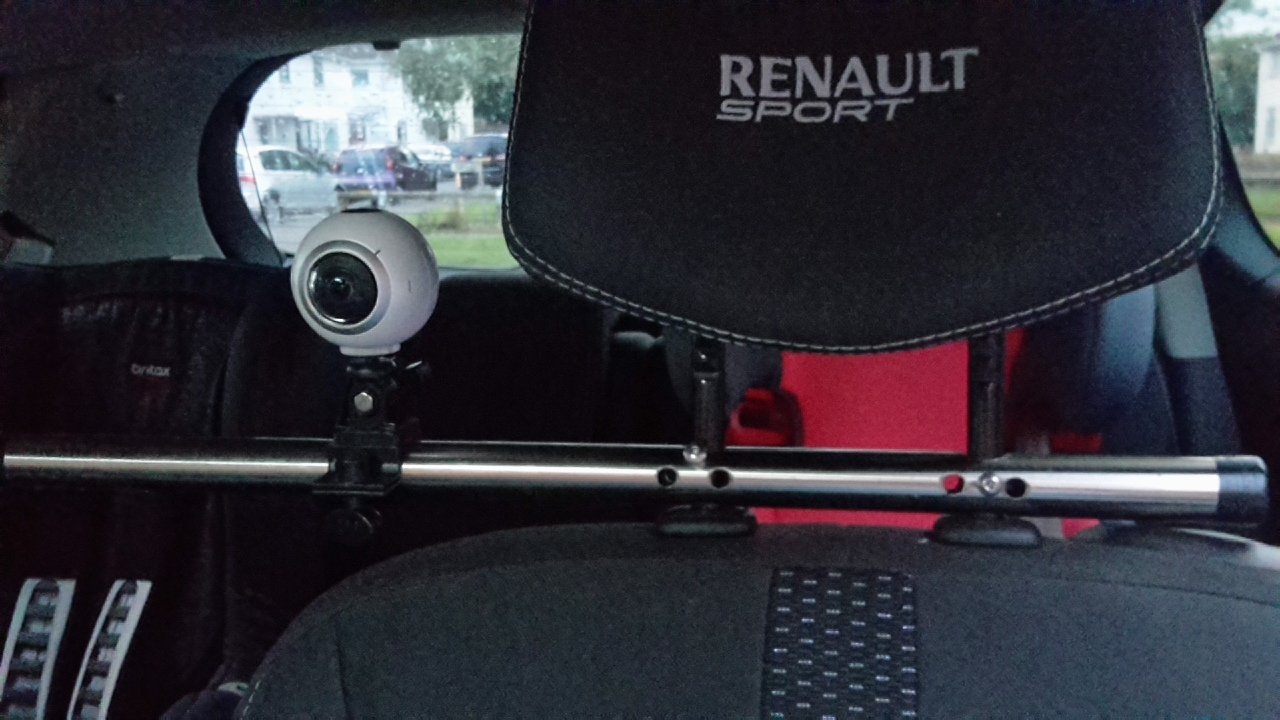

I also found the 197s has the same width of head rest bars, but the rest doesnt drop as low as the 182, so i added a couple of tapped threads and bolts to hold the bar in place.
Ignore the other holes, that was my early idea to use the similar mounting to the mounts shown earlier in this thread.

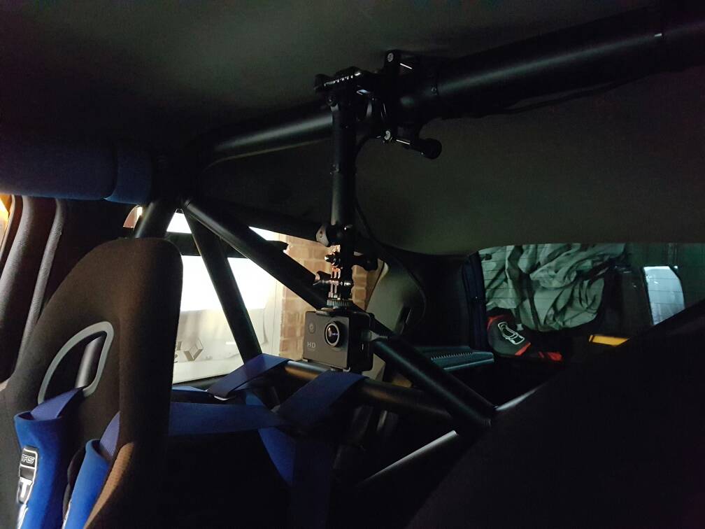

And mine, cage clamp plus odd bits from an old cheap car phone holder to get it near eye level and being able to tweak the position. Have ordered a bracket to add to this for a rear facing camera in the same position....

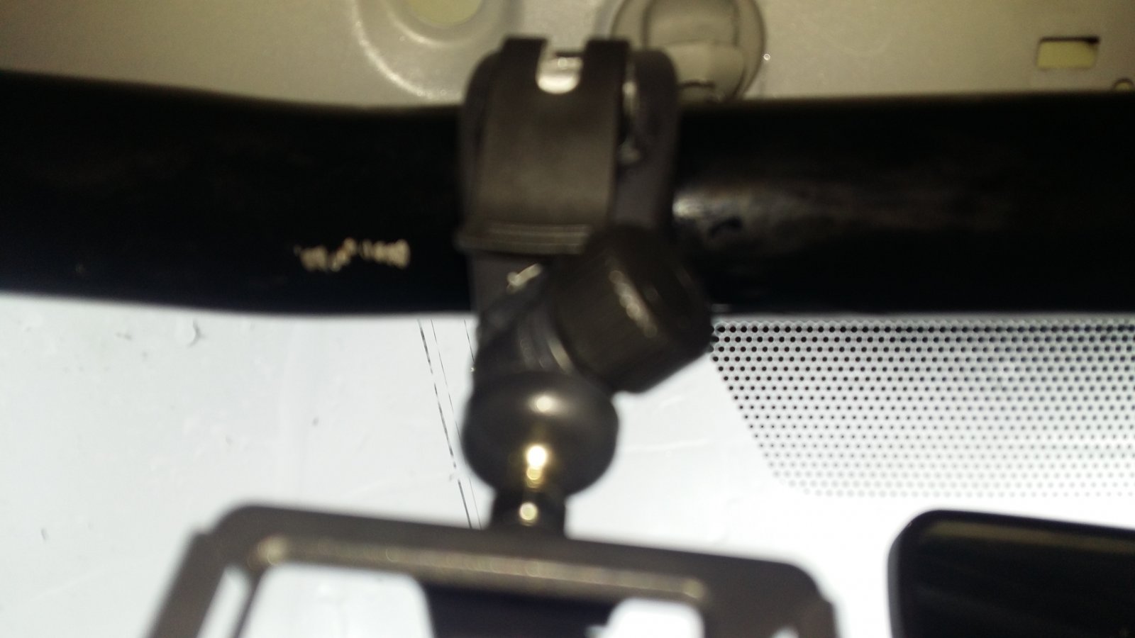

I use a simple clamp (photo attached) . I've clamped to the passenger seat (video here - - a bit of vibration) and to the roll cage / ROPS (video from yesterday here - - very greasy!)

It's a heavy duty velcro loop, rated at 7kg of grab.
The mount has a loop it threads through to pull it tight and take the slack out, then fold it back on itself for the grab :D
