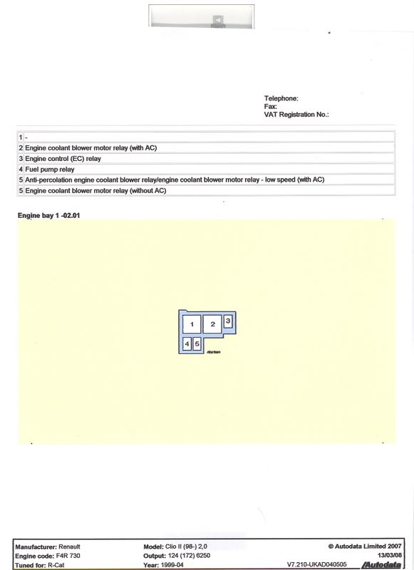

wheres the fuel pump relay?
where abouts is the fuel pump relay on my x reg 172? pretty sure its faulty, hope it is anyway or its the pump.

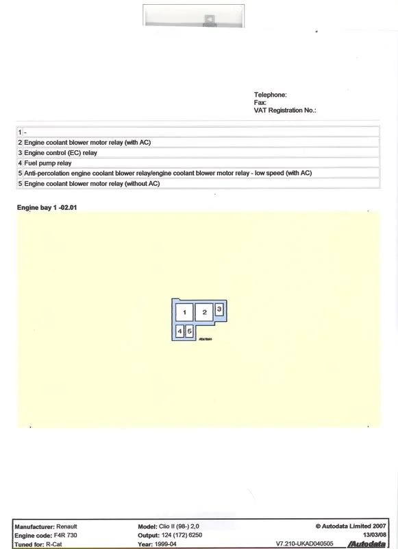

thats the fuel filter
the relay is in the fuse box in the engine bay behind the passenger headlight
there will be a few relays together, one of them will be a big yellow one and 3 smaller black ones, use this pic to work out which one is the fuel pump relay
oh well gud guess a?
