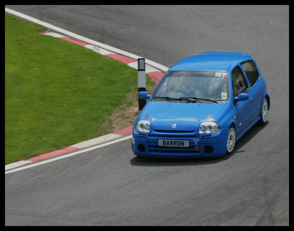

Well, the one place I used to get bad understeer wad the right hander before you go, onto the back straight at Snetterton, probably others but hey.
  lift number 1 @ btm
