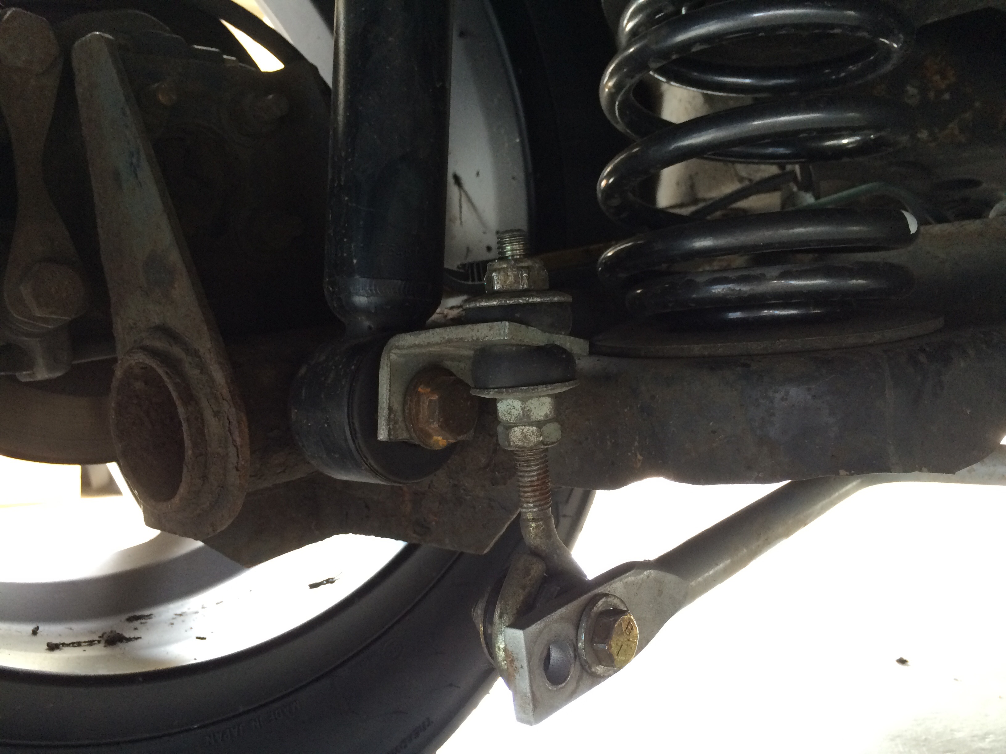

Just put the white line onto the hard setting, bit concerned about how the bush is sitting.
The other side is flat but this side is on the c**k - should I try to correct it or is this just how they sit on hard?
I'm at thruxton so could do with a quick answer ;)
Cheers,
John
Interested as I'm fitting mine tomo. Will that bracket move slightly so it sits more level? I have read that they do sit on a strange angle. Also is that the hard setting in the pic?
Yeah it is the hard setting my eyes are deceiving me, lol
Level the bracket off if you can.
Don't tighten that top nut too tight either, just enough until the washer on top stops spinning.
The bushes shouldn't look crushed.
