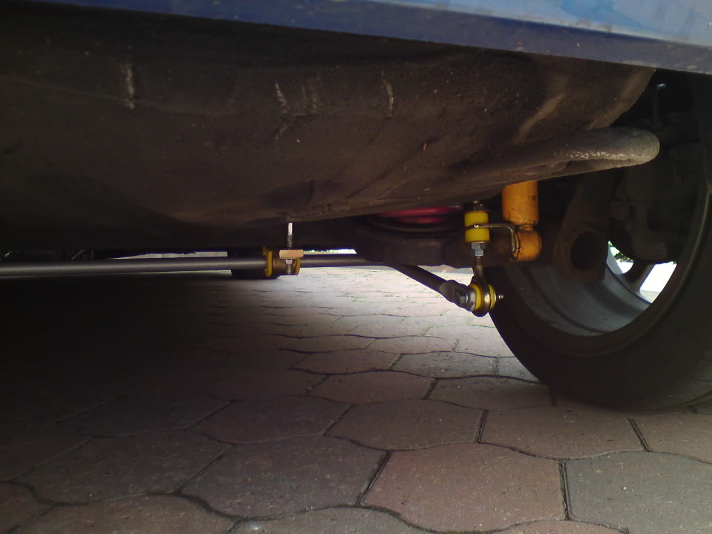

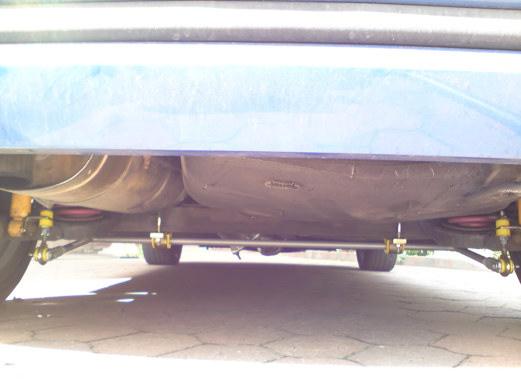

Fitted on this afternoon and just taken it for a little run.
Although the turn in is sharper, the front end feels as if it's skipping slightly and the back end seems more nervous, not dangerously nervous but it wouldn't take alot of provoking for it to step out.
Just wondering if I've fitted it correctly or maybe my Koni's need adjusting slightly to compensate for it? In the pics, on the drop link where there's two nuts at the bottom, there isn't a definite position for them and perhaps I've not got them in correct place?

How many holes do you have in ARB? as I cannot see in the picture,if you have another one next to the one you have bolted it through,try that one as you have it in the hardest setting.
On the drop link put the nuts down nearer the bolt eye,this should soften it up a bit.

I have two holes in the bar, I thought the current hole was the softest setting lol. Cheers Tony I'll give that a try tomorrow.

The Cup already has stiff suspension, any stiffer and you'll be oversteering in to the ditch. The Konis and what looks like Eibach Sportlines on your car are enough. With normal road tyres and driving on roads, especially in the wet you'll loose traction, there has to be some compliance in the suspension to make it work. Driving on a dry track is a different ball game, ask Tony Hunter. My opinion is you've gone too far for a road car. If you insist on keeping the RARB then adjust it, if you can't then move the brackets on the rear beam closer to the middle, this will have the same effect.

You definitely have the ARB on the softest setting as the longer the distance from the bush= more leverage. I would soften the rear dampers off.
I thought I did going off the diagram I had but wasn't sure. Still not had chance to adjust anything yet due to the car being off the road.
