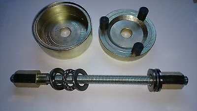

would something like this help?
DomP182
  ph1 172, Arctic182
I essentially made that yesterday using a length of threaded bar, a huge socket and a brake caliper piston with a hole in the end. Even on a breaker bar it wouldnt budge. The metal bush casing is far bigger than the inner larger hole on the beam.
I presume there must be a manufacturing tolerance issue.
You sure you removed all of the old bush? there should just be a hole, nothing else.
DomP182
  ph1 172, Arctic182
Yeah, I've had it blasted and powdercoated. Nothing but bare metal in the holes. I'm going to order whiteline bushes as they insert all the way in and dont rely on an interference fit I'm assuming they may be a tad looser.
